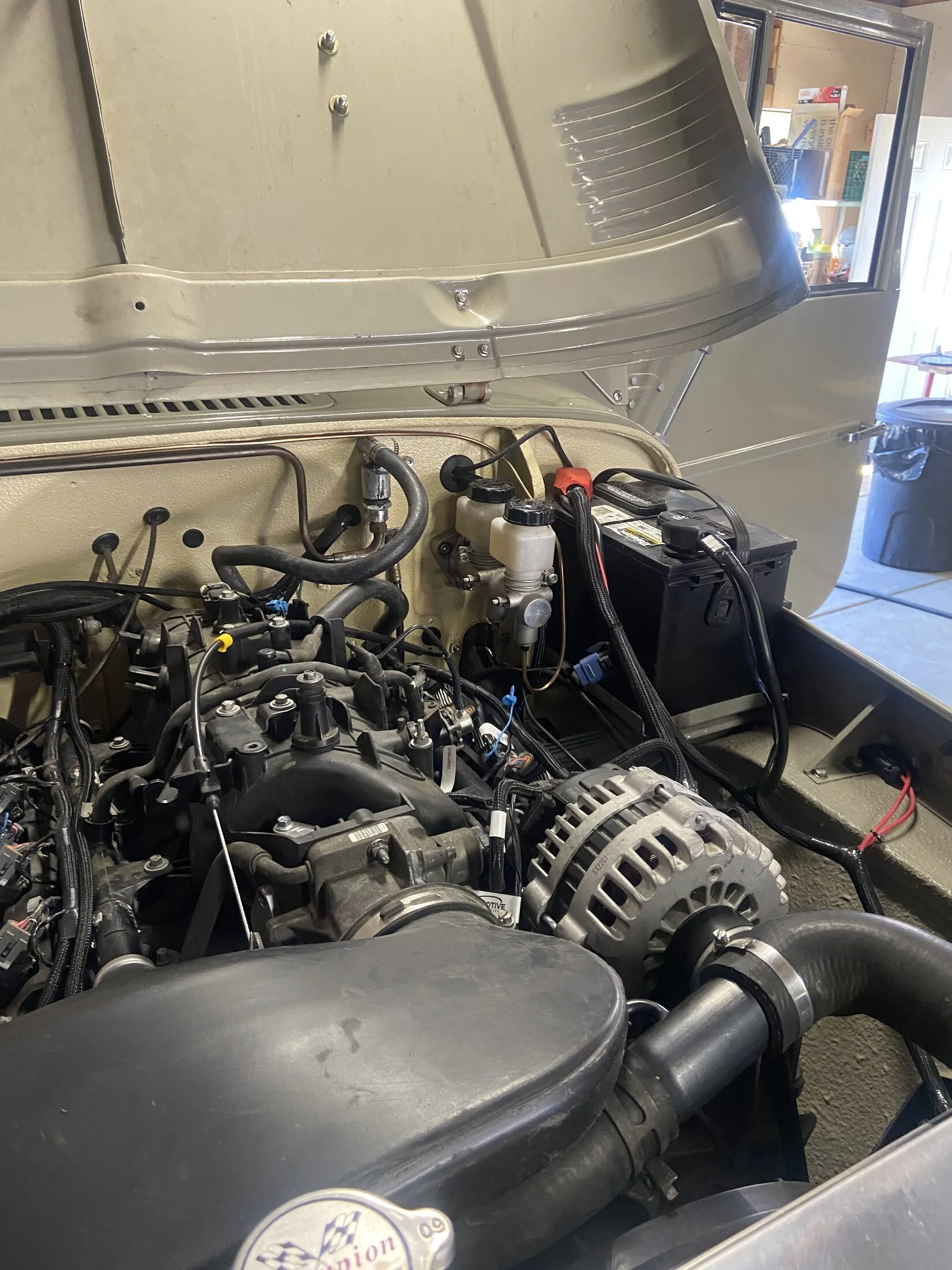

Which master cylinder are you going to use? I converted to 4 wheel discs years ago with Poser’s brackets and Monte Carlo calipers. I want to say I bought the Wilwood master through JTOutfitters. It’s an un-boosted, 1” bore, dual circuit MC. Always stopped straight and I ditched the proportioning valve when I installed the LS. I hate drums. Now the only things I have them on is a 1974 Moto Guzzi Eldorado and my 2017 Tacoma. They both suck.
