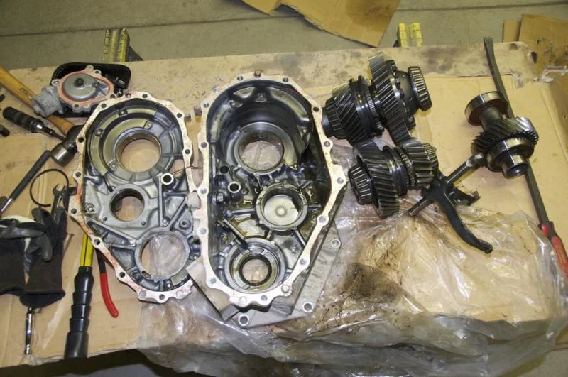

The other project that got some traction today is installing the Marlin t-case gear reduction (low range) set. I happened to call Ben at Slee Offroad at the right moment, a month ago or more, and he had a Marlin gear set to sell me (very limited availability right now): Thanks!

Dan, what are your impressions of the Marlin. Install/Performance/Value? In Moab last weekend I was wishing I was just a little lower a lot of the time.
Its sitting on the bench with gears installed...waiting for a bearing and a snap ring. Then I can button it up and install it.
The gear cut/finish is really good!

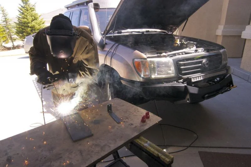

Finally got my OBW (On Board Welder) installed!
And it works great...I hope I never need to use it! ;)
Thanks Scott @ Mobi-Arc!

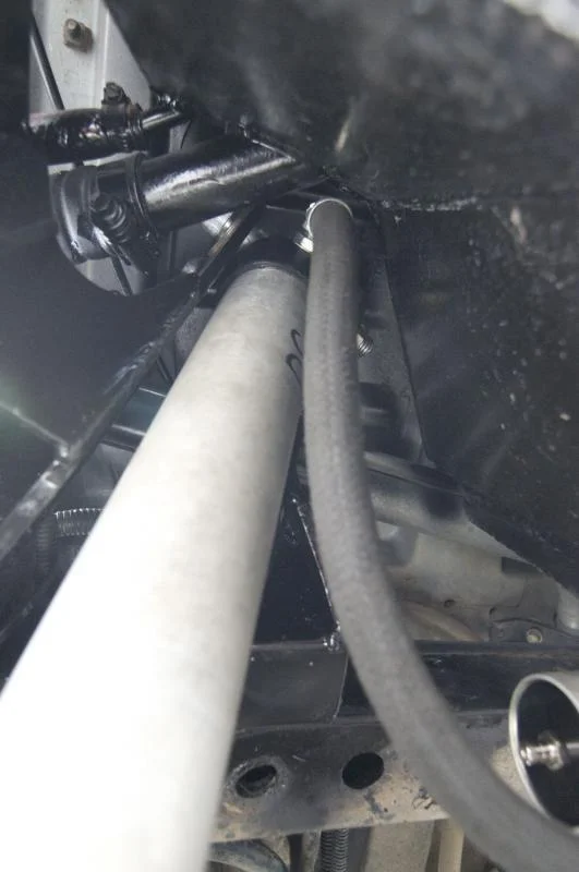

While working on the installation of the Mobi-Arc OBW (see post 420), and after 3-weeks of cutting/grinding/fabbing/test fitting/suspension cycling/cussing and cussing some more :D I completely re-did the rear upper shock mounts. And I must say, with a little pride here, they turned out perfect!
Like they say: "If you want something done right...do it yourself".
Some of the 4x4 fab shops, even the 'big boyz', give used car salesman a good name :rolleyes: Took me a while to build up the confidence to attack this job...but sure glad I did. Other than still trying to get small specks of grit out of my eyes...
Live and learn I guess.
But after running and testing the rig in DV last week the suspension has never felt better.
