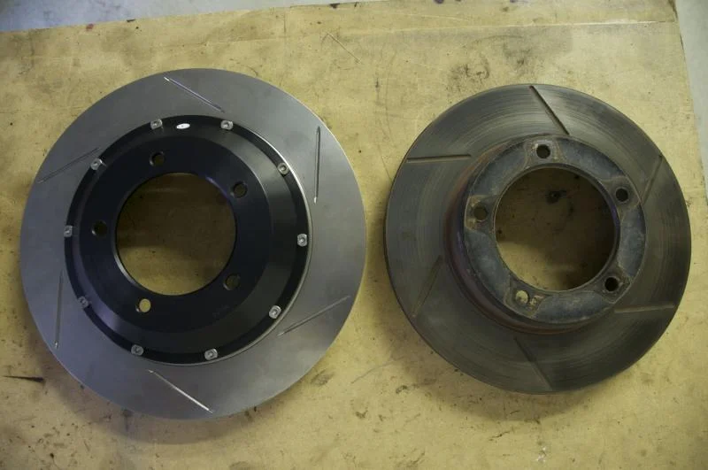

One of my latest projects. Full report coming after bed-in and testing.
Looks sweet, hope it improves the pedal feel.
Is it front only?
Is it front only?
Yes. Stoptech is currently working on a rear set-up for the 100...
I just got back from bedding in the new rotors and pads. One word: Incredible.
High & very firm pedal with an incredible amount of modulation and peak stopping power. No more double pumping either (overhauled the M/C apart of this install...thanks again Skidoo for your very well documented M/C overhaul procedure!).
Done.

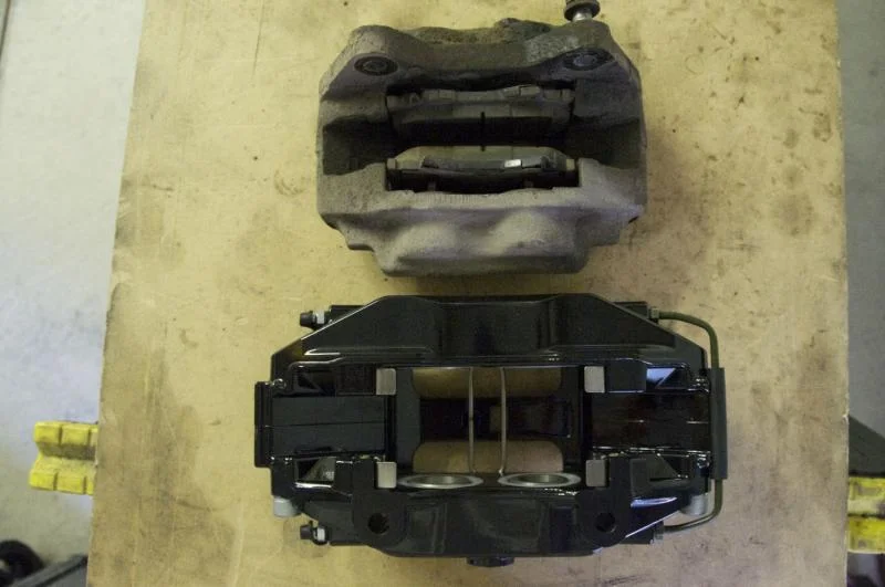

Nice! Problem solved! How much larger is the rotor OD than OEM?
314mm x 32mm stock; 355mm x 32mm Stoptech.
holy giant brakes batman! I'm more impressed by the size of that caliper than the rotor! they don't look that big behind your 35s on 18's, but when you compare it to stock... wow!
