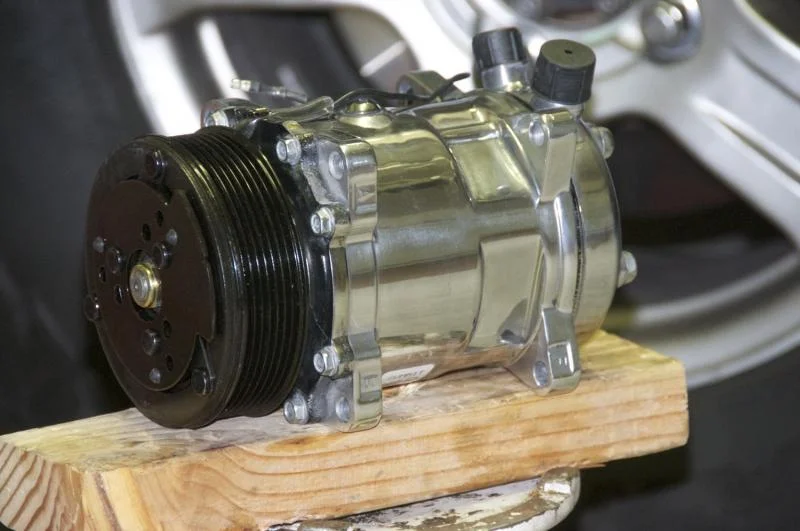

Struck out at Pick and Pull today. But found this in the clearance bin at Summit Racing just down the street from PnP. Even a blind dog finds a bone once in a while :lol:
This will be the shiniest thing on my truck :)

OBA? Is it a York?
OBA? Is it a York?
spressoAIR OBAv2 :D
(thanks to hoser for the moniker!)
Sanden via serp belt. I've been using a v-belt Sanden driven off the camshaft for the past year + testing the bracket, etc. And it has passed with flying colors. But I wanted one driven off the serp belt for simplicity and 1:1. Its taken me a couple months of thought time but now its finally coming to fruition!
A York is just too tall for our engine bay. The little Sanden is a wobble/piston/plate design (ingenious design IMO) that still puts out 8.5+cfm (!) @ 100psi (!) and is capable of 200psi output (!) but in a very compact form.

Jack told me you told him about the mod :). I already have the coalescing filter and a vapor filter installed on my Sanden OBAv1 that completely removes any trace of oil vapor. So far it has worked out perfectly. However for somebody setting up a new system it would certainly be worth the effort to try it out and save the coin.
Sanden OBAv2 UPDATE:
After a couple dozen different bracket prototypes I finally hit pay dirt this afternoon. There's just no margin for even a slight variance with the limited space available. But the bracket prototype is done.
Got a buddy that's going to spin a pulley next week and then on to bolt-up, belt length determination and then on to testing.
