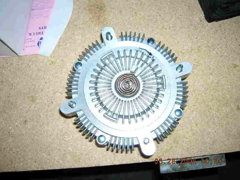

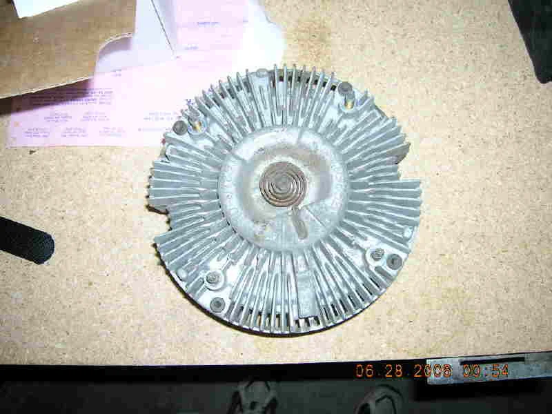

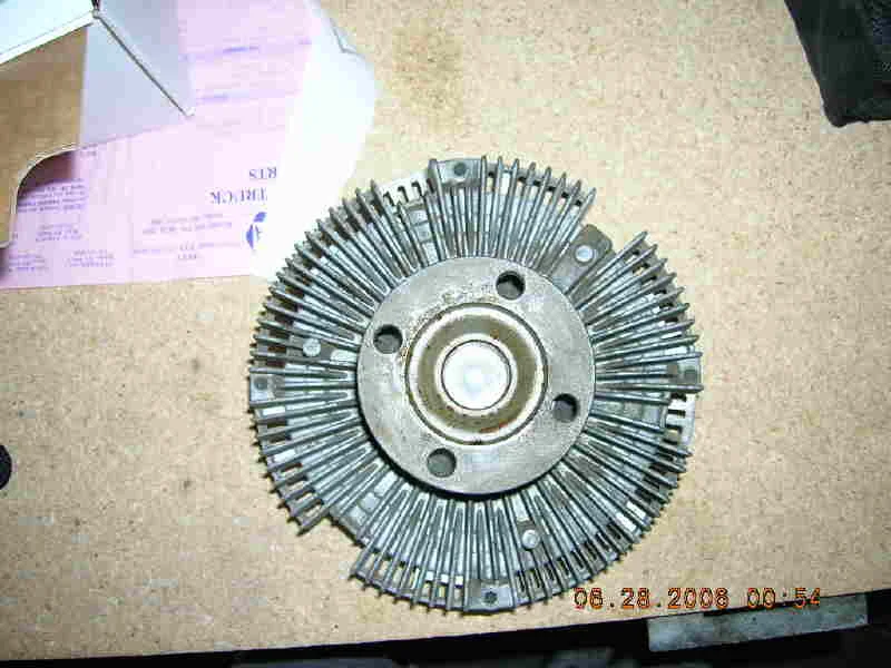

New fan clutch is installed. I did everything I could to get it to overheat. I ran up a pretty steep hill with the air on at 80mph and nothing. I took it into the hills and did several steep, slow hill climbs and a couple of miles of dirt road all with the air on and no problems so far. The only downside to my testing was that its only in the high 80's today and overcast. More difinitive test when the temperature climbs back up.
I'll try and get the pictures uploaded in a few minutes.
