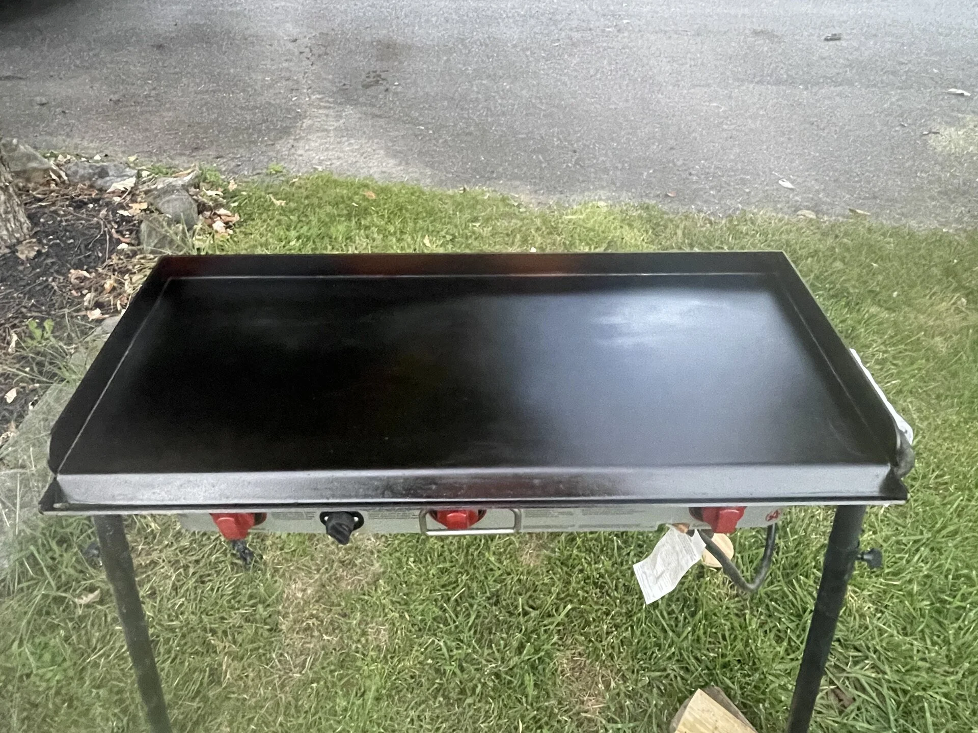

I have gotten the new club flat top seasoned. It just needs some hamburgers thrown on it.

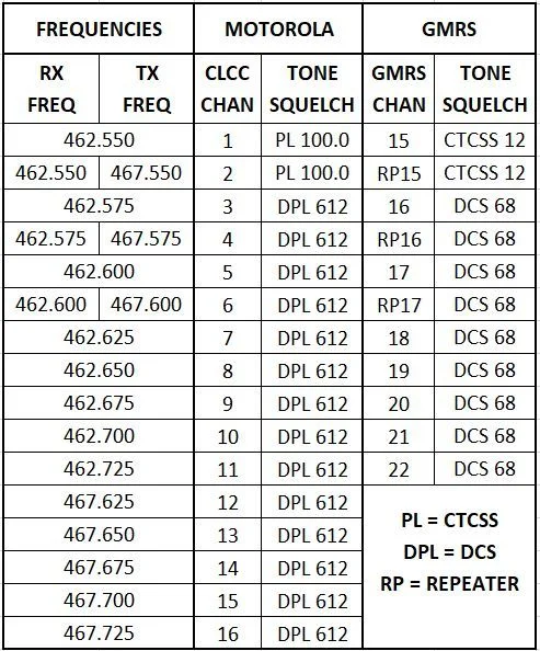

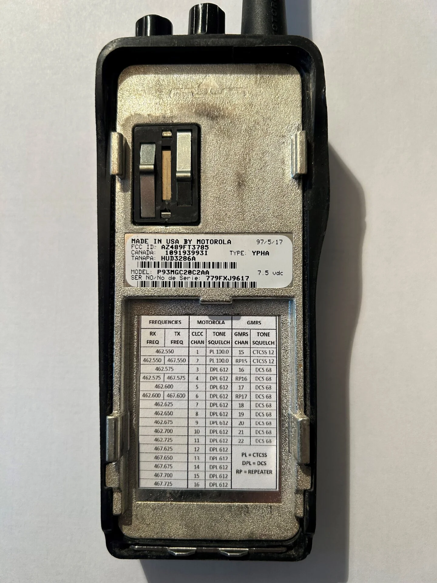

Geek Alert!!!
If you have a CLCC Motorola radio, do this:
Copy this chart that shows which CLCC channels on the Motorola radio match the generic GMRS channels.

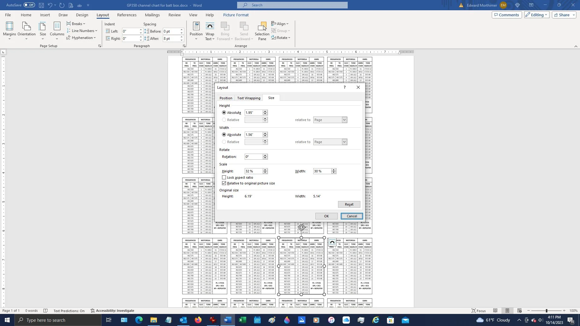

Paste it into Word and set the size setting to the dimensions shown below (H 1.95 L 1.56 aspect ratio off) and then copy it as many times as you need for your fleet of radios.
Now, remove the radio's battery, borrow you kid's glue stick and paste the chart into the back of the radio. Now, when you meet up with someone on the trail and they say they are on GMRS channel 19 you can remove your battery and look at the chart to see that it is CLCC channel 8, and now you can talk to them. :)
I will print a couple of pages and bring them to FC.
:geek:

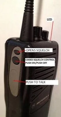

And another Geek Alert!!
If you are using a CLCC Motorola radio and they (generic GMRS radio user) can receive your transmissions but you can't receive their transmissions, it is most likely because they have not activated the coded squelch feature. To fix this, disable the coded squelch on your Motorola radio by pushing the little button above the Push To Talk (PTT) button. When you push the button, the LED will momentarily glow orange and the coded squelch is disabled. Now, your Motorola radio will receive any transmission (within range) on that channel.
OK, one more geek announcement (hopefully the last one), channels 2, 4 & 6 on the CLCC radios are repeater channels. These channels are not usable unless there is a repeater on the air. We will have a repeater on the air at FC. Channel TBD.
:geek:

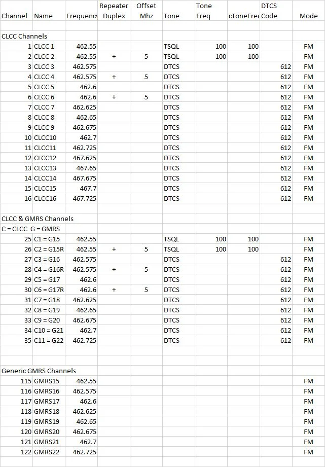

OK, one more TNG (Techno-Nerd-Geek) thought.
Since the Baofengs have an abundance of available channels, how about this?
Program channels 1 - 16 with the CLCC freqs & squelch codes, and
Program channels 115 - 122 with the generic GMRS (Midland) channels 15 - 22 with no squelch codes.
Program channels 25 - 35 with the CLCC freqs/squelch codes that are labeled with both the C (CLCC) and G (GMRS) channel numbers.
The best of all 3 worlds. This is what the North Carolina folks are doing. They have their Midland radios programmed with the same squelch codes as CLCC so channels 25 -31 just make it easy to translate between the CLCC channel numbers and the GMRS channel numbers.

There should be a Chirp file that has all the CLCC, Generic GSMR, PA club, and NY club channels on it.
I believe I have it but the computer got wet and I have not tried to boot it up sense the incident.
Hey Ed @emorth I copied the .csv file over to chirp and it is a little different than what you have. I am assuming that it is possible the difference in CHIRP versions and or that I am on a MAC and that may be different as well. Can you take look below and let me know if this looks correct? I have not dabbled in the "privacy" side at all over the years. Basically have just kept to the standard Freq's. TIA
