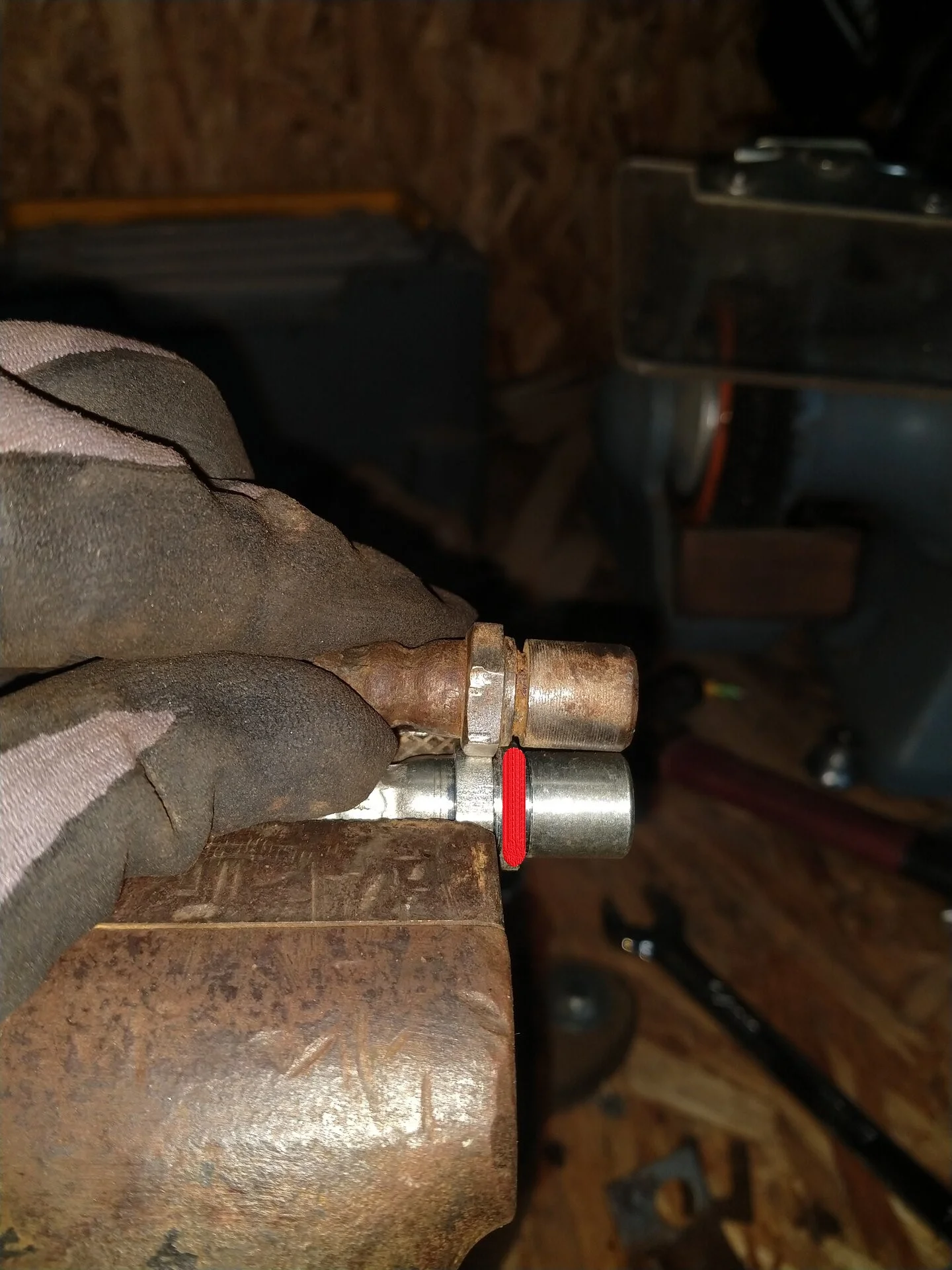

Hello everyone. I bought extended brake lines and the connectors on the ends are slightly different than the original. Looks like ill have to modify the frame mount to fit the different shape of the connector. Is this what others are doing or is there a source for the proper style connector? I can't find one.
It’s irritating when they changed that. I’m wondering if you can find a snap-ring that will fit on the upper (closest to rubber) groove, and then the spring plate in the lower.(?)

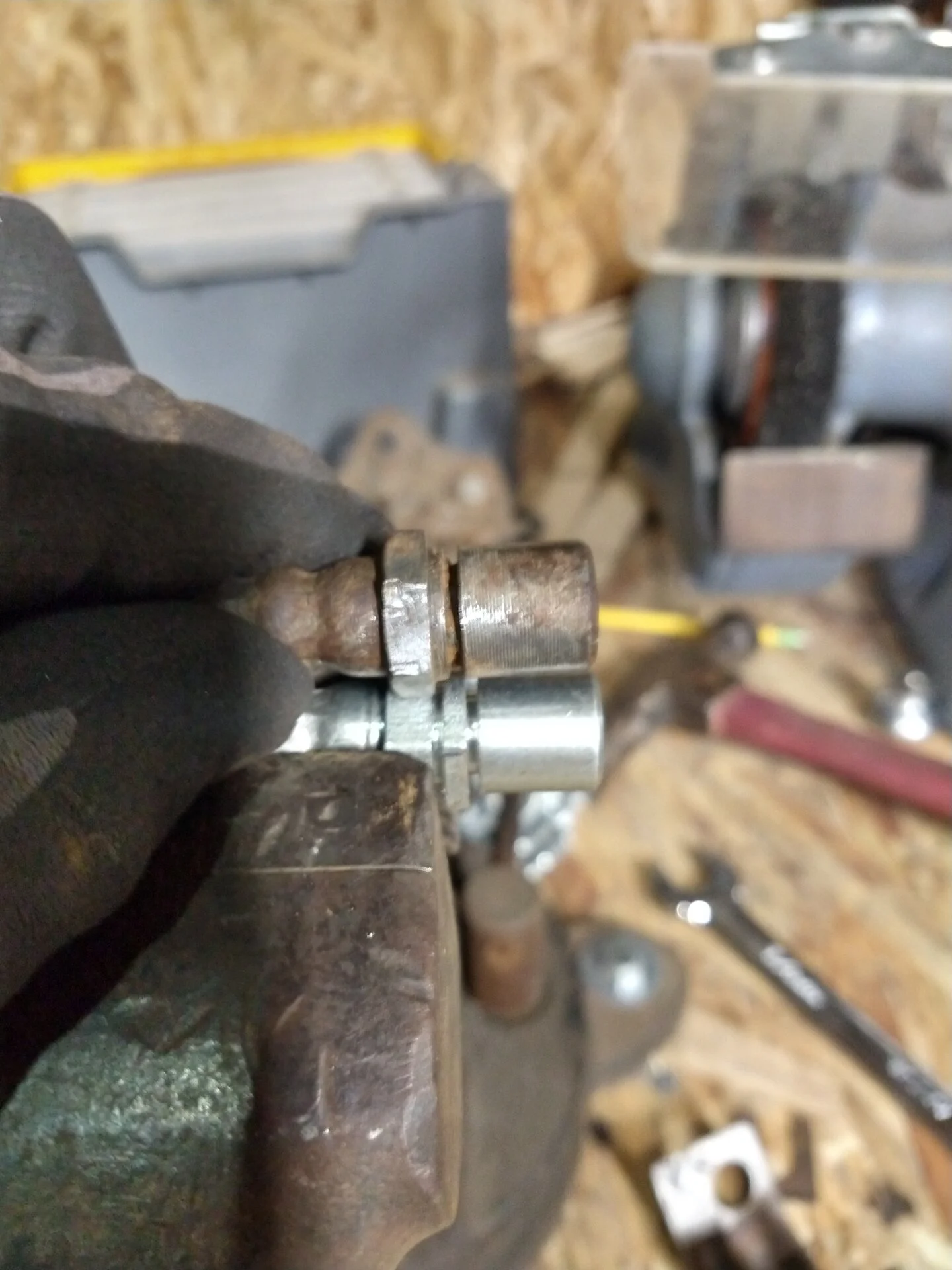

I shaved the part in red down with an angle grinder and gentle touch so that it was round and would slip through the frame mount keeper. Then used the spring tension u-shaped clip on the outside notch to hold it on. Seems to be working well so far.
I did the same with mine and all is well. I tried using a grinder but found better results using a hacksaw and a file while clamped in my vice. It took all of about 3 mins.
I might have to try this with the one I have. I have nothing to loose at this point. Thanks

They have the proper ends on them. (other than shaving down the middle ring) I originally went with the t100 line from post 6 ‘75 Fj40 front brake soft line sanity check - https://forum.ih8mud.com/threads/75-fj40-front-brake-soft-line-sanity-check.1297599/, but the male threads were about 5mm too long and would bottom out in the "T". @Grease Cruiser is right, it only took about 3 minutes to "fix" it and wasn't a big deal.
