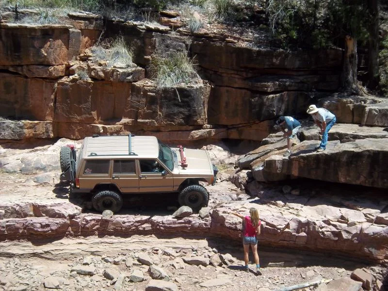

Our wives decided that AzTony and I should take them up to the pines and go trail chasing Saturday. We got warmed up by running Payette Draw first thing. It's always a little differnt each time I am up there due to errosion and traffic. Some parts were easier, some a little harder. This ledge was undercut pretty bad, and it was well past the center of our 37s. I came up to it square on both tires. Couldn't quite pop up the darn thing without locking the back. Probably would of been a lot easier to do it at an angle, but, what the heck, it would of been easier to stay home!! Caught up with a group of Jeeps before the waterfall. One of them decided to go play on the big overhang. If you've been there then you know that it is a lot harder than it looks. Every time you start to lift the front up the wall, the rear wants to crab walk to passenger due to the off camber. After he gave up, I found out that he lives about a mile from me.

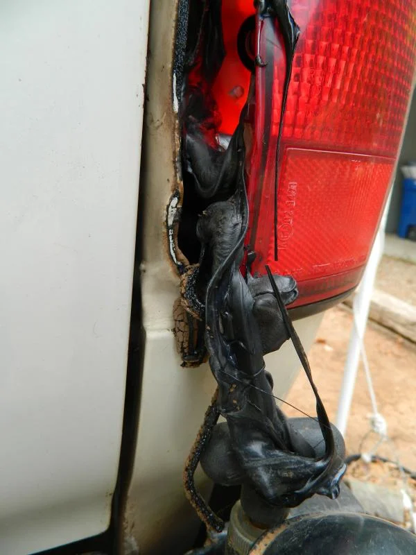

On the way to supper in Christopher Creek, I thought I could smell hot rubber briefly. Tires and fan belts were all OK, so didn't worry about it. Got back to Payson after dark, so headed down Hwy 87 back to the Valley. Just south of Rye my dahs lights went out. No smell, no sound, no other problems. Using a flashlight, I could see that all my gauges were reading OK, so I kept going all the way to Chandler. I figured I had popped a fuse. No big deal. Too busy Sunday to look at it, so went out this morning to check fuses. They were all fine. Hmmm. I wonder if this has anything to do with it?

Whoa, how did your tail light melt?

Got most of the melted plastic off, "new" light in (the red box of parts comes in handy again!). Now need to do something with the exhaust so it doesn't torch it again. Who was the spotter that caused that carnage?!:hillbilly:
There was no socket/wiring damage in or near the taillight. Kudos to Kevin for finding the problem in the trailer harness/converter. :clap:
Still trying to figure it all out. Details to come as I figure them out. Needless to say I am looking for a replacement!
Apperantly I came down on the back end on a pointy rock. It bent the tailpipe up right at the rear hanger and that aimed the exhaust right into the hollow corner of the bumper. Looks like the heat excaped between the tailgate and the tail light.
It just couldn't take all that weight in the back of the truck any longer...:frown:
Good guess, but wrong. :frown: It was due to me standing on the throttle way too much :whoops:and that supercharger works like the afterburners on a fighter jet. :idea: It gets HOT!:bounce2::bounce:
Seriously, is it my trailer harness/coverter in my Land Cruiser is F uped season? :frown:
