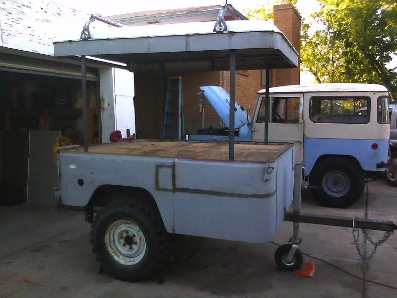

Im all for having room too. Believe me, I will keep it as high as I can. The problem I have run into with this design is that when one half of the top is lifted & the legs swing down, because of the length, they dont rest on the trailer. They are a few inches too long and so they are hitting about where the tire rack hinges are. :mad:
I have to shorten them a bit so they will land inside the tub. My goal is to shorten as little as possible until they land inside the tub. I figure I have 4-6" I can get rid of and still have enough room inside to move around. If that doesnt work, ........ its back to the drawing board.

shortening the legs alone would not work. My next thought was that the mounting brackets would have to move inboard. But I did'nt like the idea of sliding the top around on top of the wood platform to get it into position every time. Eventually the wood would wear out. the next idea was to modify the brackets to allow an intermediate knotch that would allow the leg to land inside the tub then roll off into the main locking knotch. That would work great for set up, not so great for take down.
So, I called in MrPepper again to brainstorm on the lift mechanism. What we came up with is basically a hybrid of the 2 main designs. We're keeping the legs mounted on the long side in their current location made out of the flat bar stock, but we are adding a hinge. The hinge, in order to maintain a low profile will be similar to the safety hinge on a folding ladder with 2 pivot points that will lock into position once the leg is straight. The bottom of the legs will be permanently mounted directly below the top bracket. More fabrication...... But I really think this time we've got it right.

I like the cable lift mechanism. Its a great design. When I first concieved this build, thats the direction I was going to go. I have a pop up trailer now, and have grown up with them and never had a failier either. But building that mechanism myself is another story. Its not an easy project. I have over 12 hours into the legs on the top now and it is 10 times less complex of a build. and the way the trailer is not flat on the bottom and the back end is shallower than the front - its just not as easy as it sounds. Maybe you have more fab skills than I do. Im not a pro fabricator. Im not a machinist. This is my learning project. And its gone on for over 2 years! I need to get it done so I can enjoy it before the kids are grown. Storage of the air bag would be on the mattress durring transit and below deck at the camp site.

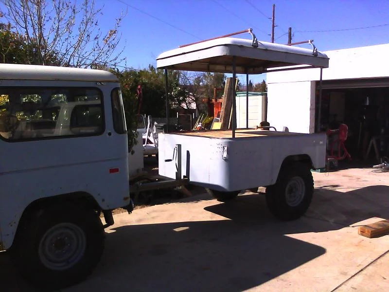

Lots of distractions lately. Ive got the geometry worked out. I just need to move the legs inboard about 6" and cut 4" off the length and they should land inside the tub. Time to refill my CO2 tank and start welding.
I spent Saturday cutting the legs down 4" and relocating each of them 6" inboard. It was a chore, but necissary. After the modification, I successfully raised and lowered the top, by myself! I still need to make some additional refinements, but I now know that it will work! I think I can lower it a few more inches and still have plenty of volume inside. Here are before after pics of the change:

Thanks! It IS pretty fantastic. I am thrilled. This design, since its inception, has always had a top that raised straight up. I could have clam shelled it and been done long ago, however I think the advantages of this design will have been worth the struggle. I spoke to my local upholstery guy today about making the tent material. He is excited to take on the project as a diversion from refinishing sofas.
To answer your question, It is all manual, but its not too bad considering you are only ever lifting 1/2 the weight at one time. I will put together a series of photos showing each stage of the set up process once I make a few more adjustments. It will be nice to move on to other areas of the trailer now that this hurdle is behind me.
