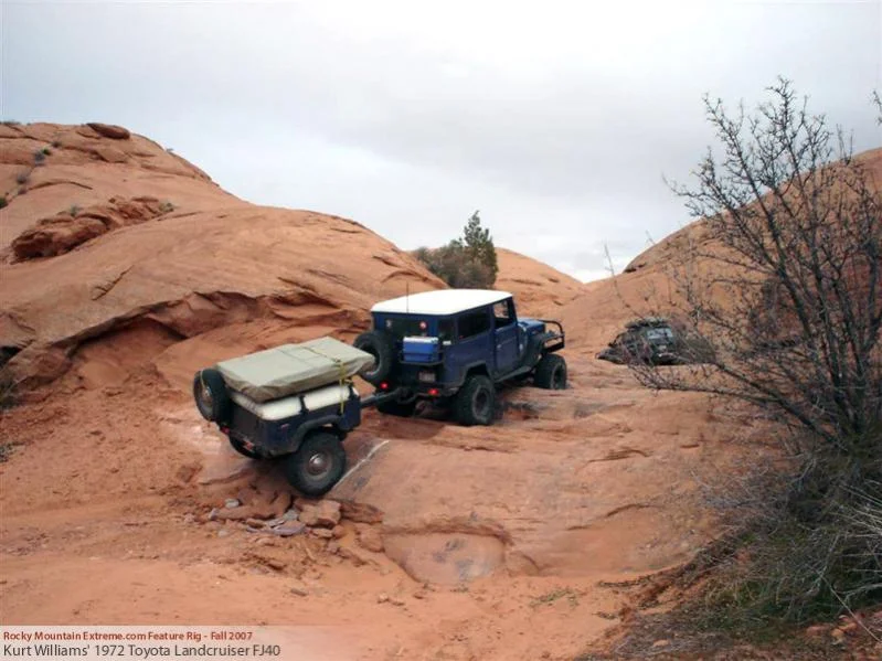

    I am planning to build an expedition trailer made from 1 or more FJ40 tub(s). I have seen a couple of these. I know Kurt williams has one. (pictured) Just curious if anyone else has or knows of one and could post some pics so I could get some ideas. Thanks.

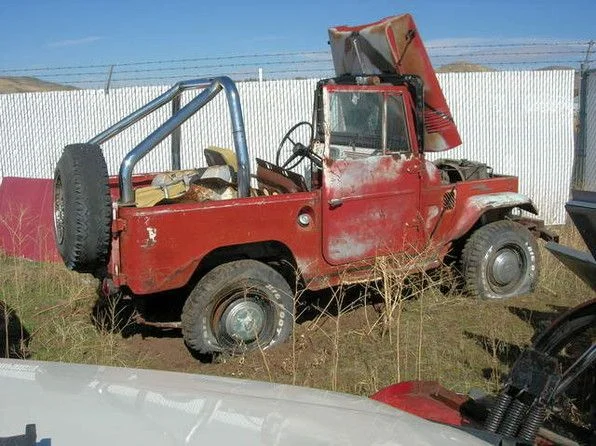

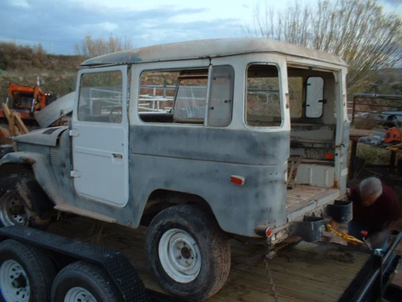

    Here are a couple pictures of my donor vehicles. The grey one is a 78' The red one is a 65'

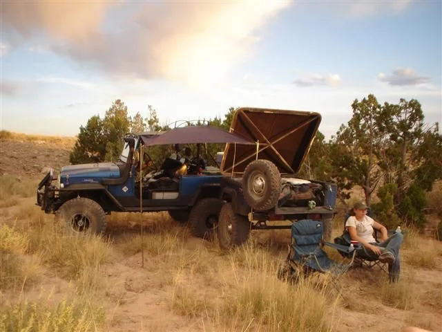

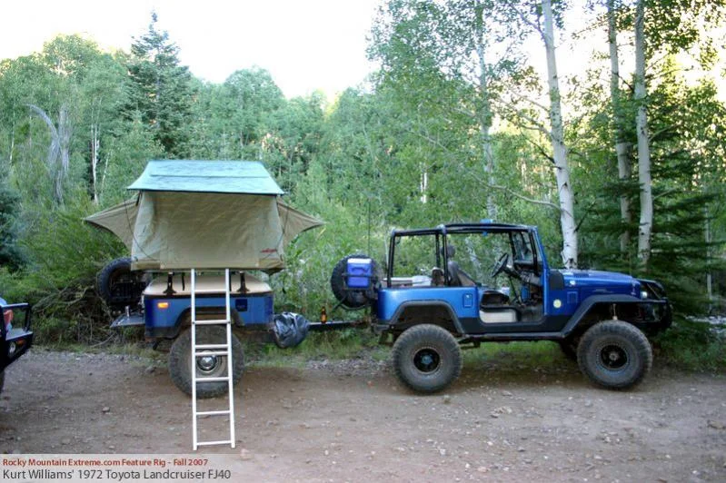

    I really like these picture of Kurts. seeing his contributed to my initial inspiration. Hope he doesn't mind me posting them.

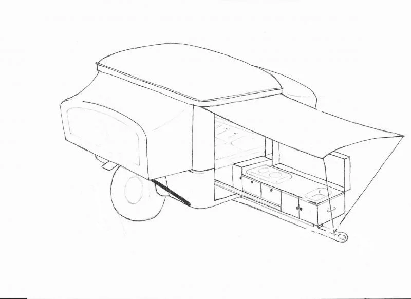

    Hand drawn, but this is the basic Idea.

    Location:
    Madison, MS
    Wow! Looks great.
    Any estimates on weight?

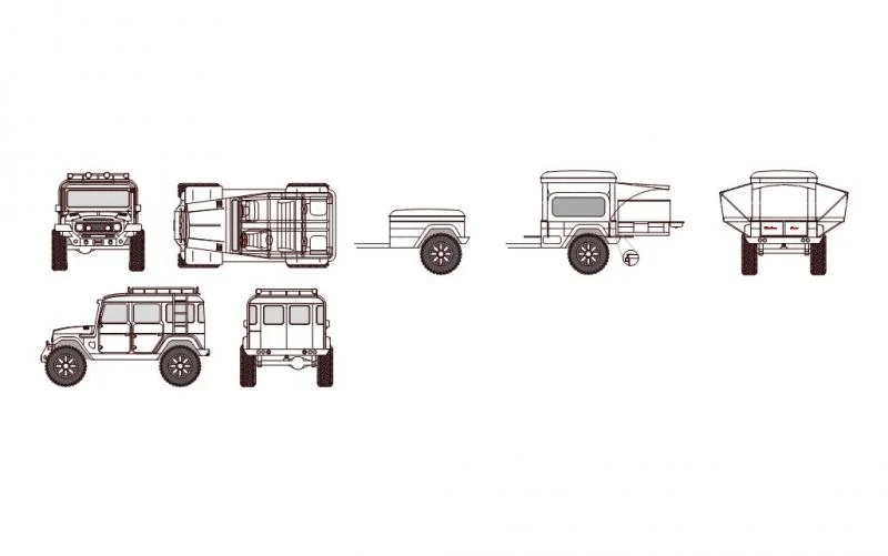

    Here is a 2D drawing that I did on the computer. It also shows My plan for a four door 40. I will use spare door parts from the donor tubs that I have.
