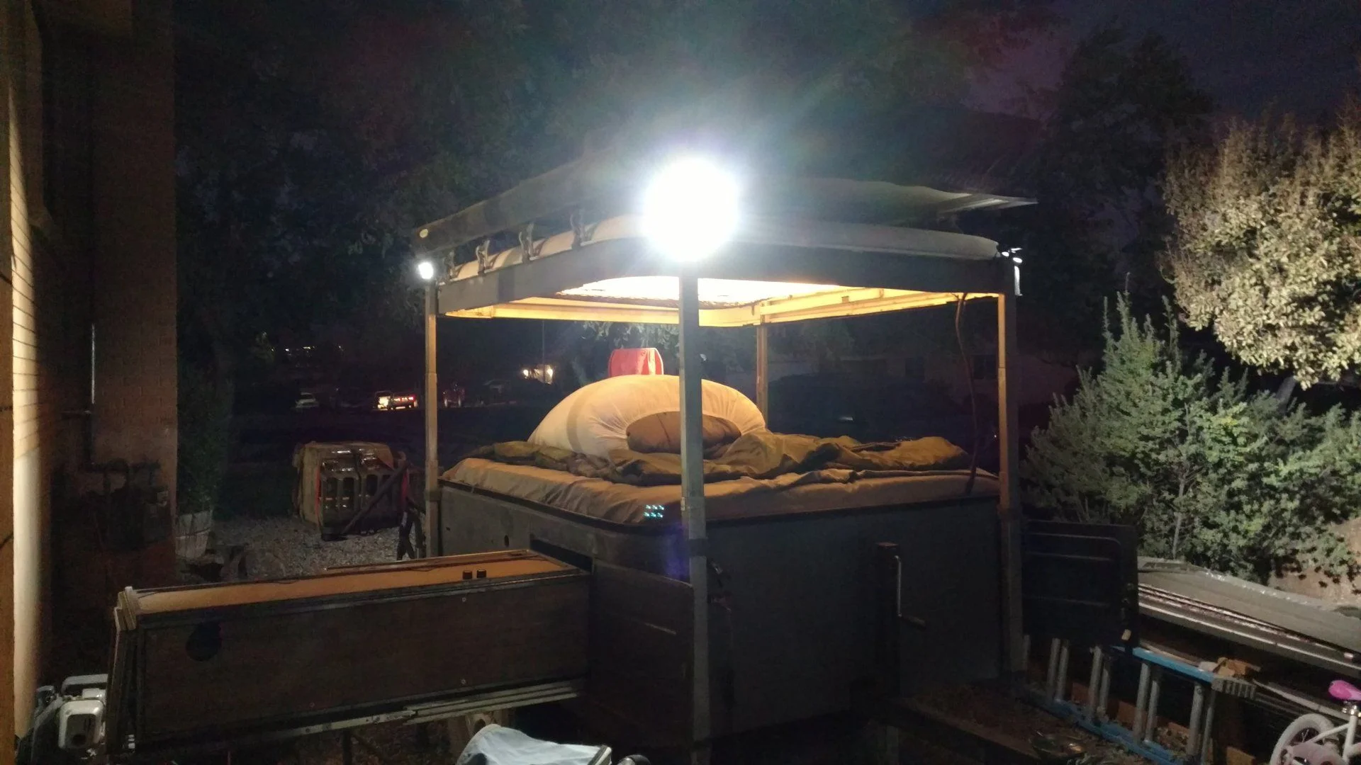

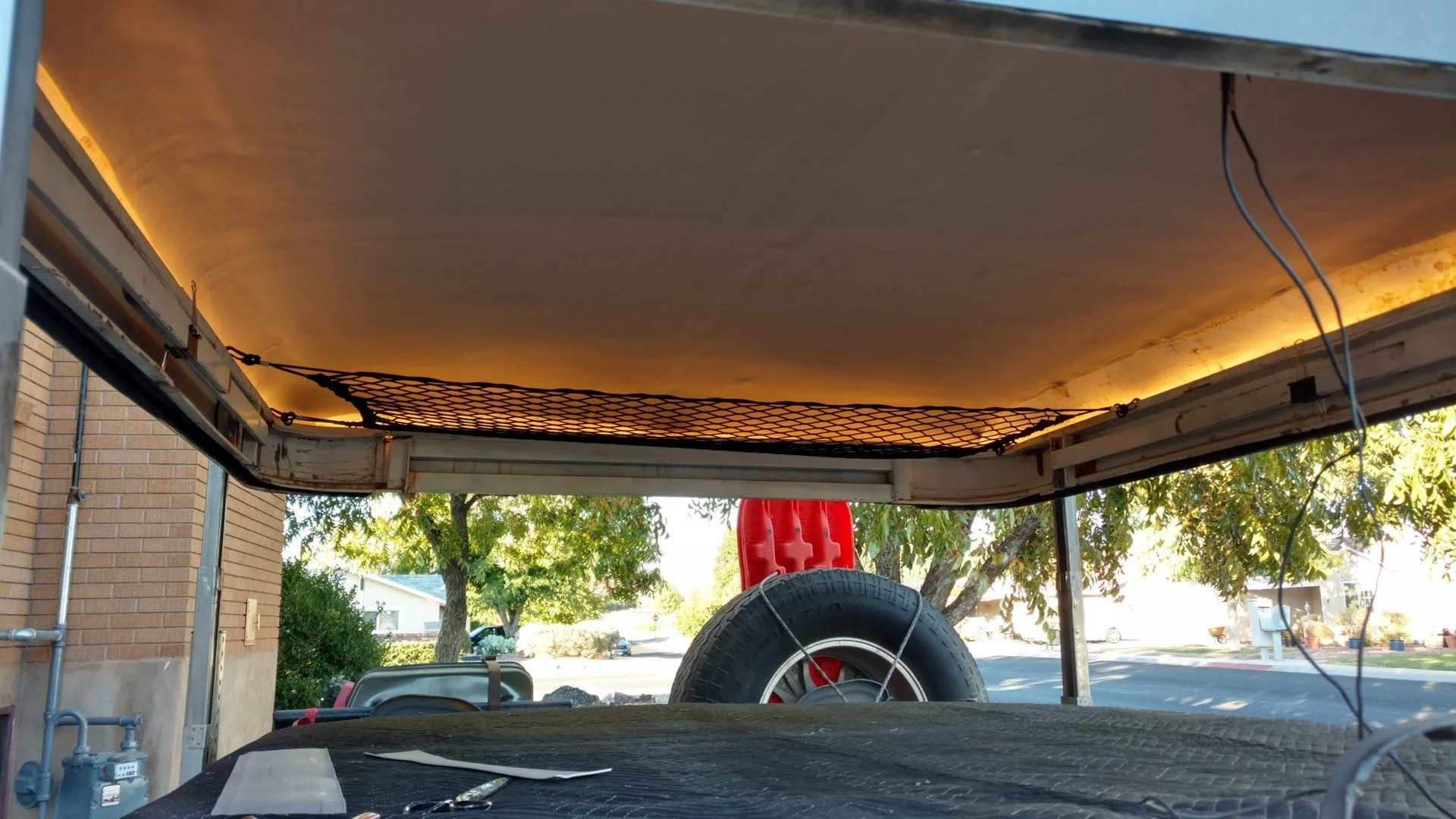

Added interior cove lighting and a headliner.

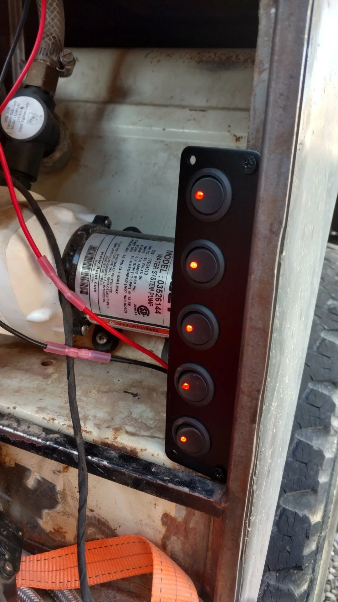

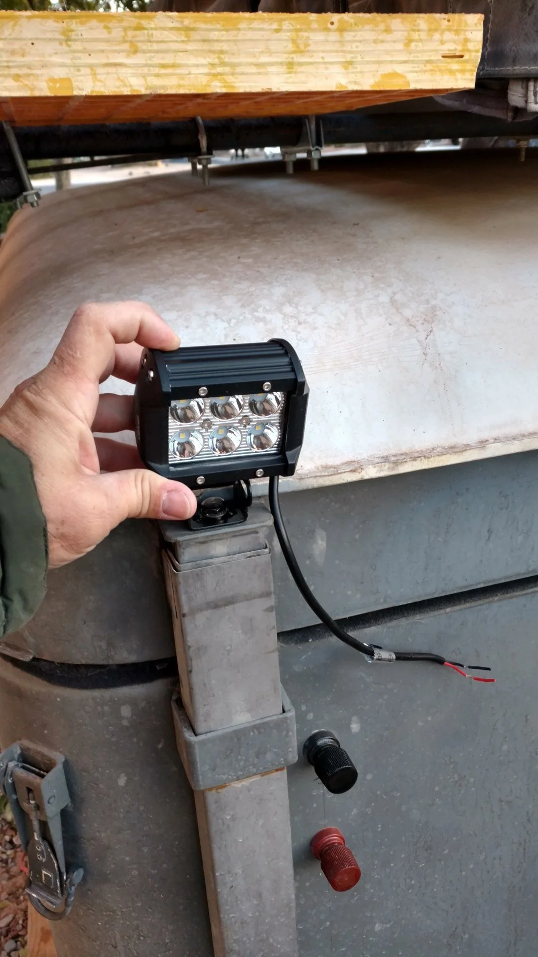

Added flood lights on each side switched individually. Added a fuse panel and remote battery terminals since the battery is not easily accessible.

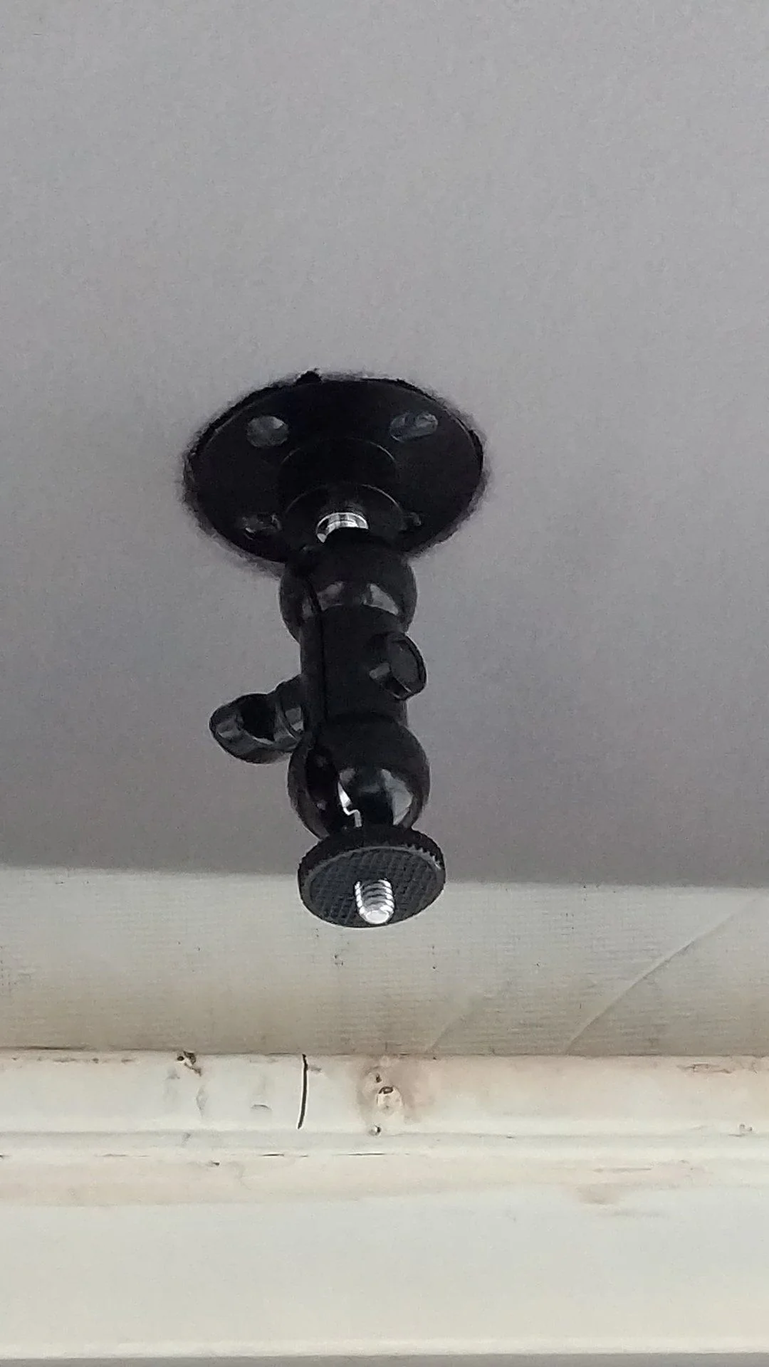

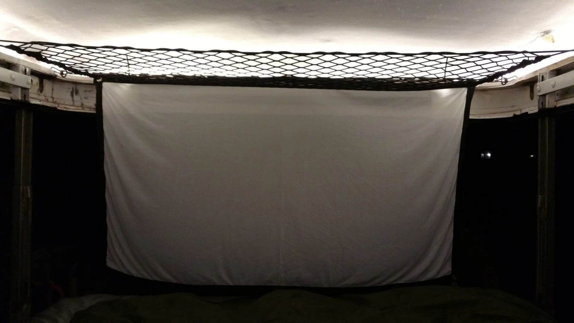

Some people disagree with this, but I think it's pretty cool. Pocket projector mounted to the ceiling. 60" screen at my feet. Movie time.

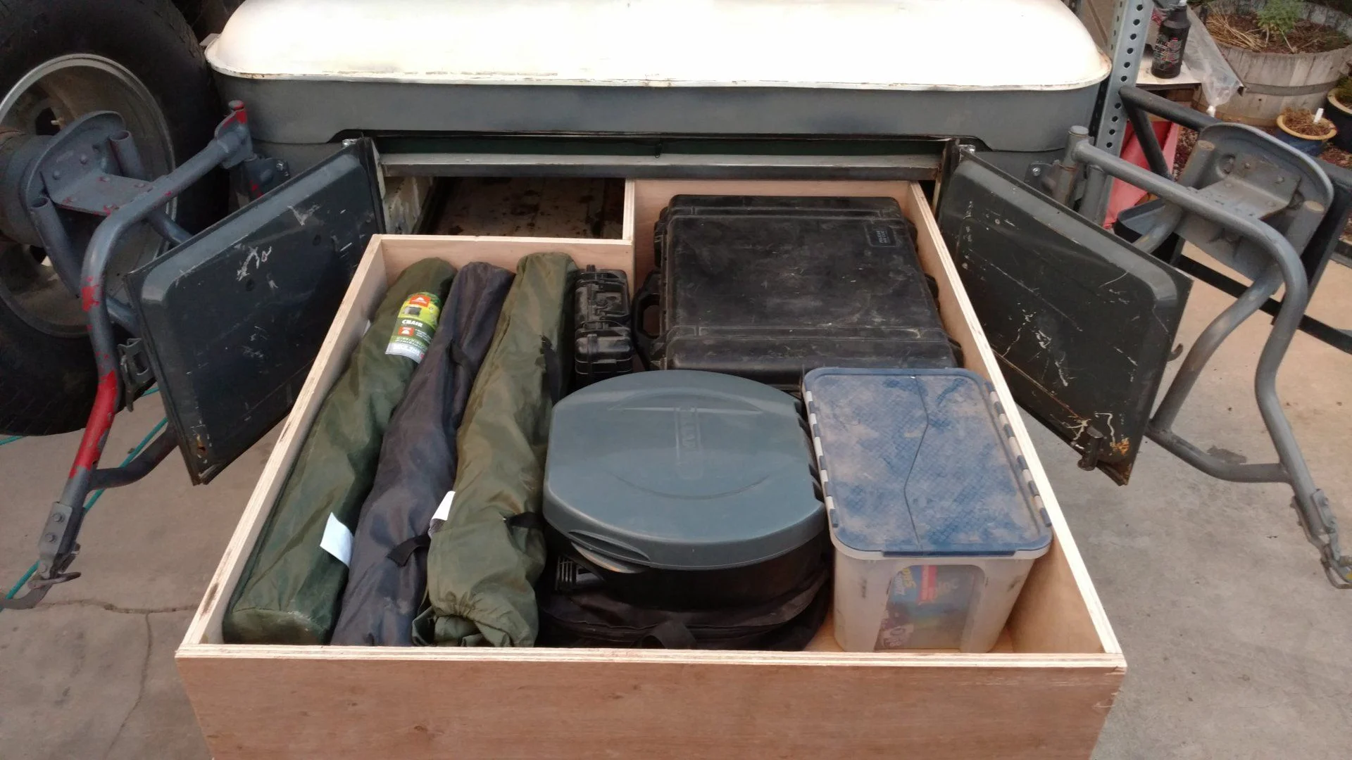

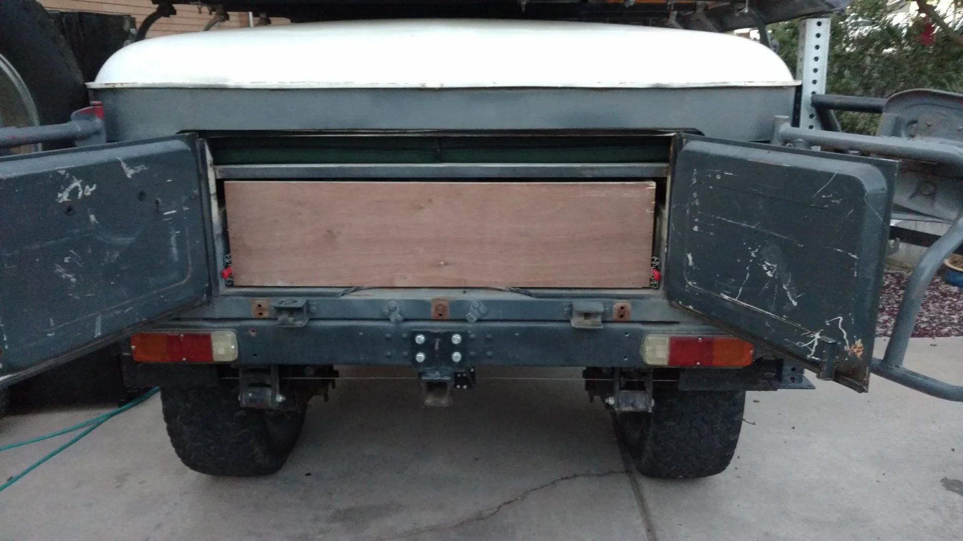

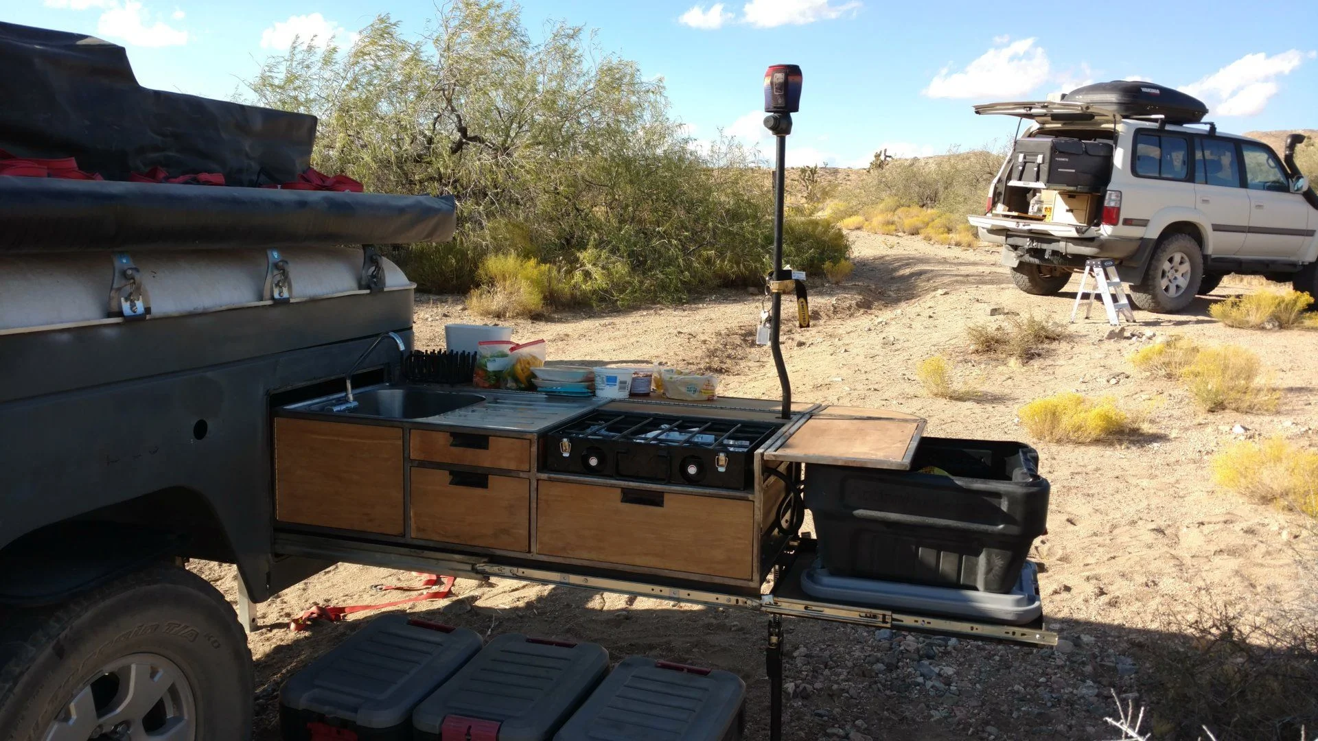

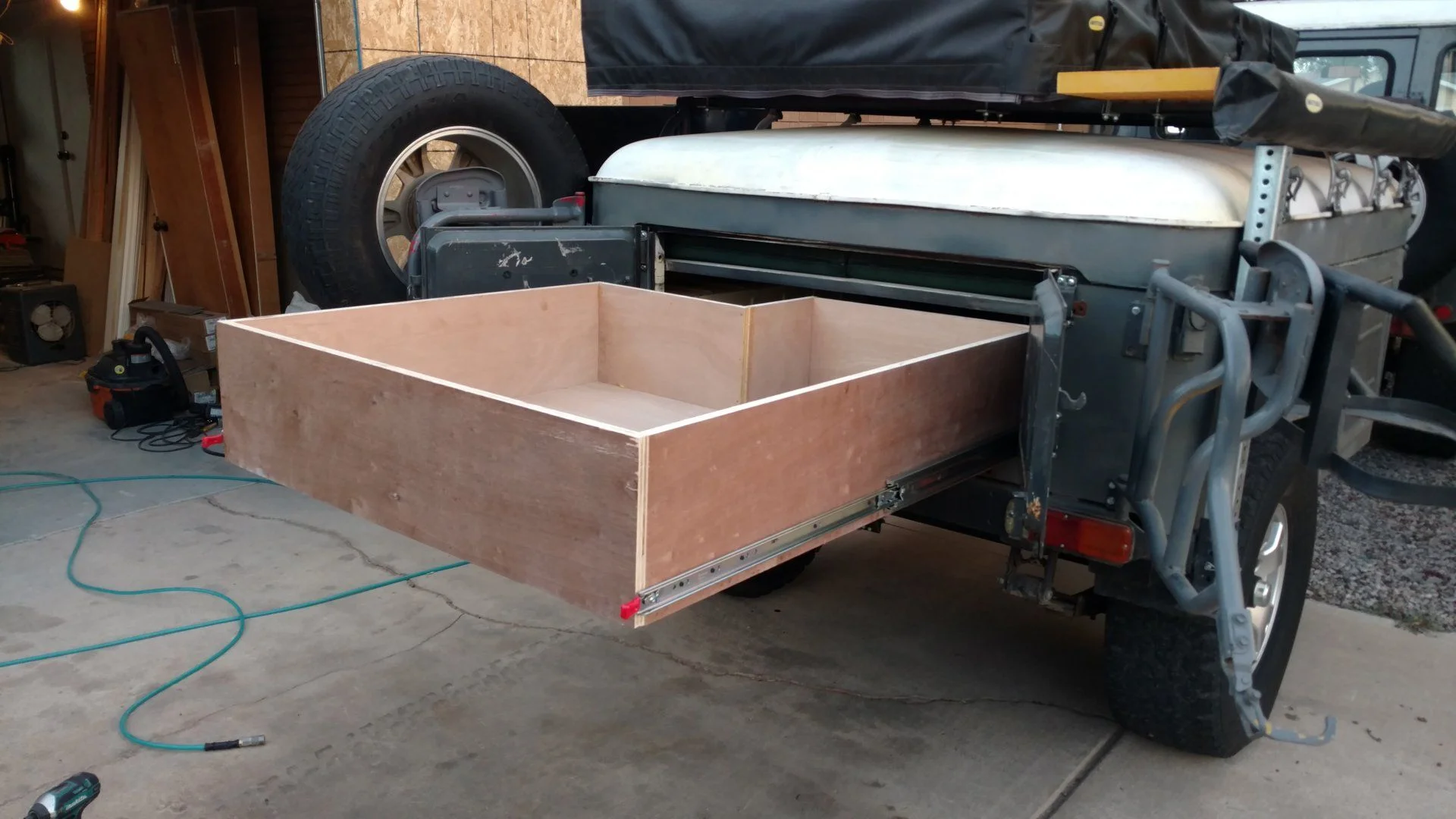

Built a gear drawer for the bed so I could actually get to my stuff. It holds my camp chairs (6), shower, toilet, propane fire, first aid kit, and other misc.

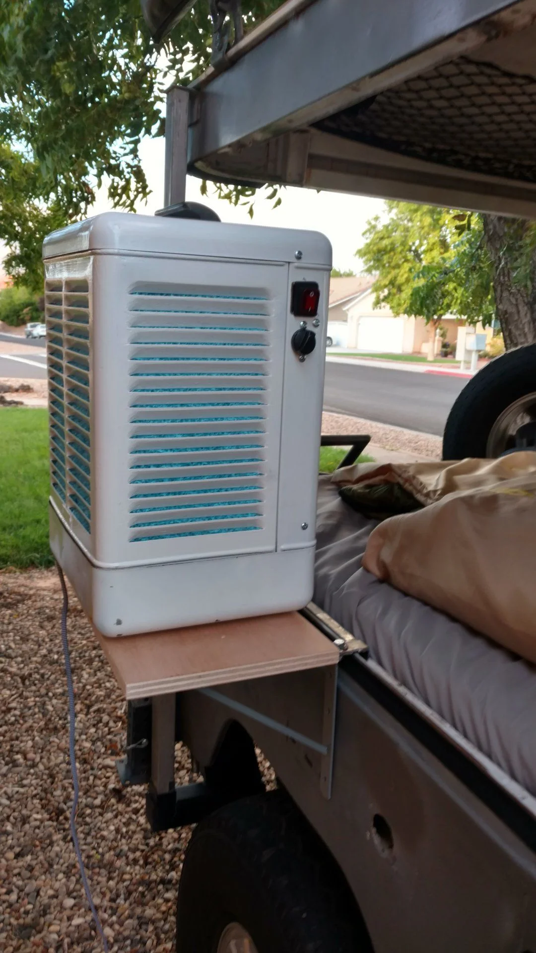

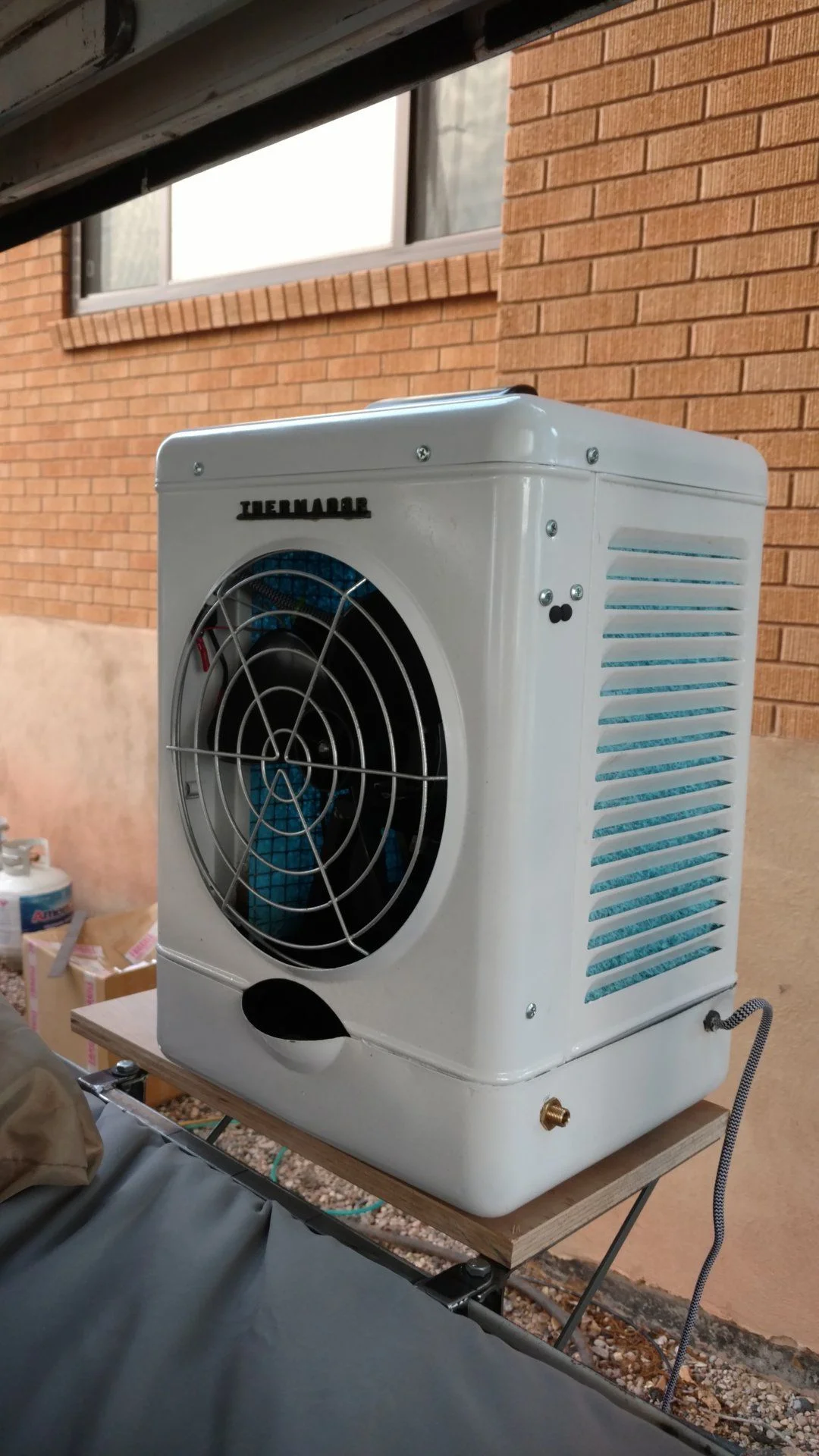

It gets hot in the desert where I live so I restored a vintage mini evaporative cooler to take along. Sits on a colapsible shelf where one of the two doors will be. It drops the temp 20°.

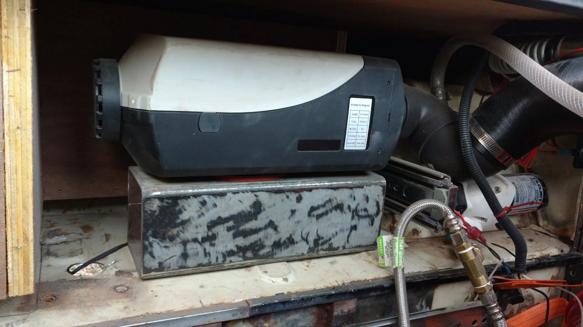

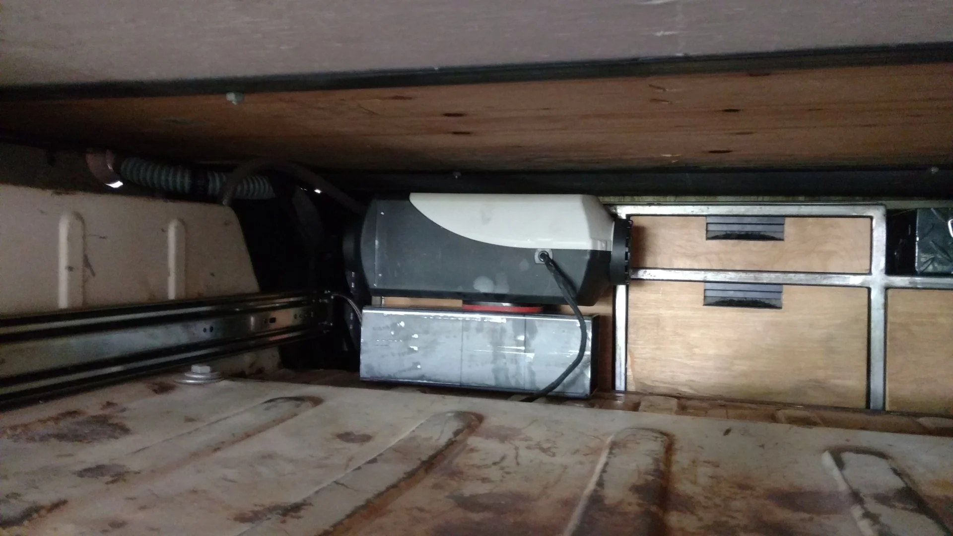

I don't have pictures but where the gear drawer is cut out I installed a diesel heater. It is awesome! Very efficient and quiet. Tested it out the other night. 31° outside. 72° inside. So nice!

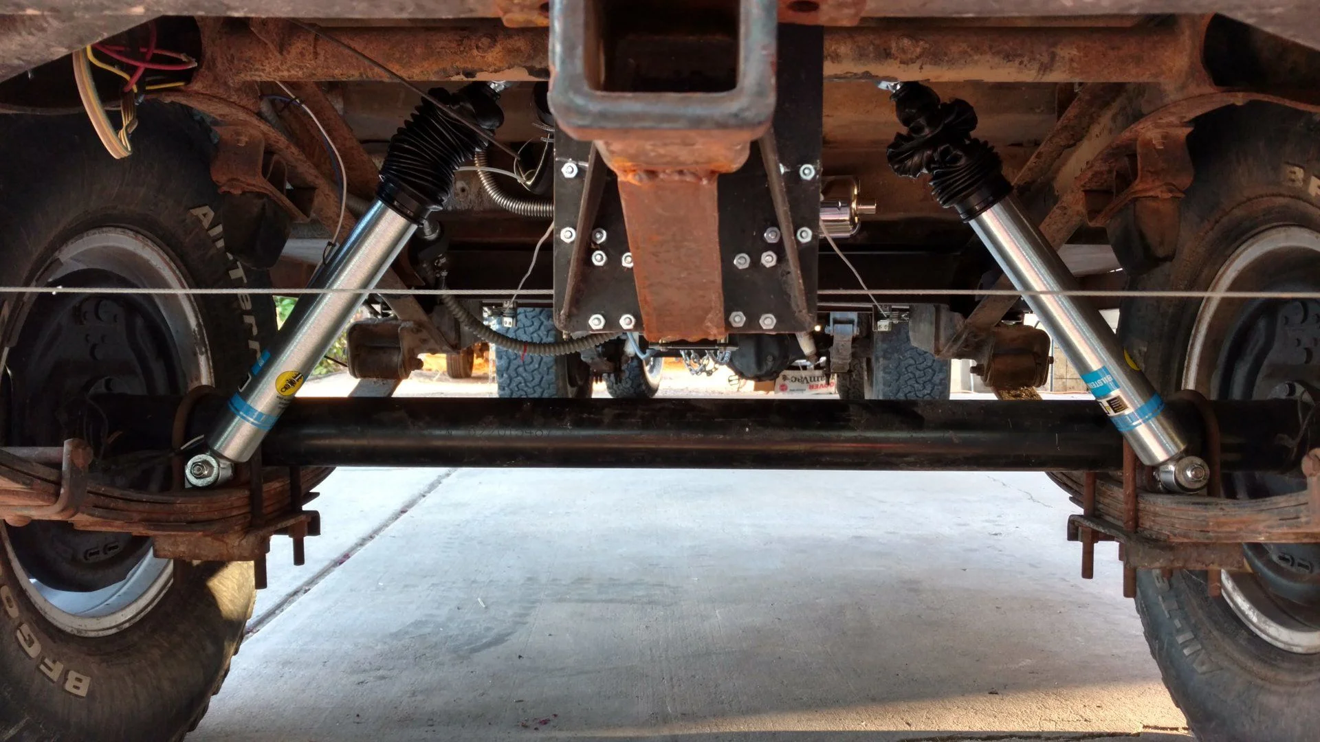

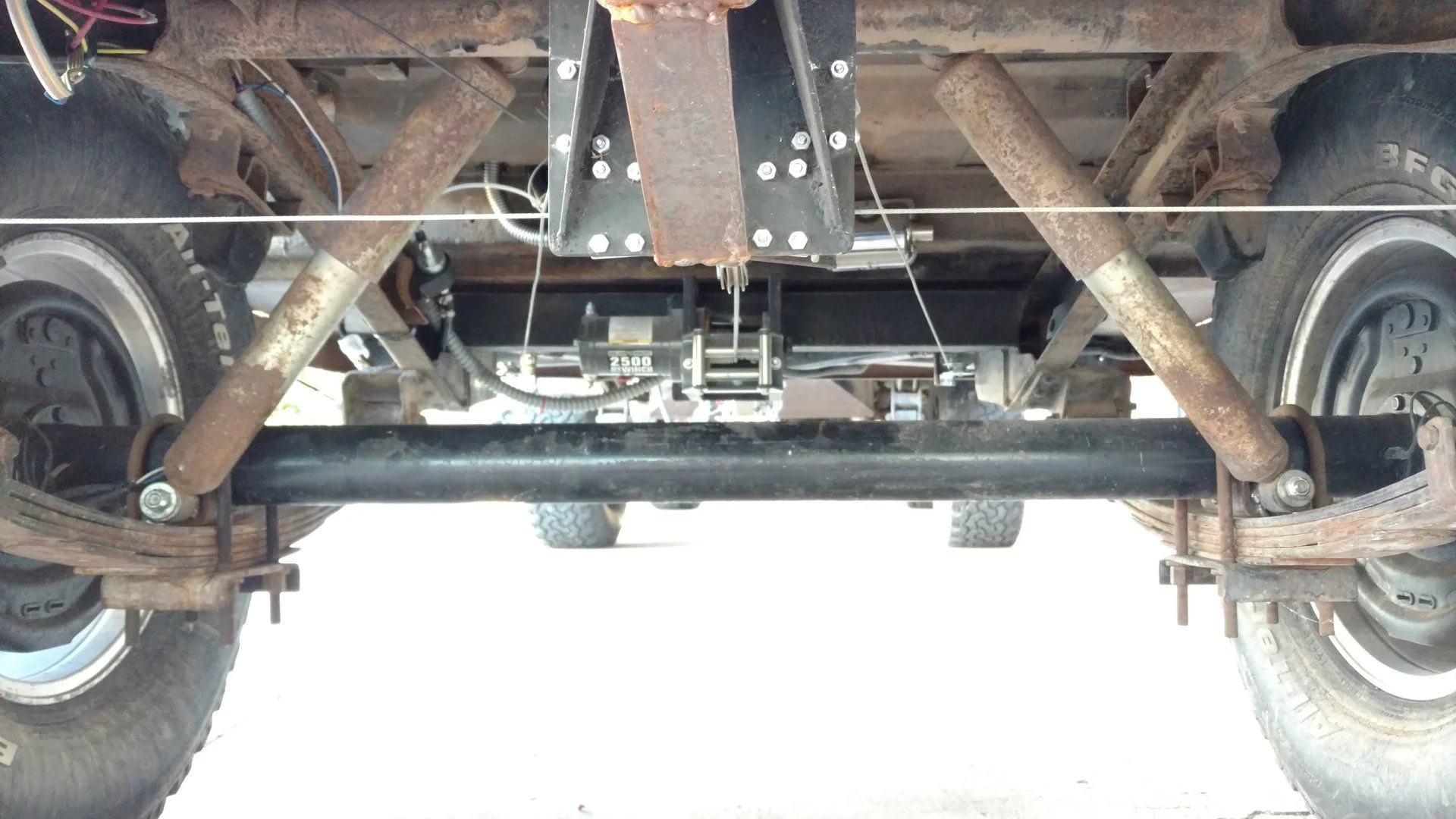

New shocks to replace the originals from 1978

Well, I’m interested in the diesel heater you selected. When you can, post a couple of pics.
The diesel heater is a 5 kilowatt Chinese webasto knockoff. I think I paid $65 on eBay. Puts out plenty of heat. Love it.
