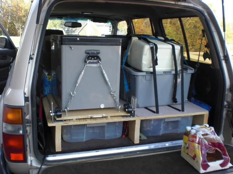

Here's the rear exterior. It is now also missing the rear spoiler.
You'll notice no roof rack. That is because I have a habit of keeping all my gear below the window line, and strapped to the floor. Lightness and simplicity are my goals. No fridge, no extra electrical or electronic stuff. Basic equipment, stripped down.

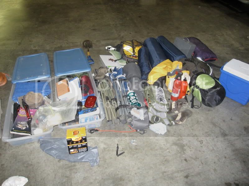

For small bits, tools, etc., I have a homemade cargo organizer. It's fairly light, and easy to install and remove when needed.
This is more than enough gear for two or three, not including large food/drink cooler. The drawers are "under-the-bed" boxes from Target. The top one is for small camping and comfort equipment. The bottom one keeps tools and fluids isolated from the rest of the cargo. The brown box is a full kitchen.
Here's what it looks like full. I also have a 48" hi-lift and all recovery gear stuffed in there, with room for four/five up front. Everything that sits on top of the cargo organizer is lightweight. All the heavy stuff goes down below.
I've also added a Home Depot Cheapo cargo barrier. It won't stop gear from decapitating you in a freeway head-on, but it will stop a tent or a bin from sliding into the passenger compartment on a steep downhill slope with bumps.

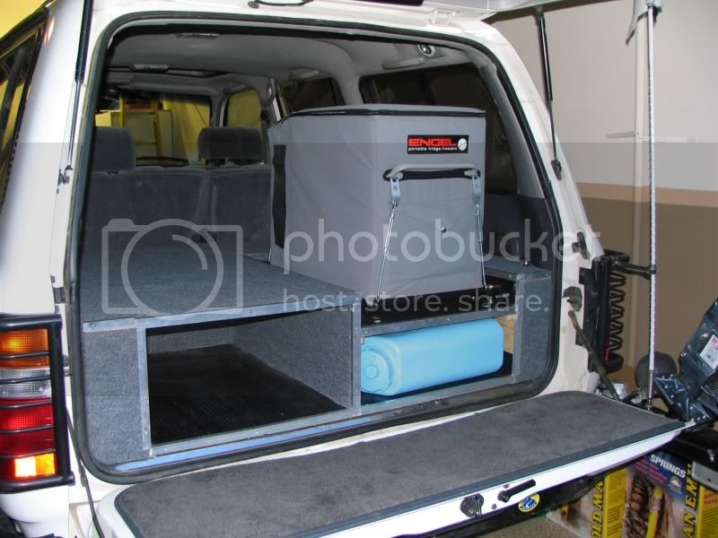

Here are a couple of pics of what I have so far. The things you can't see that have been added are:
On board shower with 5 gallon tank mounted where spare tire used to be.
In cab winch control.
Edgestar fridge/freezer with slide.
LED dome lights + added dome to rear storage area.
Upgraded high and low beams w/Slee wire harness
Jensen double din stereo with NAV, rear camera (second camera waiting for install), HD radio, SAT radio, I-Pod controls.
Dual batteries with hellroaring isolator.
Rear storage (concept from here on mud).
yaesu 8800 ham radio
cobra CB radio
12 volt power outlet added to storage area (for fridge)
RTT that can be switched between my 416 trailer or mounted to the cruiser.
Aussie Locker in the rear
CDL switch

Kenny, nice setup. I just ordered an Edgestar myself and am starting to sketch out a slide for it. Can you post some more detailed pictures of the slide you built. Also your water tank setup too if you got time.

I just switched the slide in the picture to the Engle slide from Slee. The custome slide I made was not as sturdy as the Engle slide. I'm gone this week but maybe GLTHFJ60 can take some pics of the water tank, he his house sitting for us this week.

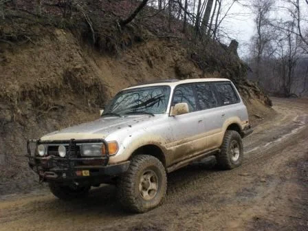

Here is mine, it handles double duty as an expedition rig and my weekend "rock crawler". My sig lists most of the mods
Here are some of the expedition specific items.

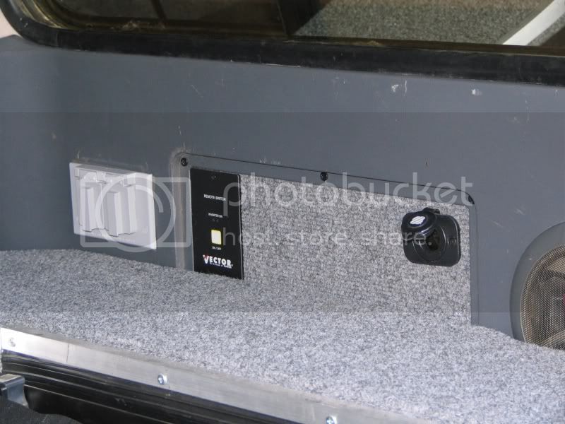

Dual battery sytem w/1200 watt power inverter
Engel fridge on my storage system. Holds 2-20 liter water jugs under the fridge and my tools/spare parts in removable bins on the other side (also holds 2-10 sub woofers for 1800 watt sound system)
Inverter install (and amp for rear door speakers)
Remote on/off switch and outlets for 110v and 12v

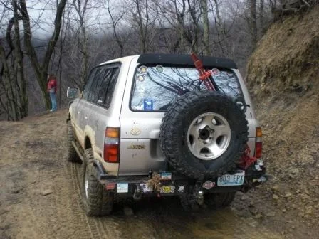

I have a custom fuel can holder on my Slee rear bumper in place of the hi-lift mount.
