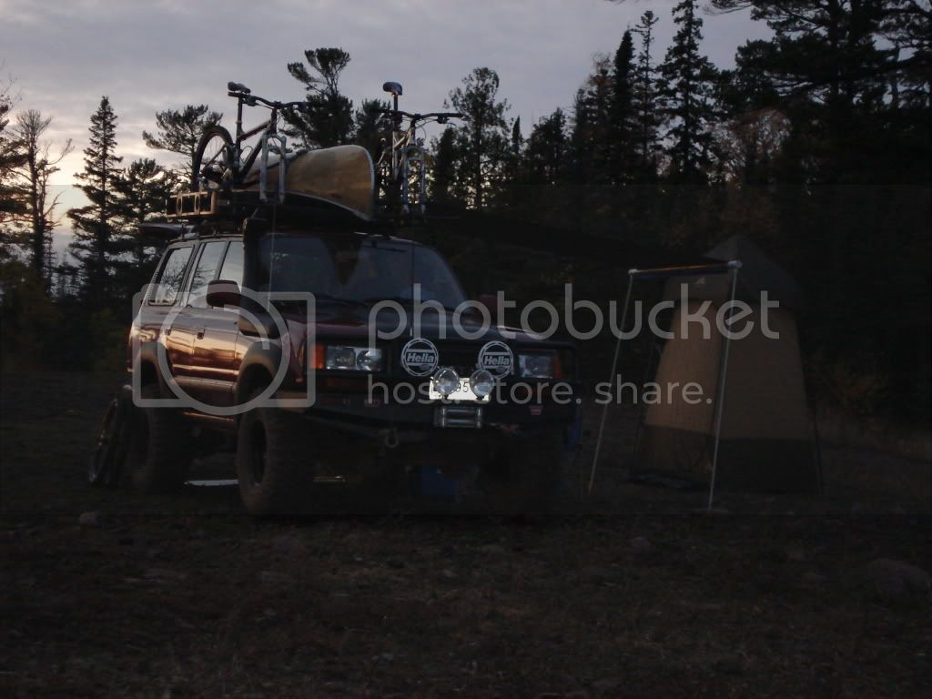

Thats a sweet setup I'd like to hear some of the details on how you have it setup and more pics :D
More pics here of the cruiser and it's specs..
https://forum.ih8mud.com/vehicles-t...31313-adv-duo-expedition-ready-80-series.html
The trailer has the ARB fridge, dual lifeline agm batteries, solar controller, 19 gallons of fresh water, RTT etc etc
SOCALFJ: Have you camped in the cold in that adventure trailer? How is it sleeping so far off the ground in cold weather?
Yeah, never noticed any problems. We've always been warm in that setup. There's two of us and a Boston Terrier, so we have our own heater :D The foam insert that's built into the floor on the tent works well. We usually lay a second wool blanket under our bags before we sleep. That way it adds an additional layer of warmth between us and the elements.
hahaha, is that tent a little outhouse?
Sweet ride upcruiser. I hope to be posting my build soon. Almost completed my 14" coilover front suspension on my LX450. I'm going for excursion theme as-well.
Jodo
Thanks guys, appreciate the kind words. And yeah, it is a bathroom/shower enclosure. I use the PETT toilette system, it works great along with a solar shower which works well in the warmer months. I want to setup a water/heat exchanger off of the truck though in my next rig. I've had this truck 9 years now and am considering moving on to a new project. The next truck is going to be dialed in a bit more since its going to be used on a 12+month trip. :D

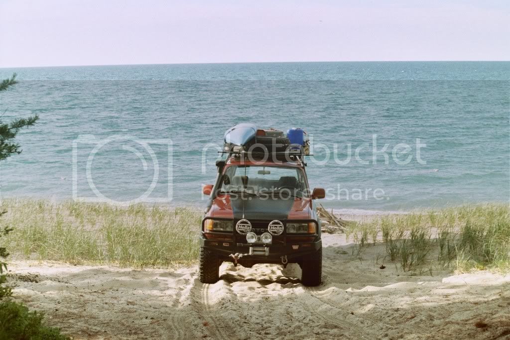

I am building my expo rig on a budget.
Notable Mods that make my time in nature more enjoyable:
• OEM Rear Ladder from MOT in Japan (easier access to roof rack)
• Conferr Roof Rack 4’x7’, with mounted shovel and hi-lift. chicken coop flooring for durability and weight savings.
• 3” OME Suspension Lift 850J/863 L shocks (J springs front, HD rears)
• OME Steering Stabilizer
• 295/75/16 Nitto Terra Grapplers AT
• OME Castor Correction Bushings
• Portable Uniden CB Radio wit Lil Wilson Mag Mount Antenna (for when I need it)
• Power Points-2 front center console, 2 rear cab (to power electronics like my air mattress, gps, and laptop)
• Dome and Courtesy LEDs (in case I leave the door ajar all night)
• Slee Transfer Skid Plate
• Low Cost Storage
• Frame to Axle SS brake lines
• Reduced length of Rear Mud Flaps (so I don't loose them when backing up and getting them caught on the tire)
• Raised Differential breather hoses
• Fire Extinguisher
• 2 Work Utility Lights in Rear
• 4xinnovations custom bolt on sliders
• 2 Fuse Blocks (1 in cab, 1 in engine bay)
• Garmin eTrex Vista GPS with Laptop Mount
• HIR Light Bulbs (Highs & Lows Beams)
• Custom Rear Tire Carrier on OEM Bumper
• ARB Bull Bar
• HID Auxiliary Lights on ARB Bumper
• Limb Risers
• SUV Canopy (busdepot.com)
