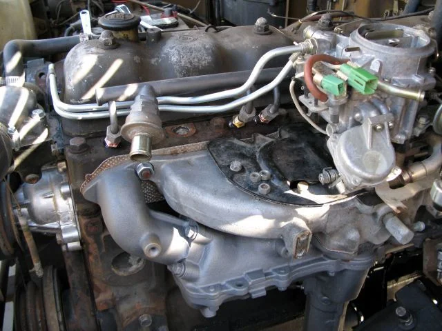

Ceramic coating would be awesome but expensive. I rebuilt mine two years ago and sandblasted the exhaust manifold and bead blasted the intake manifold. I left the intake bare but used CALYX on the exhaust manifold. It has held up well for a few thousand miles. I thought it still looked great until I went and took this picture. Then I realized it doesn't look as good as I thought.
The beauty part of CALYX is that it wipes on like grease. I can put more on it now that I know it needs it but I don't have to tear it down and reblast.
