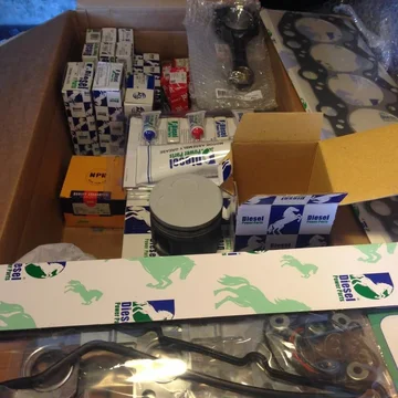

Just got off the phone with Engine Australia again trying to order my rebuild kit, they were working so hard to convince me of the pitfalls of not upgrading the con rods that I decided to just bag it for today. I don't doubt the merits of a stronger bottom end, but he made it sound ludicrous not too...I know, they're in the business to sell product, but still. Sigh. Guess I'm waiting another week to save up some more. :censor:
Minor update, I finally got all my ducks in a row and got a few things ordered last week. To my amazement, the rebuild kit arrived on Friday! To think that it shipped out on Wednesday from Australia and arrived that quickly...The world has become so small.
It was a bit like Christmas opening things up, until I realized that a few mandatory items I had talked to Engine Australia about didn't make it into the final order. So among a handful of other miscellaneous items, I'll be ordering freeze plugs, piston bushings and gudgeon pins this week. Really surprised the pins and bushings didn't come with the kit considering the new con rods... Hopefully that doesn't hold up the machine shop much as I'm sure they're ready to be done storing my block.
As for the turbo argument, as you can see from the photo, I gave in and opted for the upgraded con rods. With so much going into this build anyway, the cost seems worth the reassurance. I opted for the basic level Grunter turbo kit (designed for around 15 psi) from Graeme since I'm not planning on intercooling any time soon. I think it should mate nicely to the internal upgrades I have in the works. Hopefully I have more to share soon as things get moving again.
That's a nice box of parts right there, must be very exciting!
