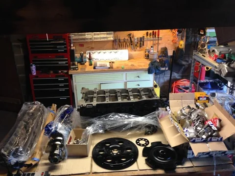

Alright, we're back on track. Picked up everything from the machine shop on Friday afternoon after they convinced me at the last minute that it was worth having everything balanced. At some point they had deemed it necessary to balance the rods and pistons (I'm not really sure I know how that works for something without an axis like a crankshaft) since they were so far out of balance so it wasn't much more to have them do everything else.
Now I have an entire weekend to start re-assembling and naturally this means more questions. There isn't a real clear guide to the turbo install, but I've managed to figure out for the most part what needs to be done. My question is more of a confirmation for the oil return line. I know there are two options for this, the first is a return into the oil pan, the second being into the block. Since everything is apart and no risk of metal filings in unwanted places, I figure I should go into the block. So, just to confirm with my upside down photo, the boss that I'm pointing at is the return location and the two to the right are for the turbo stay which also need to be tapped. This makes sense looking at it's location relating to the turbo and looking at the manual, but it's worth asking. The two holes for the support bracket will wait til the turbo is on so the holes are in the right spot, but is there anything I should know before I tap the oil return line?

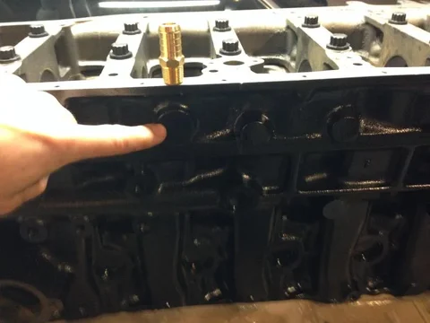

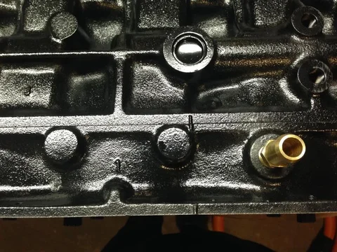

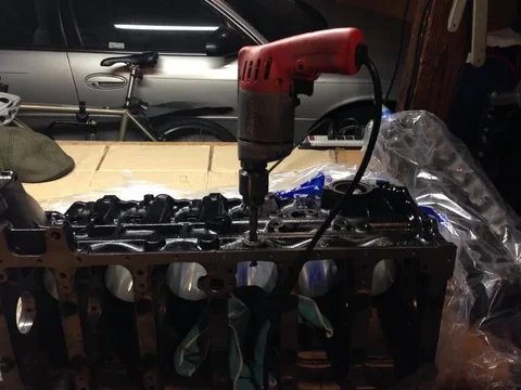

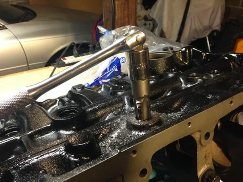

I figured that the best thing to start with was drilling and tapping the block, which meant driving around town for half a day to find the right sized tap. I could've done this sooner, but I guess I've been putting it off because it's kind of terrifying to intentionally put a drill to your block.
It's probably not advisable to go freehand like this, but I did actually rig up some rafter squares into a jig to keep things in alignment and had my girlfriend provide another pair of eyes.
And it fits! Anybody know if there are cheaper alternatives to Loctite 545 hydraulic sealant? Is it really necessary to use that one?
The holes for the stay need to be tapped still, but as these don't go through the block, these can wait til the stay is in place so I can get a precise location for the holes anyway.

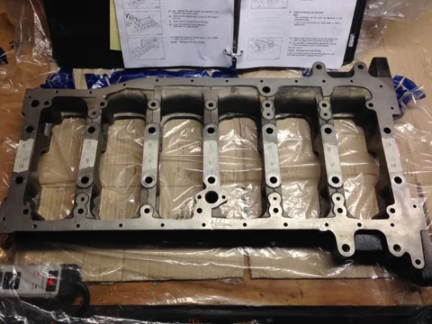

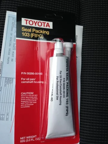

I'd intended to set the crankshaft this weekend too, but it never dawned on me that the FIPG I had in the drawer that wasn't Toyota OEM might not be sufficient until I was reading through the manual and they specifically call out for their sealant. Fortunately the dealerships have plenty of this stuff so a quick trip over takes care of it-- but can someone honestly tell me why this is better than something by Permatex?

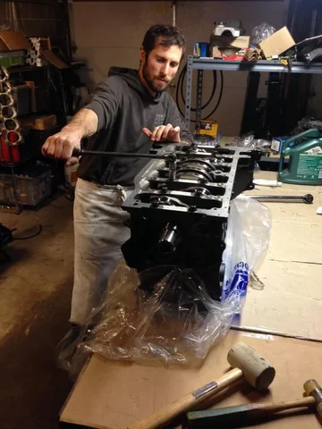

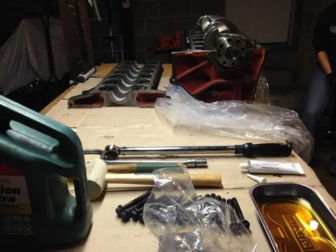

I'll be trying to get through at least one small project per evening, so tonight's chore was to get the crankshaft set and torqued into place. I'd already cleaned everything over the weekend so it was just a little prep making sure everything was in order, mentally walking through the steps so I don't have something out of reach when I need it most. I'm sure once you've done one build it's a little less intense, but right now I'd say when FIPG is involved, it feels a lot like doing glue ups on furniture!
I picked up this trick from Kevin R.'s build thread, though it's so logical I'm sure many people do it this way.
After helping me get everything in place, I made my girlfriend hang out and make sure I didn't miss a number while I was counting out loud going through round after round of evenly torquing. So she made herself useful with some action shots.
And the finished product for today. Everything spins smoothly still so I guess that's success. I'll get it on the stand tomorrow and maybe start attaching some of the external gears like Jan suggested, but it should only be another day or so before the rings come in anyway.

No idea if the toyota glue is better than permatex. It was not worth wasting time on that for me...

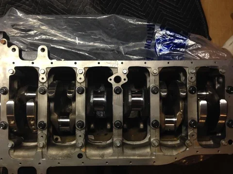

Has the crank been ground undersize and if so by what amount..... also if so, did the machine shop mention anything about the crank being nitrided from factory.... by the wide "join line" on the crank shown in one of your crankshaft pics, they appear to be a forged unit....
The crank had some surface checks so it was ground to .25 o/s. The shop didn't say anything about nitriding but I have to assume it's okay to machine since the FSM tells you to. Not sure what join line you're referring to.
The second pic in post #79... you can see a wide ridge running along the non machined part of the crank.... usually looks like someone took a grinder to it. That WIDE line indicates a forged crank ( it does in sb chevs anyway)... my understanding is it's where excess material from the forging process is ground off during manufacture......
On the nitriding... just because factory has under size bearings available ((0.25mm (about .010 inch) in your case) doesn't mean the crank isn't nitrided. It could just mean your crank hasn't got a hardened surface finish any more... :cool:
