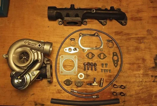

Not a lot of progress lately, I'm mostly just waiting on the machine shop at this point. We had a "snow storm" last week that pretty much shut the city down for several days so that set things back a bit, or so I'm told by the shop. Coming from Alaska, it's still pretty amusing that 6" of snow over two days could shut a major city down for something like 5 days.
Anyways, I've kept busy cleaning parts I'll reuse and ordering all of the miscellaneous bolts, belts and water piping that didn't come in the rebuild kit that I need to replace to baseline (and for the bulletproof factor). A big shout out to Akella for helping me navigate the process and track down part numbers for everything. I also received my turbo kit from Graeme last week. :D If anyone was wondering about a more specific parts list he includes in his kits, this is what it looks like.
Since I'm new to the turbo world, can anyone verify if I can use the standard turbo outlet elbow that's used for the 1HD-T? It's one of the only parts I haven't ordered because I thought it might come with Graeme's kit for some reason. I did manage to track down the thread below discussing some alternatives to the Toyota part-- has there been any further thought on this by anyone? I should mention that I'm keeping what I can of my current (2 1/2"? I can't remember...) exhaust system since it's practically new and I need to give the bank account some recovery time (rebuild kit + turbo + machining + misc parts = :eek:).

I've used my standard outlet for the turbo (from a 1HDT originally) and have no problems with cooling or spooling up a grunter 2 on a 1HDFT engine. A 3 inch exhaust would be nice, but I do not view it as essential at this time.

Thanks Jan, I'll keep moving forward and assume I'll just need to grab one of these at some point soon. My understanding of 3 inch is similar, maybe necessary if I was trying to intercool and extract the most out of this engine, but that's not the case here. I've also heard anecdotal stories that going that big on the HZ can also work against you depending on your setup by providing too much flow. Don't hold me to that though, the internet is vast and only 10% of it is accurate at best...
