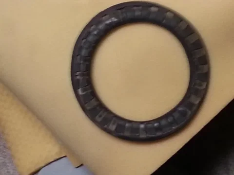

it's not attached to anything, just a floppy rubber washer that sits on top of the coil to prevent metal on metal. Who installed your OME lift?
Ok thanks. I'll have to look into that and see if they are still there. The lift was installed prior to me buying it so it's hard to say without tearing into it. The po seemed very meticulous though.
