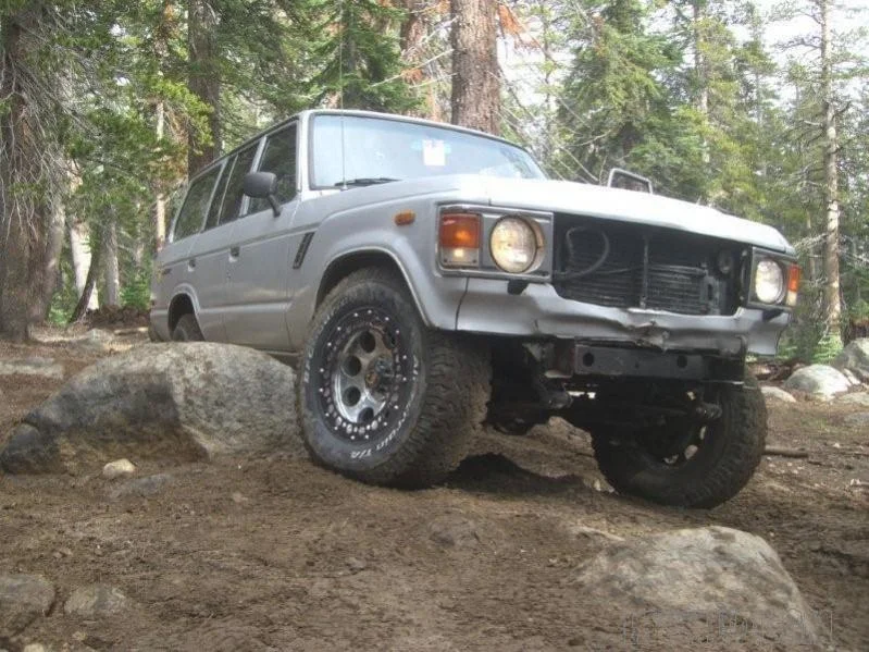

Let the build begin... it is official. Aside from rims and tires a few months back the first official mod will be a Saginaw pump! About 10 years ago I built a fine specimen of a vehicle (below in blue) and named it Sally, before her I had another quite similar truck named "Flo". I always loved that name for my truck, but thought I could ever name another truck the same as a previous (the FJ60 is my 35th!), but I am going to bend my own rule and I am pretty set on keeping this one for a while... so everybody meet Flo (in silver)...

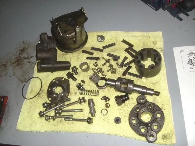

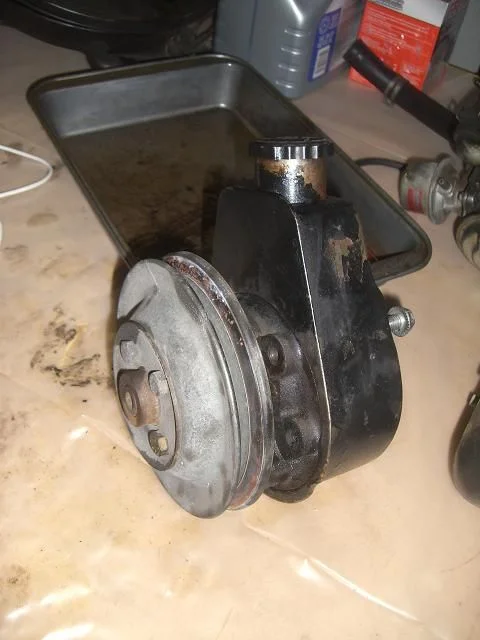

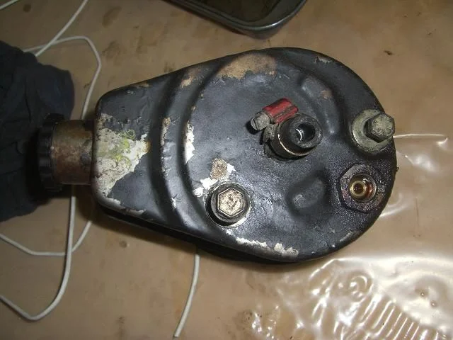

So thats my big dream. Now for reality. I have a DD that doesn't do that very well right now. First project is a SAG pump upgrade. Why? Well I took apart my fluid spewing stock steering pump (top pic, nice jack-in-the-box effect when i pulled the shaft from the body, didnt see that coming) and found the bushing to be worn bad in the front and rear caps, so I tapped them out. After a call to CDan I learned that those are not replaceable parts and $370 (new pump) would get me on the road again! I had been reading about the SAG swap and $35 at PnP (bottom pic) fit my budget much better. Found an early 80's Volvo 244DL with 118k on the odometer that had my new pump. Brought it home and now I am ready to fab the bracket. Found several good posts and still haven't made my mind up exactly how I will do it yet... What is cool though is it has the exact same pressure fitting as the LC, flair and threads worked perfect, and the pulley is the right width and diameter!

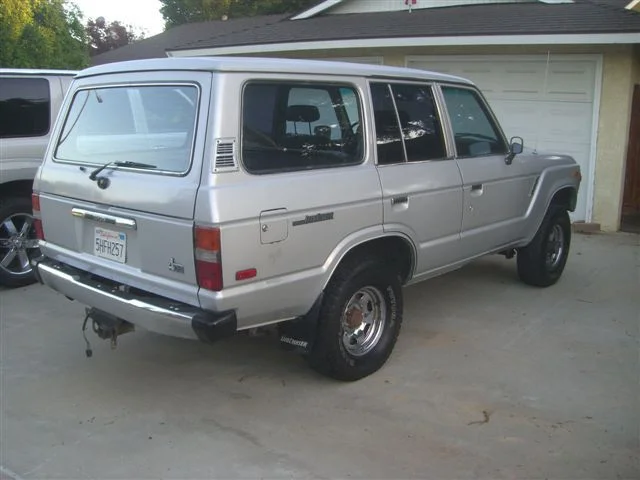

Here is Flo the day I brought her home with 256k on the ODO... Paid $1200!
what those shoes on Flo?
...um, what are the wheel type (size also). thx
yeah she was hit hard up front before i got her. i have a whole stack of paperwork. In the last 40k shes had:
Top end rebuild
Bottom end rebuild
Paint (not the best, but it will do)
New driver side window regulator
Wheels are 17" Pro Comp 1079 with the simulated bead lock. Tires are 285/70/17. it looked real good when i got them on but i made a left hand U-turn and had a horrid noise as my drag link end ground down the inside lip of the passenger side rim... 17" is not enough to clear it. So i am running 1.25" spacers up front and 1.5" spacers in the rear and everything is grind free!
