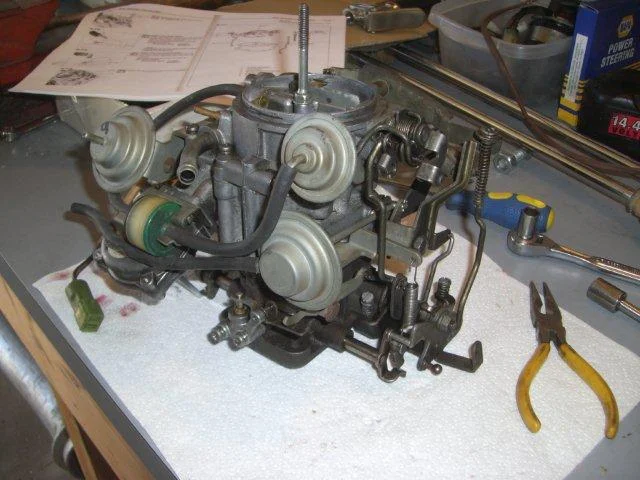

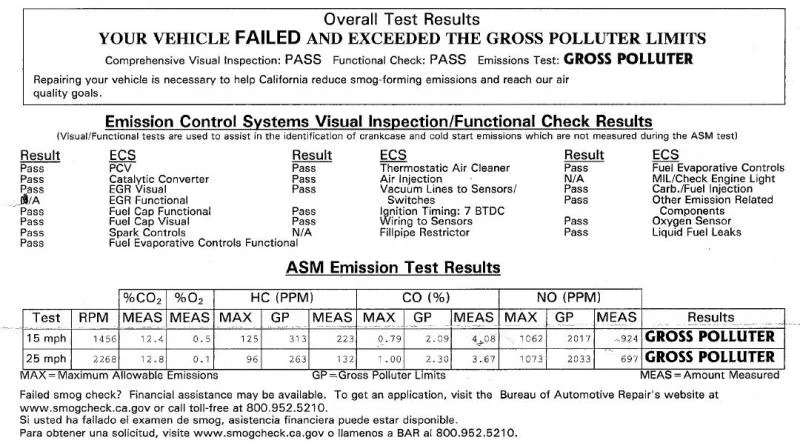

Found my carb problem!

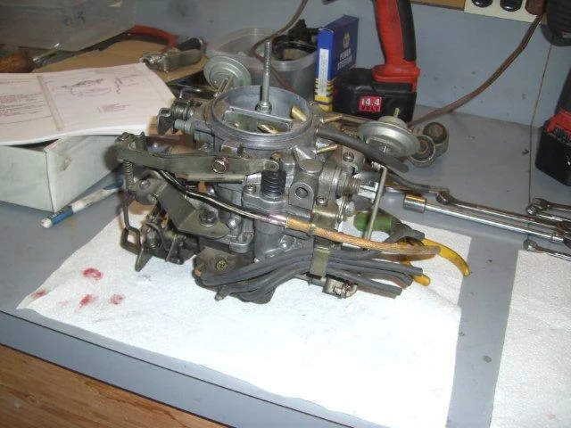

Got to putting the carb back together and the step in the FSM that calls for installing the Main jets. I hadn't seen those hiding in there so i pulled them and cleaned them. Saw the difference in numbers and the FSM didnt state anything but the color difference. So i logged onto MUD and presto, my mains, secondaries, and small venturies were all backwards. No wonder my smog registered so dang high! The said i was running about 4x too much gas through the carb and my mechanic agreed. Her is the pic i took after pulling the top of the carb off on the begining. Backwards! Thanks to all the help on this thread: https://forum.ih8mud.com/60-series-wagons/116760-venturi-color.html and https://forum.ih8mud.com/60-series-wagons/69239-slow-jets.html.
Finished Carb
Here is the finished carb, new parts, jets in proper places, all, vacuum parts tested and the electric solenoid functioning. I will get it on tomorrow and then its a new Cat and tune up (by a pro to dial it in... !

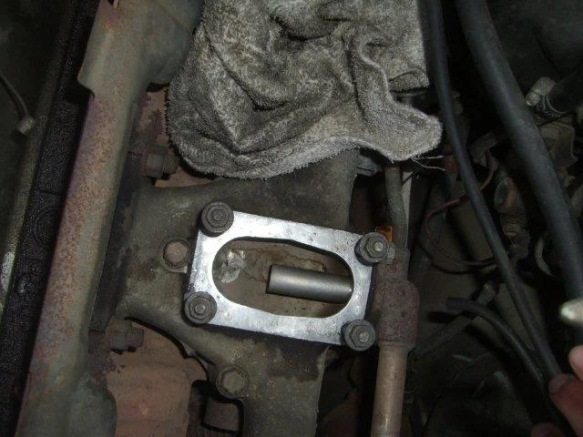

Intake Manifold Issue?

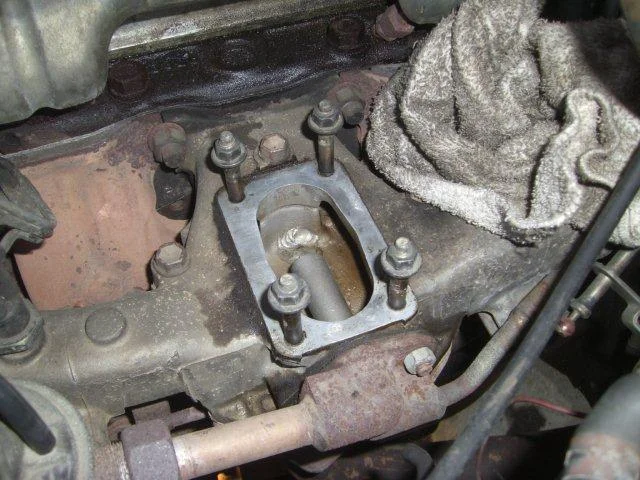

This doesn't look right, anyone else agree?
Your intake looks funny because at some point during its life, a crack developed in the bottom of the plenum. Somewhat common, the fix is to have someone weld it back together. Your intake had that crack develop and it looks funny because it was welded up.

Thanks for the info GLTHFJ60, I wanted to make sure it was a common issue!

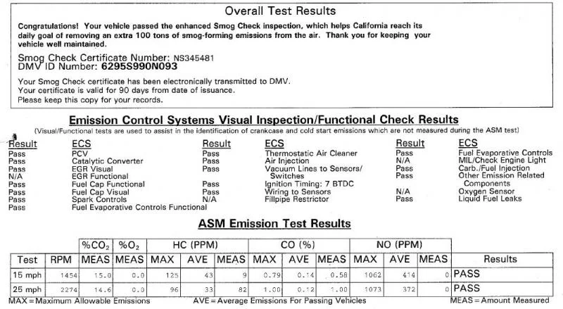

I passed smog!!!!!!!!
Saturday was a great day, she is finally legal!
Bad Fail:

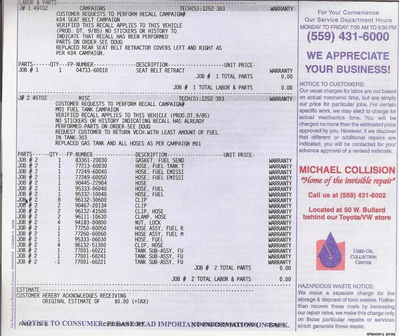

-I am all ligned up for two recall fixes at Toyota! Replacing both the rear belts and gas tank. Parts are in i just need to get the Alt in so i can drive it over.

That said, i picked Flo up from Michael Toyota last friday with her recalls done! Didn't cost a dime and i got a sweet new tank (lines, gaskets, clamps, etc.) and the rear seatbelt retractor fix, they added a half retractor sleve that almost comes all the way through the seat cushions. Works good so far, pictures coming. Below is what they did, the list of parts and the cost:
