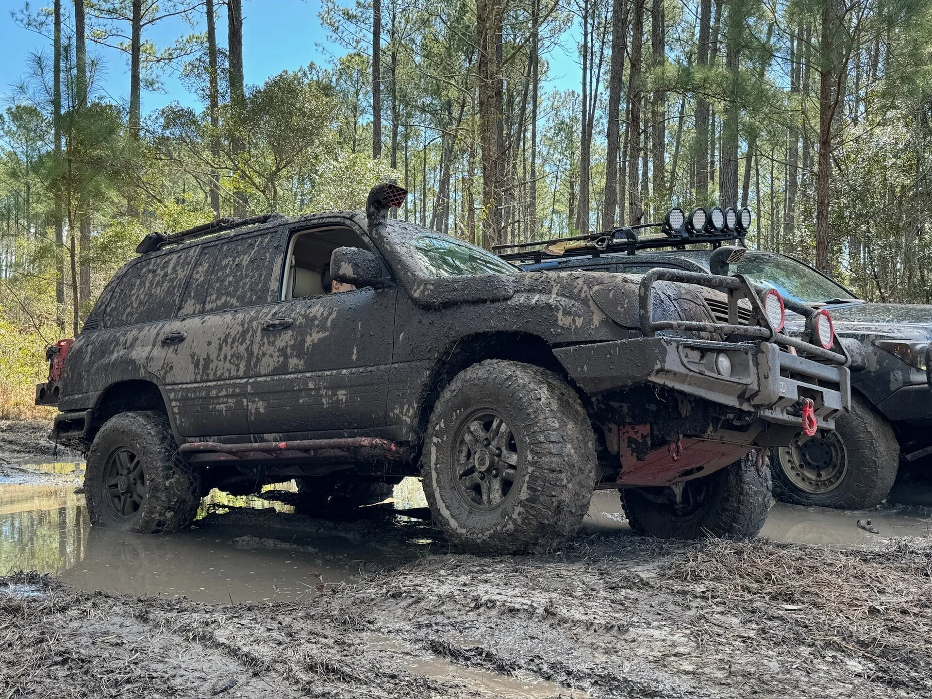

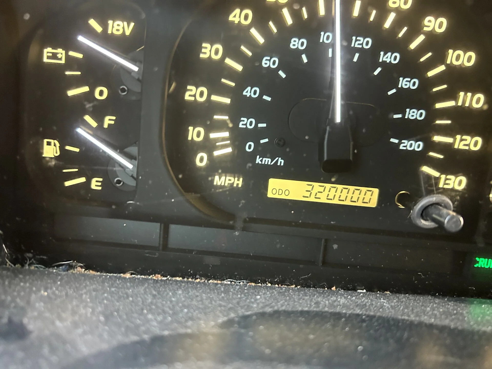

Maintenance by the book, CVs every couple years, and a new rack once over the 320k life so far. I also kill my brakes by packing them with mud. That is pricey, but that is on me.
