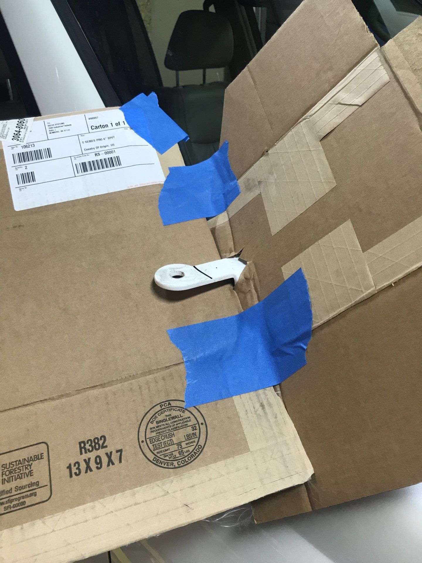

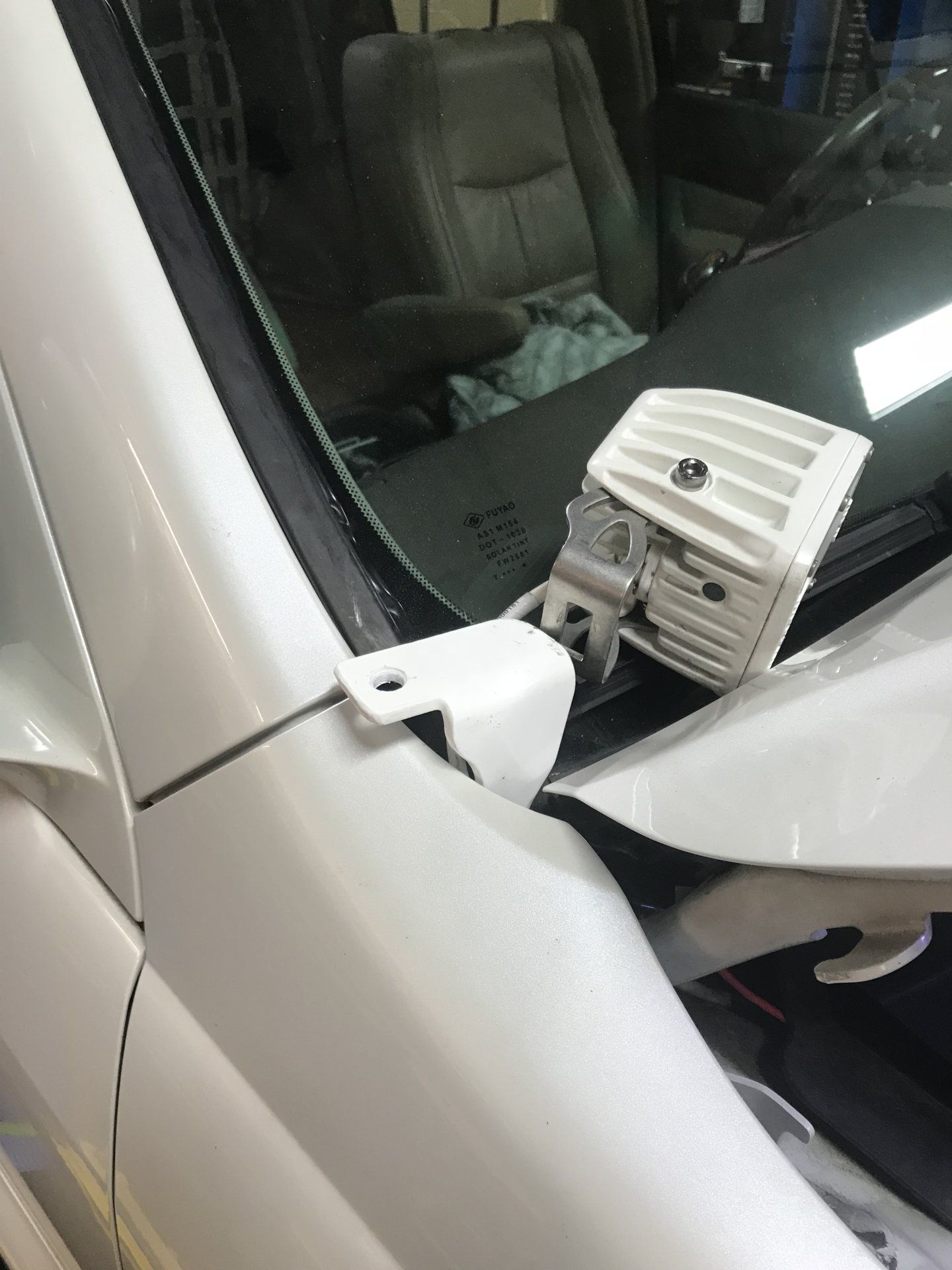

To prepare for the snorkel we had to trim one of our CBI ditch light brackets.

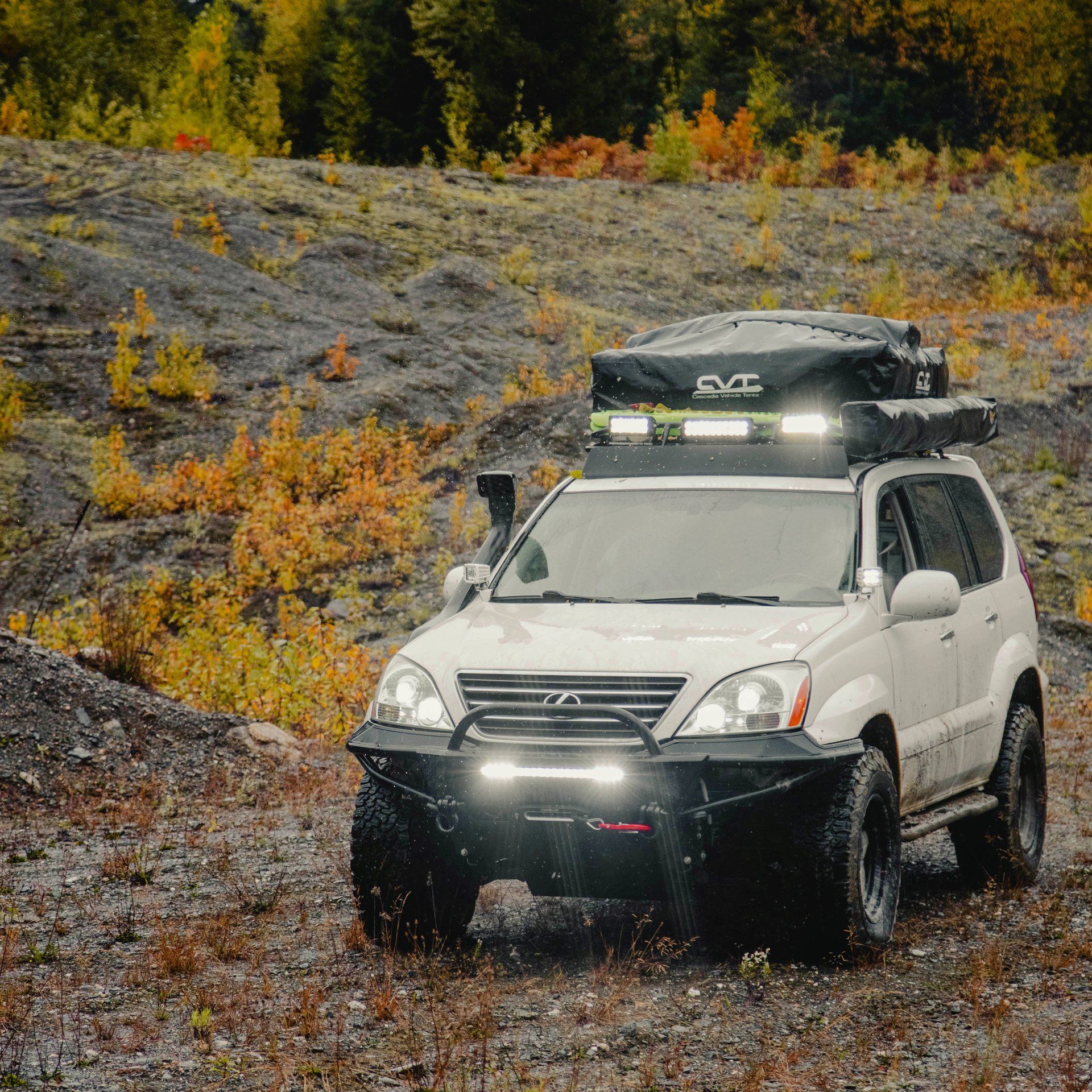

We stepped up our lighting game with two Rigid 6” E-series Pro spots on the roof rack and a Rigid 20” SR-series spot/flood mounted in the bumper. We know Rigids are pricey but we’ve used them on many different cars, truck and boats to become believers in their products.

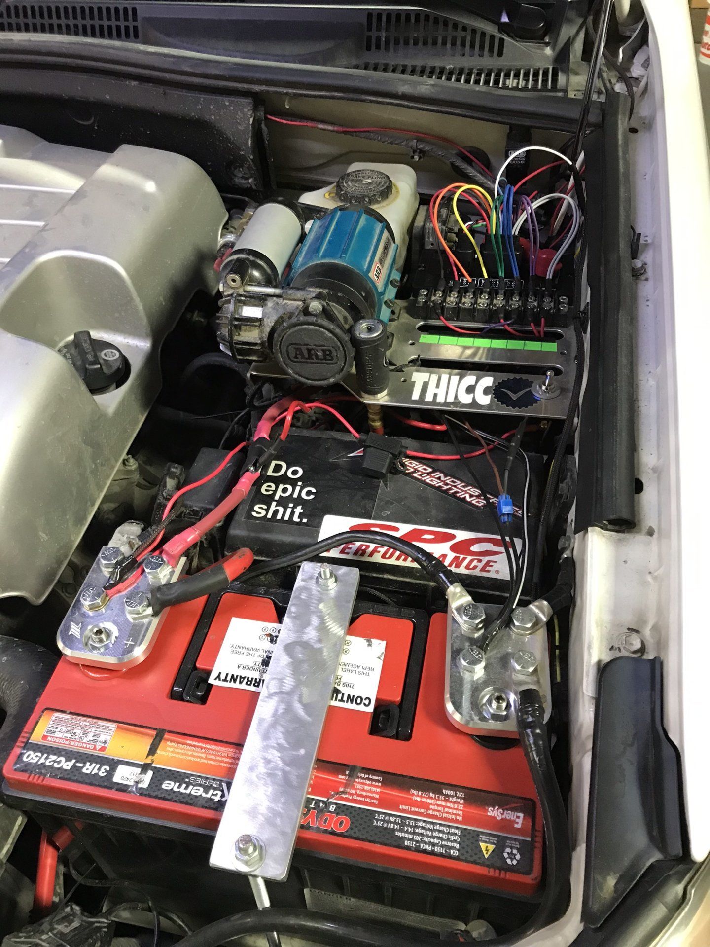

Trucks can’t run without electricity.
We swapped out our old tired battery for an Odyssey group 31, added a homemade aluminum battery tie down, Xplicit Audio battery terminals, and tried to clean things up.
** Side note: we were having some glitch issues with our Switch Pros 8100. Their customer service was amazing and when I was not able to troubleshoot the problem myself I sent the unit back to them. After a year and a half of using the 8100 it had a bad internal ground. They sent us a new 9100 as a warranty replacement. SwitchPros makes an amazing product and they stand by it. I cant say enough good things about them.

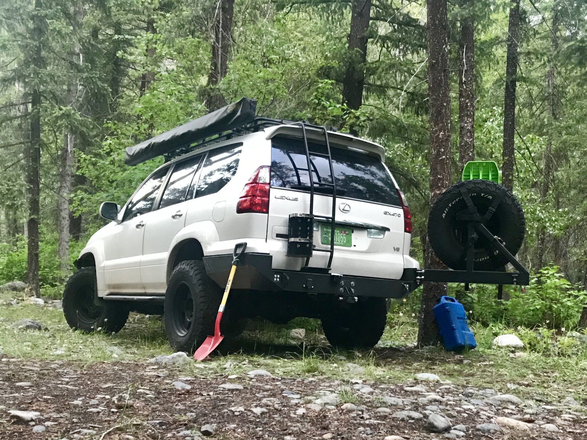

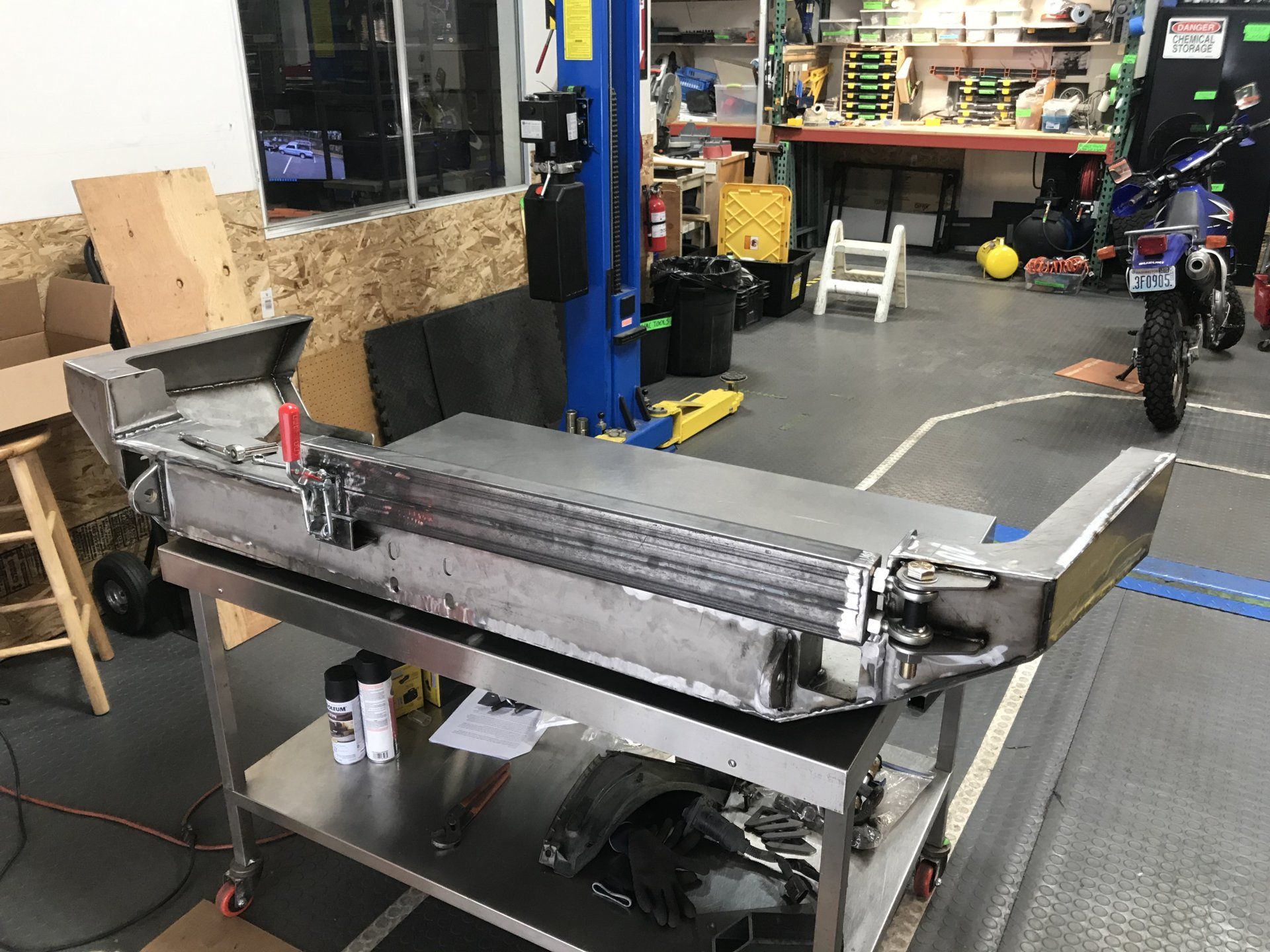

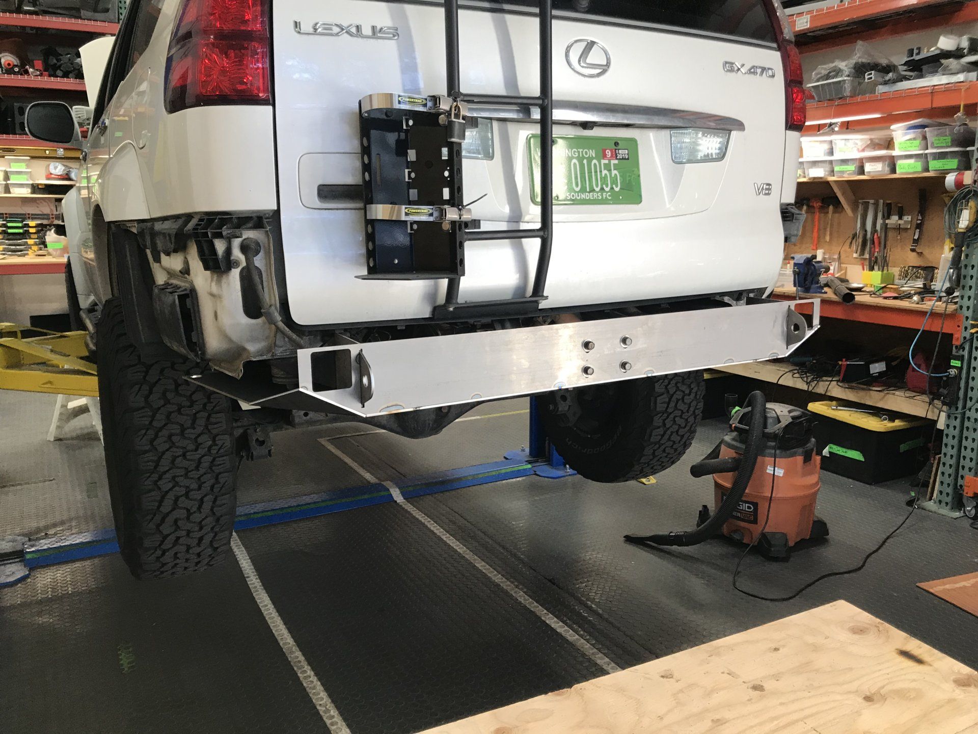

Coast Offroad single swing out rear bumper:
This weld together kit took us about 3-4 days total of welding, grinding and painting. It was a fun project and if you’re willing to put in the time and work it’s a great cost effective rear bumper/Tire carrier solution. Brandon, the owner of Coastal has awes customer service also.

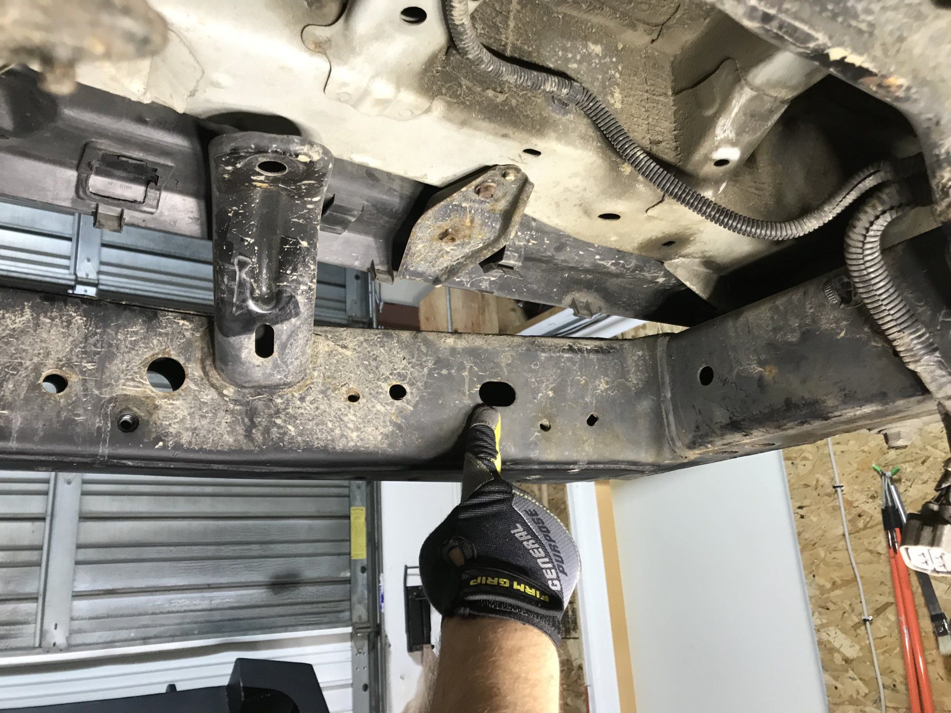

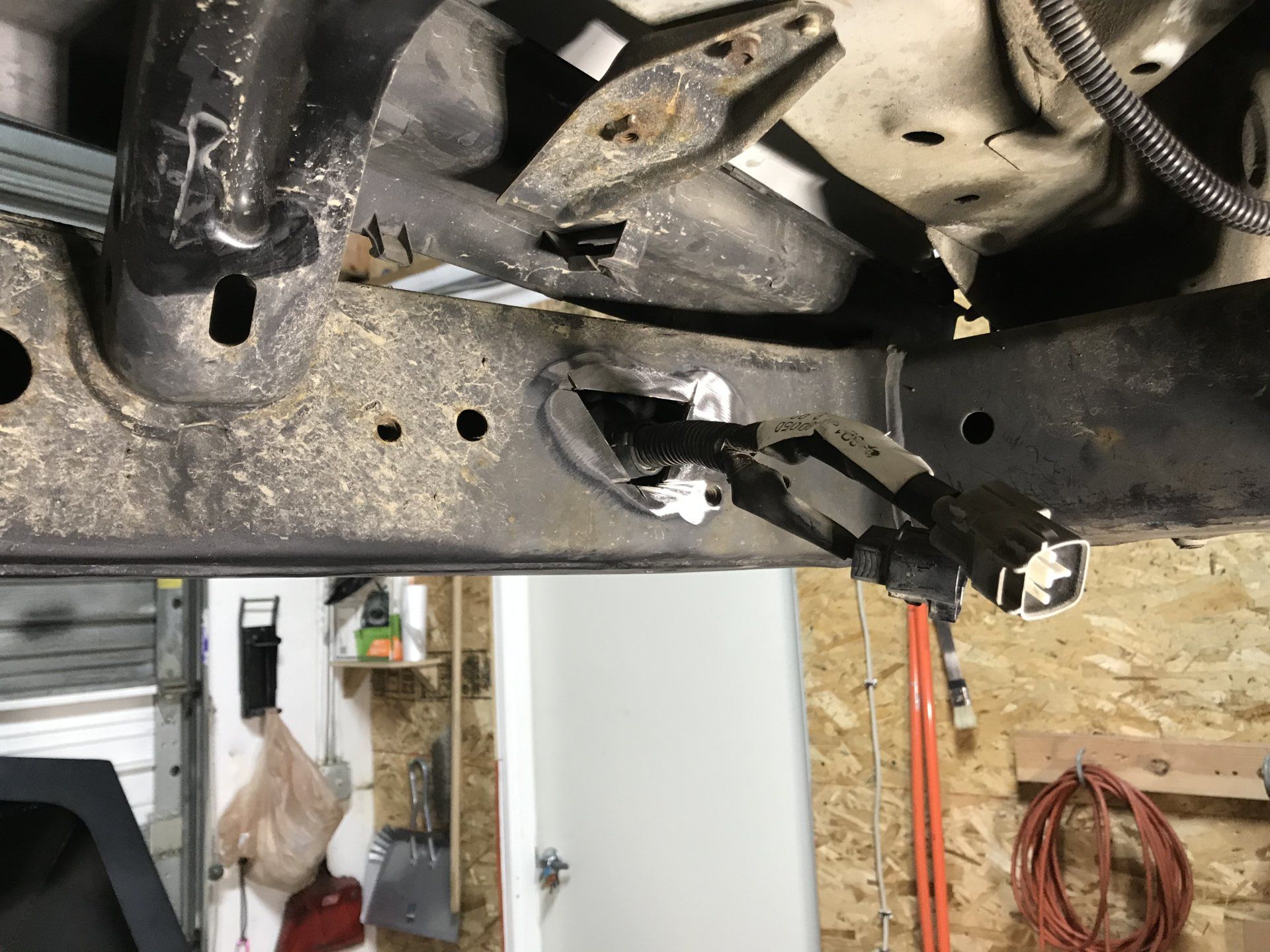

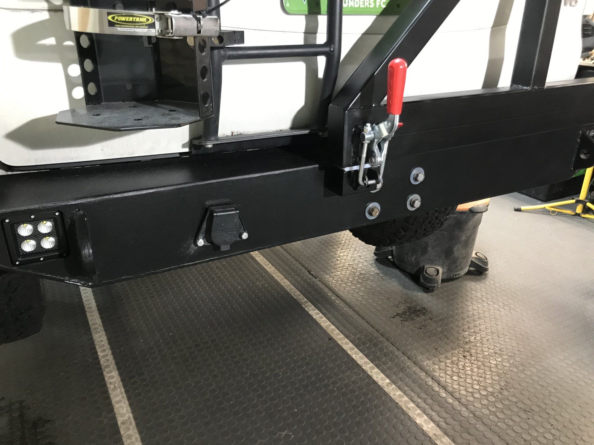

Relocating the trailer wiring plug:
The Coastal Offroad bumper gives us an amazing departure angle so we didn’t want the trailer wiring to be the lowest piece to get ripped off on the trail. Lining up an existing hole in the rear frame, drilling it bigger and puking a hole in the new bumper made it all better.
