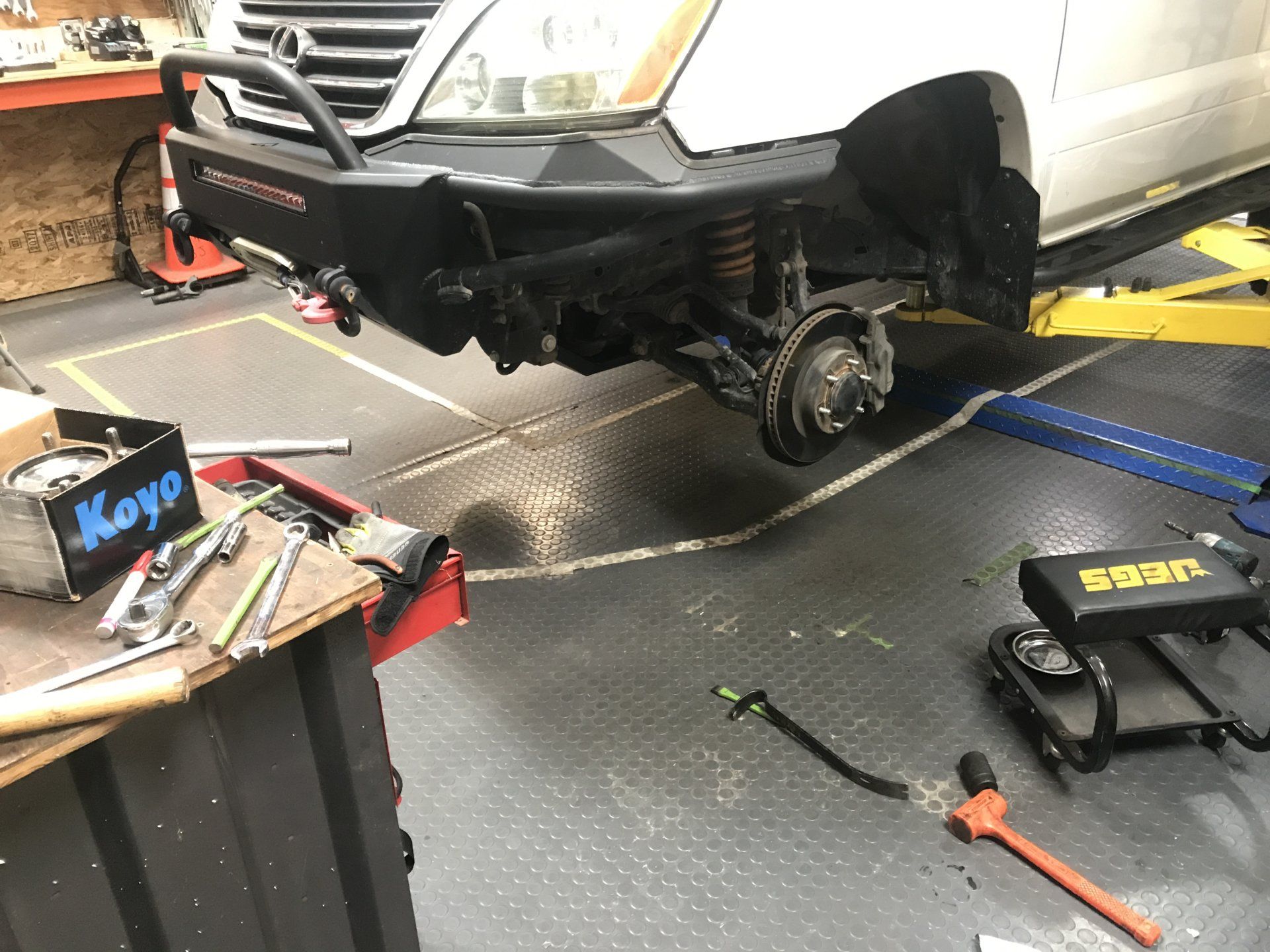

A new set of BluePit wheel bearing were in need when we got home.

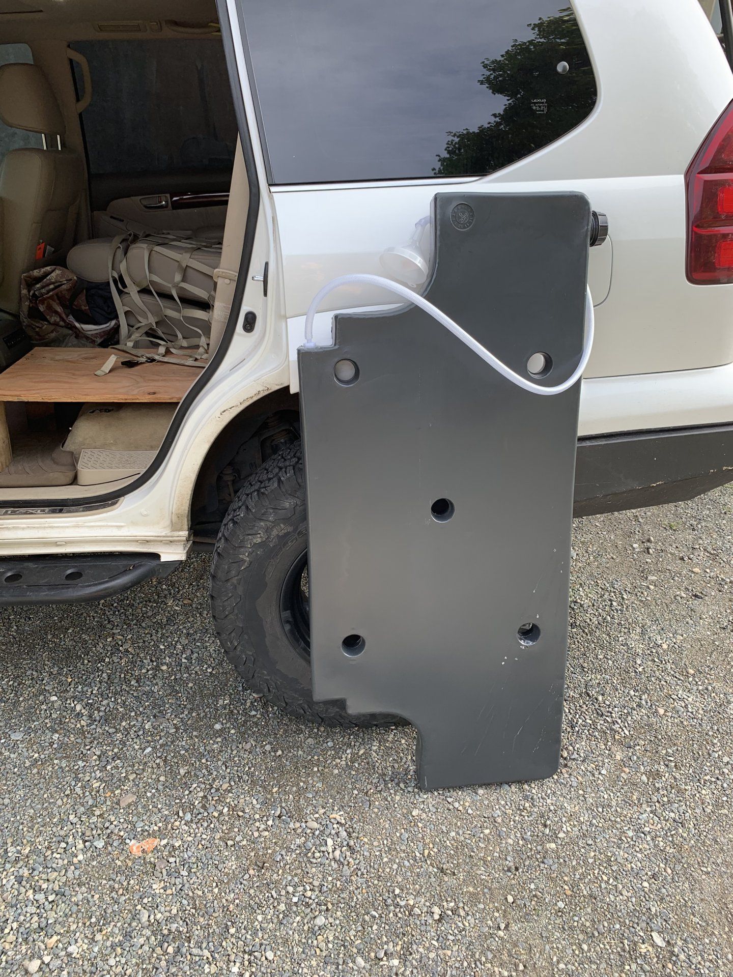

After some long trips I was really tired of our current water storage. A 5 gallon cube with a spout and for longer trips another 7 gallon plastic “Gerry can”. They took up tons of room and were awkward to carry.
Enter the front runner slim 11 gallon water tank. It tucked between the 2nd row seats and Dobinsons drawers nicely and we plumbed it to a water pump and spray nozzle. The pump is hidden on the drivers side under the wing of the drawers.
wired a switch just inside the rear hatch to turn the on-demand pump on And added a duel USB/volt meter because I could.

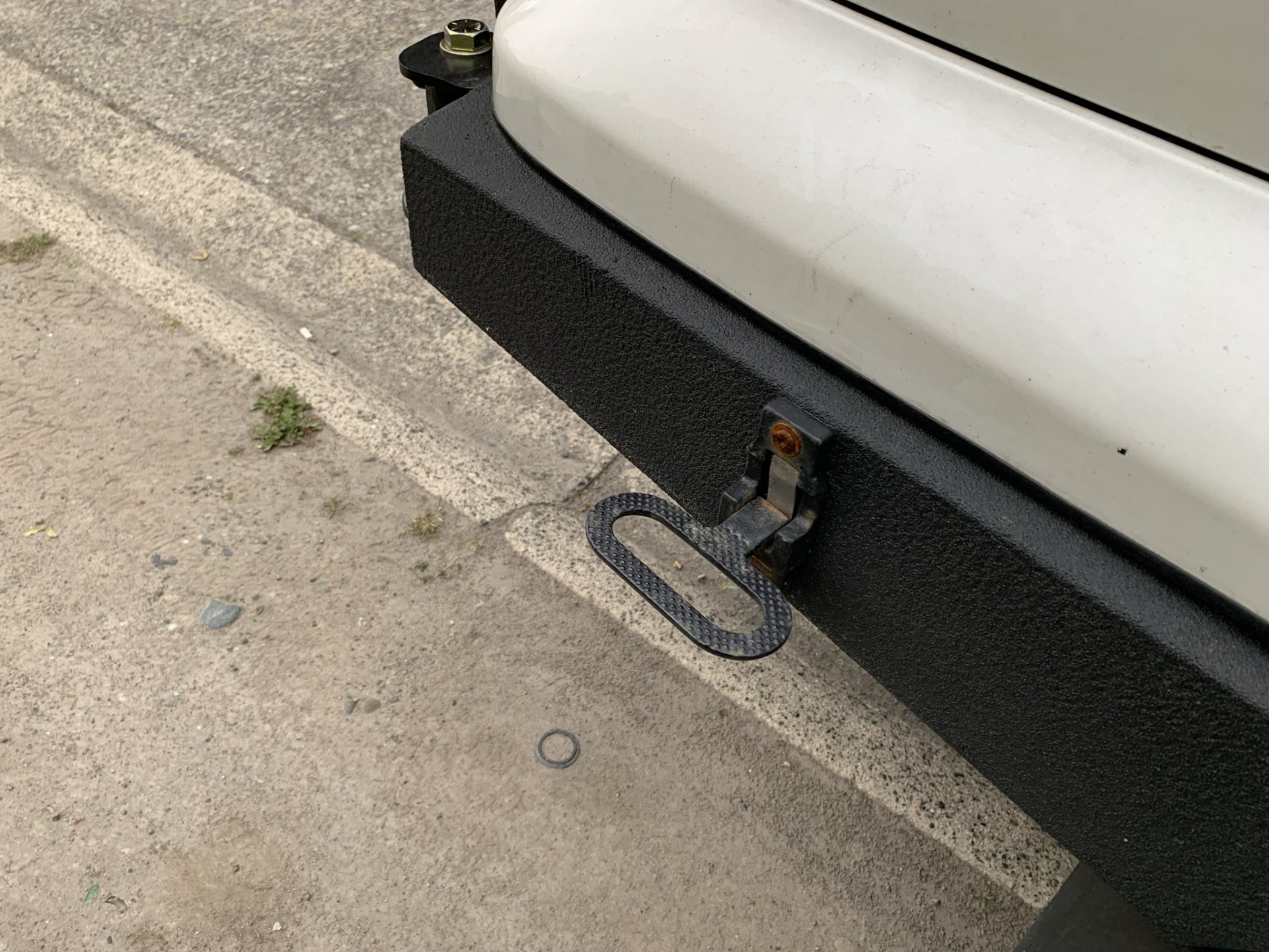

-Rear bumper folding steps
Who doesn't need more stepping points when crawling around the truck. They also double as good drink holders

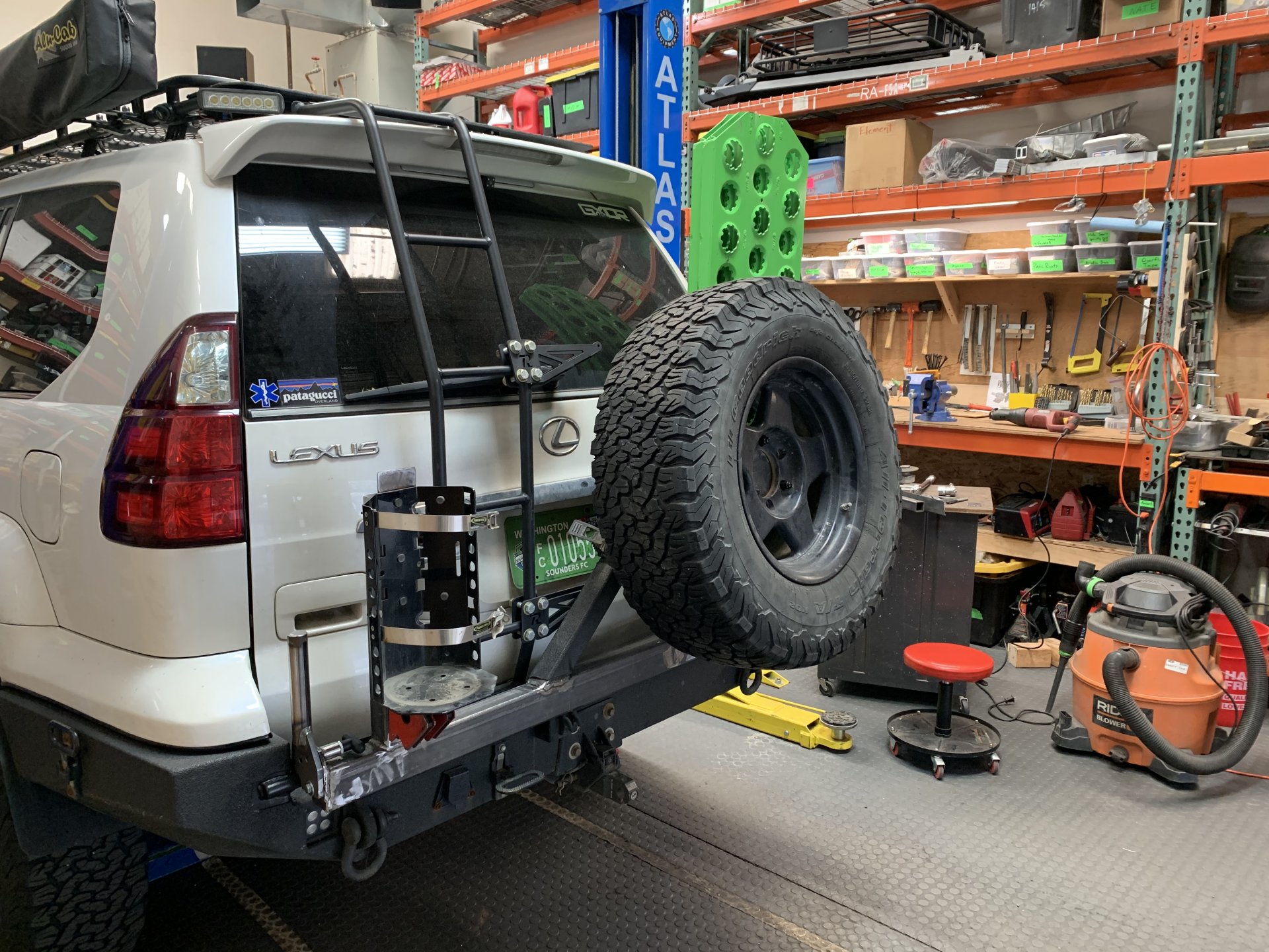

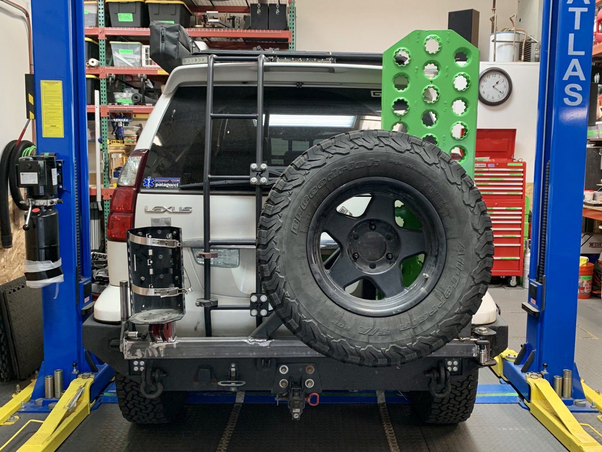

-Rear camera relocated to hitch
With the new rear bumper and tire carrier, the OEM camera location was completely worthless. I found a nice little spot right above the 2" receiver/tow hitch.

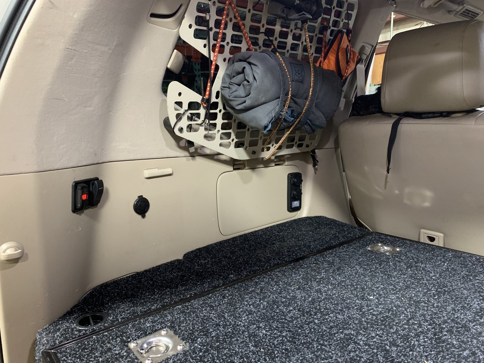

-Rear cargo area Blue Sea 12v/USB panel.
We picked up a Dometic CFX 75 fridge so I wanted to make a little home for it where we use to keep our Yeti 105 cooler. This panel had the 12v plug the fridge needs on a switch so we could turn it on or off appropriately.
*Side note, we love and trust everything Blue Sea makes. We have used their products in our Land Cruiser, GX and multiple boats we've owned.

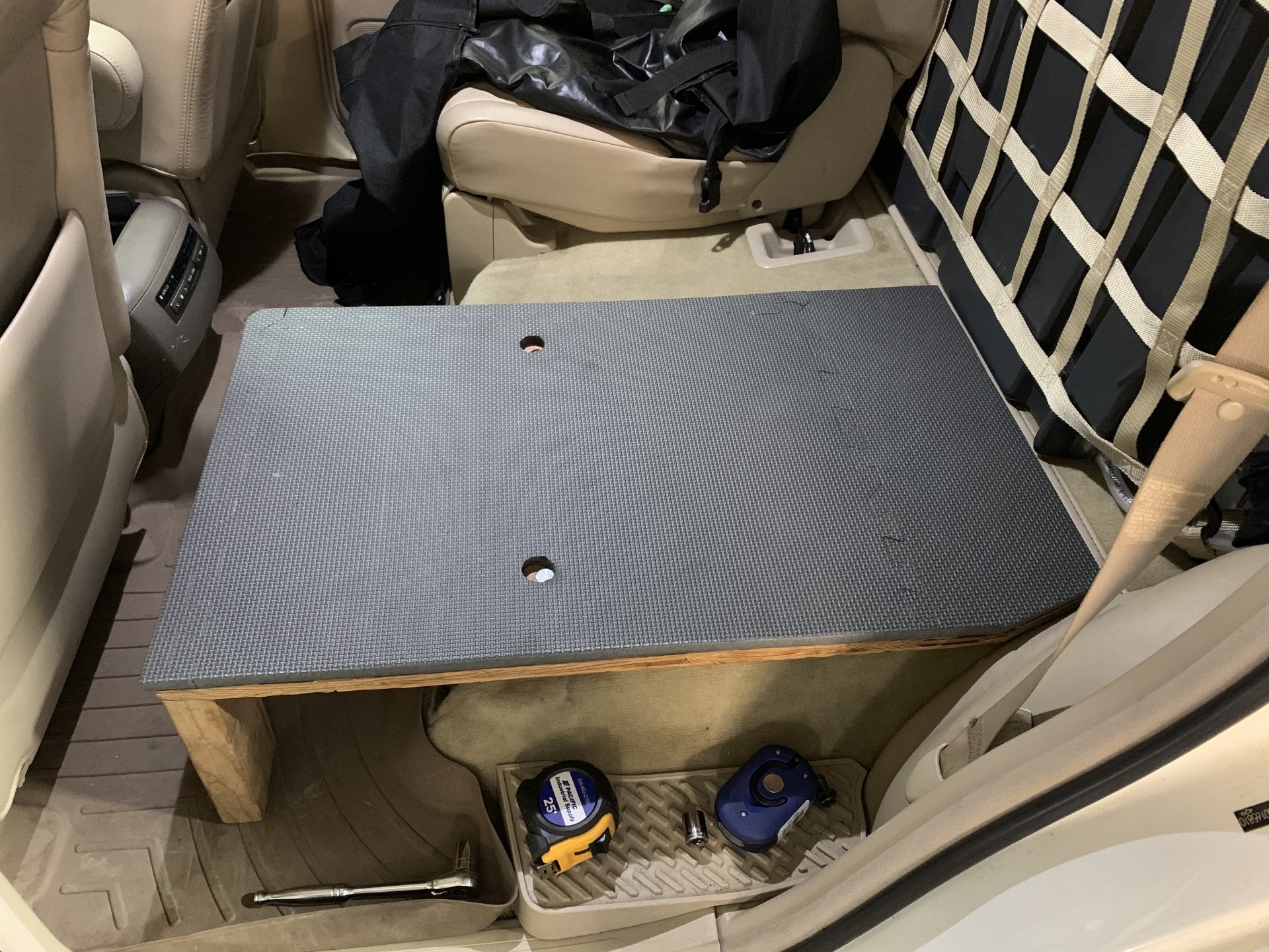

-Fridge platform.
We had a platform of sorts in this spot that held our Yeti 105 cooler. The Dometic CFX 75 is just about the exact same size. I rebuilt the scrap plywood and 2x4 chunks and bolted it to the OEM 2nd row attachments holes. A little foam shop flooring was added to easy jolting of the fridge going down the trail and it's the perfect home for the Dometic. It's nice to roll down the rear window and grab a cold drink or snacks right out.

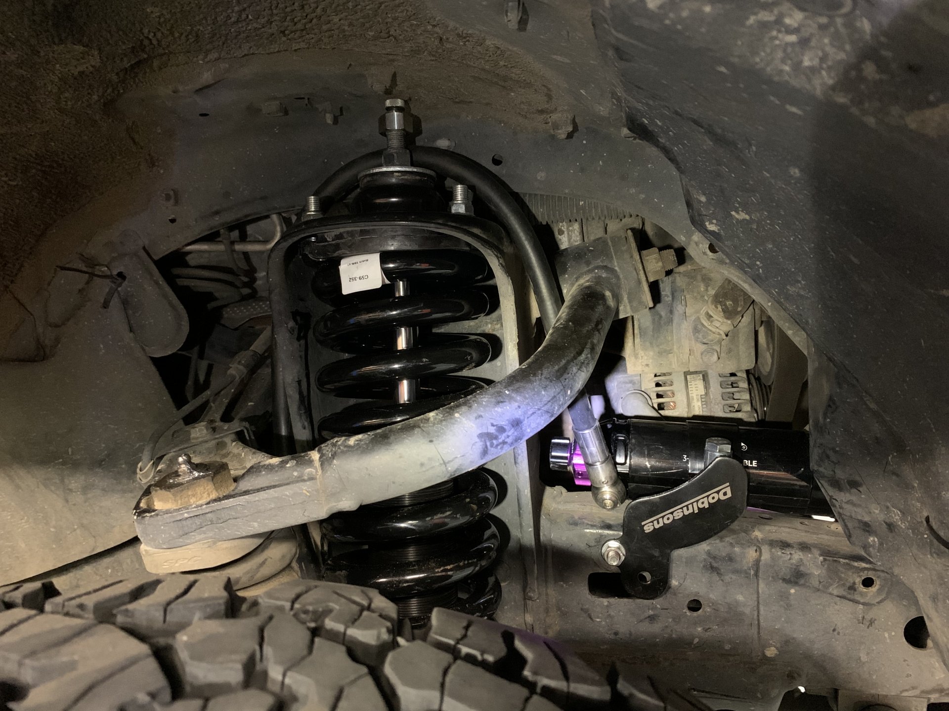

-Dobinson's front MRA standard travel (C59-352 springs)
-Dobinson's rear MRA long travel (701v springs)

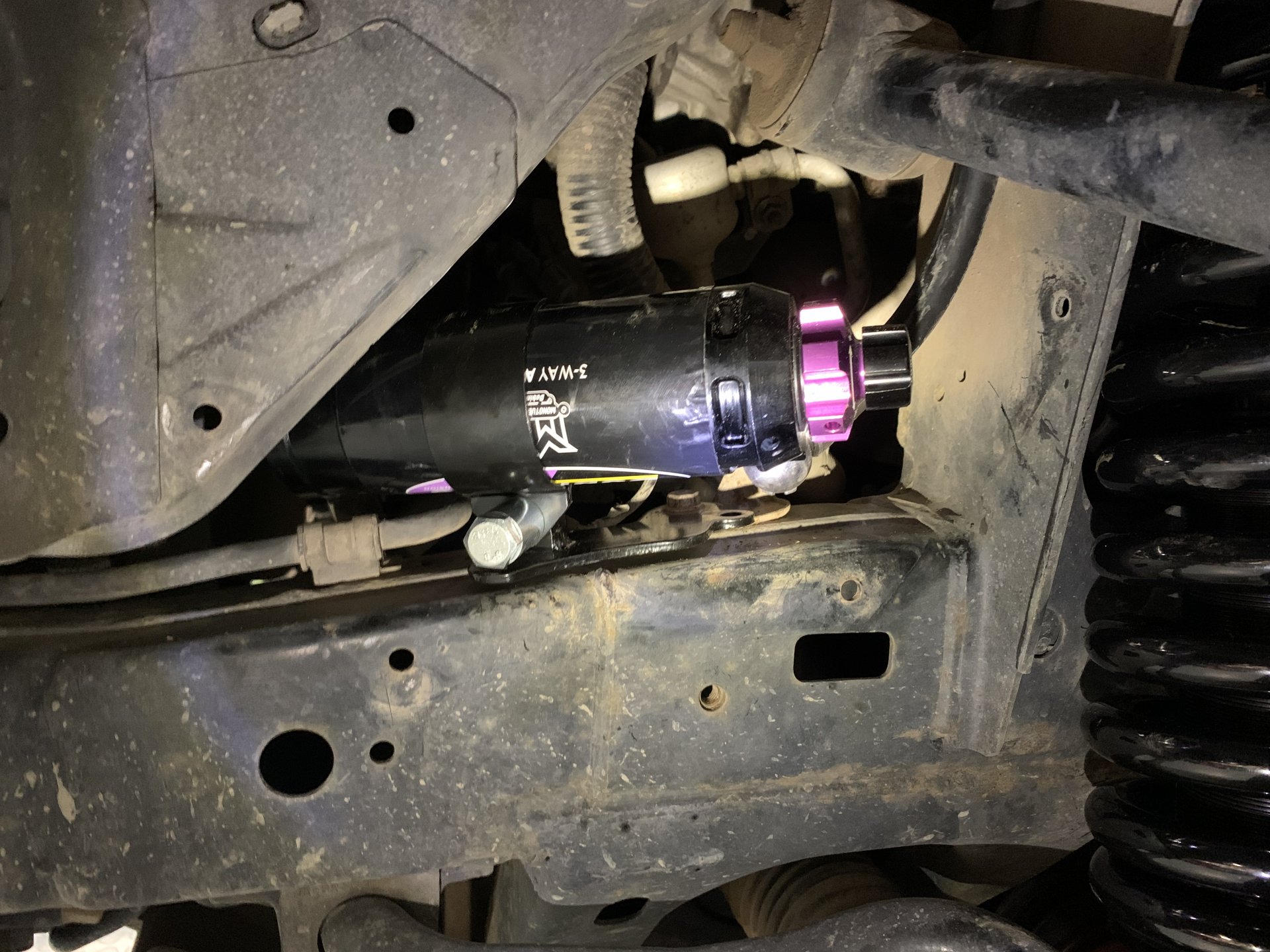

Being able to adjust the high speed & low speed compression and the rebound has been a huge game changer. It seems the faster you drive over speed bumps, rocks, washboard or drainage cuts the better these shocks work and the better they feel. Being able to keep both the rear tires planted on the ground is amazing too.
Mounting locations of the remote reservoirs:
Driver Rear:
Passenger rear:
Passenger front:
Driver front:
Driver front:

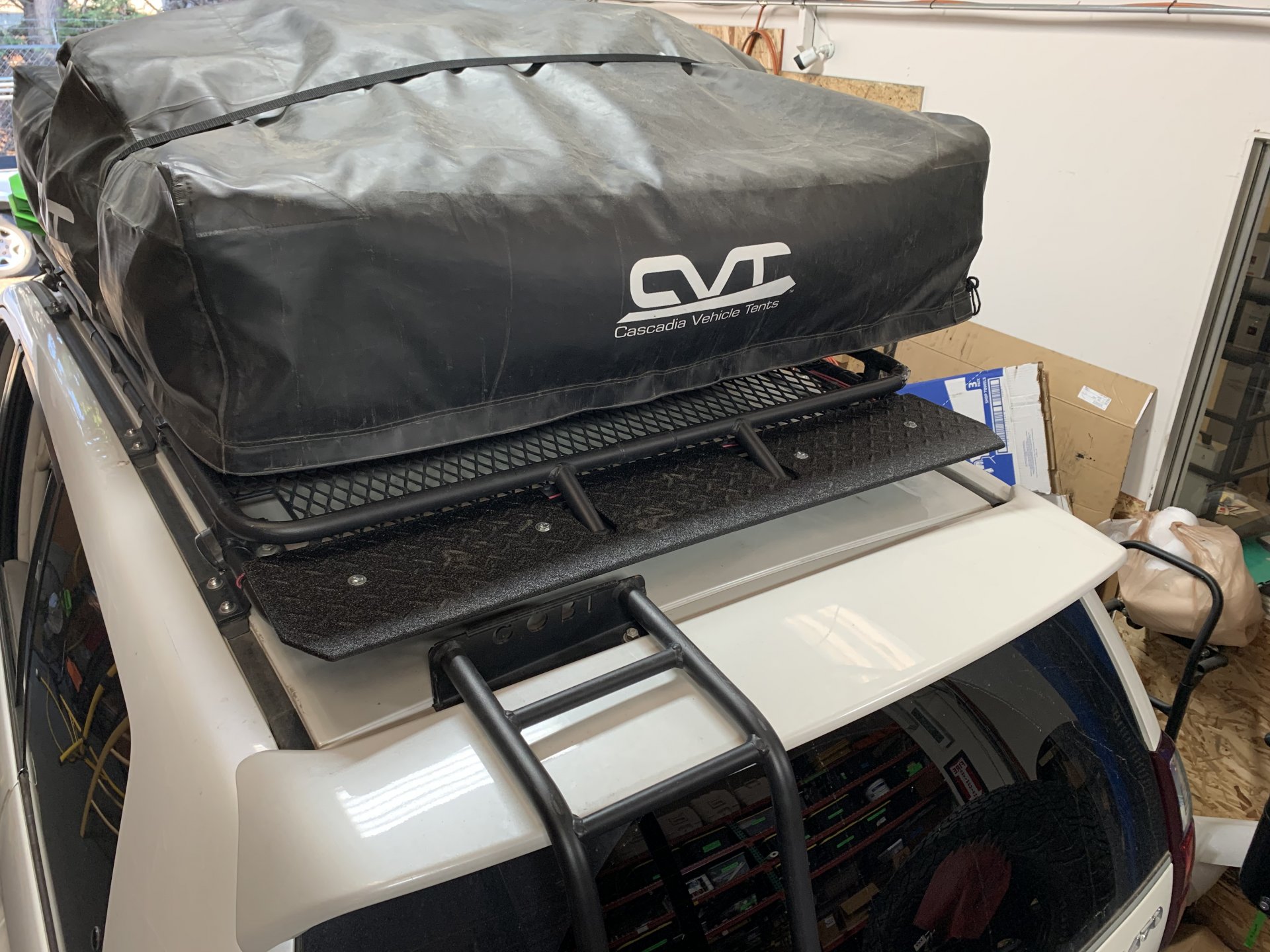

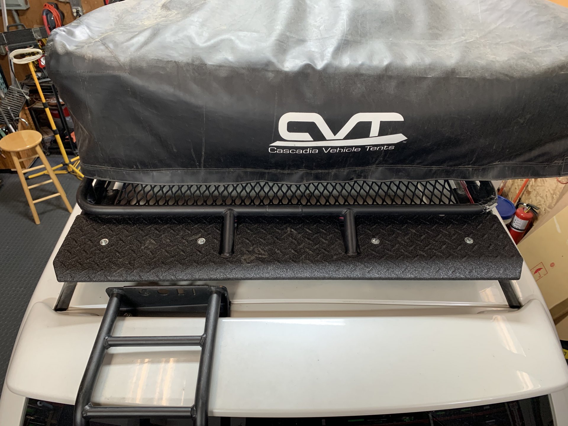

-Gobi rack custom rear step/platform
When climbing around on the rear of the rack we wanted a little more room for our feet to feel a little safer. A scrap piece of aluminum diamond plate and we had Rinolined works perfect.

-Re-built rear swingout with 4x Innovations hinge and locking handle
A stronger hinge, more solid handle and now a full length swingout with a propane mount and rack for the aluminum boards.
