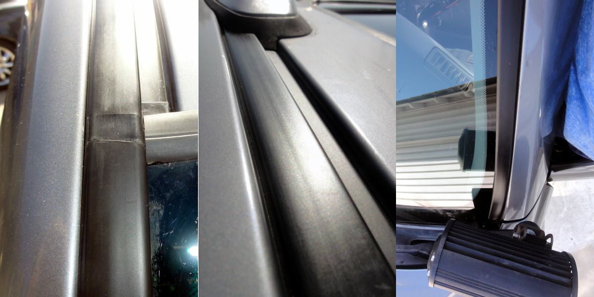

My gx470 is 15 years old and some of the door window trim was falling apart. I felt that air, dust, and rain could be getting in.
When I’m off-roading in the desert, there are clouds of dust everywhere from my own car or from other cars. So, for me it was functional.
I actually prefer the chrome trim but it was too expensive. This black plastic was betterpriced.
Also, when my windshield was replaced, the windshield trim never fit back the same way. The trim is old and brittle. I’m hoping this new windshield trim helps with wind noise I’m hearing at 65 mph.
I took videos while doing the window mouldings on the doors. It was easy. It took about 30 minutes to do both front and rear doors on both sides.

The quarter panel mouldings look much more difficult because you have to remove the inside panels to remove the screw that loosens the quarter window. I estimate the quarter window trim to take at least 2 hours to do it right.
View attachment 1736877 View attachment 1736878 View attachment 1736879 View attachment 1736880 View attachment 1736881
Thanks! Took about two minutes to install my driver’s door mounding after watching your video.

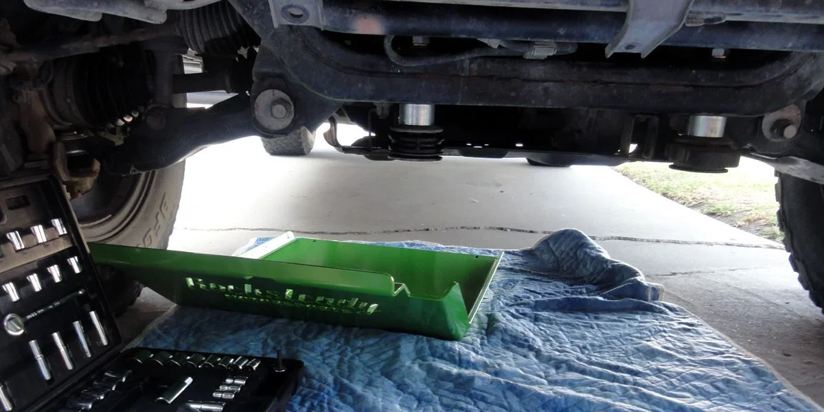

All: anyone see my post on a question regarding the oil hole on your front skid plate?

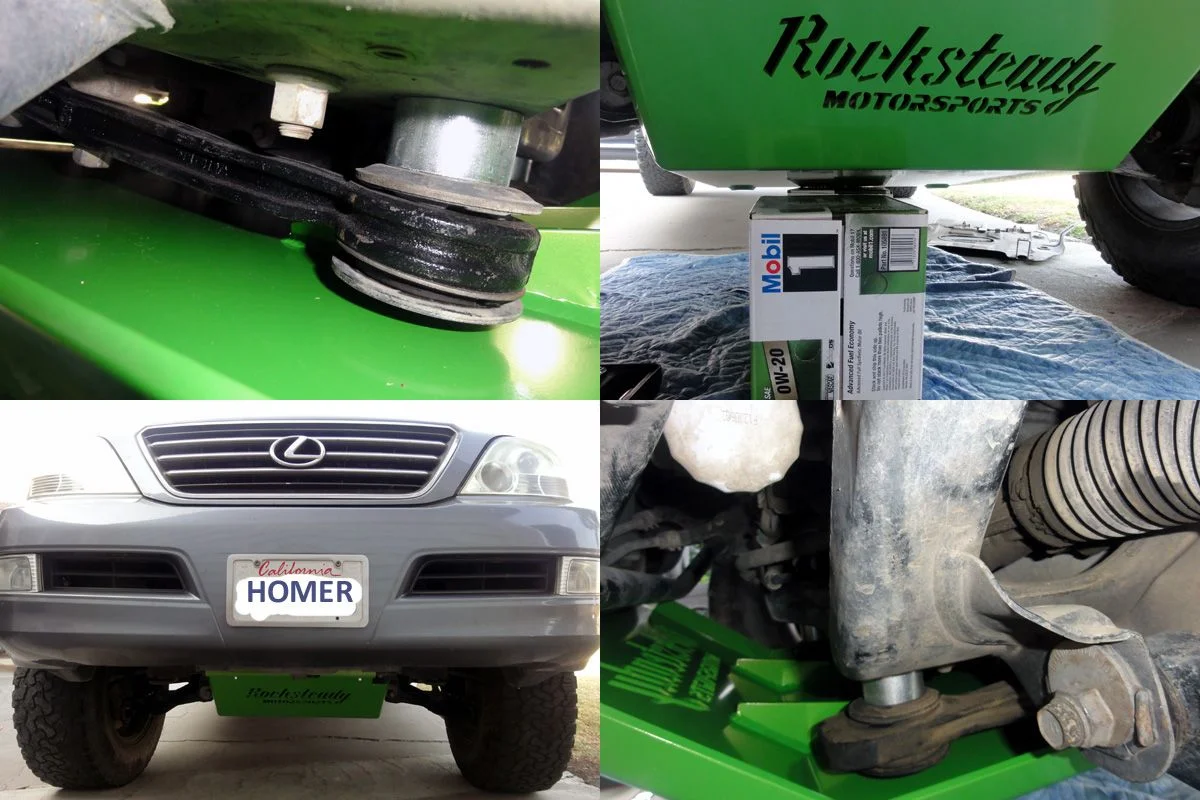

My RockSteady aluminum front skid plate came without the hole for oil changes. I can go to RockSteady to add the hole, but they claim it gets hung up on rocks. Anyone has had this problem?
I guess I’m asking if you have a front skid plate, you think the oil hole is necessary and useful?
It turns out that there's enough room on the side of the skid plate to remove the oil filter. So, I'm going to ask RockSteady to drill the hole on my front engine skid plate. They don't add the oil change hole anymore, but they didn't inform me of this and their web site has always shown the front skid plate with an oil change hole. I need to drive down to San Diego to get this done. I hope they open on Saturdays since that's the only day I can drive down there.

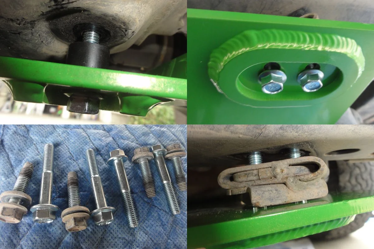

The install was easy. I used two full six-packs of Mobil 1 Oil 0w-20 (for my LS460) to prop up the skid plate. The holes aligned perfectly and I installed the skid plate in about 30 minutes. I had to remove the OEM skid plate and the plastic splash guard.
Also, my diff support brackets with the 1" diff spacer clear the skid plate. So, I left my diff drop kit in place.

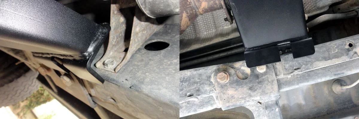

Adding skid plates one at a time. Just installed the middle skid plate aka the transmission skid plate
Trying to install the 3rd and last part of my RockSteady Skid Plate full set. This last part is the transfer case bracket to hold the transfer case skid plate in place. Unfortunately, I got stumped!
The transfer case bracket overlaps with the middle leg bracket of the OPOR passenger-side rock slider. So, it looks like the RockSteady transfer case skid plate bracket and the OPOR rock slider middle leg bracket need some modification to fit. Argh!!!
I hate when that happens. Now I have to figure out who can cut and fit both brackets!

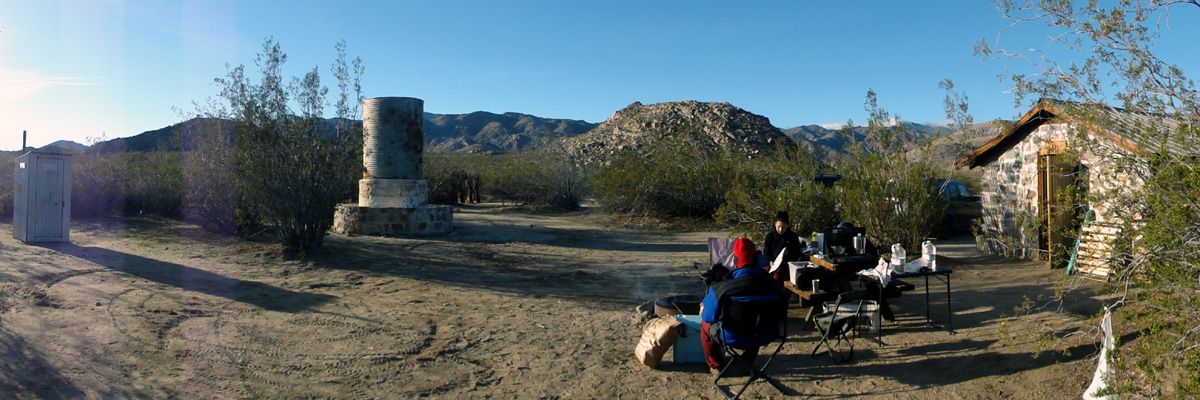

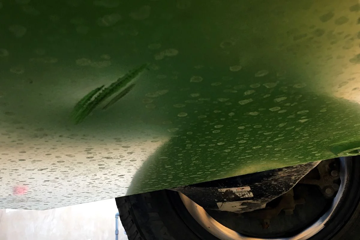

Went to Baileys Cabin and dented my new skid plates. Great outing. Some 4x4 offroading, a hike, overnight camping at a cabin, and a great bonfire.
Did you get to actually stay in that cabin or camp next to it?
Yeah, we were able to claim the free cabin (first come first served) for two days (one night). We camped inside the cabin. The cabin is small like 12' x 16', but well built. There was an outhouse as well that was rebuilt like 12 years ago (or so). The place is well kept and nobody was around for the two days we were there.
It was cold and windy, so we setup a 10'x10' Coleman tent inside the cabin. There was evidence of rodents, so we decided to put the tent up inside the cabin just to be safer. There was a fire ring and a picnic table outside, plus there's a second picnic table inside the cabin.
It was great to have the place all to ourselves. We felt we were so far from civilization, but we were like 15 miles from a small town.

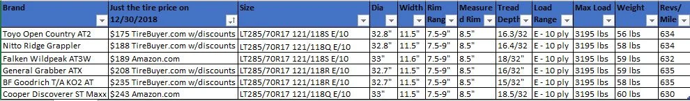

Ordered new shoes. I'll add a picture once they are installed. Got the Nitto Ridge Grapplers in LT285/70R17 E/10 for $828 taxed and delivered to a local tire shop American Tire Depot. These are the tires I considered, but ended up with the Nitto's due to price, quality, and recommendations.
