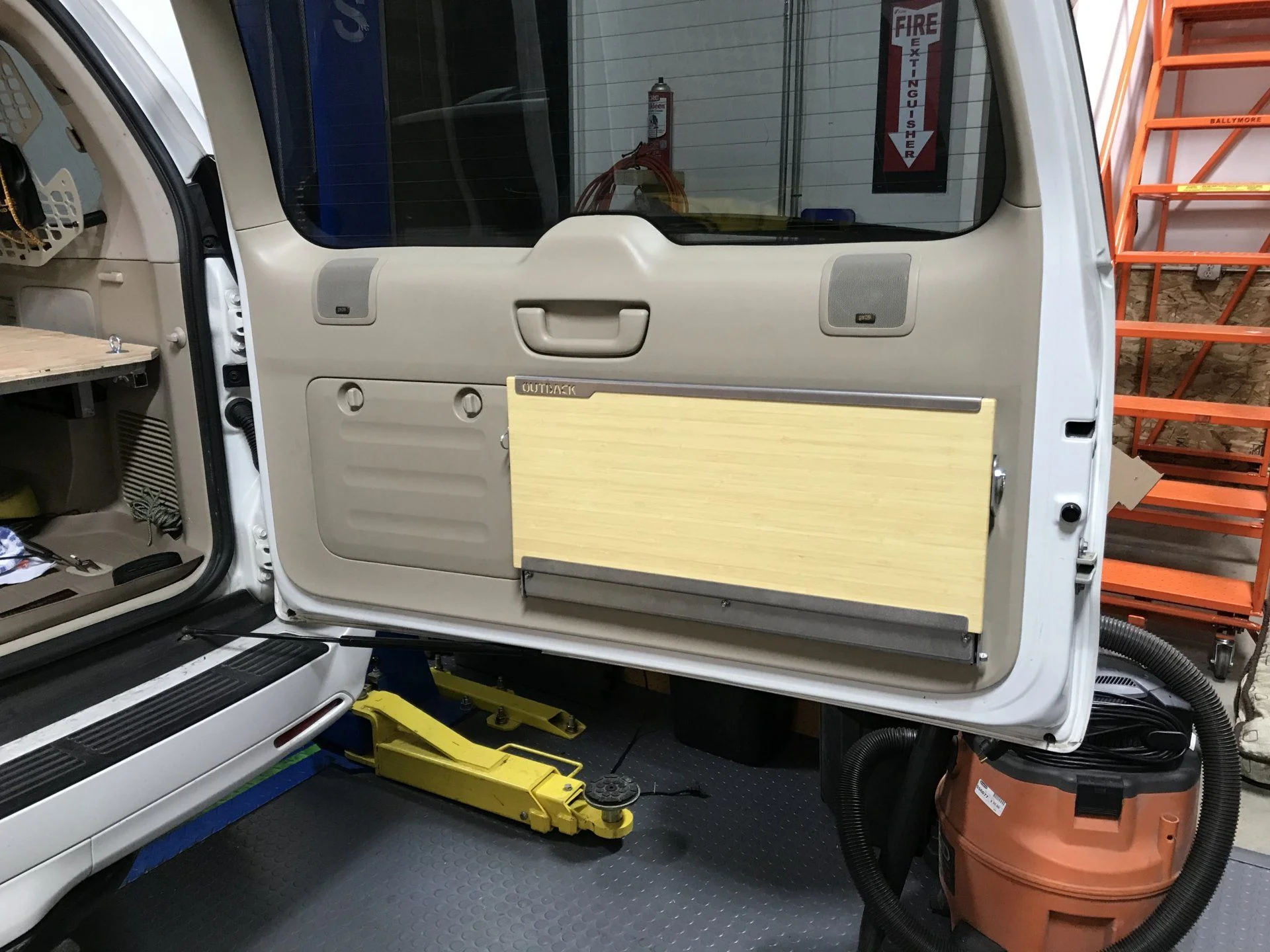

-Outback Adventure drop down table on rear hatch

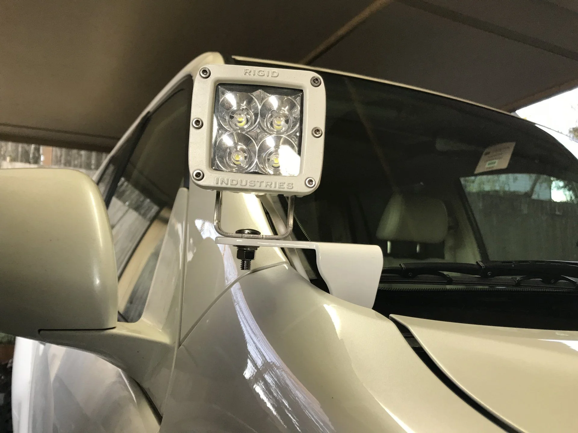

-Two Rigid E-Series PRO | 6" Spot (roof mounted)

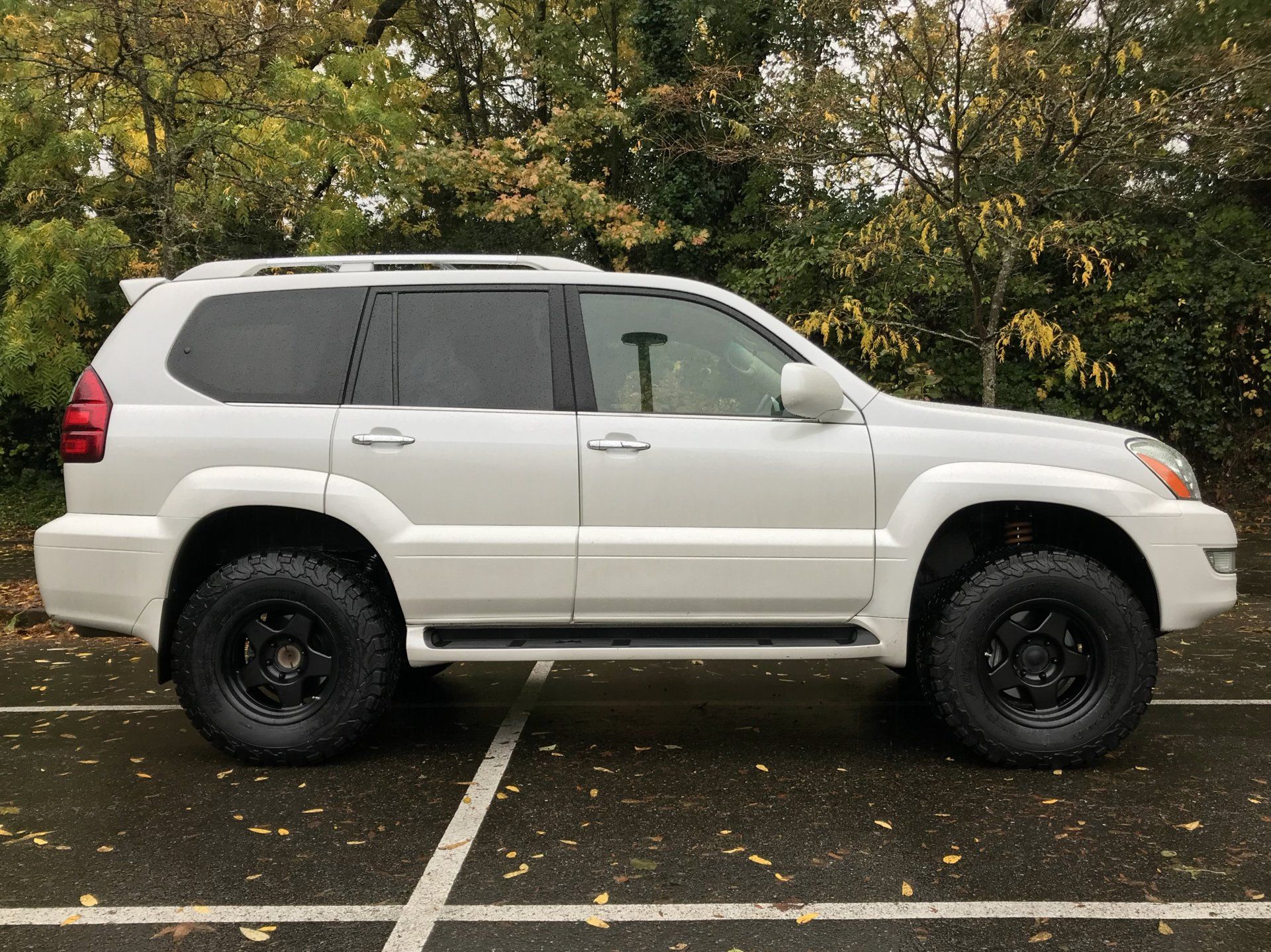

Lose the running boards and cut those mud flaps, you’ll be much happier. Maybe some sliders for Christmas?
Running boards will go as soon as sliders come in. Wife and dog like the step getting in and out.

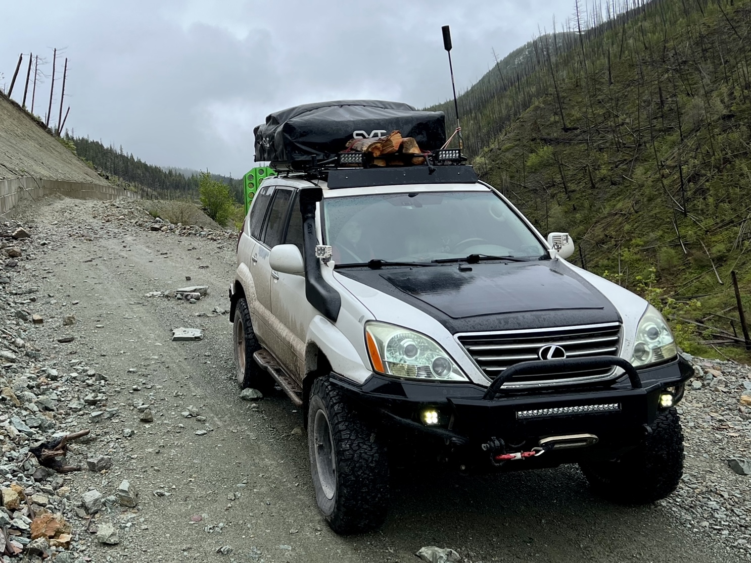

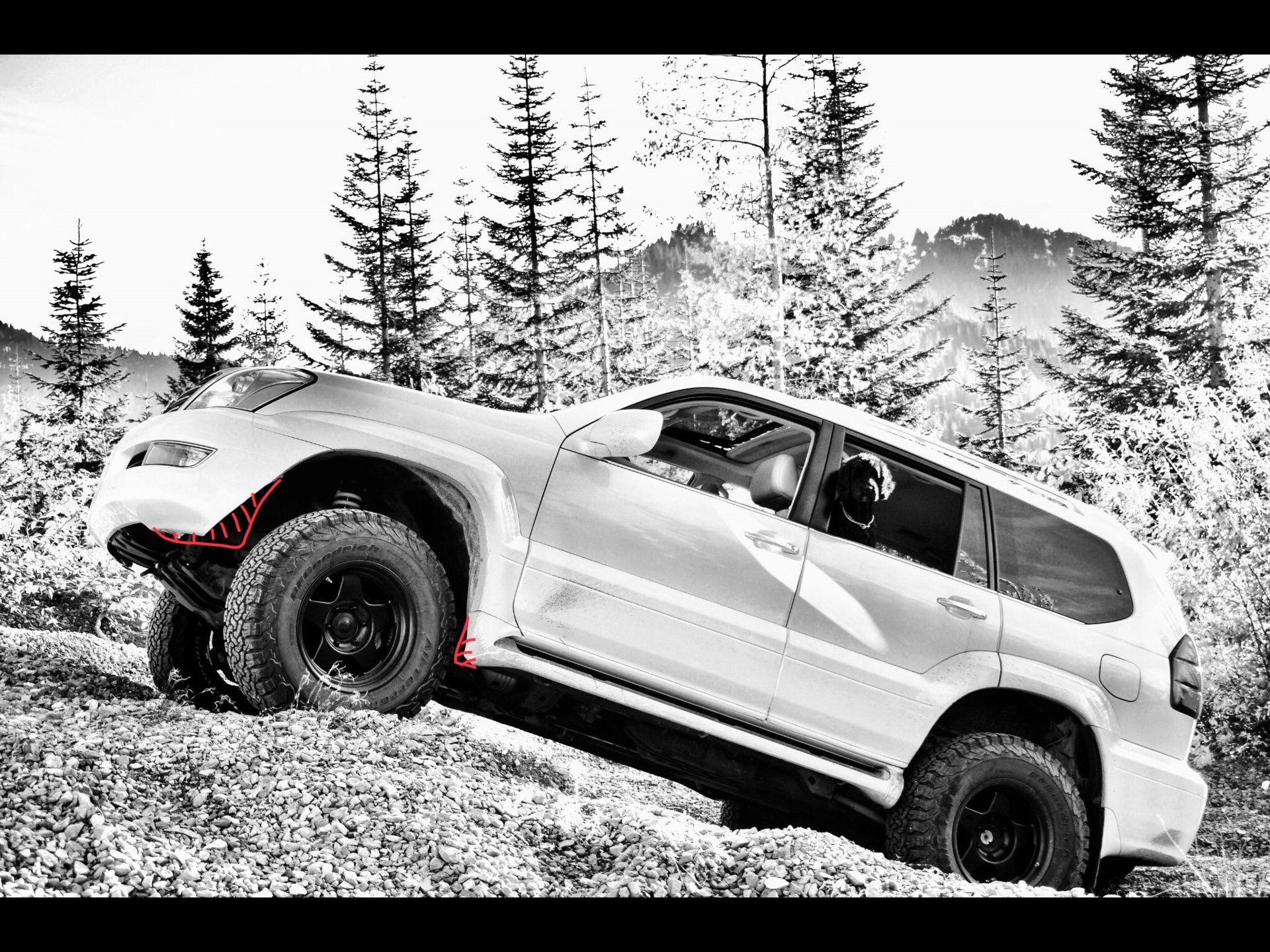

Iron Man Foam Cell Pro lift, stealth custom series F5 wheel w/ 285/70r17 BFG KO2 A/T
estoddart, how do you like the Ironman suspension kit?
Oh, and where did you mount the oversize spare tire?
I'm looking at selling my 100 series and purchasing a 2005-2007 GX470 and have been looking at the options. Metaltech has the Ironman on sale right now. Thanks.
An alternative to the full size big spare is to get a skinny tall 255/75R17 (32x10R17) tire and mount it on your spare oem rim and call it a day. This works because the tire fits your oem rim and won’t rub when u use the spare
We like the iron man. It’s a good set for the money. We might move to something nicer in the future (BP-51’s ?)
We don’t have KDSS so a 285/17 fits in the underneath spare spot.

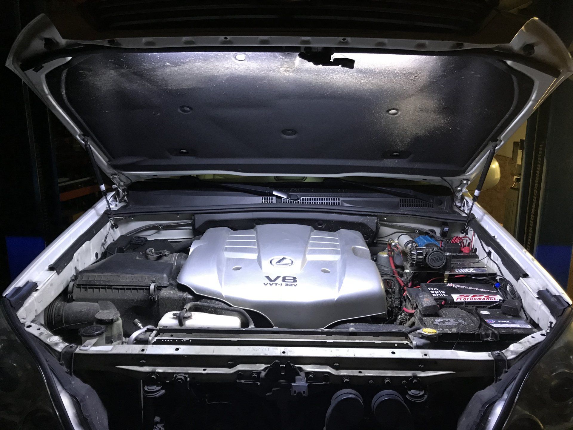

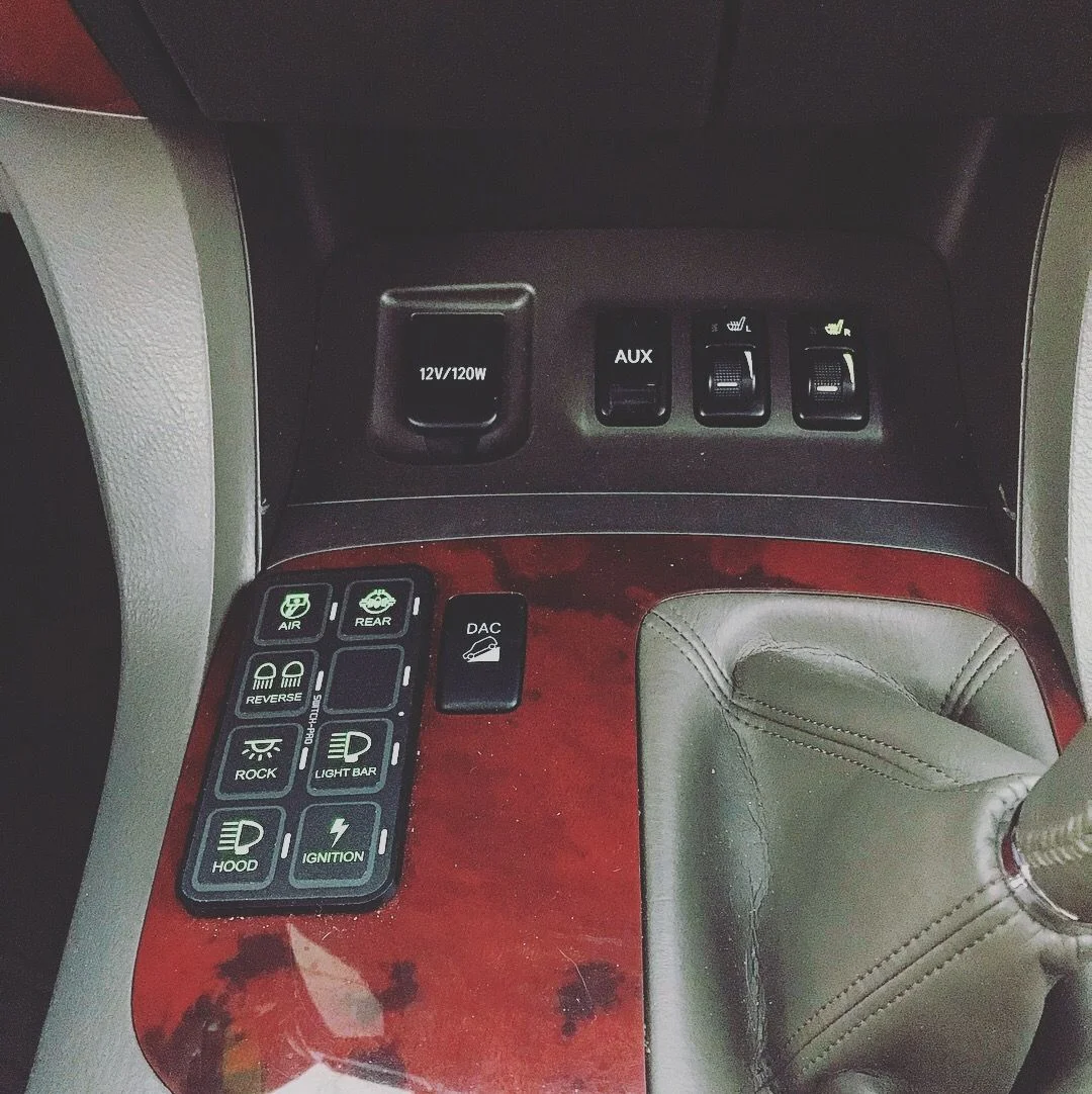

Power Trays, SwitchPros, CBI, Rigid Industries & ARB installed

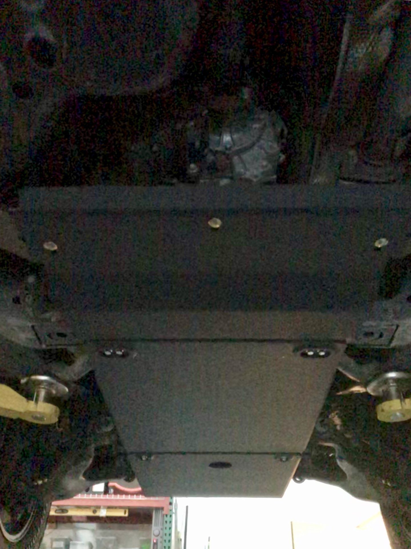

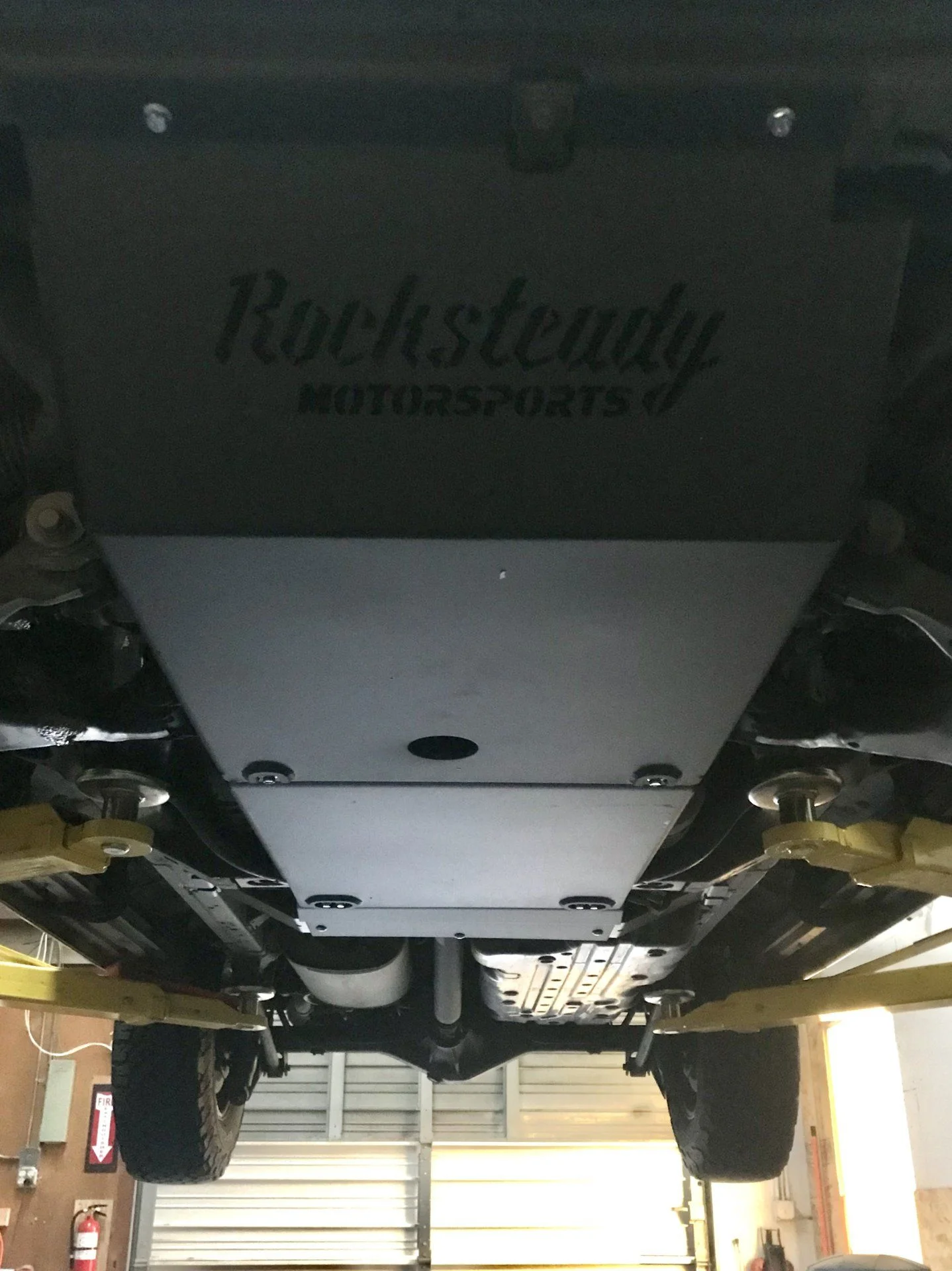

Rocksteady Motorsports aluminum skids. Engine, Transmission and Transfer Case Skid Plate
Looks great, getting ready to start my recent 04 gx. I'm coming from a 96 3xlocked lx 450 on 35s. Power and comfort upgrades are awesome.

Sits perfect.

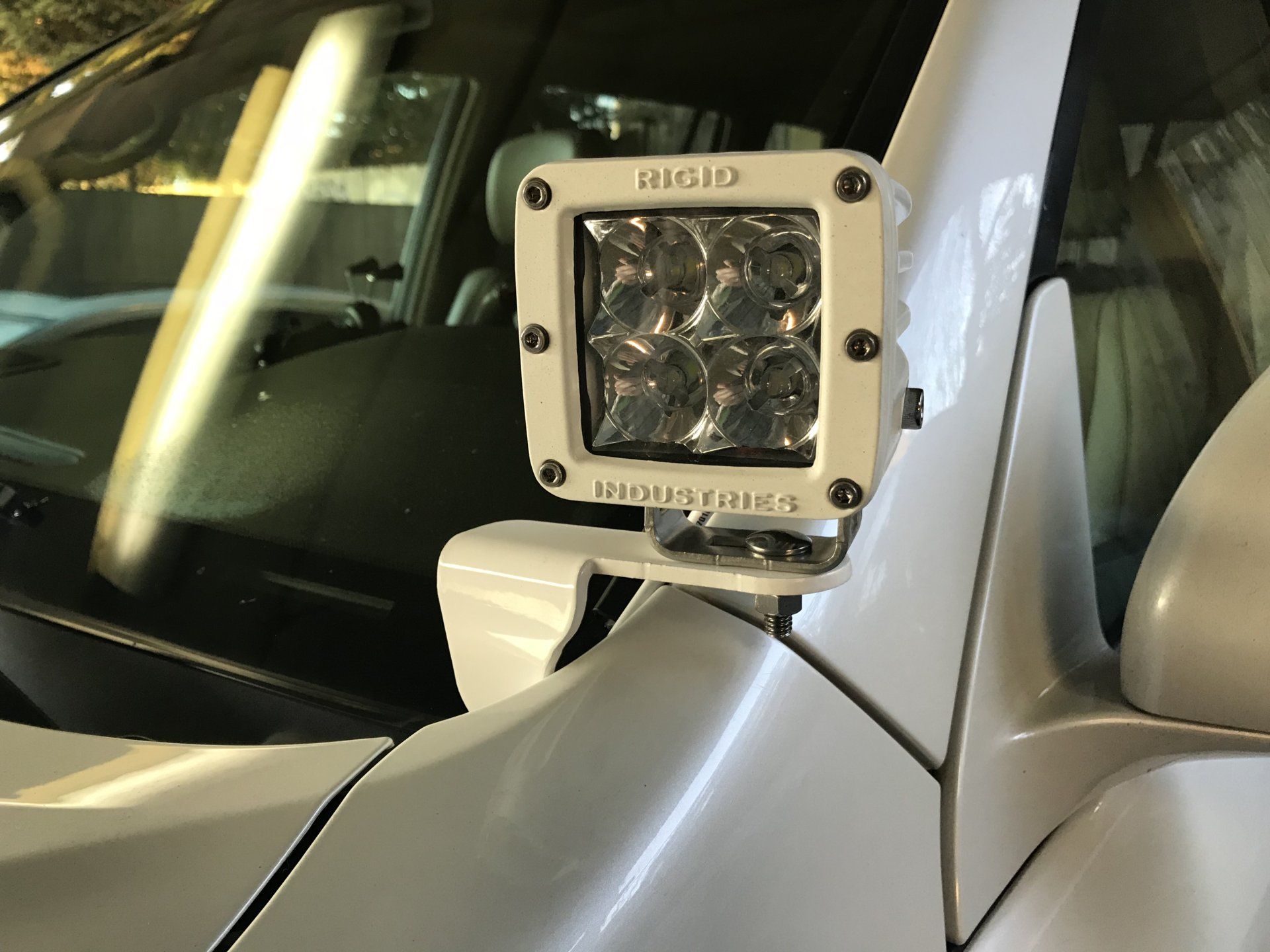

Looks good! I know it seems pretty straight forward but can you shoot a few pics of the cbi ditch light mounting. Have the same ones with no directions and wanted to double check how they mount. did you have to use longer bolts? Thanks
Had some questions about trimming with this lift and tire combo...
Yes, I’d be rubbing on turns if I didn’t trim the front bumper, inner wheel well liner and a small corner behind the front wheels. The rear was just fine left alone.

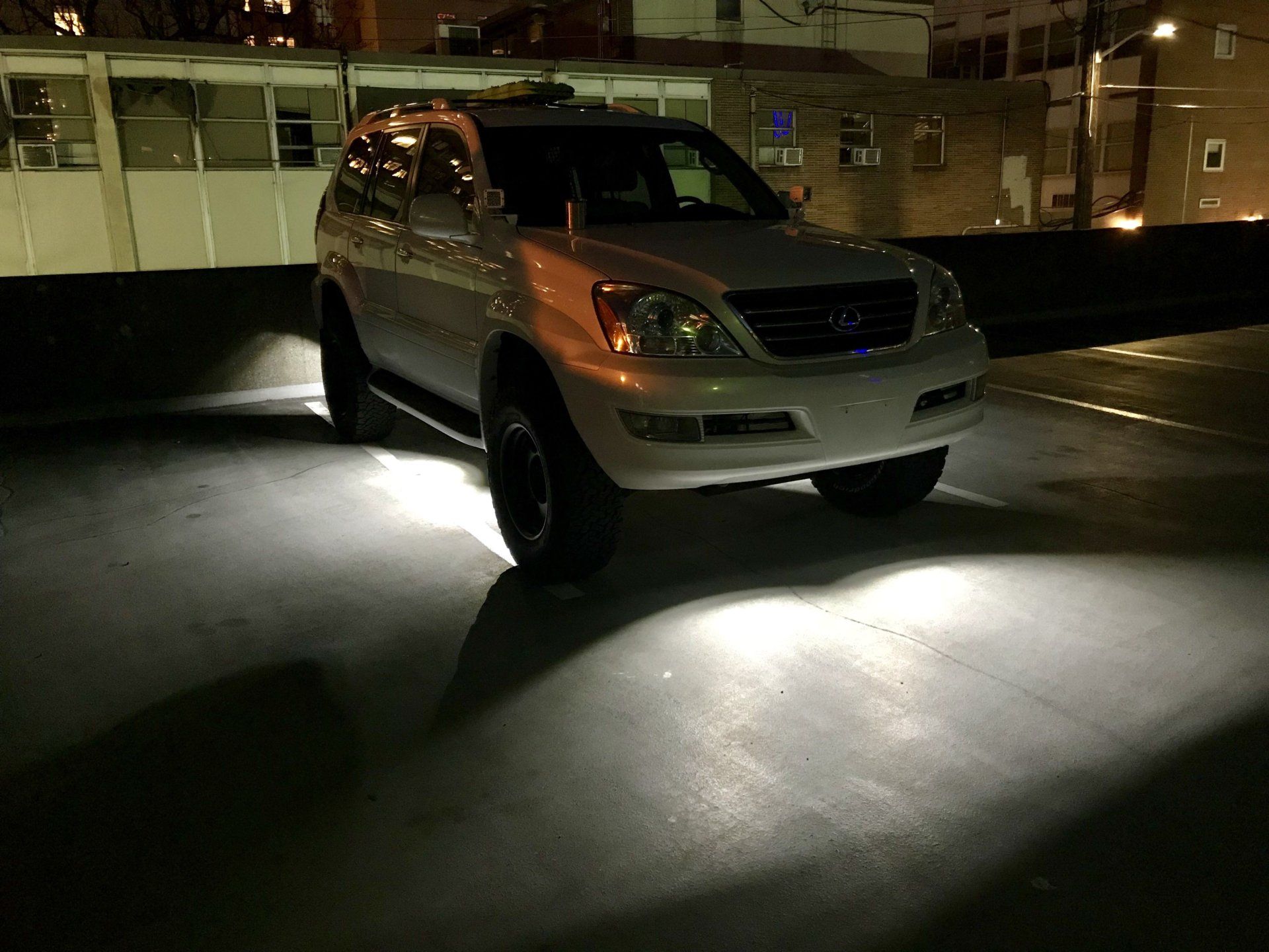

Installed the OZ USA rock light kit. I was skeptical about the $65 price tag but they look very well made. I used an aluminum “L” piece, cut it down and bent them to about 45deg for mounts.
Looks great! So clean. How was your alignment before you added the UCAs?
