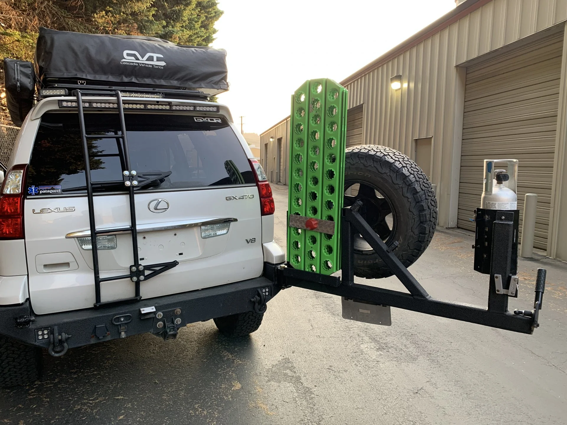

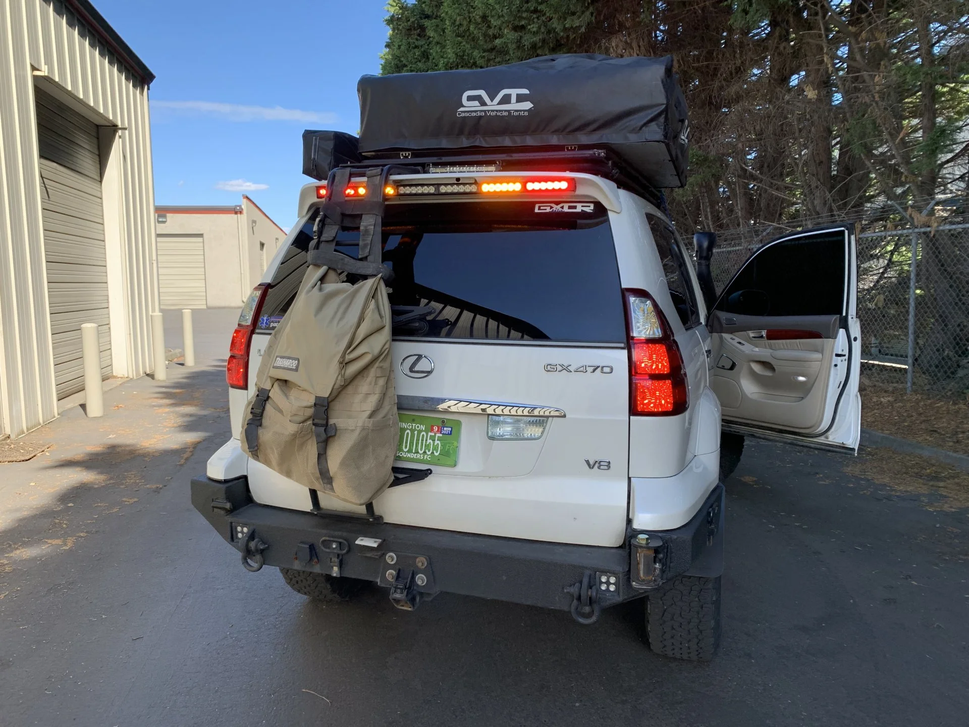

Rear bumper pre-Rinolining

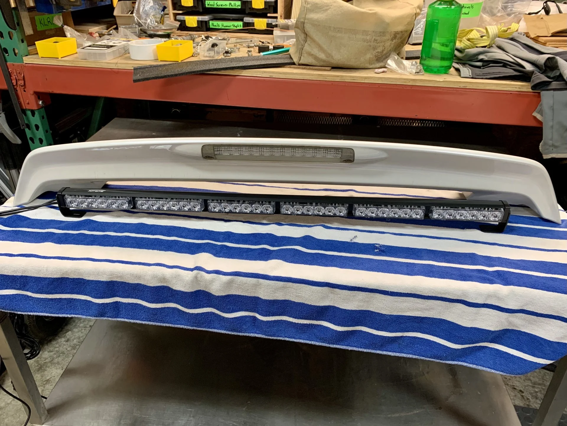

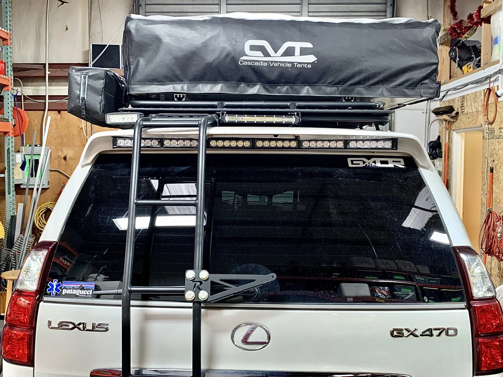

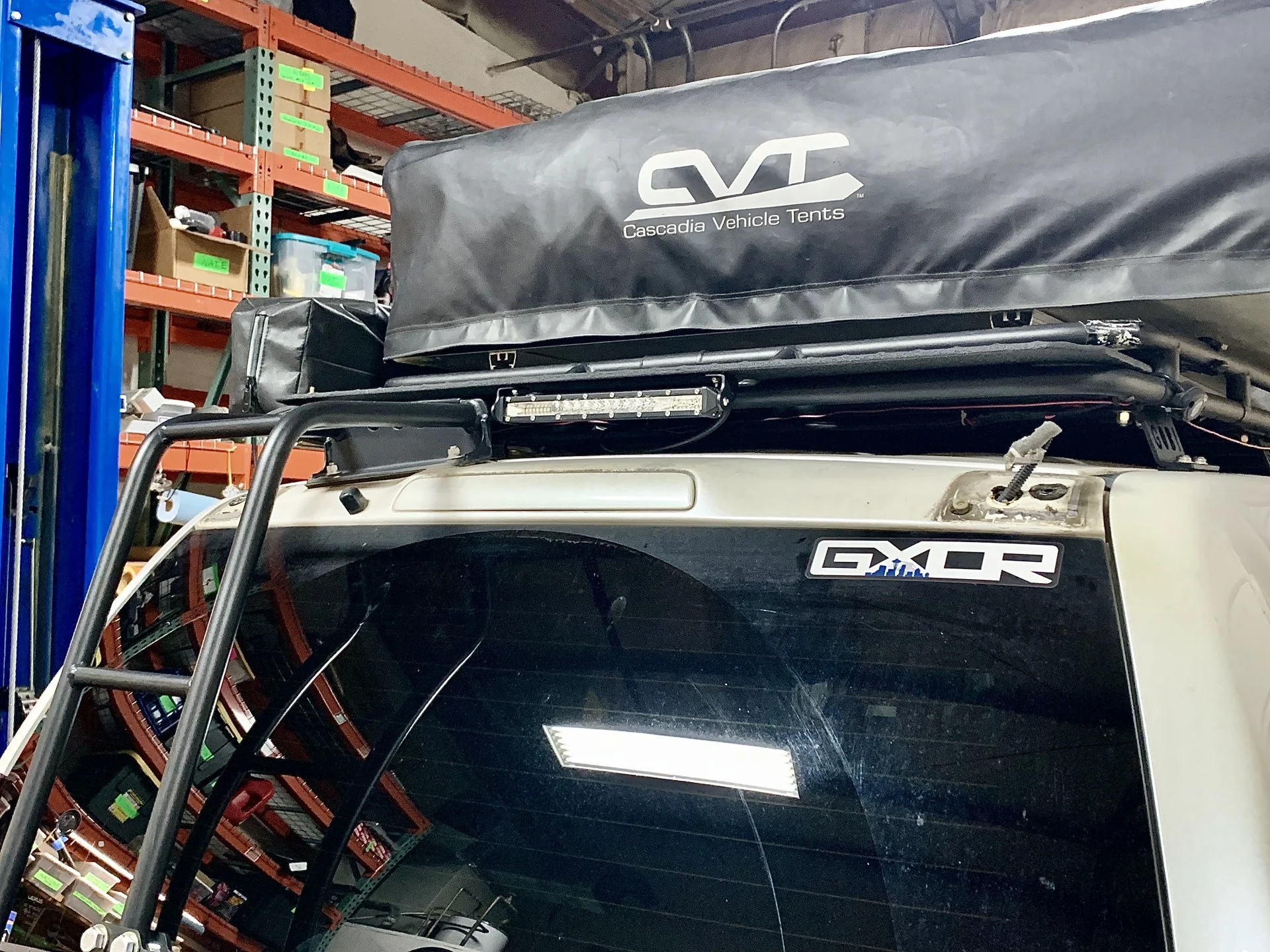

-Xprite chase light, 30in. "RYWWYR"
Pull the OEM spoiler off
Check the sizing
Start the cutting
Re-mount the spoiler with intergraded chase light.

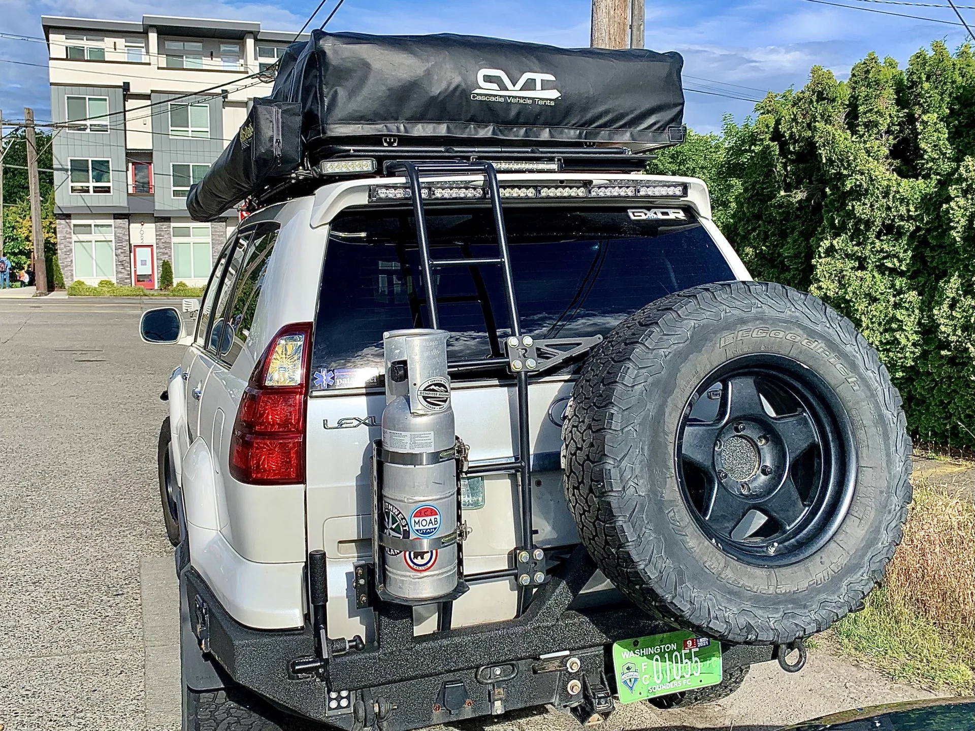

@estoddart man quite the list of updates! Some awesome stuff, I'm jealous of the mra setup. Jealous of it all really, awesome build.. I love the flip down step on the side of the bumper. I've had thoughts of doing the same thing if I get a steel bumper. You going up in tire size or keeping it where it's at?

Thanks TLar25 & VSPro.
We're on 285/70-17 (33") but I think we'll switch to 285/75's (34") next time.

Coastal bumper + 4x Innovations swing out is the way to go. I did the same setup on mine.

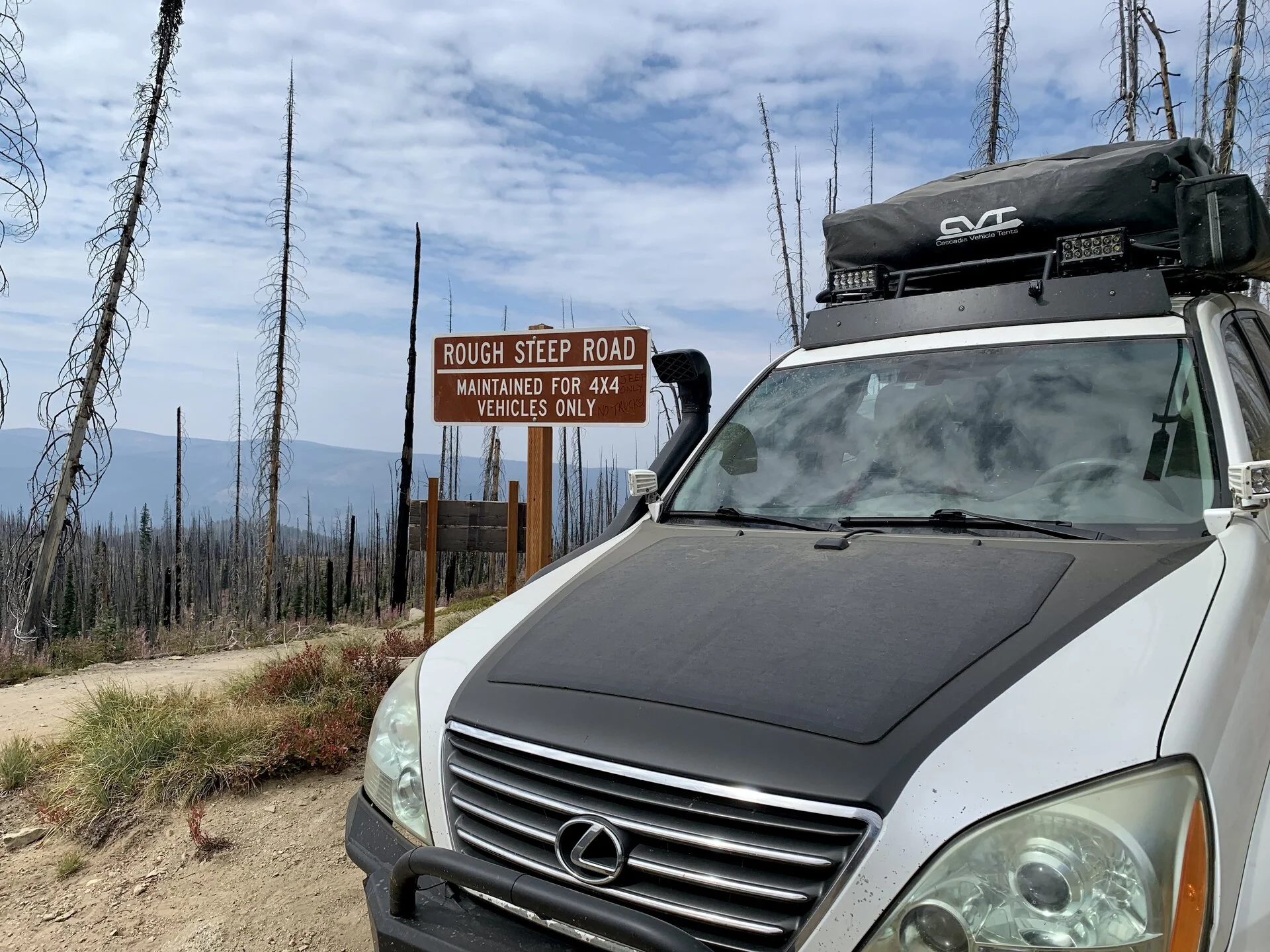

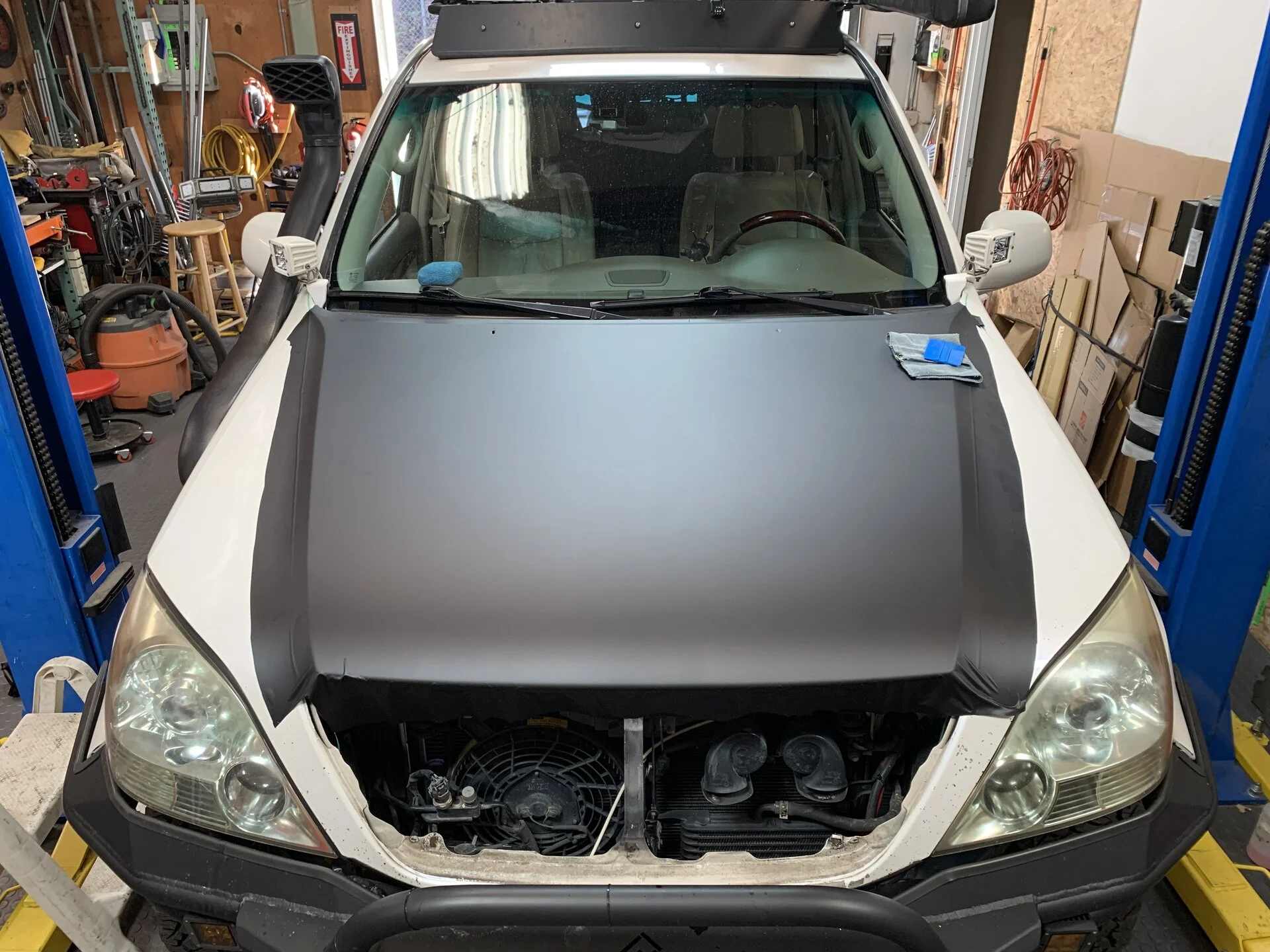

Anyone that has an 06-09ish, Pearl White GX470 know our paint is s***ty. To help cover up most of my horribly chipped hood, give me a good sticking plane for the solar panel and add style(maybe), I opted to wrap the center sections in 3M matte black vinyl. It came out pretty good if you don't zoom in.
I've noticed most people "blacking out" the center section follow the natural hood crease. That leaves a weird gap where the grill and crease don't match up. I opted to run a straight line from the grill corner to the top corners of the hood.
The Trail-Power "Hoodie" installed easy and has been a great addition. We highly recommend.
