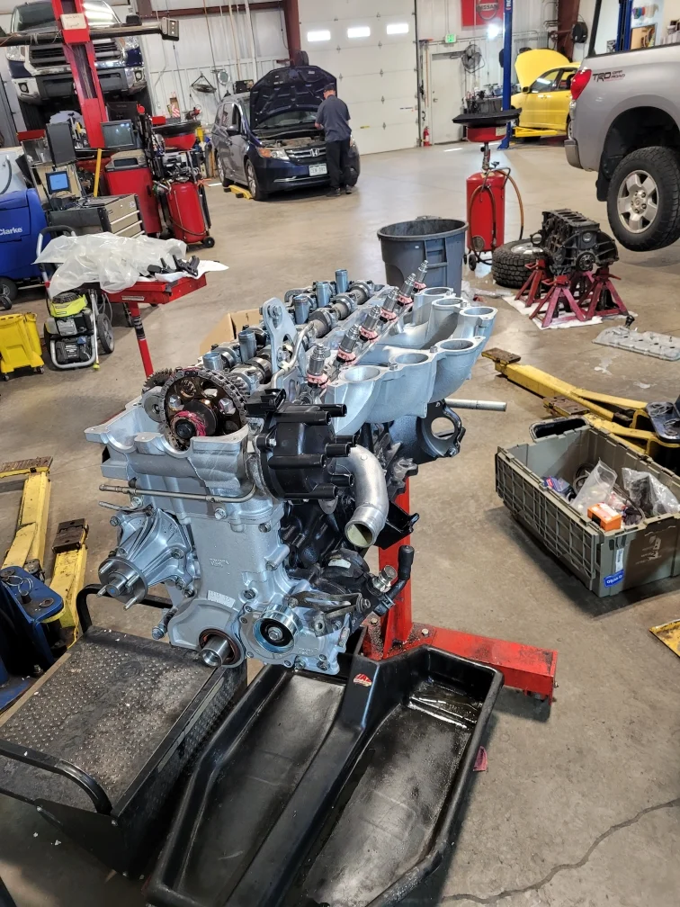

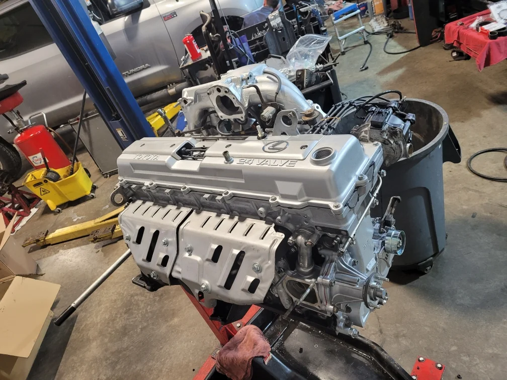

I just did a new Toyota short block and remanned the head at the most reputable Toyota shop in Denver. Lots of new bits, radiator, injectors, EGR,
full exhaust, etc. I can send you the detailed invoice if you're interested, but the total was way past what you're talking about. I traded $26k for that service.

Agreed. Prices have changed fast in the past couple years though. I'll post the invoice here shortly for the world to digest.
I like the 1FZ, it's right for what I use it for, and it's done it's job well since 1997. In my opinion, I've just set that truck up for its next 25 yr chapter in life.
