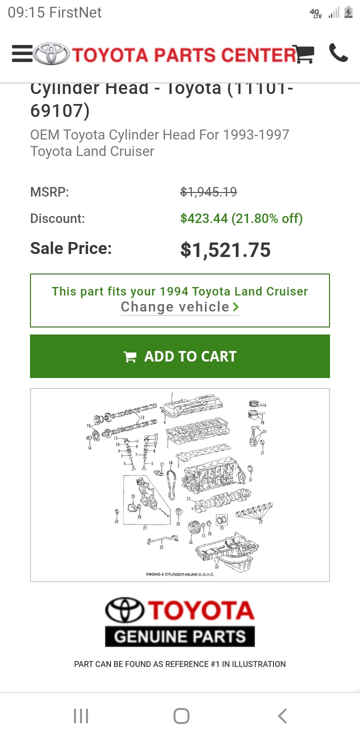

New Toyota head? Pretty sure you won't find one of those.

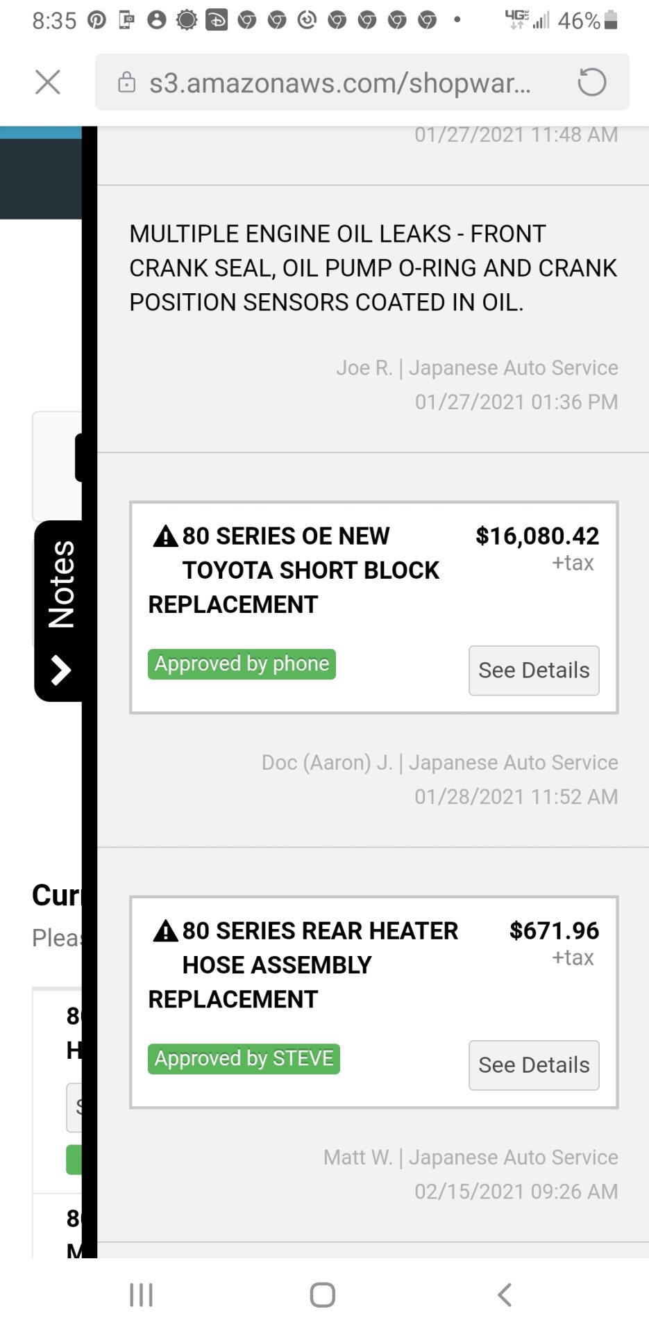

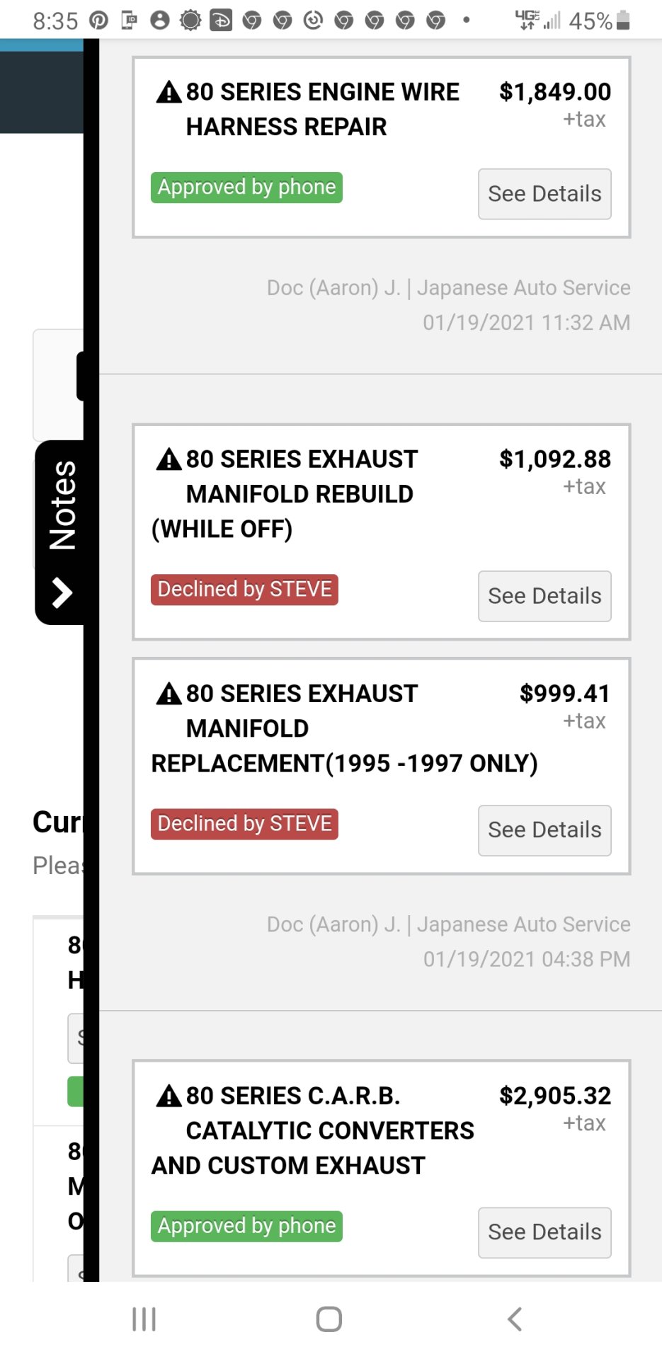

I just did a new Toyota short block and remanned the head at the most reputable Toyota shop in Denver. Lots of new bits, radiator, injectors, EGR,
full exhaust, etc. I can send you the detailed invoice if you're interested, but the total was way past what you're talking about. I traded $26k for that service.View attachment 2827904
Here's one in case you ever need it. Seem to still be available.

Nice one! I will definitely be inquiring with my shop as to why I was told it was unavailable. Thanks for the info.
I think you know this, but that is just for the casting. You still need to buy cams, valves, etc. Or reuse your old. But, you'll most likely be buying some shims at a minimum.

I have a very detailed invoice with part numbers and photos. Please pm me if you would like me share it with you. Otherwise, here is some overview.
View attachment 2828608View attachment 2828607
Not sure I understand the wire harness repair; I just put in a new one, not cheap, but ~$500+. Super happy I did that. Other prices seem odd as well, but, I did everything myself and shopped for the best price.
