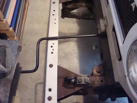

Had the need to get to TDC after a distributer change. Quick shop project to make a "Service Tool". Didn't see your post before making, but appears to be the same concept.
