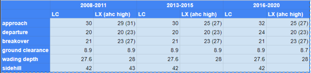

Here's some info on the relative angles between the 200-series trims. Departure is about the same (bad) for all of them as is usually the first area of concern.
I would love to know how 33-34s affect angles. Probably a nice tasty boost if anyone is inclined to measure
