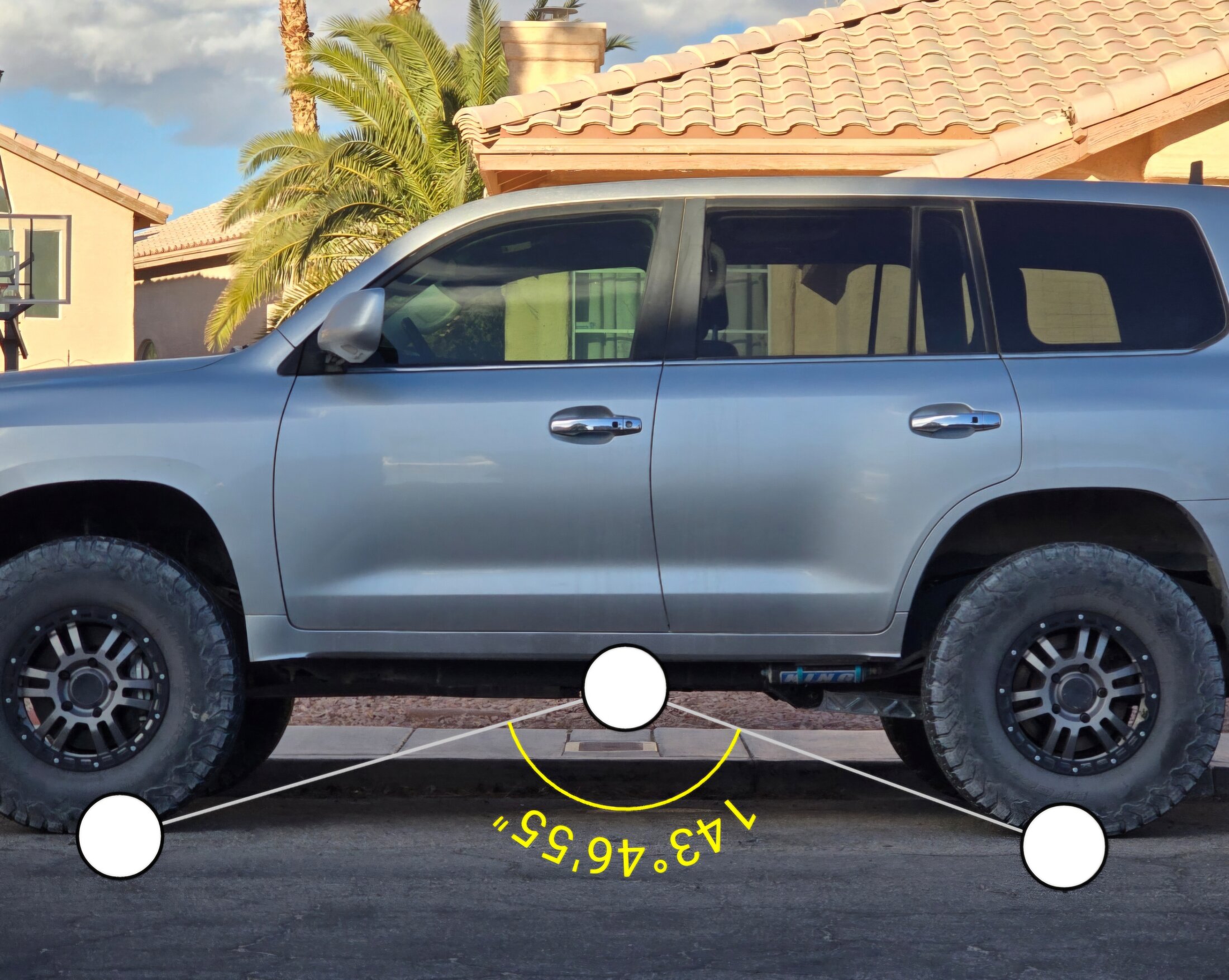

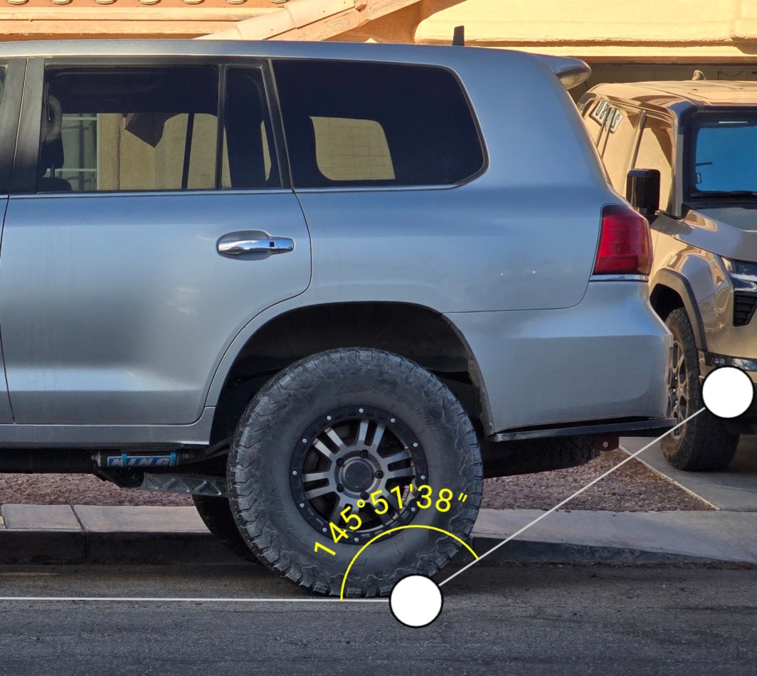

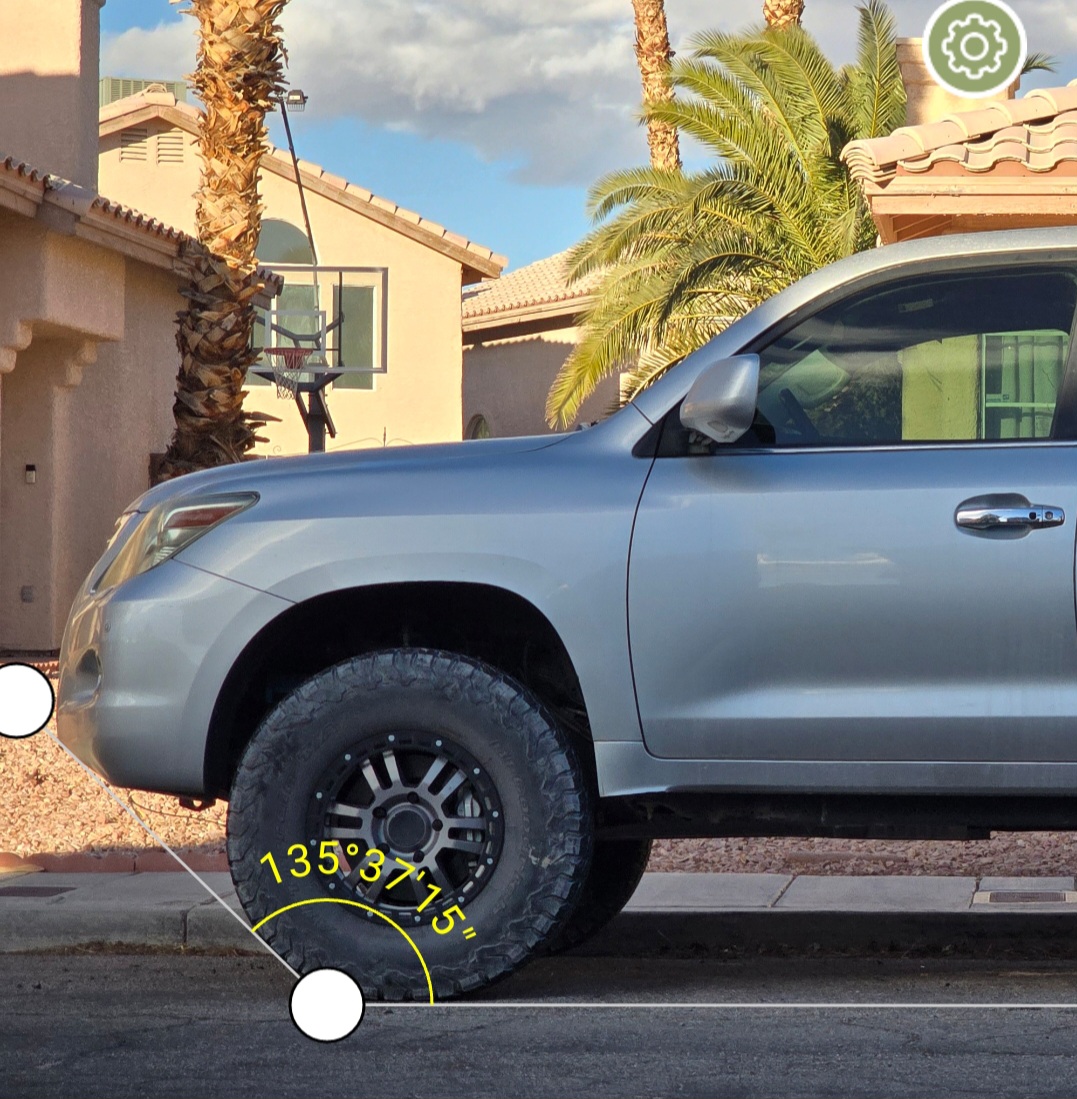

I'll join in, I think I followed your method.
