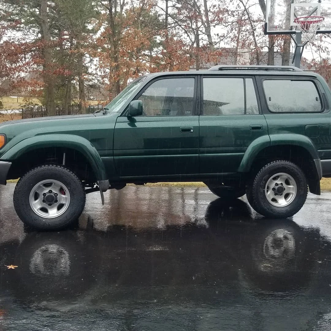

I purchased the eibach lift kit for $604 at tirerack.com for my 80 series. I did it myself over the weekend so far iam very pleased.Looks great.
Rides better than stock 239k miles not sure of the age of old shocks.

Hey thanks so much for posting that up. Did you do a before-and-after measurement? Also the front looks a little bit higher than the back. Am I seeing things?
I did no take measurements (rookie move).

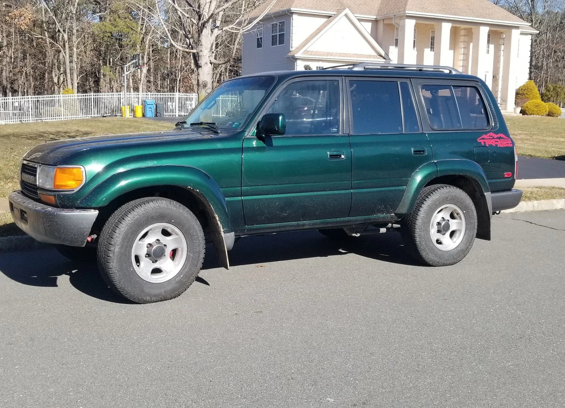

Here it is before I did the work with the same tires.
I noticed reverse rake, I feel this pic has reverse rake as well.
@mtlandcruiser How did Eibach handle the different spring heights left to right (longer on the driver side)? Were the springs different lengths or did they just give you a spacer for the drivers side?
Huh - It shouldn't be level with equal length springs. There's more load on the driver's side of our rigs. Engine, transmission and T-case are offset to the left and the fuel tank is on the left. There's a big gaping void on the right.
The cruiser gangsta lean.....
