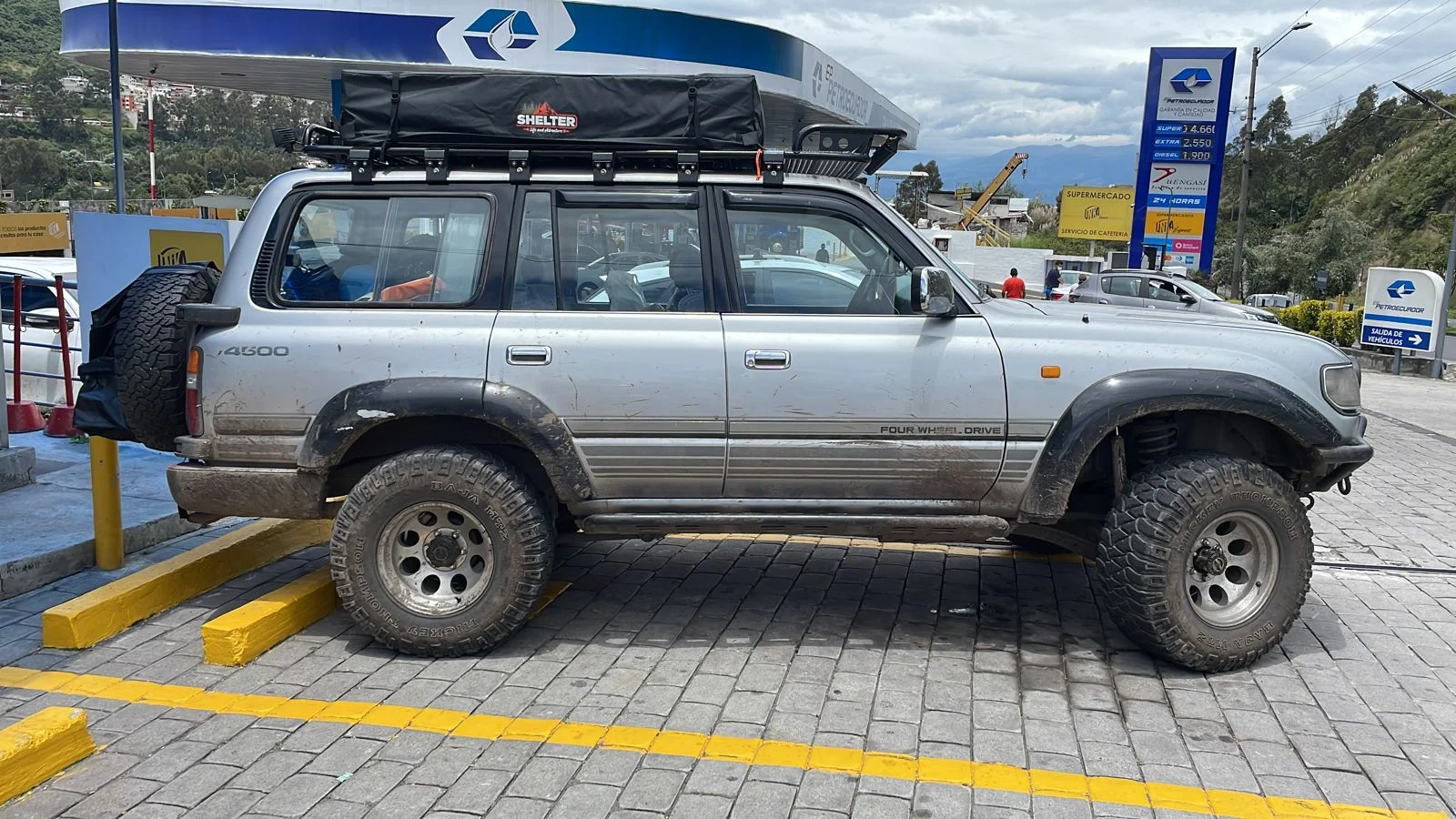

Ah well SHIIIIII%%. Im in quite a kunundrum right now. I think I might of screwed it up as I gave the OK for those shocks...... its too late now, they closed the order today. Thanks for the suggestions, Ill have to go and see what happens.
Im running 33" Mickey Thompson tires, Ill show you a pic of my rig. Dont make fun of my EIBACH suspension though!! LOL
