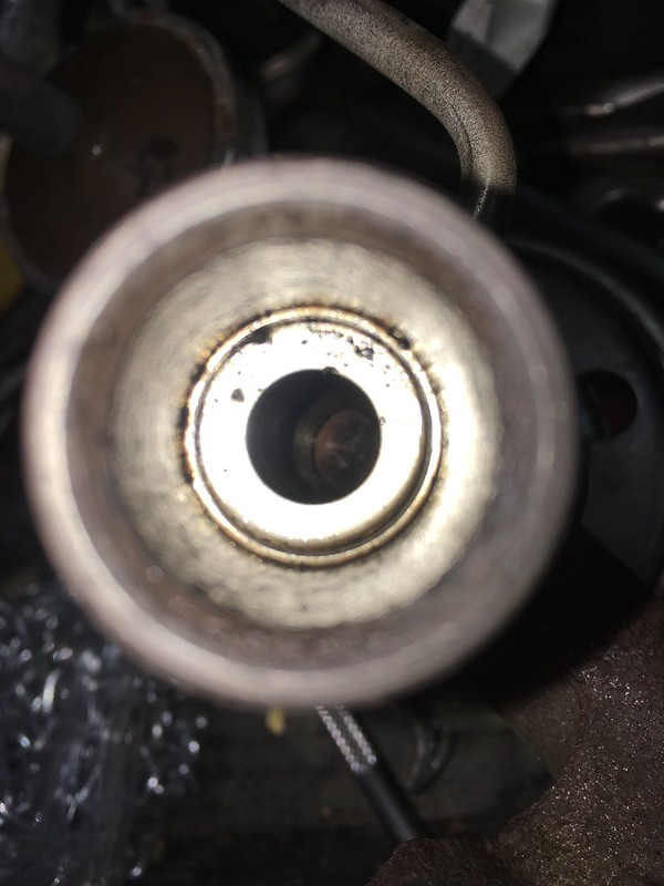

Ok, made as much progress as I am going to make. I have to blow much harder to get air through so its a huge improvement. Not perfect but its better so I'll run it. I used dental picks to scrape around the valve, MAF cleaner to blow out any chunks of crud and clean up the metal. Looks nice and shiny!
You can see the closed valve at the bottom of the tube. cleeeean :)
