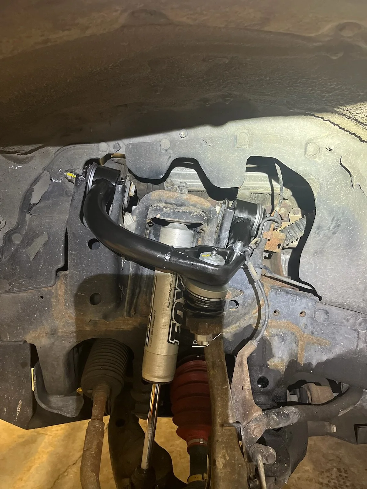

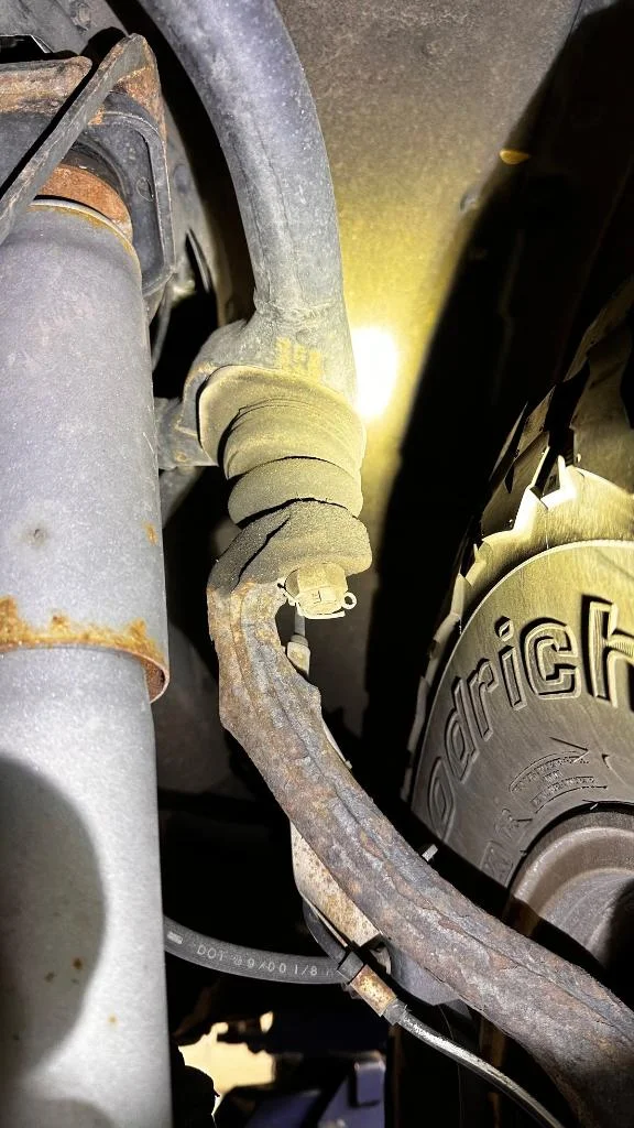

We have their upper control arms to accommodate the slight lift we’re running, and have really limited miles on them, maybe 8000 total or less. The truck went in for an unrelated issue this week that had me stumped, and the shop did a multi point check and is telling me the ball joints have totally failed. I haven’t gone in to see it with my own eyes yet but they insist they’re properly torqued but completely shot and loose. Has anyone else seen this happen, like maybe there was a bad batch of joints from a supplier? And I can’t remember, is that a replaceable ball joint?
I’m one step removed from this whole deal because my son owns the truck now and brought it in, so just trying to make sense of it and help get it resolved. Attaching a few pics they sent - I don’t see much other than the grease outside the boots, but that doesn’t really tell me anything without being able to check for play. Do you see anything visually?

Those are sold by Slee, but pretty certain that they're the SPC's. These have a user-serviceable zerk on the top that should be filled with grease every oil change. If that's not been done, they have a great chance of being shot due to neglect of the joint.

Great info, and you're right - I'd forgotten that, they're actually SPCs. I'll change the title - they're so new, it just doesn't make sense to me that they'd have failed so soon. I'd typically hit all the zerks every 5-10K, but I guess since the car sat so long without being driven it's possible they leaked/dried out and that's all it took.

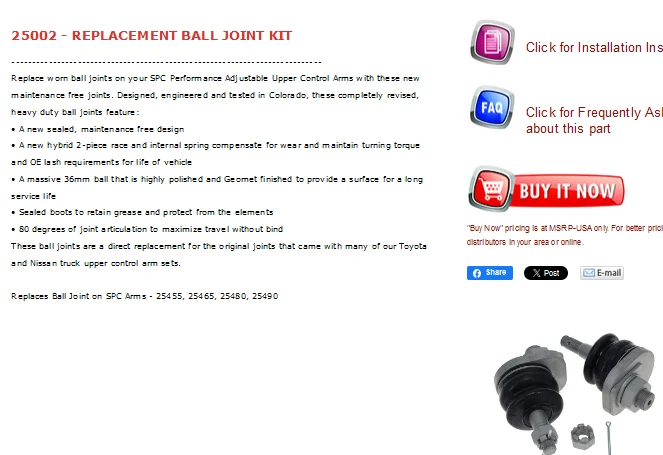

Some confusion for me on this one. I have had the SPC front UCA for years now, and for the third time (a few months ago) the BJ's on the arms had to be replaced.
History:
-The original arms I purchased years ago did not have the zerk BJ but a "maintenance free" BJ which failed after about 30-40K road miles.
-The above original BJ set was replaced with a BJ set provided by SPC that contained a zerk fitting for maintenance, which also failed after 30-40K road miles...
-The latest replacement (a few months ago) contained a maintenance-free (NO ZERK) BJ of a "new" design supplied by SPC
If I am to believe the website, the "newest" design goes back to a maintenance free BJ, and these are what I received from SPC a few months ago. Note the lack of zerk in the picture and no claims to grease/maintenance in the description. Unless I am wrong, the latest UBJ from SPC do NOT have a zerk.
Either that or I received New Old Stock...tough to know.
