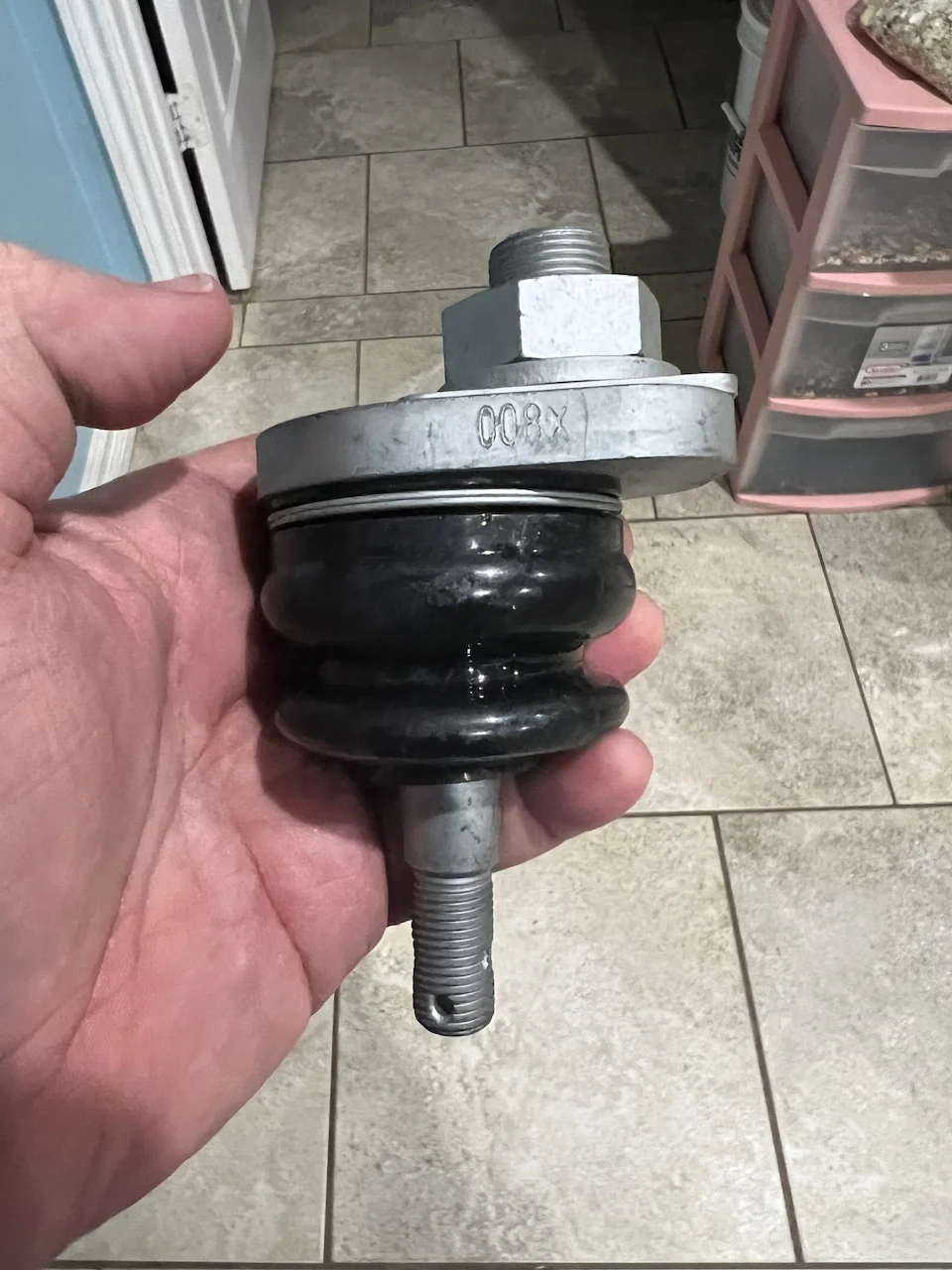

Got the new ball joints, and they are maintenance free.
Got this from SPC. You can convert the new ball joints to greasable if you care to.
The above boots have been discontinued by SPC.
Does anybody know where I can get new boots. Internet came up empty.
