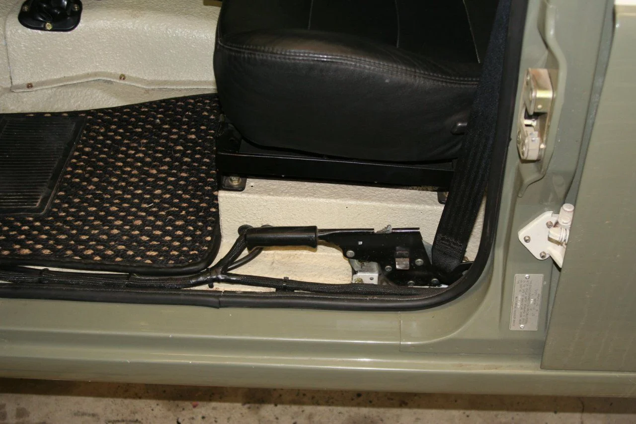

I put a 60 e-brake on the side of my 55. I know different animal, but problem with mine is I have to open the door to apply or release the brake. With the door closed, there's not enough room for my arm between the seat and door. When I go to a FF axle with discs, I'm going to a dual line lock. Something to think about before cutting.

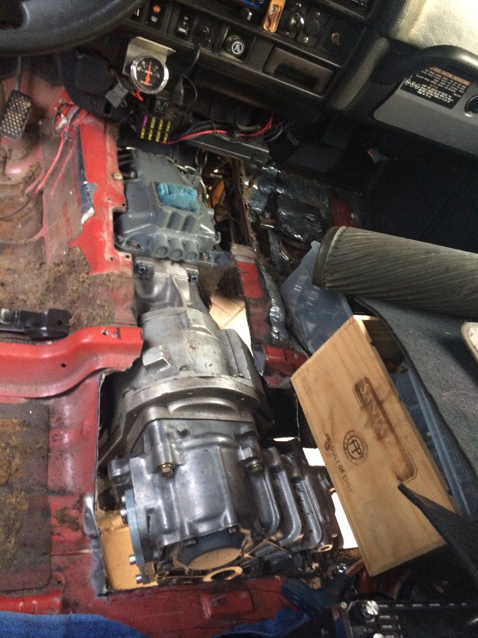

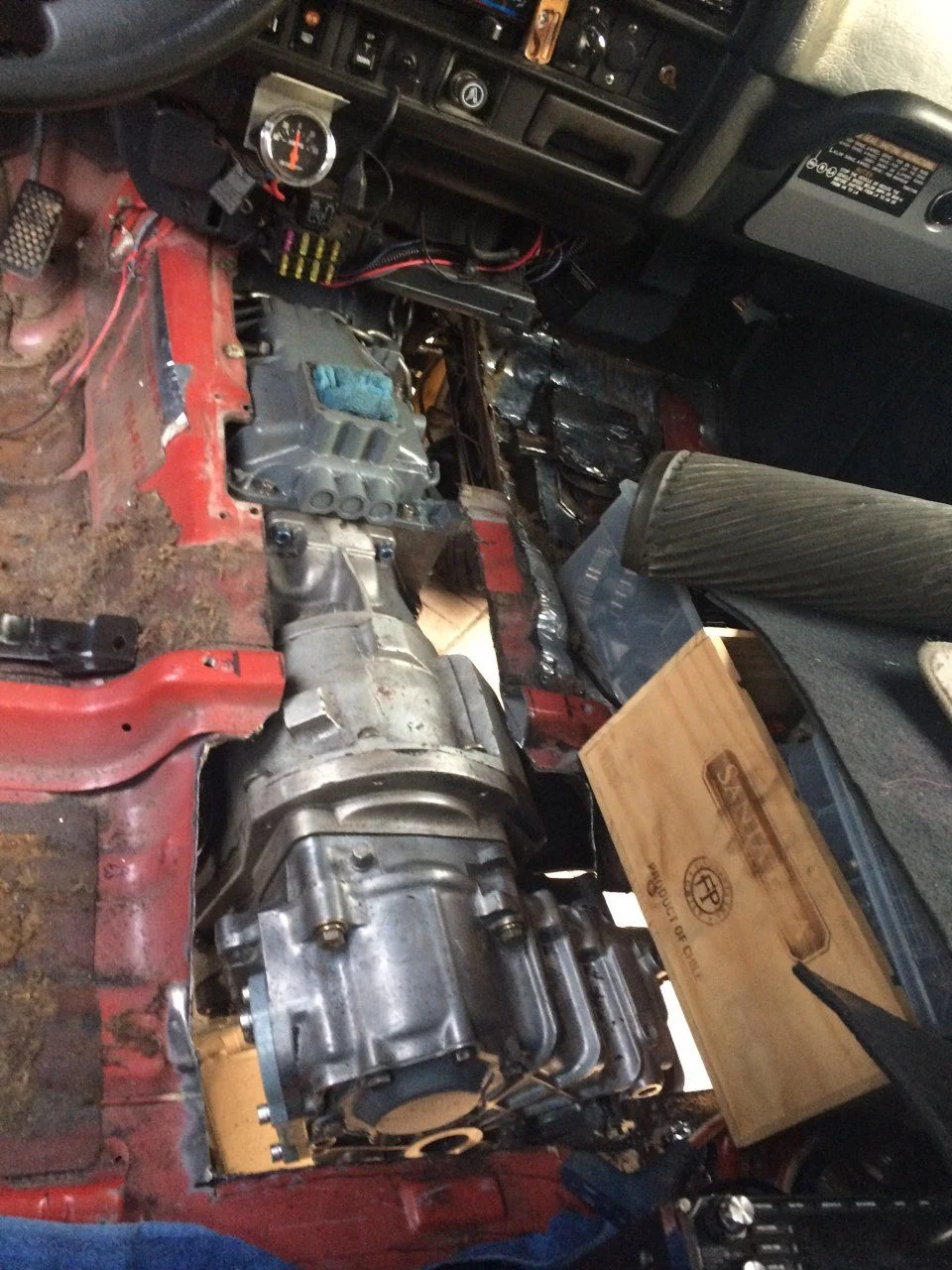

For anyone wondering, this is why I'm doing this. The e-brake's stock location is now taken up by a 203. :eek:
Well, not going to work because there's not enough room with the door closed to pull the handle. However, there's a trick up my sleeve...

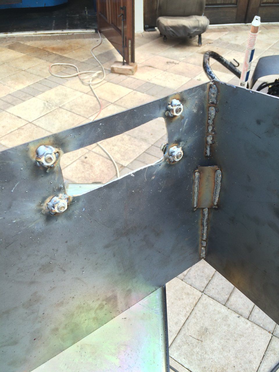

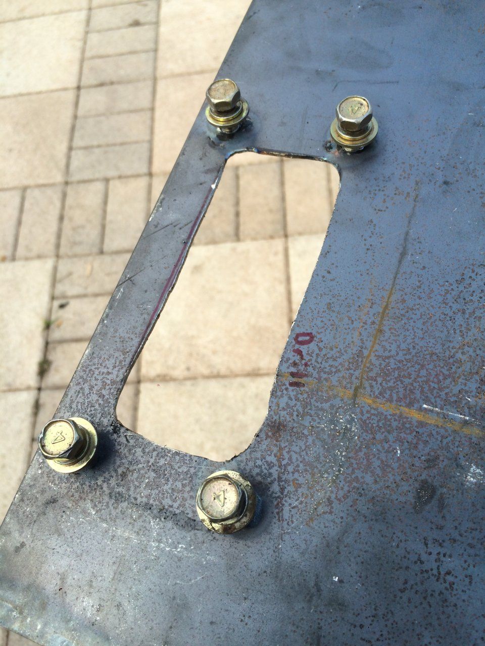

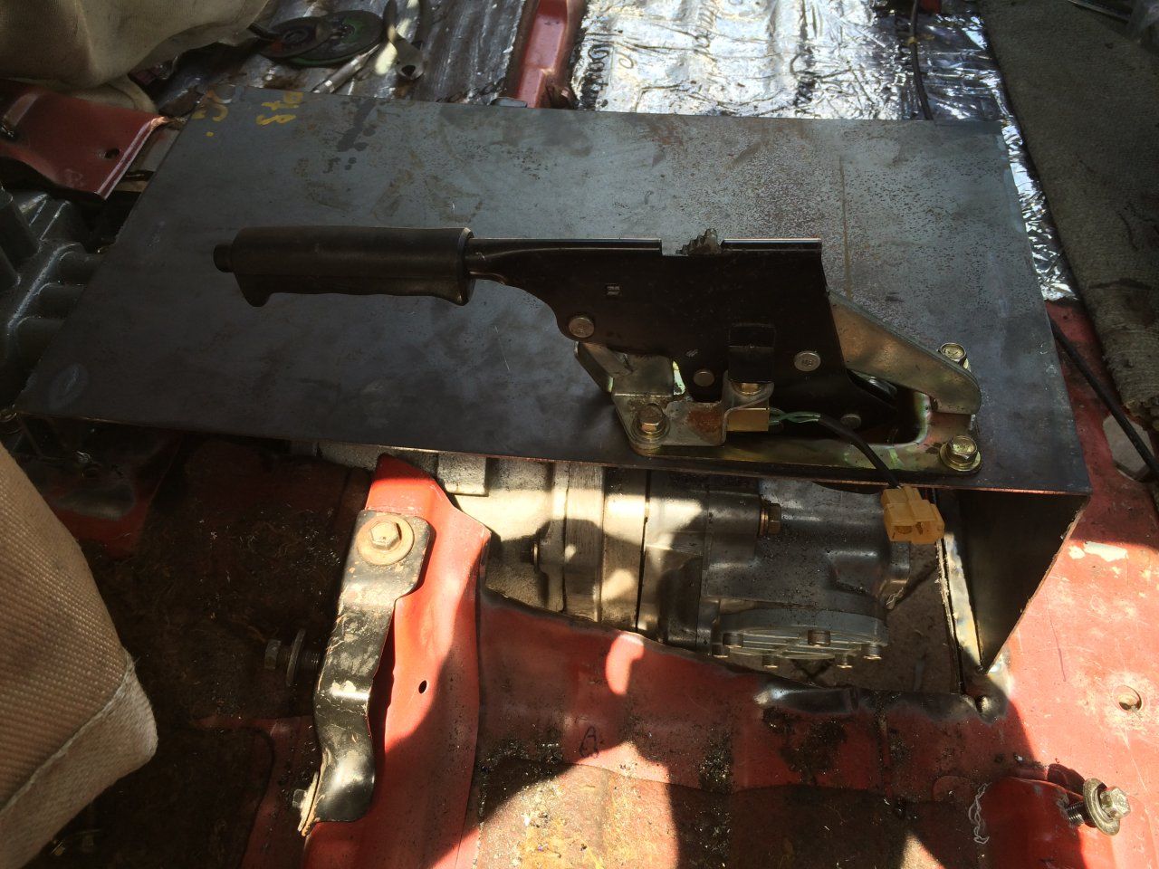

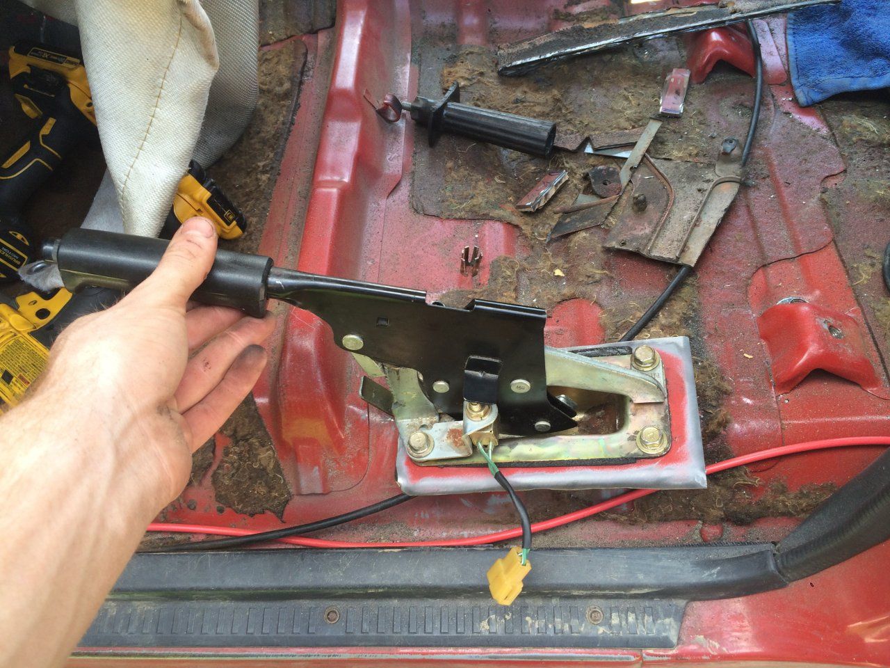

That's what it looks like I'm going to do, kind of where it is factory just higher up. The floor section I built looks like it is going to to lend itself very well to this, and the mounting of a Tuffy console.
Now there's a perfect spot for an 8" Tuffy.
