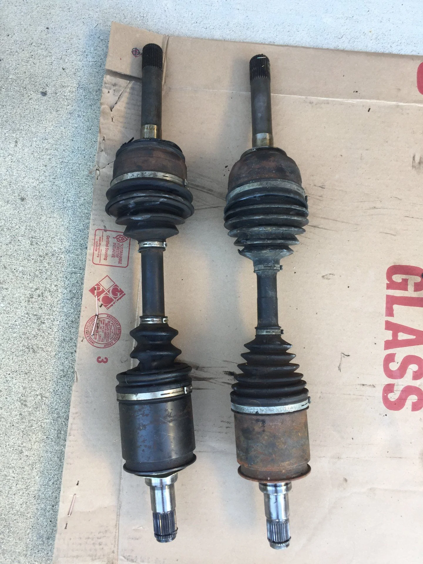

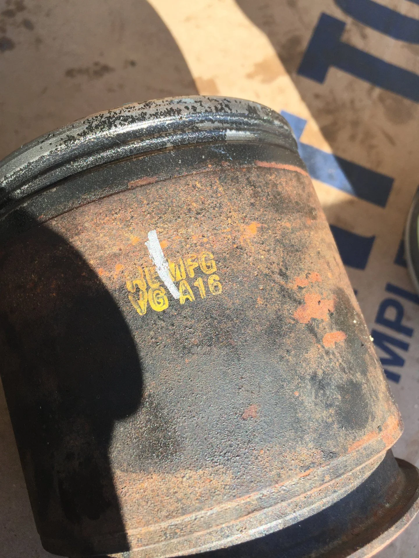

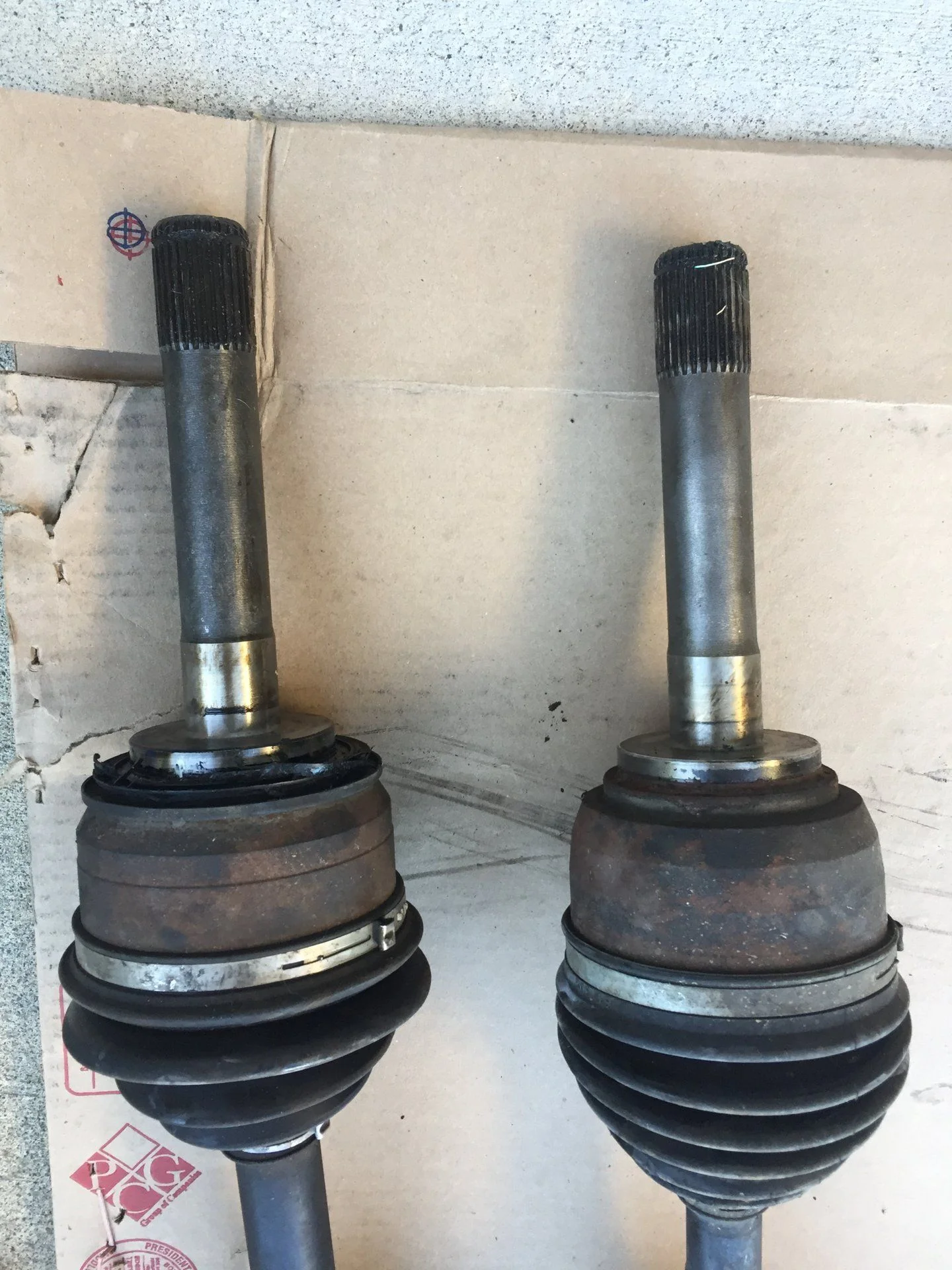

Once I got my axles out (I removed the diff too - I'll reassemble it all once the diff is rebuilt) I could see they don't match. The ps appears aftermarket. I see no markings and I haven't cleaned it out yet but the boot says 'Interparts'. The ds is stamped 'REMFG VGA16' and I assume it's a reman oem part.
I was planning to reboot & repack both sides but I'm wondering if it's worth the time to redo the aftermarket one (assuming that's what it is). To my untrained eye the ds assembly (remfg) looks in pretty good shape. Very minor pitting on one bearing that I can barely see, a bit of wear on the inboard splines, and some irregularities on the basket cutouts. However, it has no dustshield at either end. The ps assembly (aftermarket?) has a dustshield at the inner end where it meets the diff and a dustshield along with a gasket or bushing (but very detiorated) at the outer end where it meets the knuckle. The ds assembly is missing both.
Any thoughts on this? I'd like to replace the aftermarket axle assembly with a rebuilt one from CVJ, and just reboot the remfg assembly. I'd maybe reboot the aftermarket one as well just to keep as an emergency spare, depending on its condition once I clean it up.
Does the ds look like a good candidate for a reboot? Should it have dustshield? Does anyone know if I can get them individually or have part numbers? Have I correctly identified them as aftermarket and reman oem?

Two shafts. PS (aftermarket) on left, ds (reman) on right:
Ds stamp:

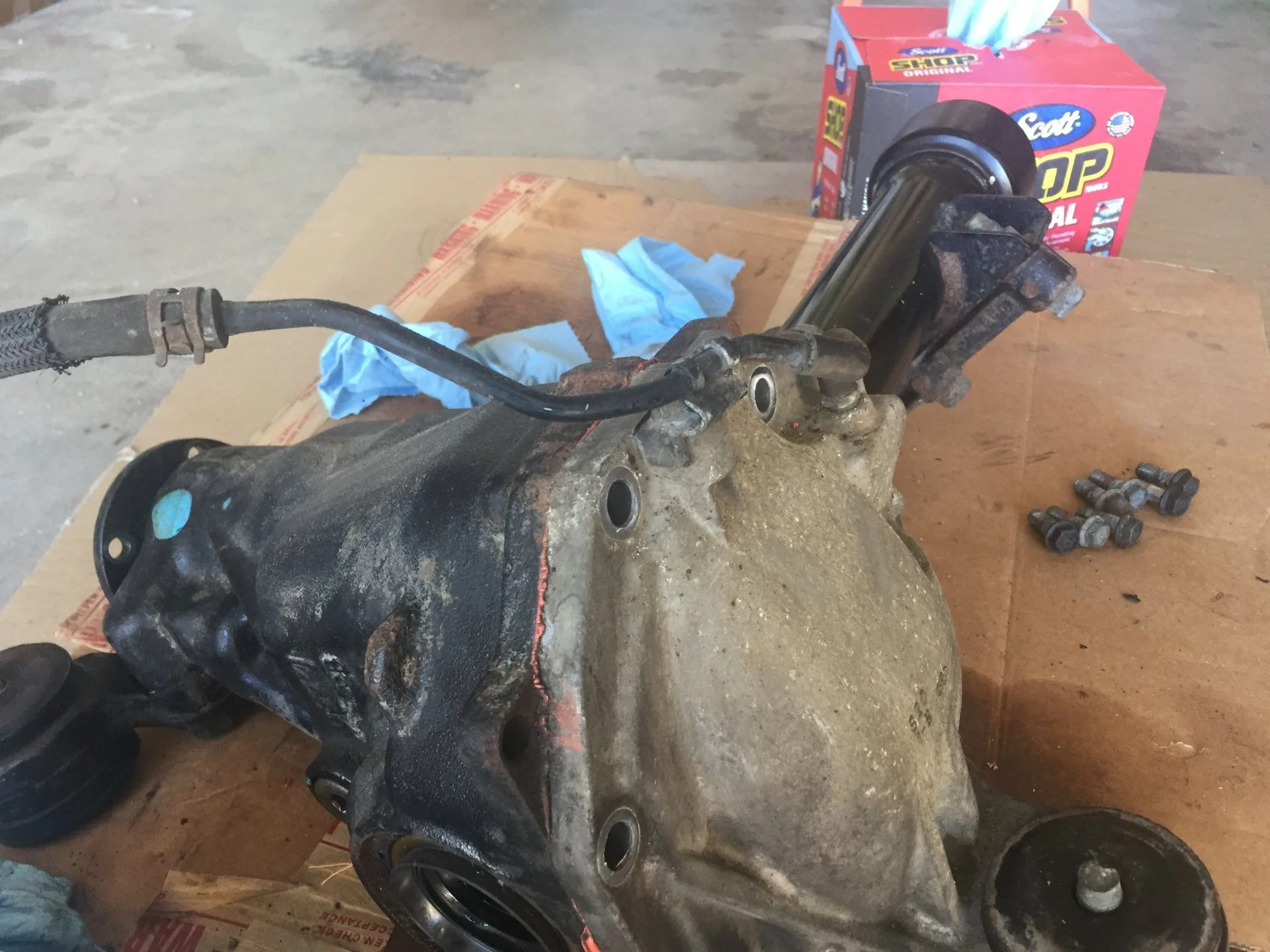

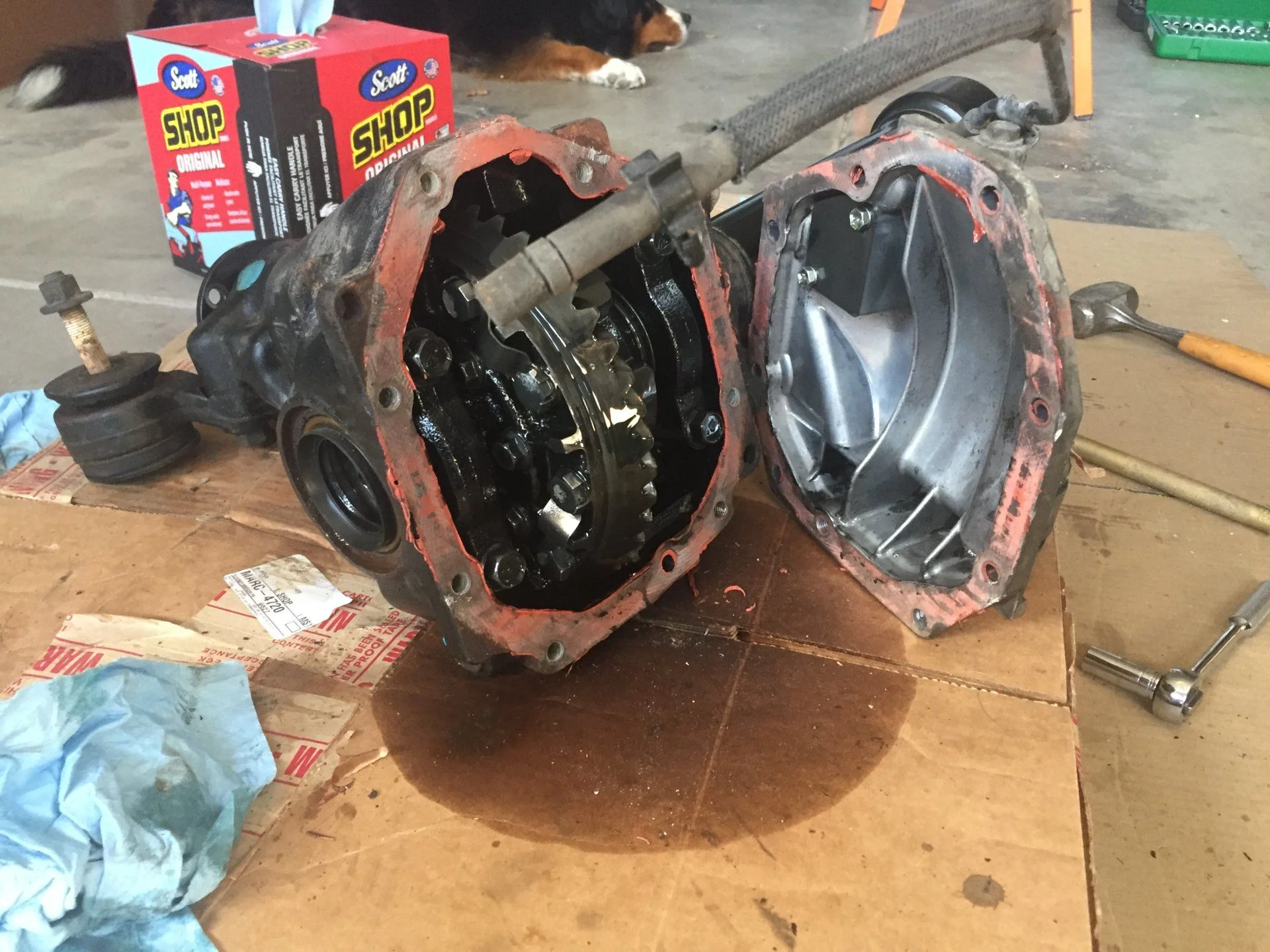

My new front diff will come tomorrow. I had a look at my old one. I wonder if it’s been rebuilt.
The axle tube looks to me like factory finish, shiny. The diff housing also looks like factory black cast. The spot of blue paint near the pinion flange makes me wonder if it’s a reman. The housing cover is a different finish from the housing (silver, not black). And loads of red fipg.

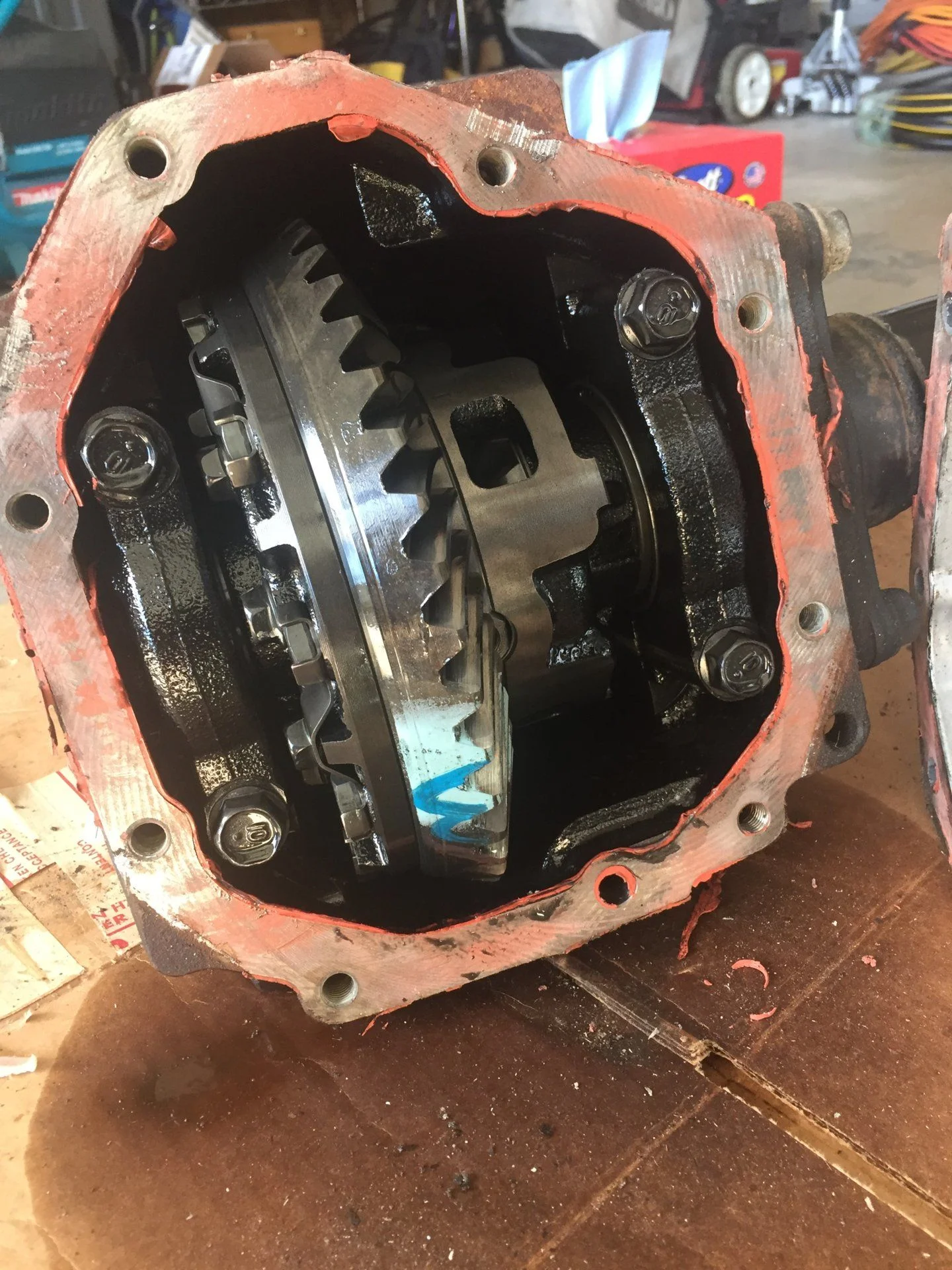

Opened up:

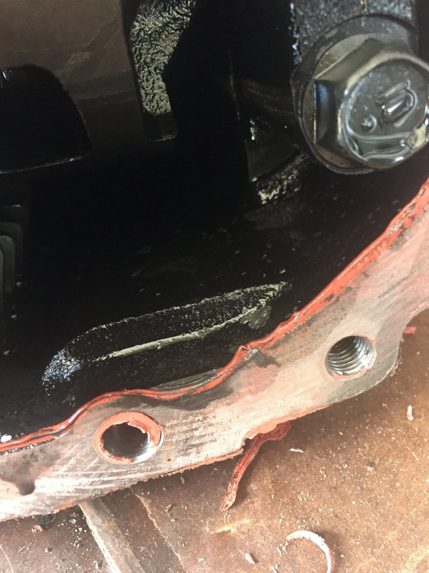

There’s ‘mud’ inside that looks like pulverized metal. It’s dark graphite color here inside the cover:
And also here inside the housing it shows up lighter against the black, a little harder to see:

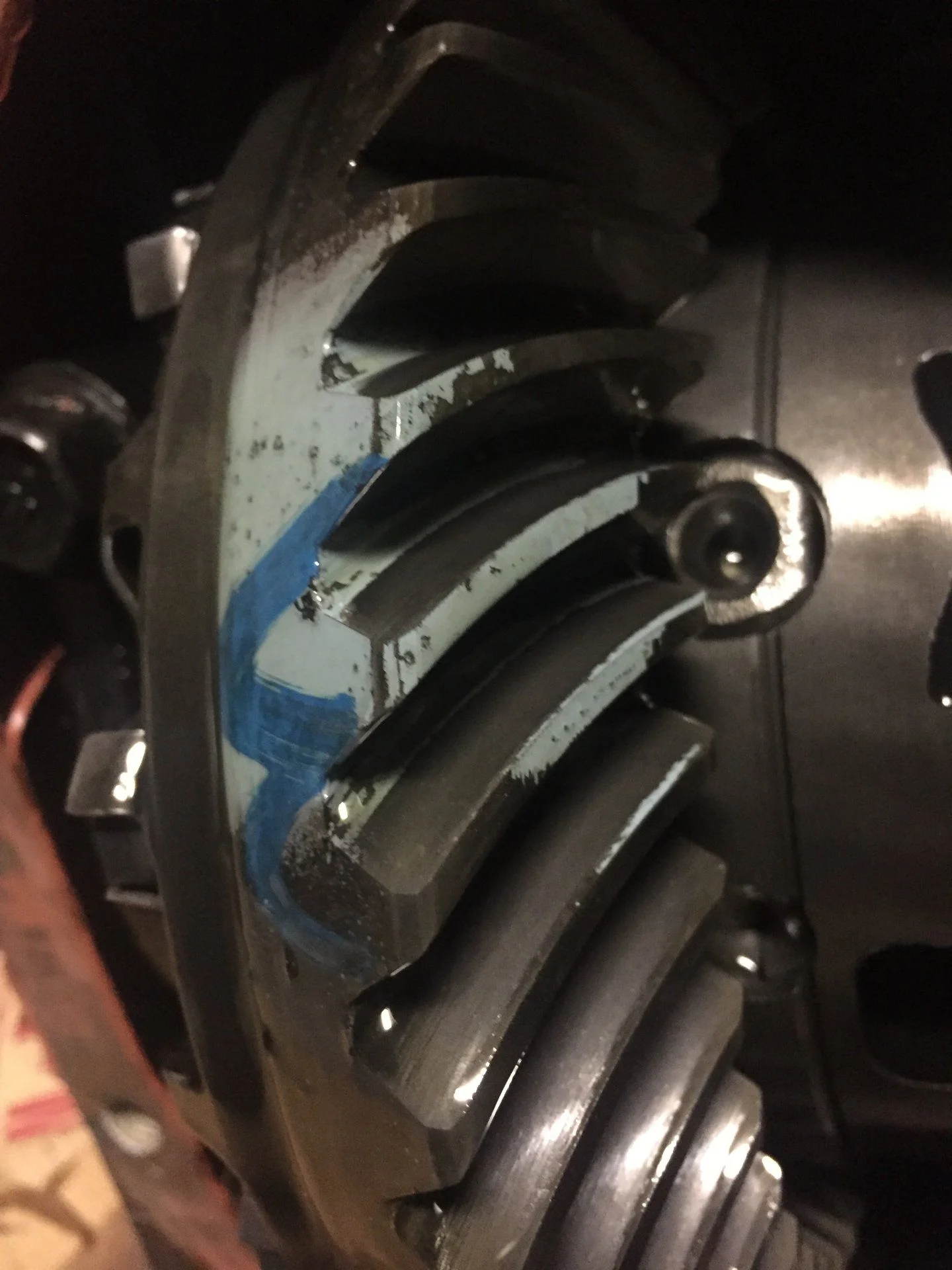

There’s also blue paint on the ring gear. Reman?:

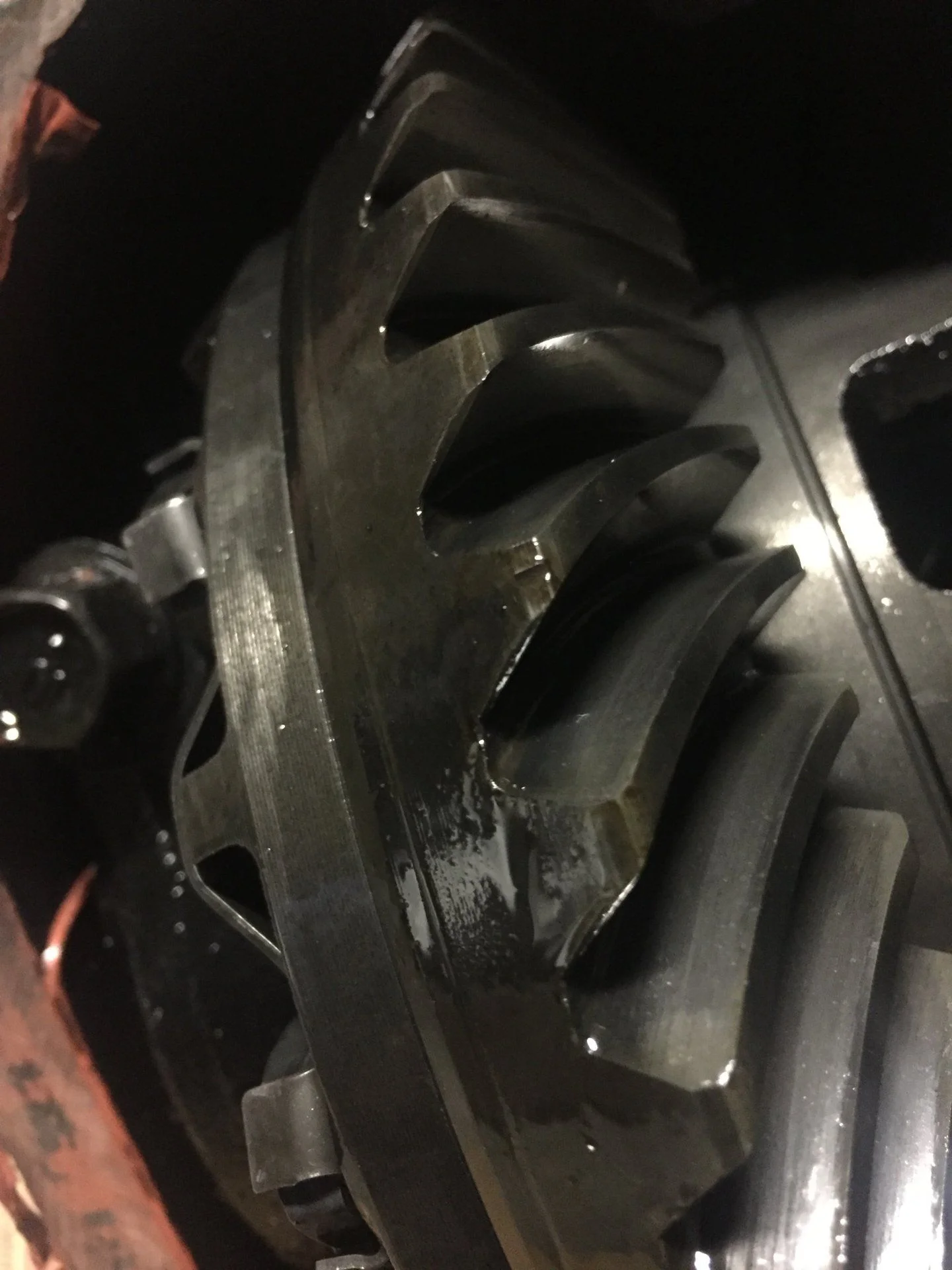

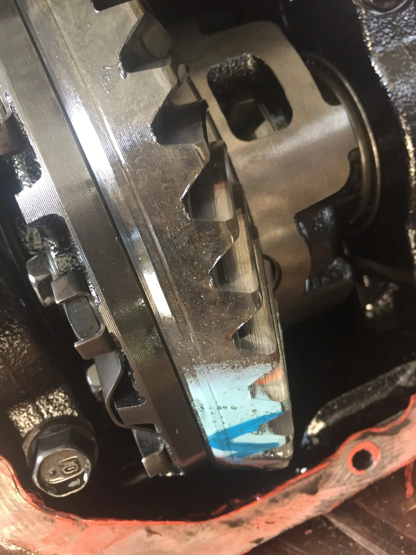

The outer edges of the teeth are worn, especially in the valleys:
Maybe that’s where the ‘mud’ is made.

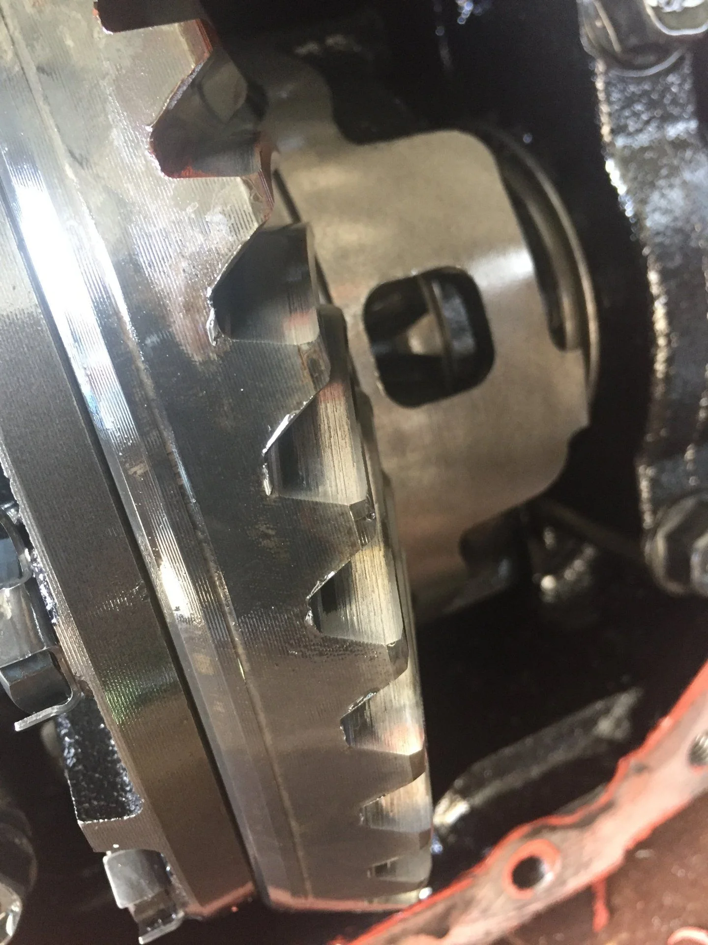

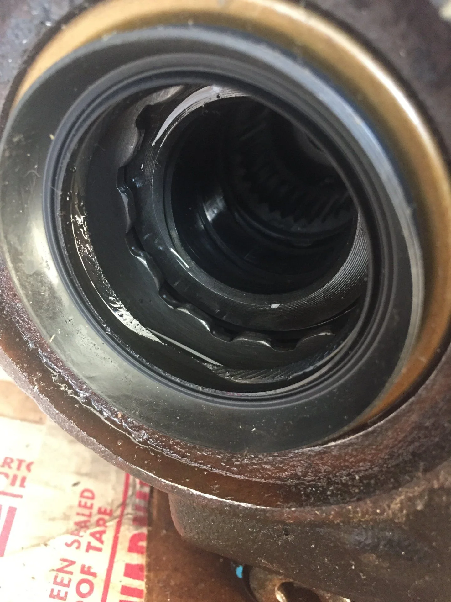

Looking in past the right axle seal I can see wear on the shallow teeth closest to me. I’m not sure what this ring is:
Nothing appears to be broken but there’s definitely wear.
I can’t post the video here but when I turn the pinion flange or the ring gear by hand it makes a grinding sound. Maybe I had more life in this but it feels like it was slowly chewing itself up.

Are the lower teeth in the second to last picture scored?
Was the gear lube very low?
I think the lines on the face of the teeth are from the machining/manufacturing process. They feel smooth but do catch the light. I could be wrong. But I do see a nick in the end of at least three separate teeth at the top/apex:
Also, looking at the spot that has been marked with paint, there is some indication of uneven wear:
