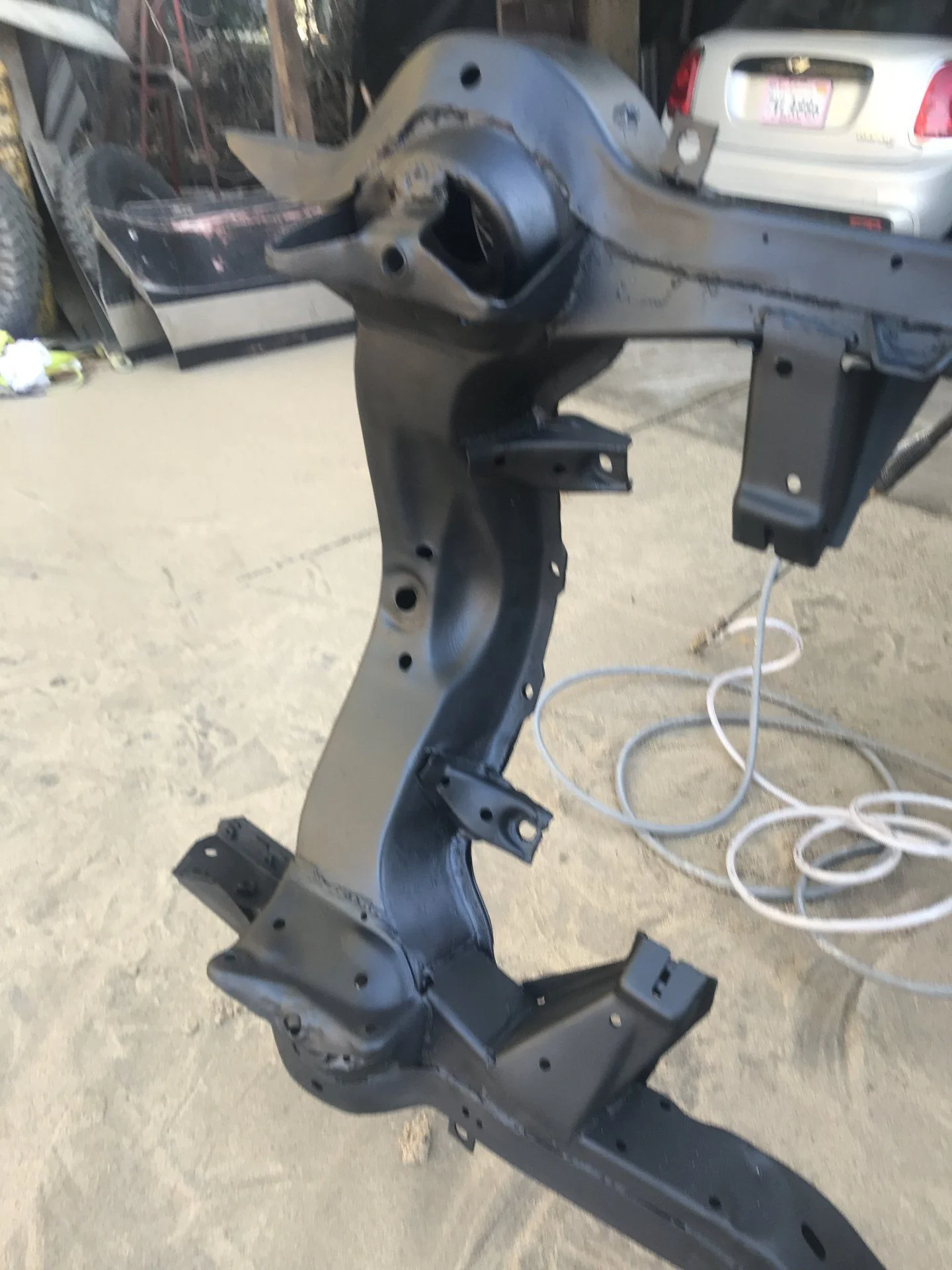

I will ad that at first I was discouraged , was taking a long time, but after about an hour of experimenting, I found that lowering the pressure to just the right amount really increased the Venturi effect. AND very important, I only blast on hot sunny days and the sand had been baking in the sun! This also helps with getting it dry quickly and then it’s an hour of air blasting all the sand out. It then gets primed ASAP. It will flash rust if this is not done. I had no issue with any panel warping ( 67 45 does have thick sheet metal. Here is a corvette frame I did a few weeks ago.
