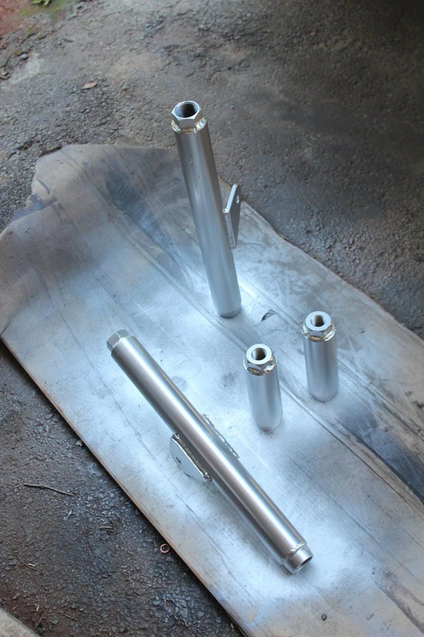

Back to business, I finally got all of the parts to finish up the front radius and caster arms. I painted them and installed them.

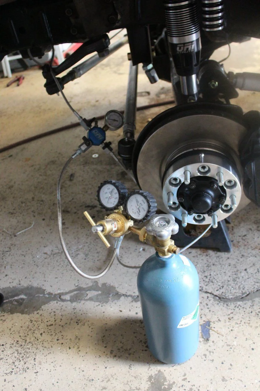

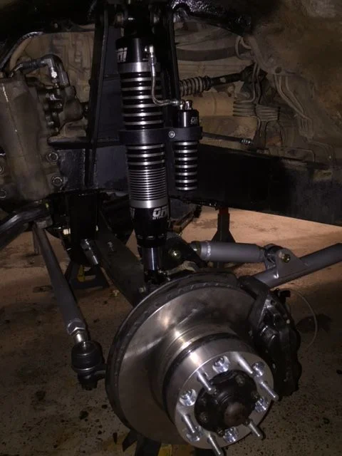

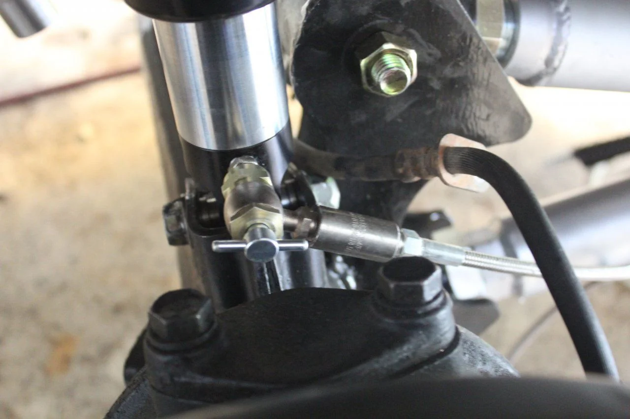

I charged up the shocks last night to 100lbs on the lower chamber and around 150lbs on the upper chamber. It looks like I may need some more in the upper as I need to raise it up for my panhard to fit. Some more fiddling with the air pressures is required, but ORIs instructions make it REALLY easy to adjust and setup.
Their no-loss air chuck is required for filling high pressures through a schrader valve.

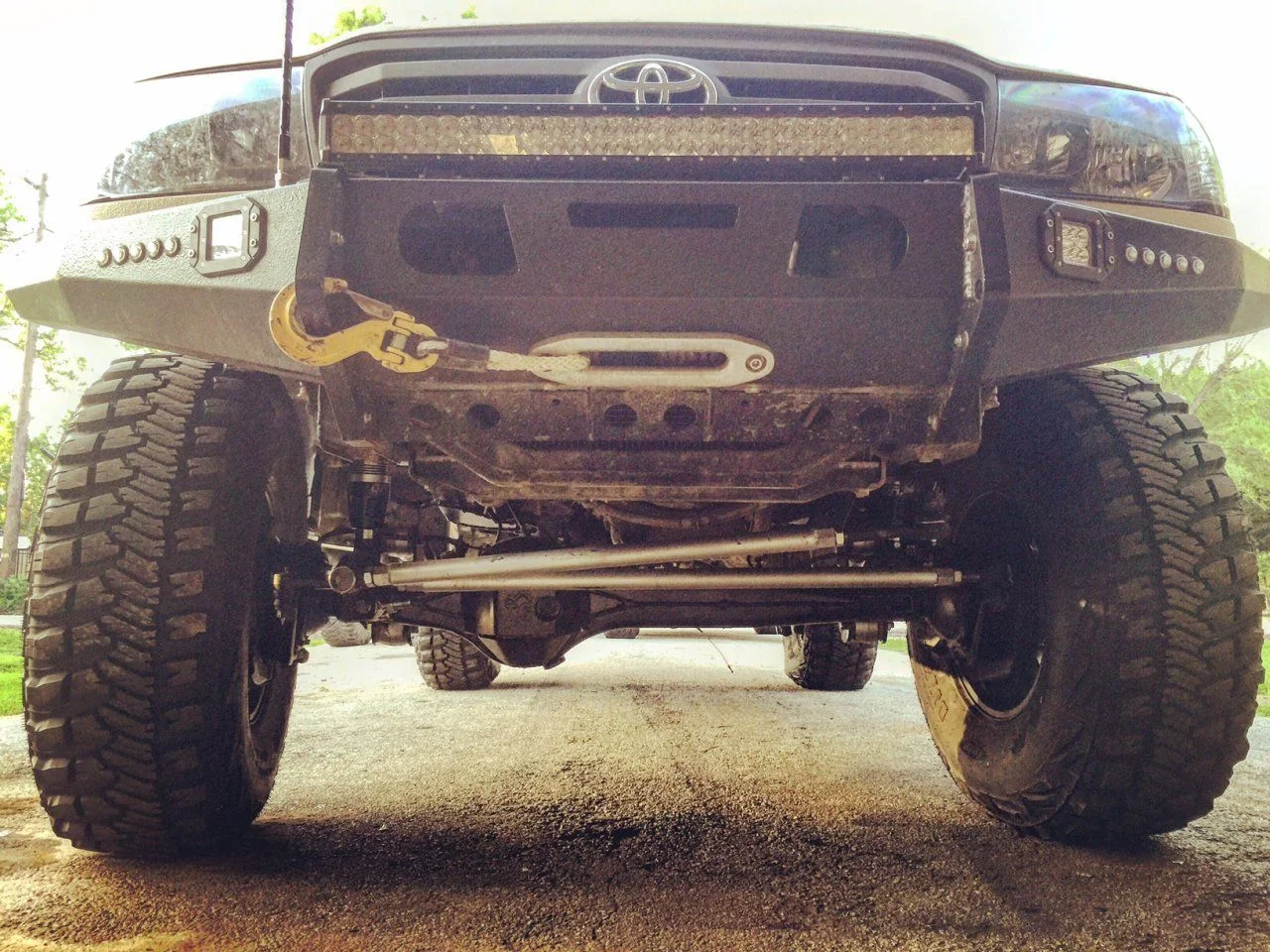

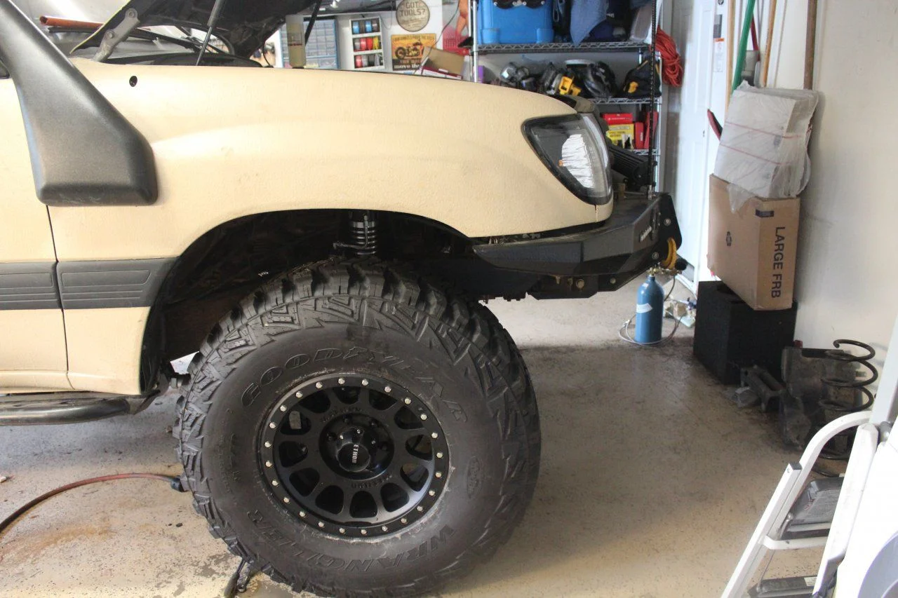

Everything tightened up in the front end and I wanted to see how my placement of the axle was so I installed a wheel. Looks good.....

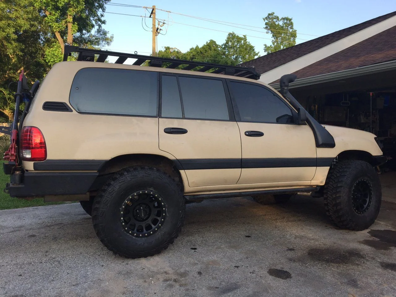

Yes it is! I ran into some issues with the rear brakes but was able to finally find some FZJ80 backing plates from @mel lowe here on the boards. The problem I had was that the axle I had was a '92 with disc brakes BUT the disc brakes that came on them are much smaller than the US FZJ80 discs. After much run around with trying to find the correct shoes, rotors and backing plates, everything came together yesterday and it all fits perfectly. I rebuilt the e-brake shoes with all new hardware, adjusted them and bled the rear brakes. Tires went on and lowered the 37" MTRs to about 4lbs of air each and it backed out on it's own out of the garage last night. I was pretty tired after working all day on it, so it's sitting in my driveway and I cannot stop staring at it!
I still have some issues to work out such as proper front brake lines. I found out that the OPOR rear lower control arms will not work so I ordered up some Johnny Joints to make some new arms. OPORs will hit the for sale section soon for anybody with bent stock rear LCAS.
It's not ready to hit the road yet, but almost there! I have 15 days until my event so I should be able to make it. Cutting it close though.

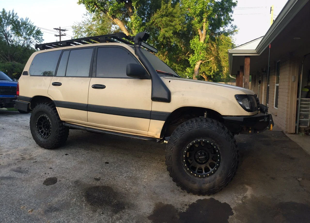

Front tires do not have camber. It's some weird picture effect that's causing that.

Is the rear axle shifted forward in the wheel well, or is that another optical illusion from the camera?
That's a pretty impressive transformation in just 2 months!
Good eye. It is shifted forward, which is why I had to order JJ and build new arms. The clearance to my sliders and the inner lip of the wheel well is too close for my liking.
