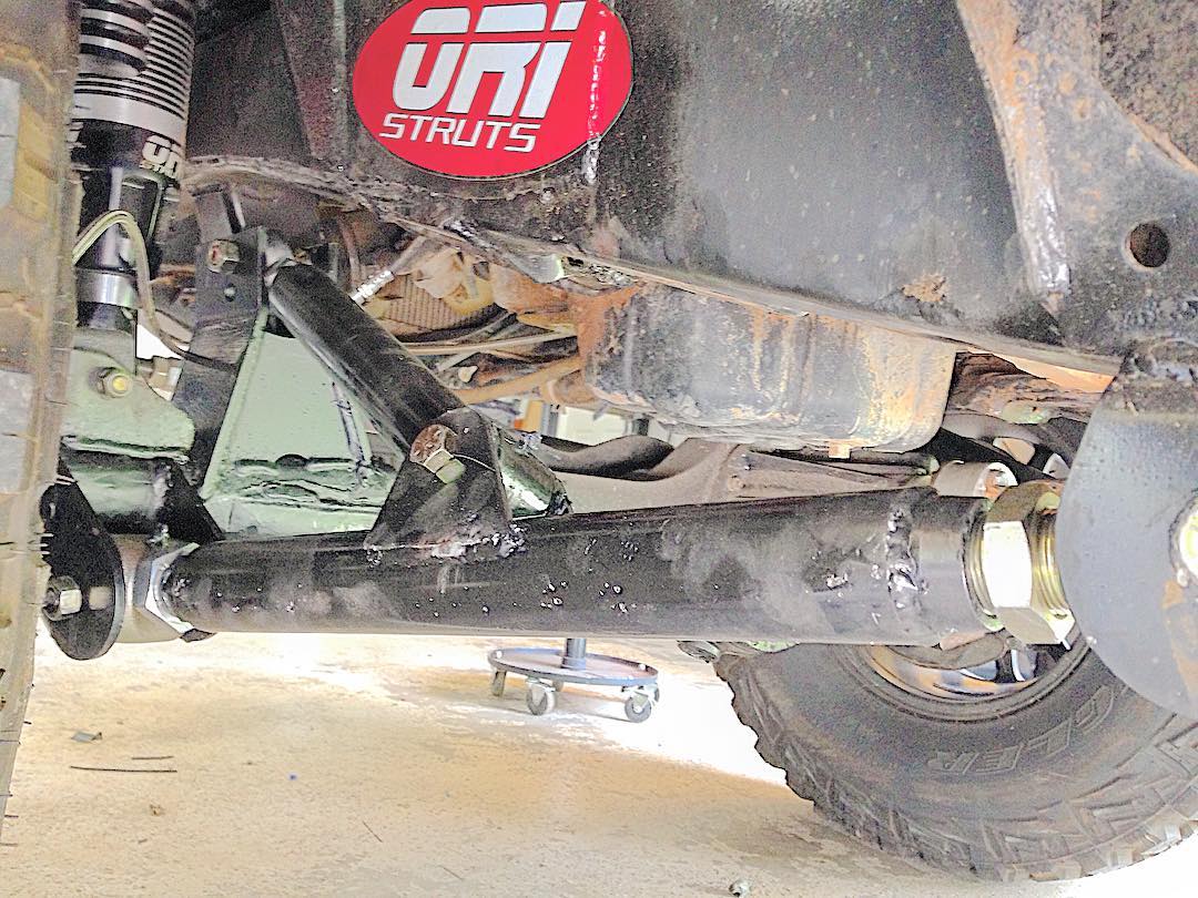

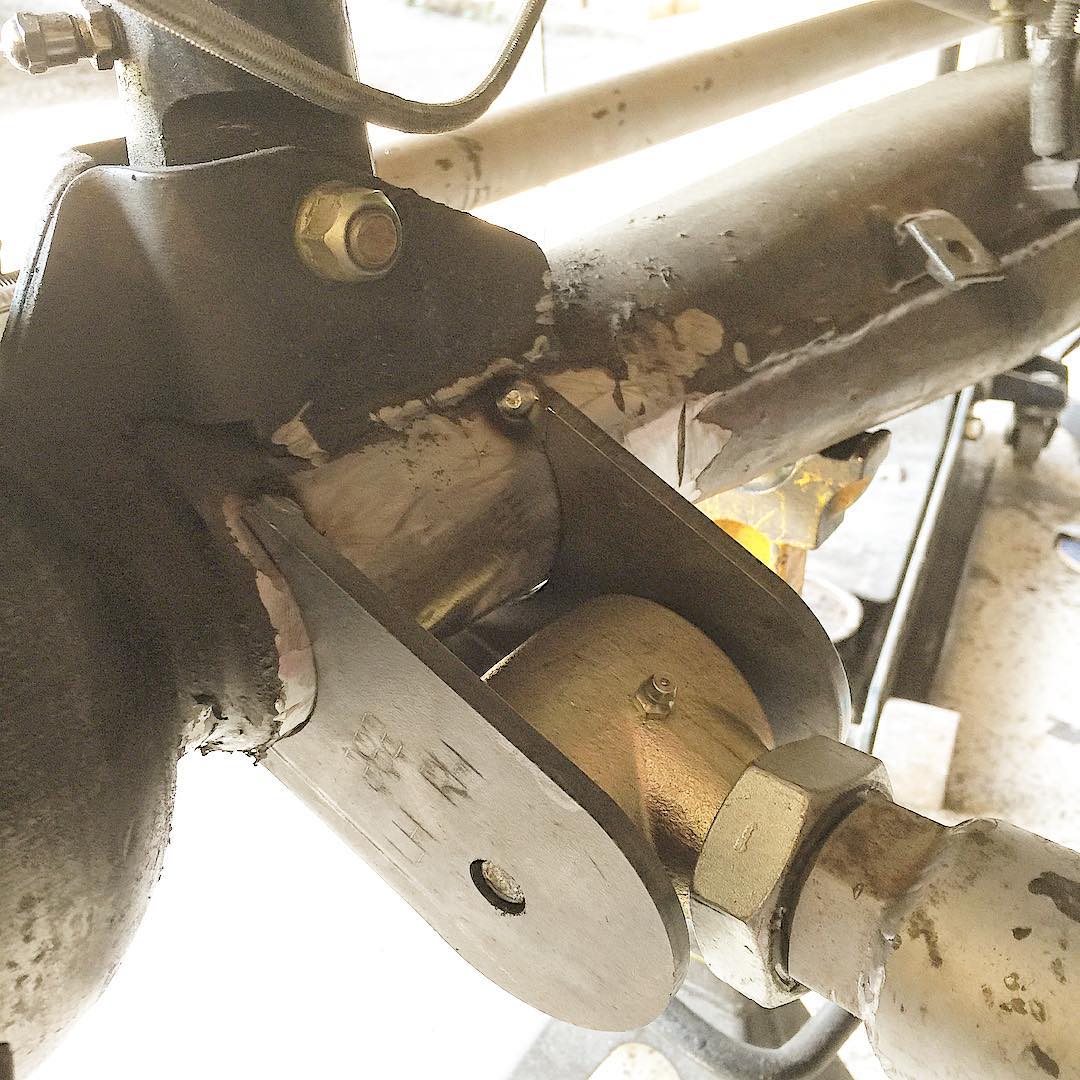

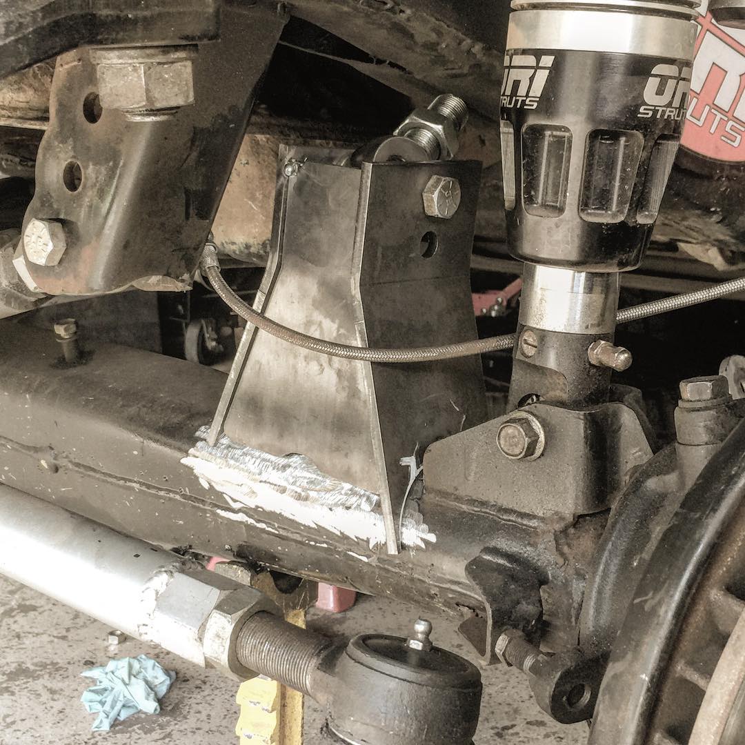

First off, I found out why the previous setup failed. The poly bushings I used provided no flex when articulating so the weakest point were the mounts and they let go. After weeks of deliberation, I went with 2 5/8" Johnny Joints for the lowers and went with some super beefy lower and upper control arm mounts.
Lower tacked in with JJ
Uppers tacked in
Upper and lower setup complete

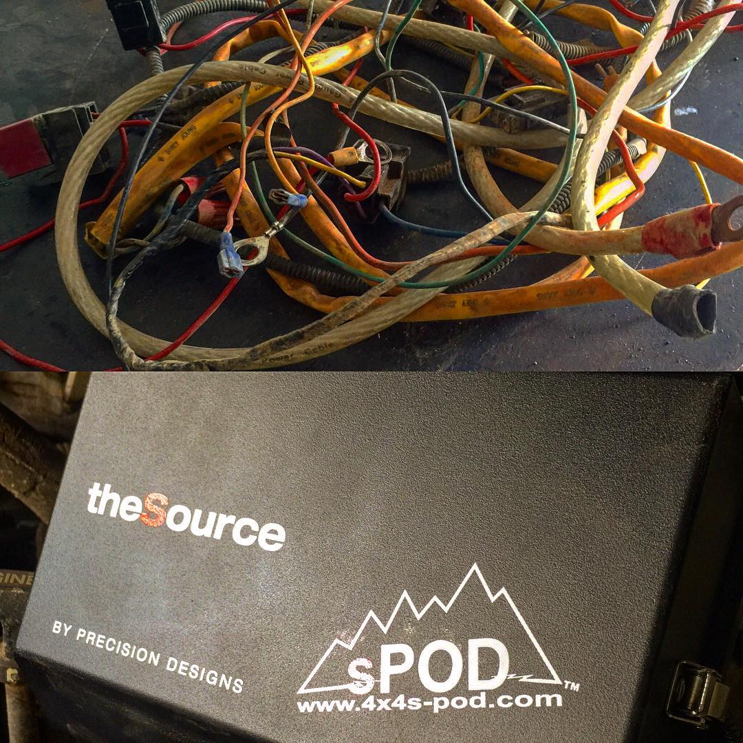

I installed "The Source" sPOD system which is a waterproof and weather sealed system. The basic premise of this system is that you run one wiring loom into your cab and hook up the switches, run ground and power to the box, and then run all of your accessories to the box. This makes it uber simple to wire up any new accessories.
It also allowed me to lose a ton of wiring in the truck, which honestly was a fire hazard and a pain in the ass to look at everyday.

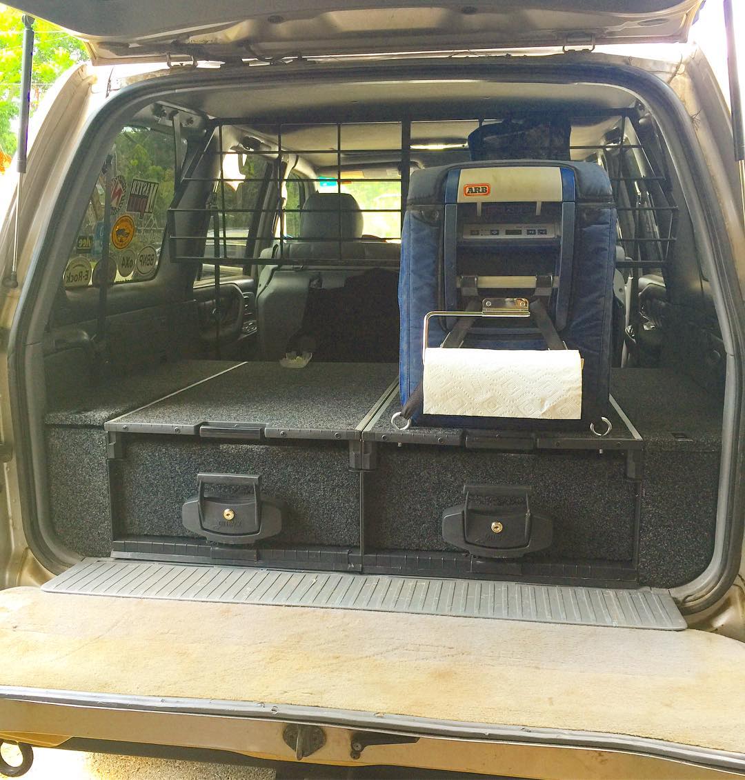

I picked up a set of ARB drawers from a member in Dallas with dual roller tops. I had a dual drawer system before but was simply not pleased with it. The ARB system is top notch quality and I also got rid of the ARB fridge slide which was no longer needed.

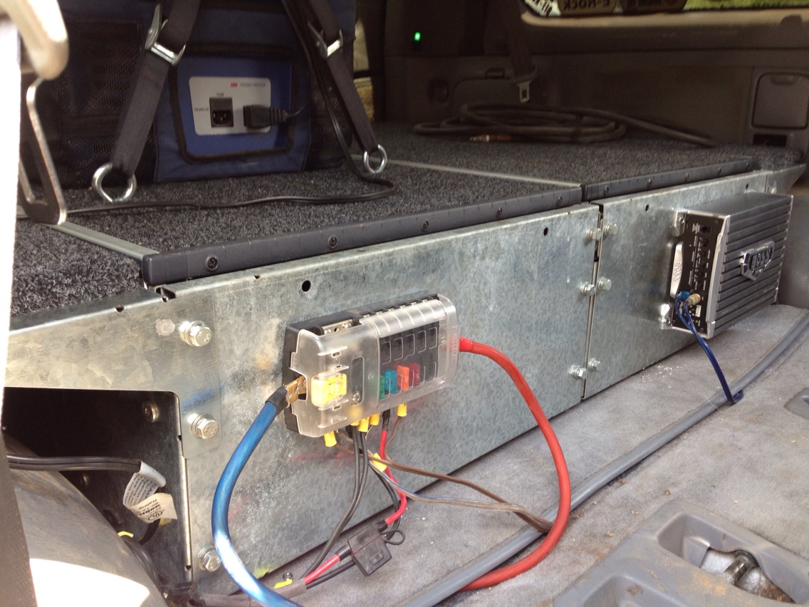

I mounted my blue seas fuse block on the back of the drawers and now just need to wait for my subwoofer box to come in to complete the rear storage area. The subwoofer is a requirement for me on long trips since it makes the drive bearable :)

Looks nice, glad to see you continuing to dial in the suspension system. I have the same drawers and would advise you to trim up the extra thread on the bottom of the fridge anchors as tight as possible. I left a few extra threads exposed under the roller top and its a good knuckle scraper when you reach in the drawer below. BTDT! :hillbilly:
