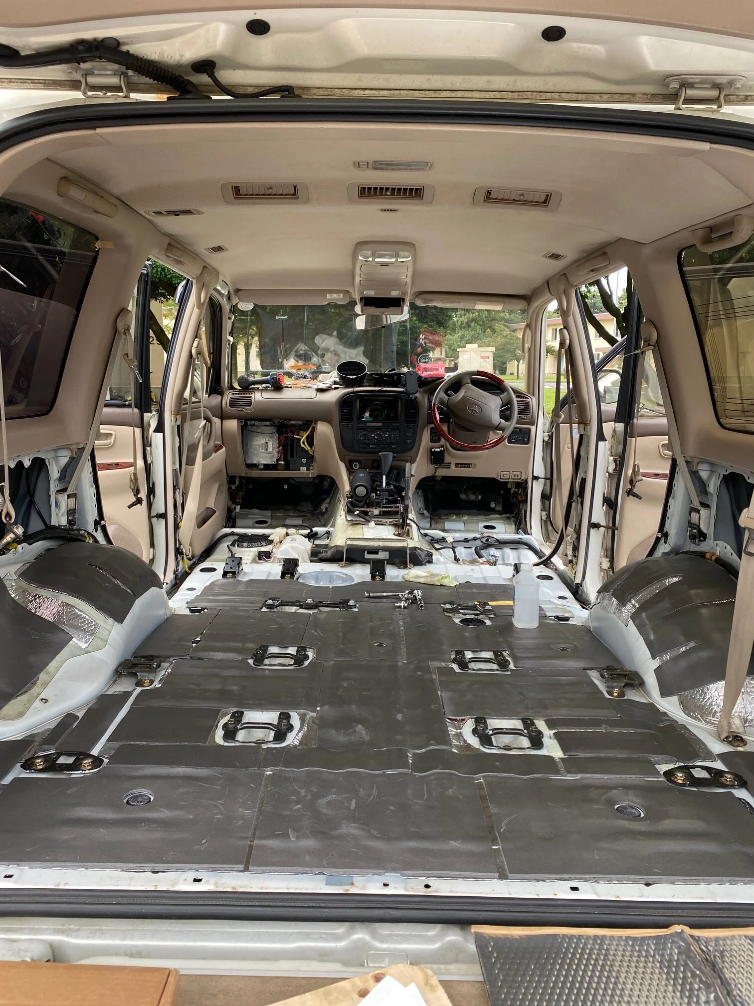

-I removed the interior to add sound insulation and a nice stereo with Infinity door speakers on a 4 channel amp and a low profile 12 inch sub the trunk

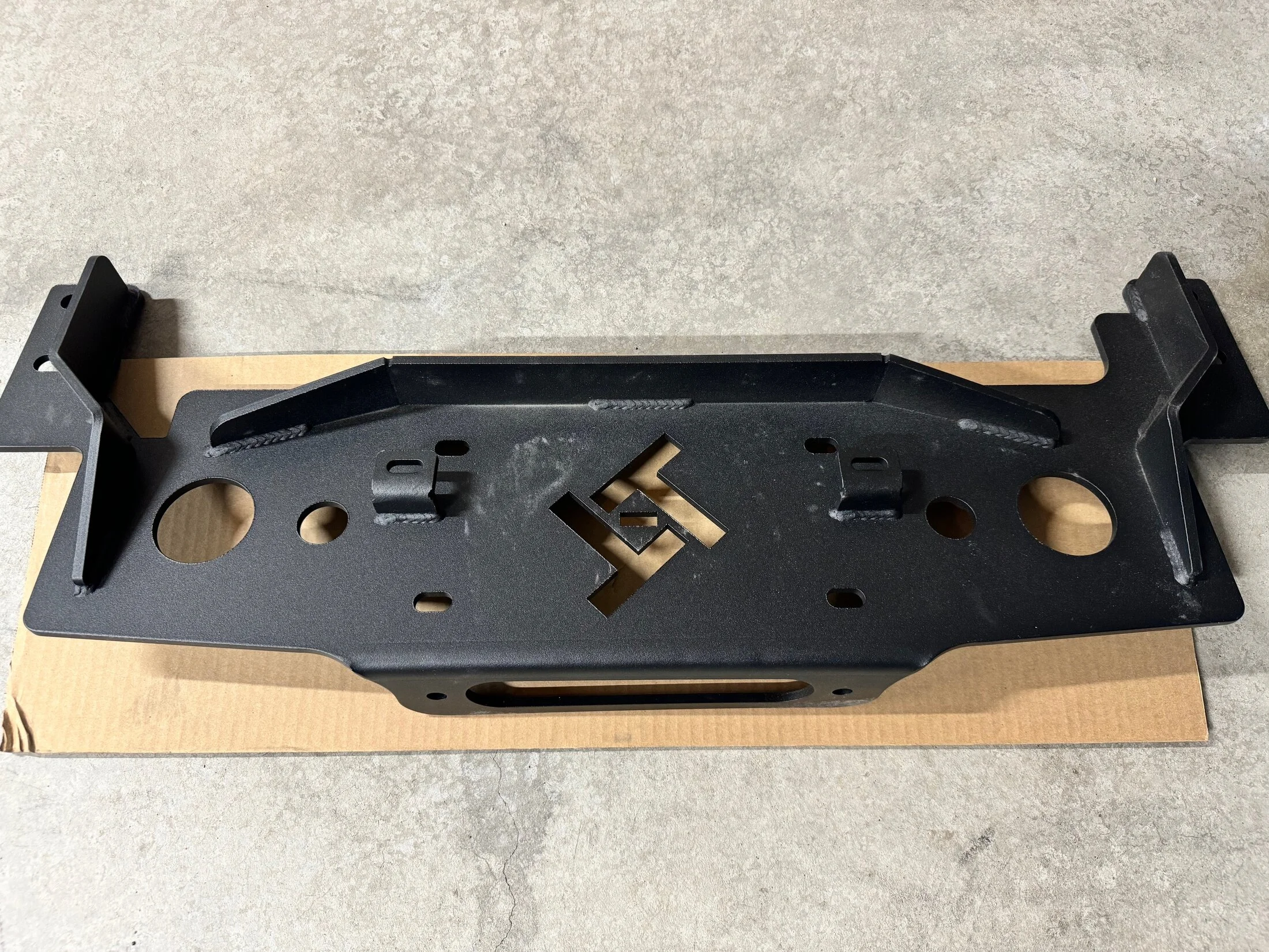

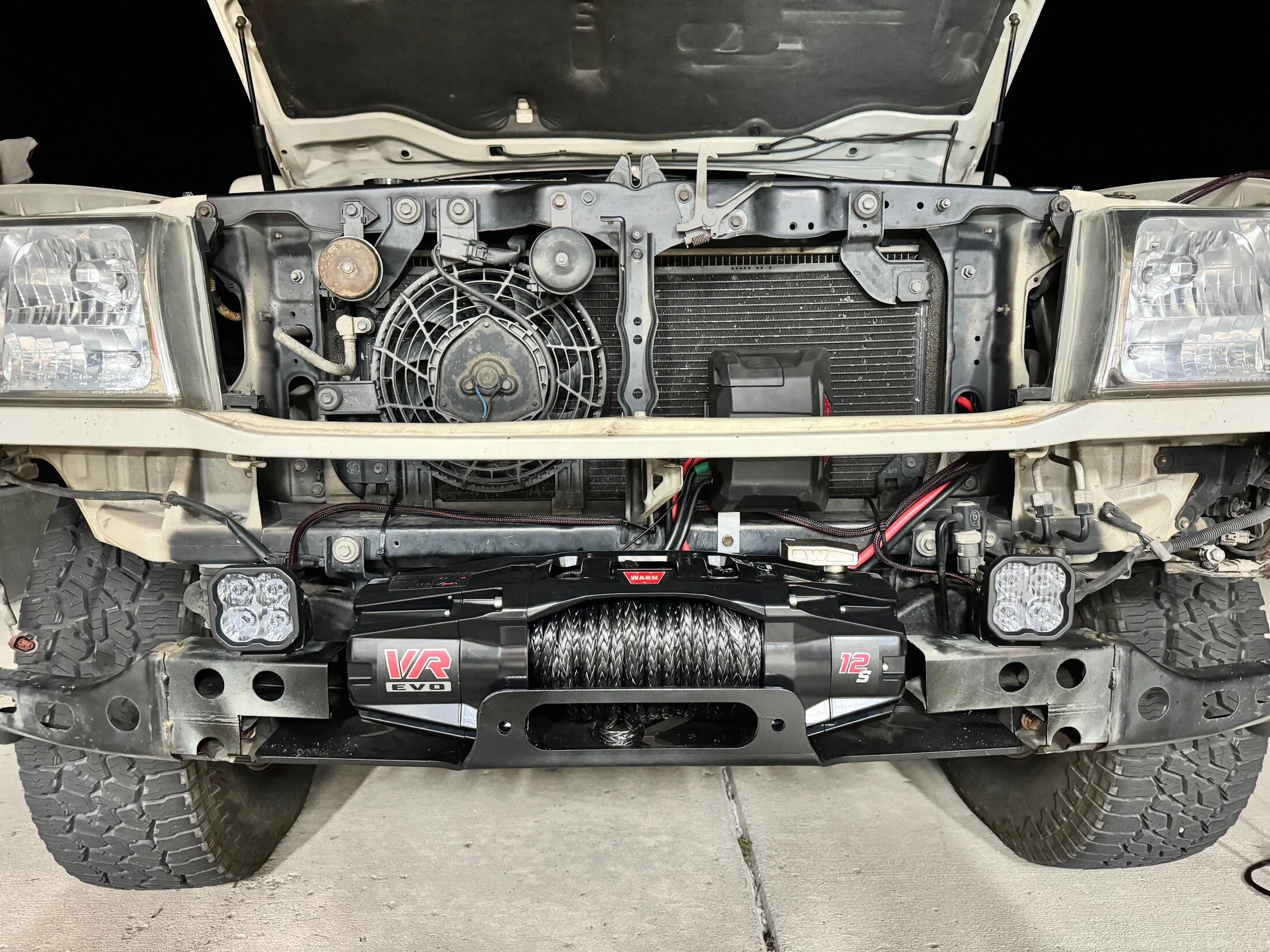

Hidden Winch

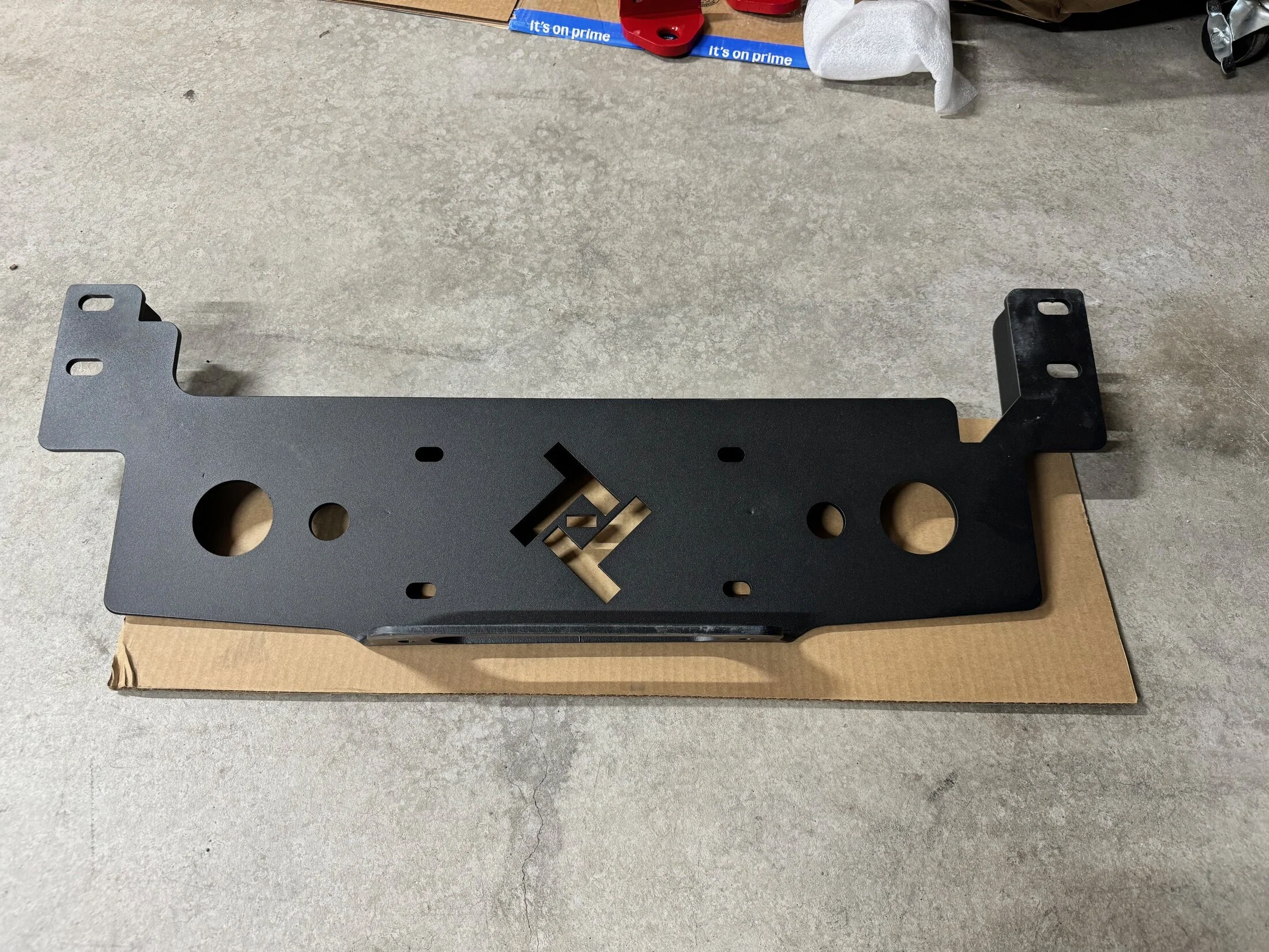

I went with the @TRAIL TAILOR hidden winch and a Warn VR Evo 12s. I also got the tow points and bolts from Trail Taylor. I wanted to keep this stock looking and I'm happy with the result.
I'm happy with quality of the hidden winch, good reenforcements and clean welds.
The tow hooks are 13mm thick vs the 7mm stock hardware.
I kept as much of the factory sub frame as possible to mount some Diode Dynamics light pods. I mounted the winch controller on a piece of aluminum bar to an existing tread in front of the radiator, the remote can be plugged in between the grill and radiator.
Hope this helps anyone else considering this hidden winch with a Warn VR Evo 12-s winch.
Final result. I'll upload some daytime shots later on.

What did you use for the sound deadening? I'm about to strip mine down to a "shell" to have it painted and seats repaired and I think I'll add some before putting it back together. Thanks
I like it.
Thanks Goose. I used 80 mil butyl sound deadening from Amazon on the doors and the interior. I then added 157 mil closed cell foam over it as I read it's good to do both for best results. I cleaned the surfaces with alcohol and left cut outs to access any bolts or access points on the body. I got a set of leather hole punches on amazon to help with small holes, those are nice to have but not required.
On the inside of the door panels I did another 50 mil butyl layer. I did not do the roof as I was afraid of damaging the headliner, but I'm sure that would be ideal if you can. Lastly I got some generic panel clips as you'll likely break or lose some when you disassemble the interior plastic panels.
Appreciate the info.
Any issues getting the carpet to fit properly after adding that extra bulk? That would be my biggest concern. I was looking at Dynamat Superlite because it's thin.

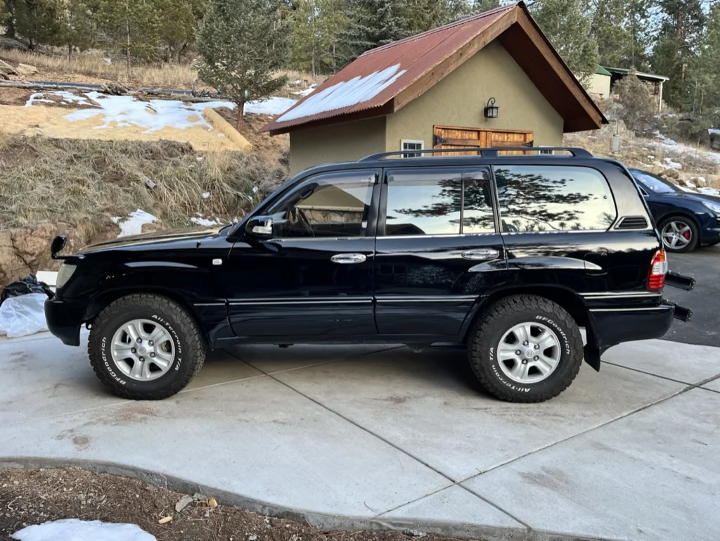

Nice.. Whats the size of the tire? I am ready to replace all 4. Is there a lift or all standard suspension. thanks!
It has a mild lift: Dobinsons IMS shocks in each corner, Dobinsons TB-59 torsion bars and C59-223V Rear Coil Springs. Factory control arms and it aligned with no problem. Front CV shafts are pretty much parallel to the ground, and the truck rides great!
Tires are 285/75-16 (32.8 inches) on stock wheels. Stock tire in 98 was 275/70/16 (31.1 inches).

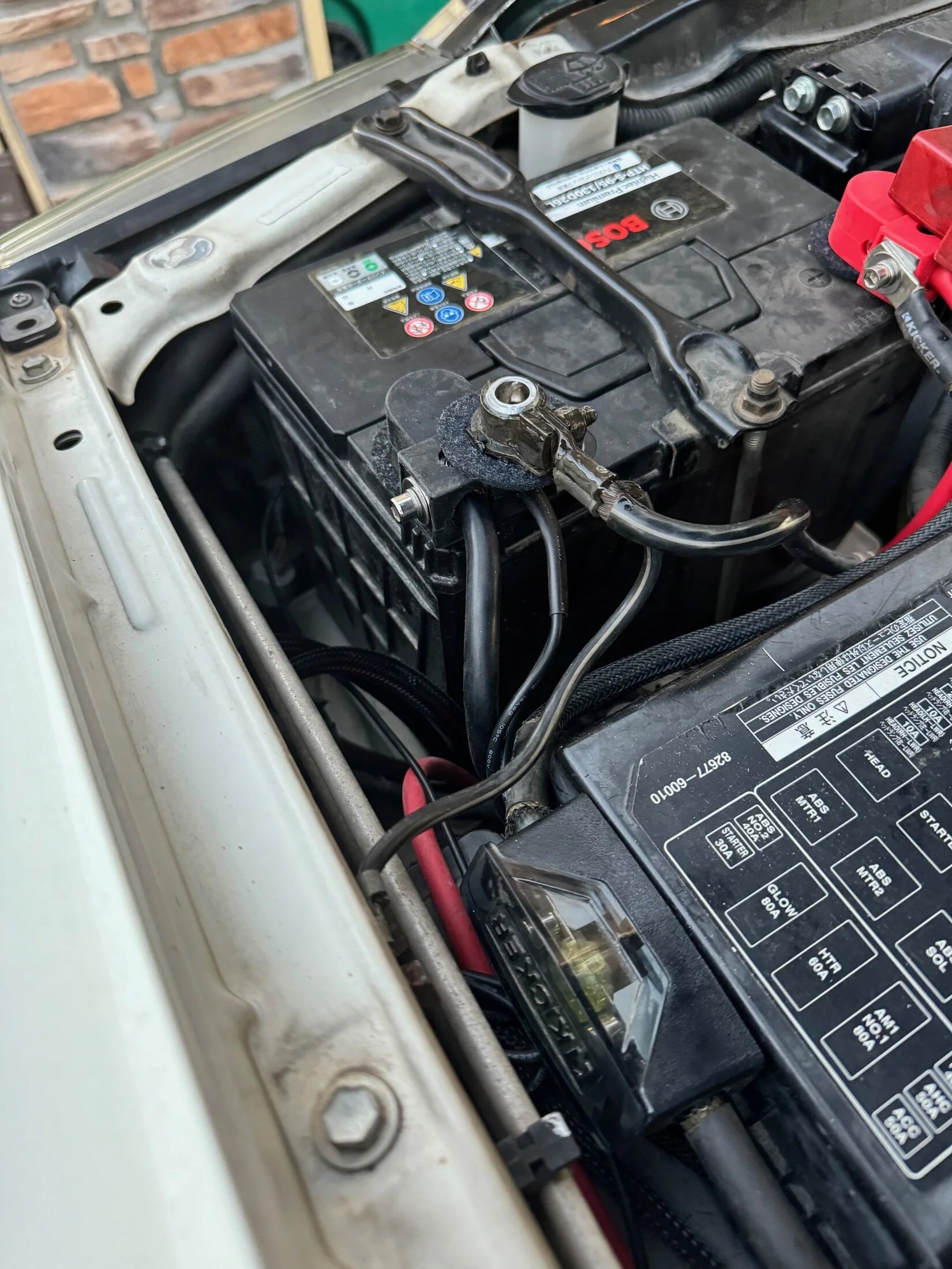

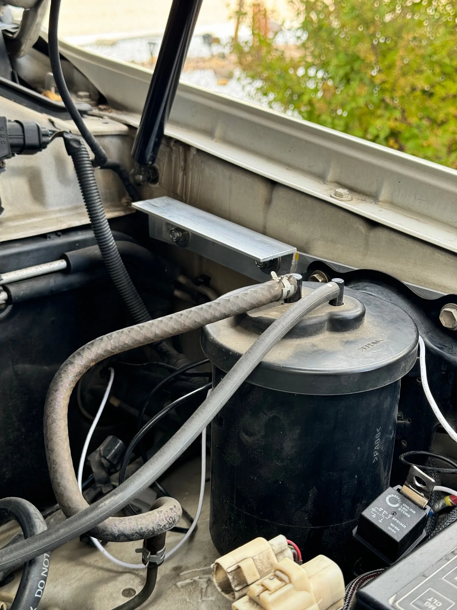

I did some clean-up of the power cables connected to the battery recently. I made a little tray out of aluminum and mounted a fuse block. The 8 gauge wires were probably overkill. Currently my Diode Dynamics light cubes and another fuse block in the cabin are connected. I got the "Recoil BTO Solid Brass Positive Negative Battery Terminals" from amazon and connected it to the battery. On the negative I have my winch and light cubes connected. On the positive I have my winch, fuse block and amp power cable (powers two amps). I ran a negative wire on the fuse block but I don't currently have anything connected. I attached the aluminum bar to the charcoal filter mounting points, seems solid enough considering there is little weight mounted on it.

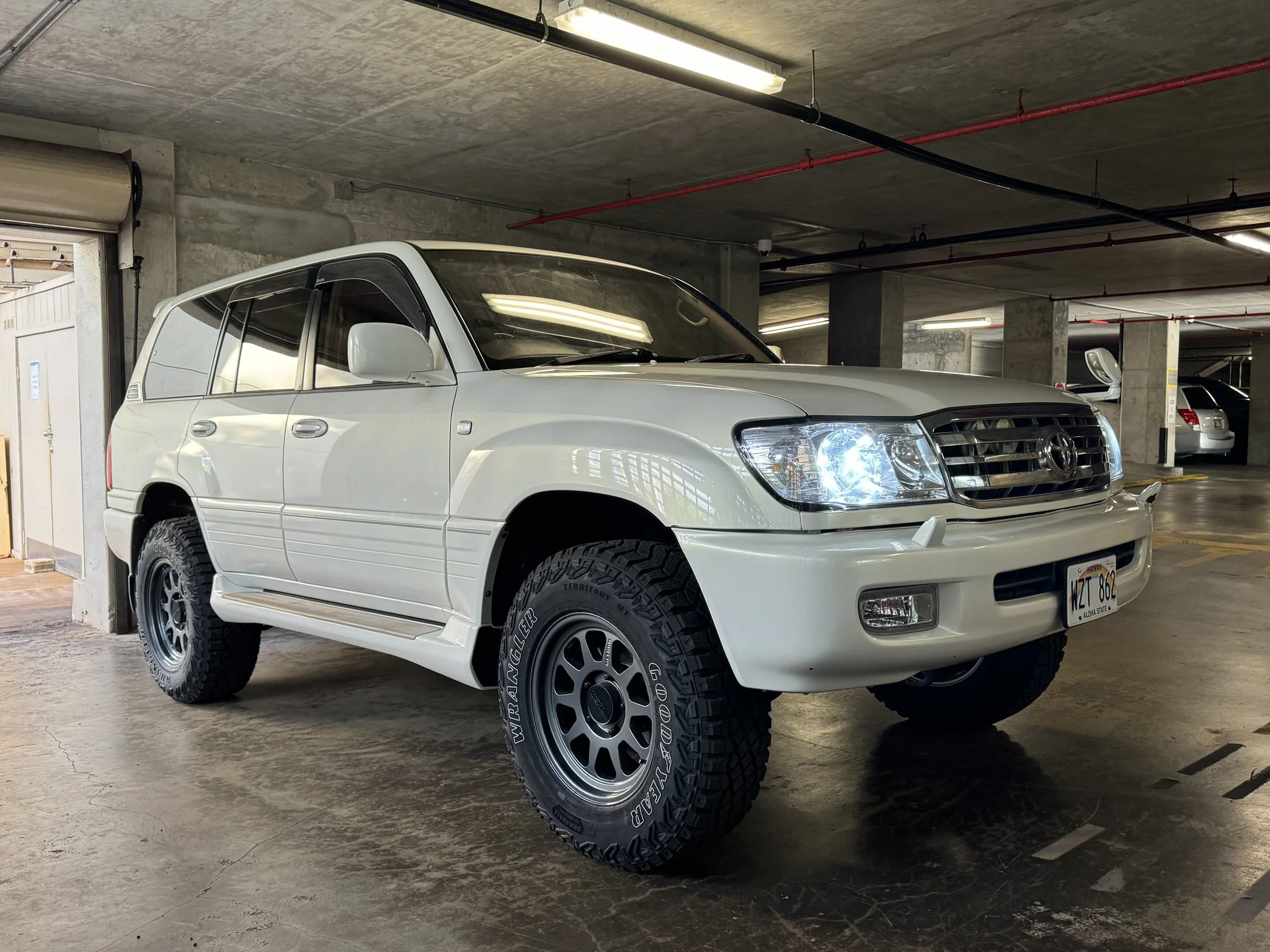

I got mine from Japan a few months ago and it’s the best. Slowly upgrading. Did the wheels, new media system, Japanese seat covers, upgraded cup holders. Next week I’m going to change out all suspension bushings.
Are those methods? What size? Your paint looks amazing, wish mine was that good!
18” Method 316’s. @cryptyk was able to make me some 3D printed center cap extensions to fit over the dust caps.
