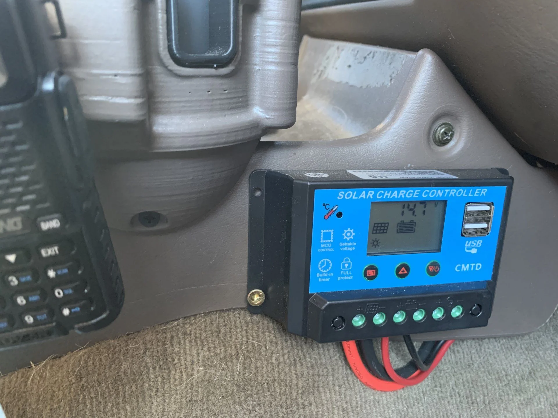

I bought a 100w solar panel kit off amazon and hooked it up to the 2nd batt. Keeps it topped off when I'm not driving and is great for running the fridge and accessories while camping.
Minor hijack here - how do you connect your solar panel to your single battery? I like that idea, but I'd like to keep it as simple as possible.
Thanks.
It’s very easy, the kit I bought came with a charge controller, you simply run the +/- wires from the charge controller to the battery, and will keep you nice and topped off.
The thicker gauge is running to the panel on the roof, and the other two are going to the Aux battery. Pleasantly surprised at how good this thing works. In full sun I can have fridge on and charger batteries and barley see a drop in Volts.

It’s very easy, the kit I bought came with a charge controller, you simply run the +/- wires from the charge controller to the battery, and will keep you nice and topped off. View attachment 2524485The thicker gauge is running to the panel on the roof, and the other two are going to the Aux battery. Pleasantly surprised at how good this thing works. In full sun I can have fridge on and charger batteries and barley see a drop in Volts.
Thanks for posting that up. I appreciate you taking the time to put the photos in, too. Cheers.

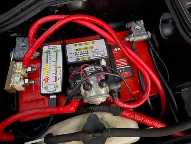

Here's a picture of my set up.
link to the kit you bought
Sorry OP, but this just looks like a accident waiting to happen, I don't see any tie down for the battery, the power post is on the wrong side and one big bump from shorting out on the body and the average Joe would not have a clue what to do if it were shorting out.
I agree, sounds like you're on a path to correct these issues which is good. In addition to what Broski said, those breakers are not a good idea. They look like a trip and reset type which means if there is an issue they will trip for a period of time then come back on, if the issue persists it will arc again and trip. Not a good situation. They also look very undersized for the gauge wire that is coming off of it.
Other than those items you have some good hardware there.
