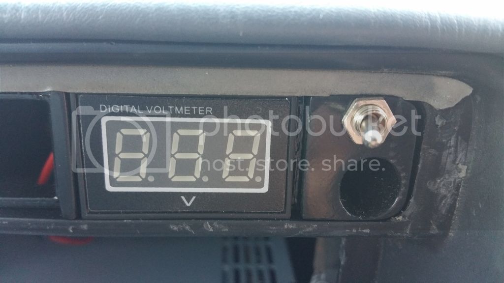

For monitoring, I used these inexpensive waterproof voltmeters in 2 of my installs. They are wired to a center off Carling type switch, so I can turn it off, but you could leave it on if desired. Switch up is engine battery, switch down is house battery, center position is off. They draw 15 mAmps so a trivial amount of power.
http://www.amazon.com/DROK-DC2-5-30...roof voltmeter&qid=1461235980&ref_=sr_ph&sr=1
I have found them to be reasonably accurate, and they fit in the "coin slots" of the 80 console without modification. And the digital read out is more accurate and more intuitive than the National Luna LEDs.
http://www.amazon.com/DROK-DC2-5-30V-Waterproof-Voltmeter-Monitoring/dp/B00CK3P20S?ie=UTF8&keywords=waterproof voltmeter&qid=1461235980&ref_=sr_ph&sr=1

Would love to see how you wired the switch to show both batteries.
Easy-but I don't think I can manage a diagram...
You need a single pole, double throw, center off switch. I like Carling switches (Like ARB airlocker switches) but even a hardware store switch is fine.
Each battery feeds one side of the switch. The center pole of the switch goes to the voltmeter +. The volt meter negative just goes to ground anywhere convenient.
That way with the switch "on" to one side, you get the battery voltage from that side displayed on the voltmeter. "On" on the other side of the switch, displays the other battery voltage on the meter. Center position of the switch turns the meter off.
