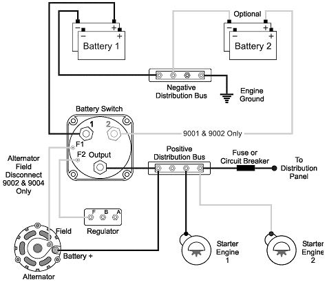

my dual batt's are wired up into a boat switch, which sits in the center tuffy console, from there the positive goes to the starter and the neg goes to the frame, from the starter I have a line going to 2 fuse blocks, one key hot and one always hot.
the boat switch method has worked very well for me. I can choose to use one or the other or both of the batt's.

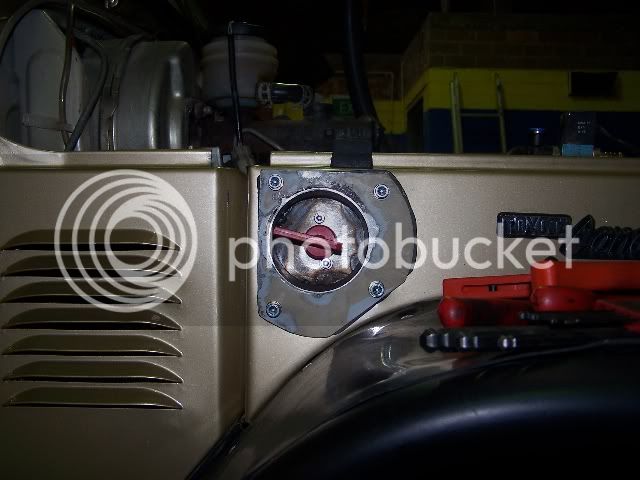

no, I don't, the boat switch is usually set to OFF when parked, but to your point it would be a good idea for sure, never had any problems, I did make sure that the cables are very well insulated where they go through the floor

I understand how you are using the Acc and ST positions on the keyswitch to activate the two solenoids, (pretty neat idea BTW)but I don't underestand how you hooked it up to allow charging both batteries while NOT allowing both batteries to power the starter or winch.
This is what you have?
You have Solenoid #1 in line between the starter and Battery #1 and Solenoid #2 between the winch and Battery #2, right?
Then you have the alternator connected to BOTH batteries so it can charge them. Unless you have a means of disconnecting the alternator when starting or winching, current will flow from BOTH batteries through the connecting wire(s) from the alternator to both batteries. Or am I missing something here? :D
