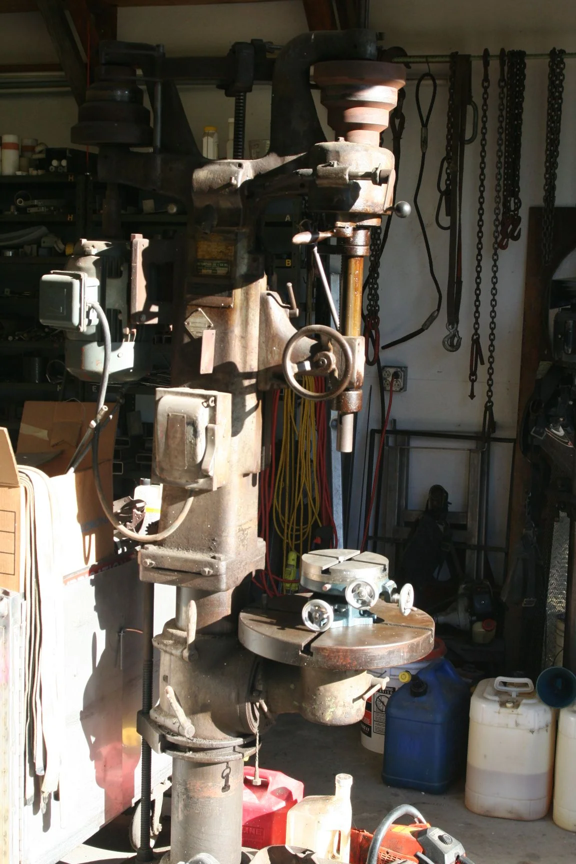

I have on of these would prefer the Clausing that it's a copy of, got it cheap/used. It has a mill table and vice, is a beast, haven't found anything that slows it down.

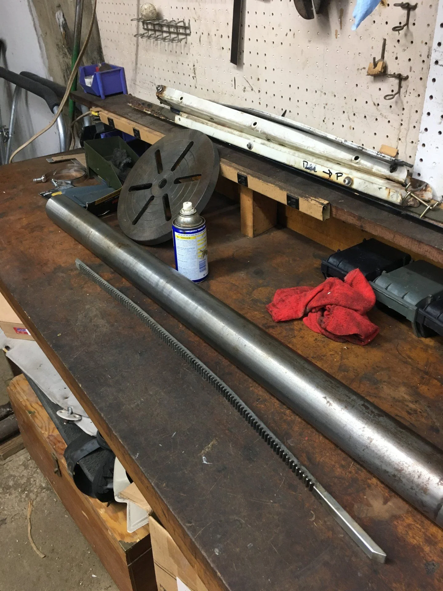

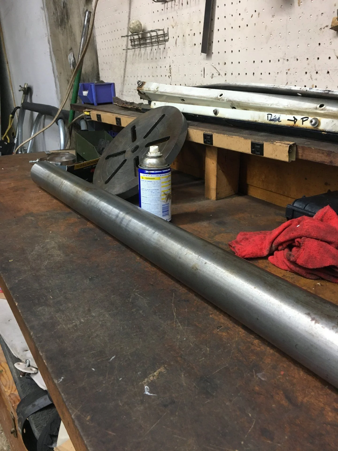

Took the main pieces of the press apart to clean them up a bit. The pillar was pretty nasty with surface rust and grime, but cleaned up well with some steel wool.
Dropped the pieces that needed welding off at my buddy's. I was able to clamp the table together nicely with a big c-clamp, and then carved a good groove into the crack with a die grinder. The other two spots that need welding will be quick and easy: a crack in the base that holds the pillar, and a crack in the ring that holds the toothed piece upon which the table moves up / down.
The toothed piece is nowhere near straight, so I'm hoping once it's back against the pillar and secured with the ring and the base, it'll still function properly.

You'll want to coat the pillar with something so it doesn't rust. BLO works well and is cheap.
Ok, ok, what's BLO.
BLO = boiled linseed oil. Super volatile stuff. Rags soaked in BLO can spontaneously combust if left wadded up in a trashcan or otherwise.
I’d just wipe it down with oil or wax. You really don’t want something that will build up and gum up moving the table up and down.

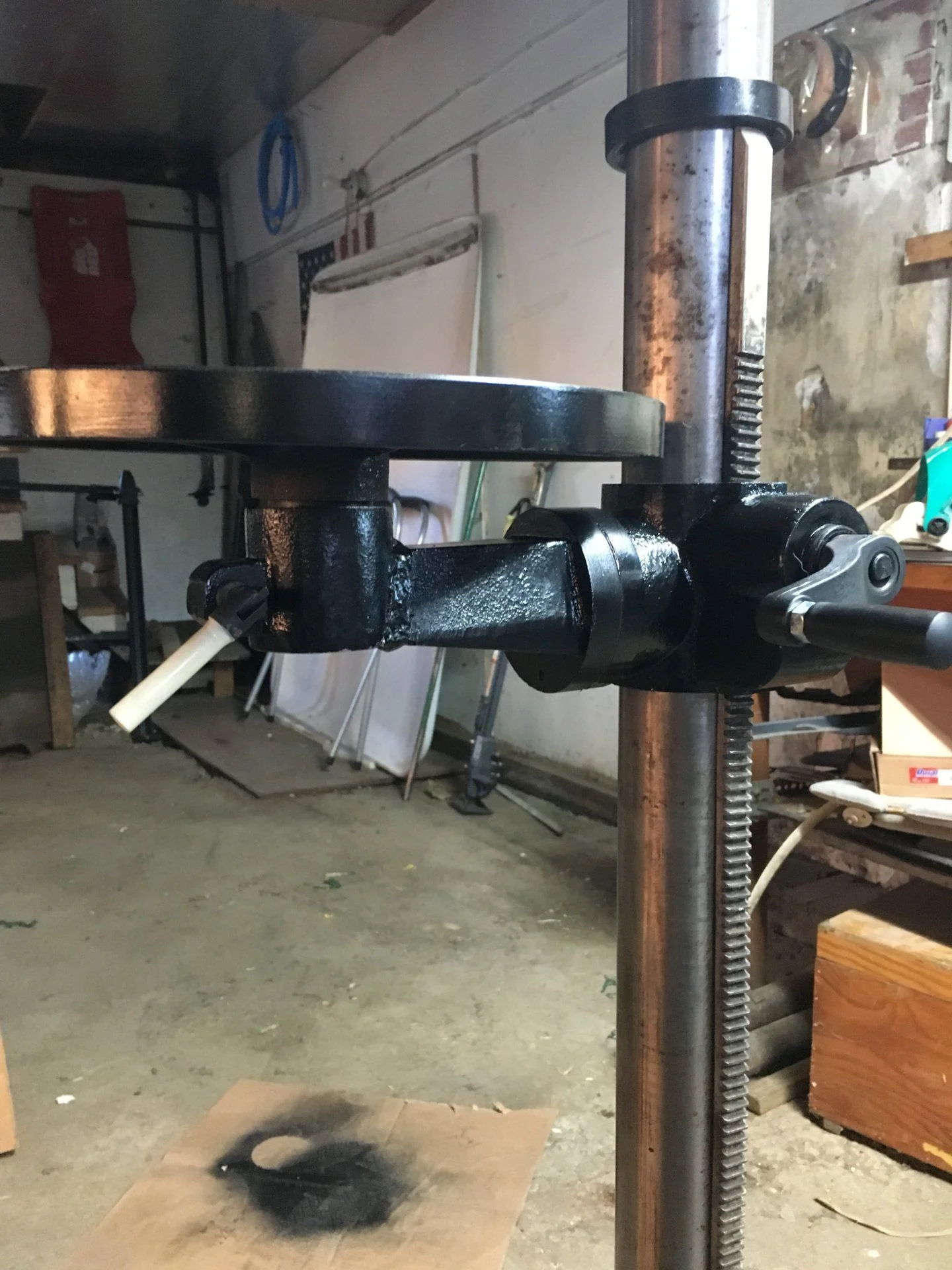

Making some progress on getting my side-of-the-road drill press up and running.

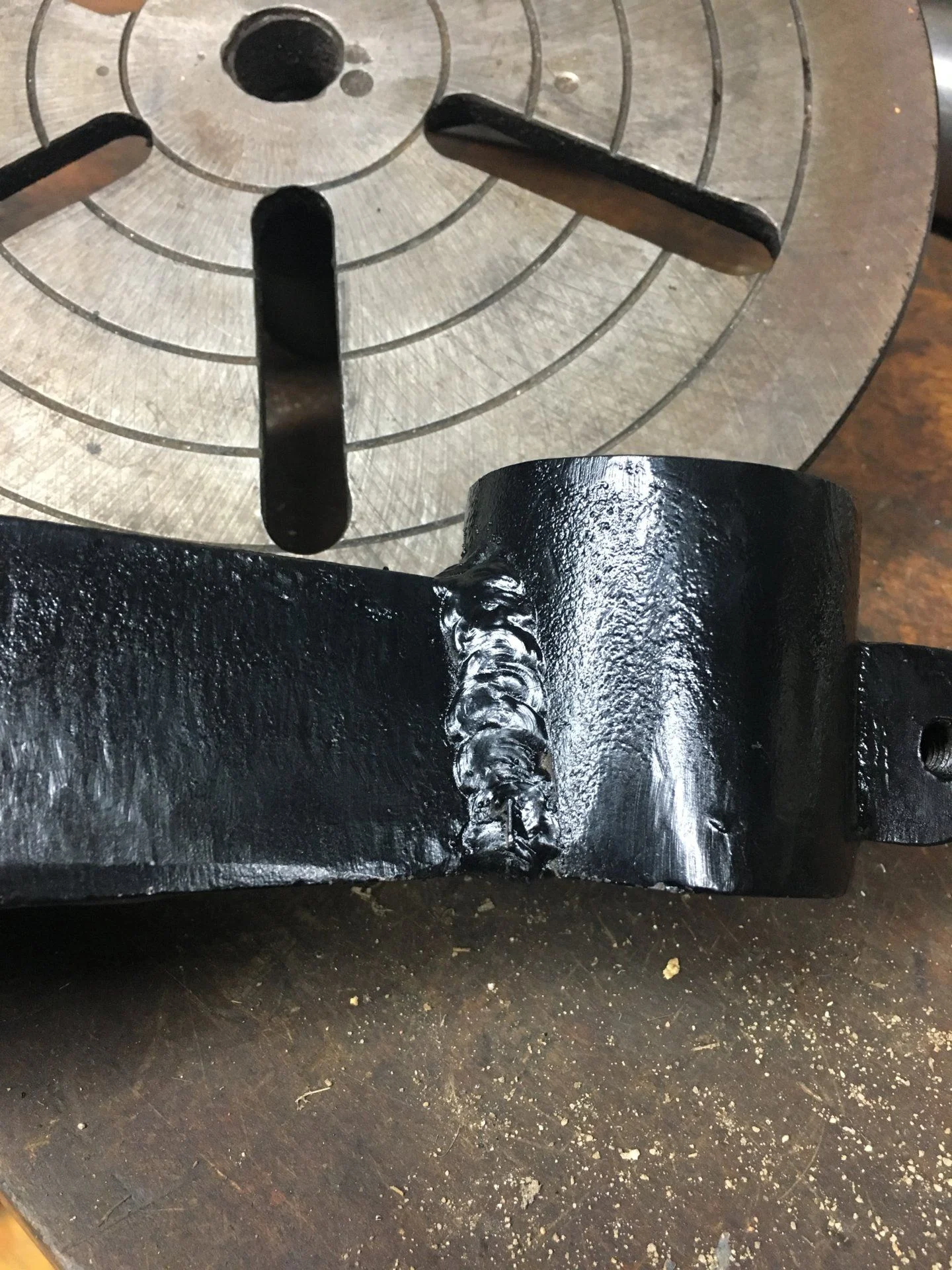

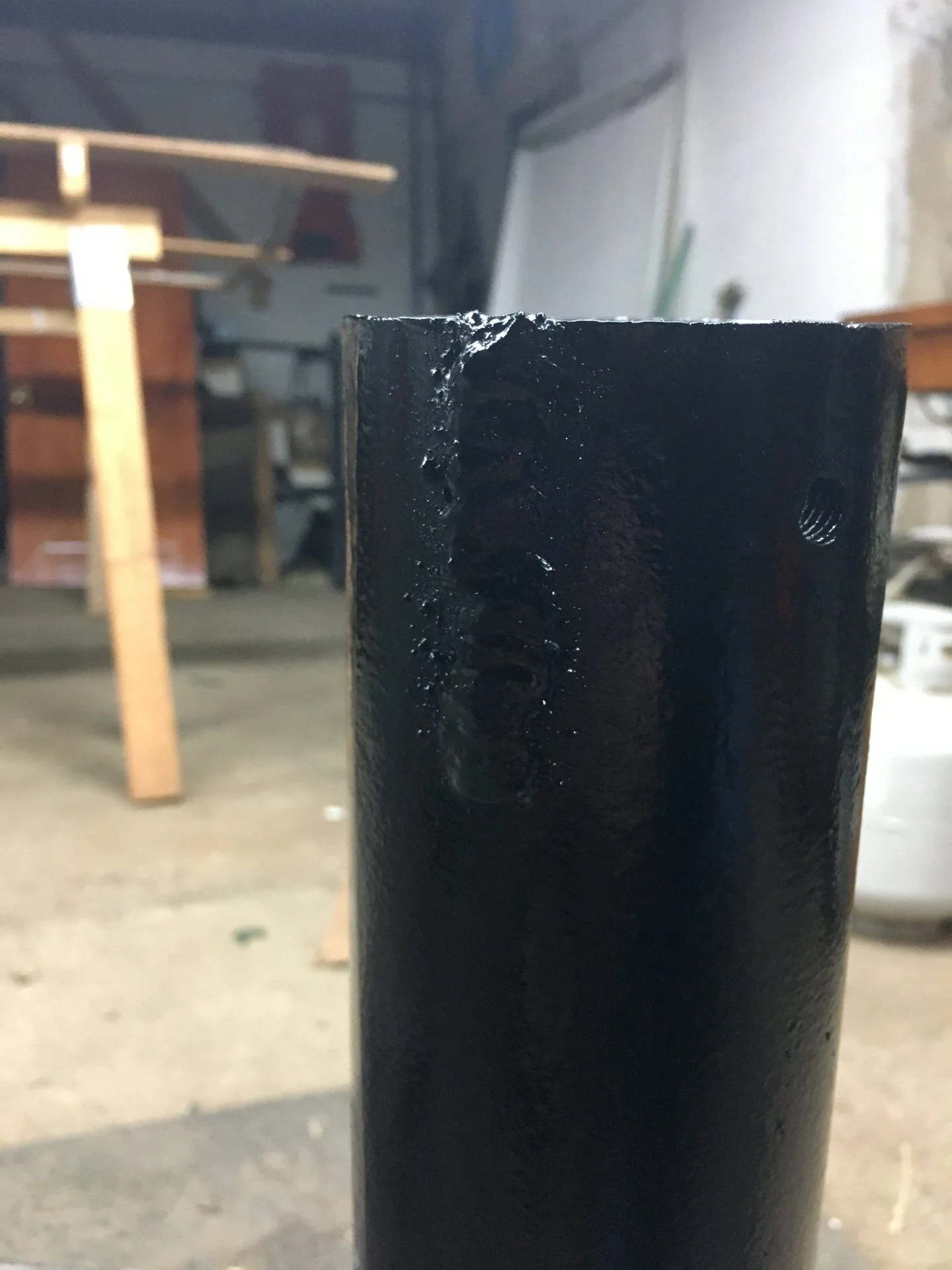

My buddy, Silas, did some nice work with his MIG to weld back the fitting the holds the drilling table to the adjustable part on the column. He hit a couple of other small cracks, too: one in the ring that hold the top of the toothed guide for the table height adjustment, and one on the base where the pillar inserts. Silas is that guy that can fix everything, has that random part / thing you're looking for, and is generally a good human. He made time to fix these parts, and come over and do some grading in front of my shop, before he went in for hip surgery earlier this week.

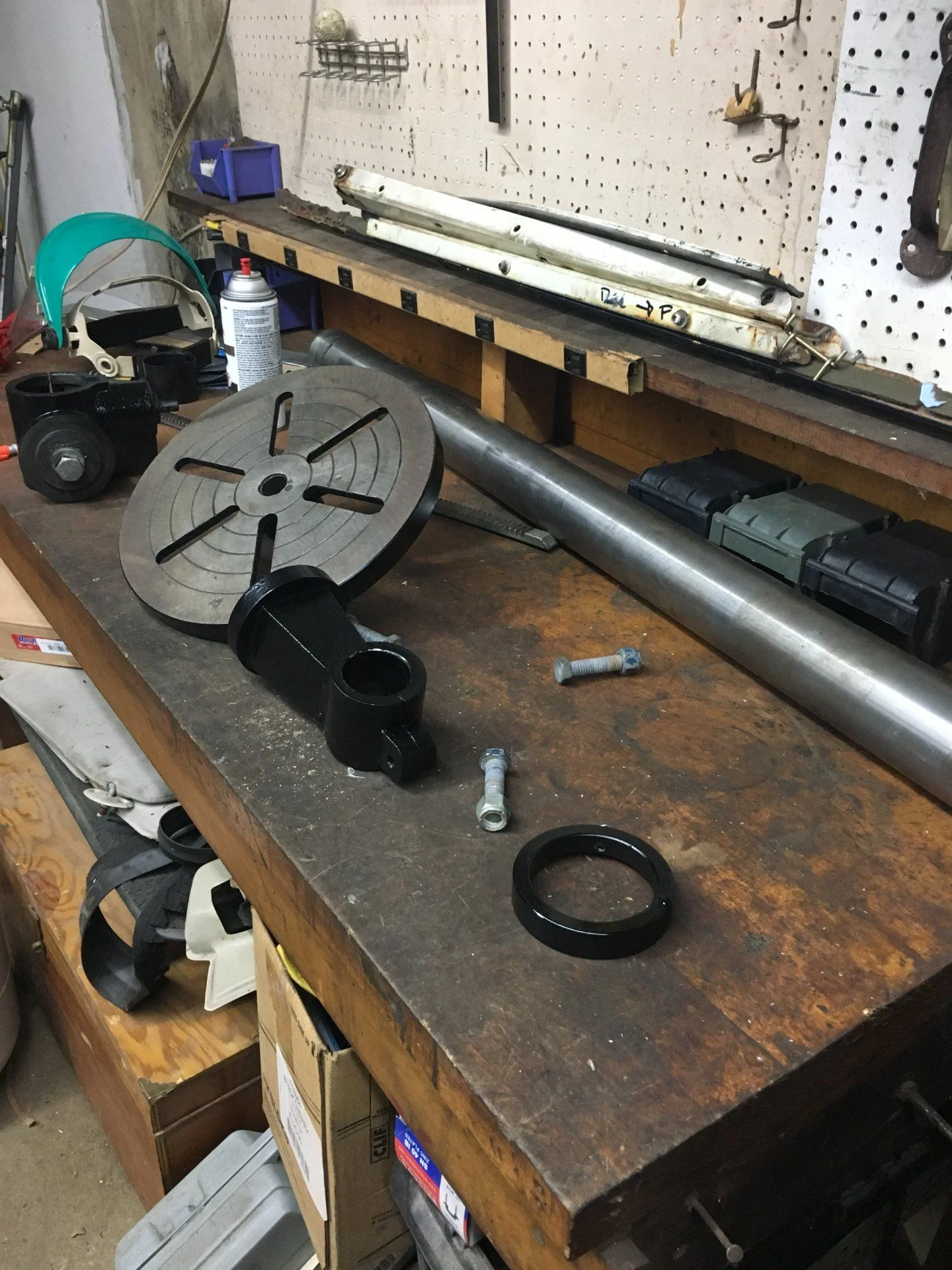

I degreased, scuffed, and cleaned up the parts, then hit them with some paint that I had at the house.
Hoping to put everything together tomorrow and get the drill press up and running!

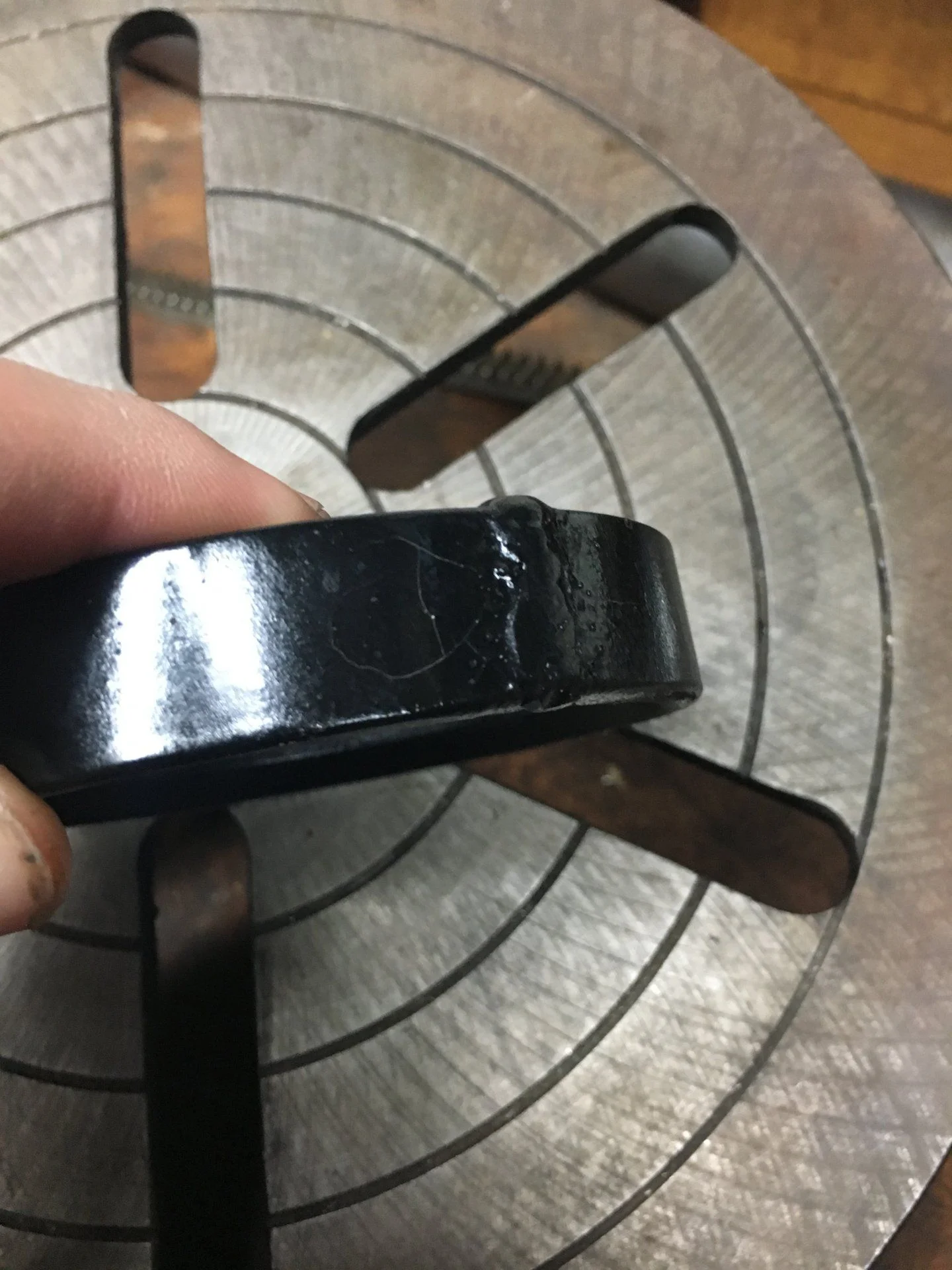

Little more progress on my lunch break today. Got the pillar installed in the base, table assembly put back together and reinstalled with the worm drive guide.
Only issue is the the ring that holds the top of the table height guide cracked at the spot we'd welded to repair. So, I've got to figure out a replacement / solution.
