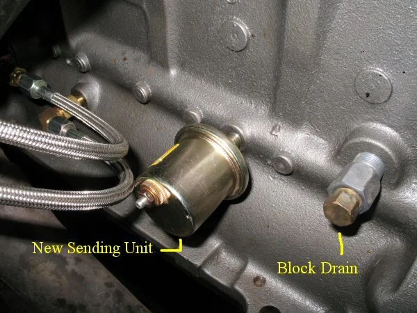

Here are the results of moving the new electric oil sending unit to the OEM location.

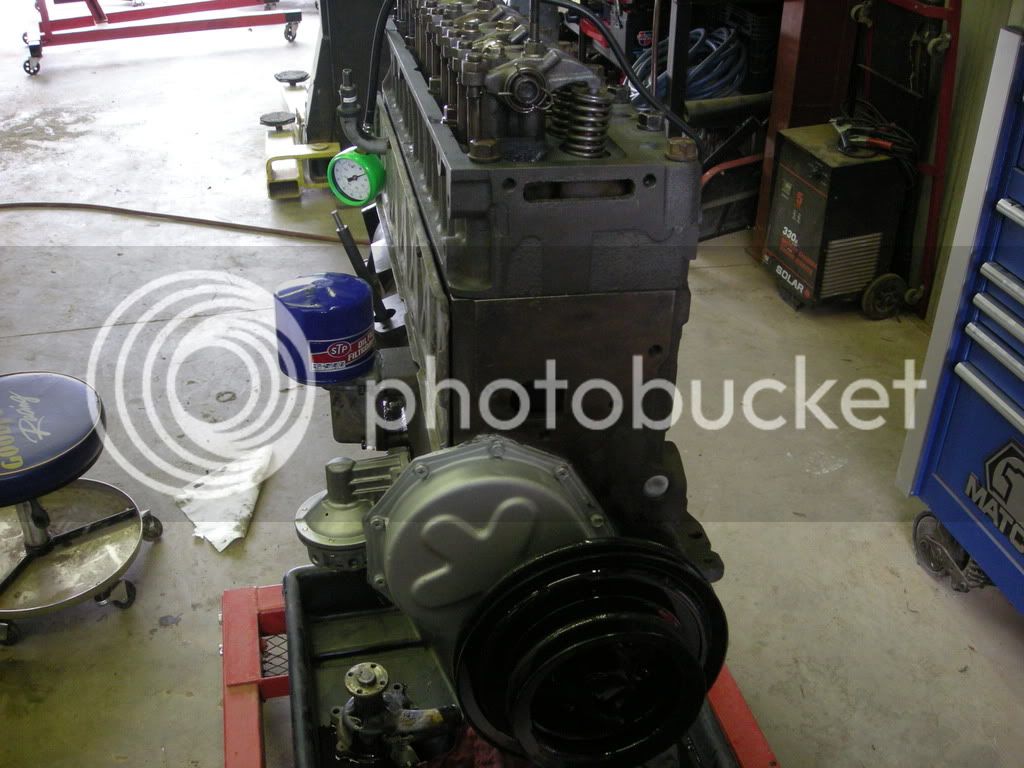

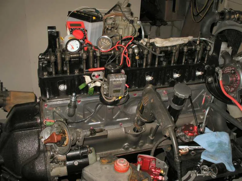

First pic shows the setup: FJ60 dizzy removed, old dizzy shaft chucked into a drill to spin the oil pump, snd lawn mower battery to power the electric oil pressure meter.

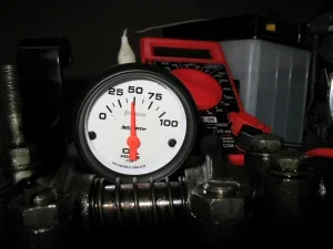

Second pic shows oil pressure at slow speed on the drill.

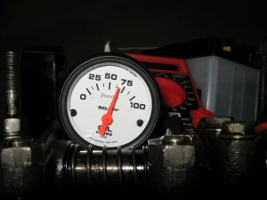

Third pic shows pressure with drill wide open.

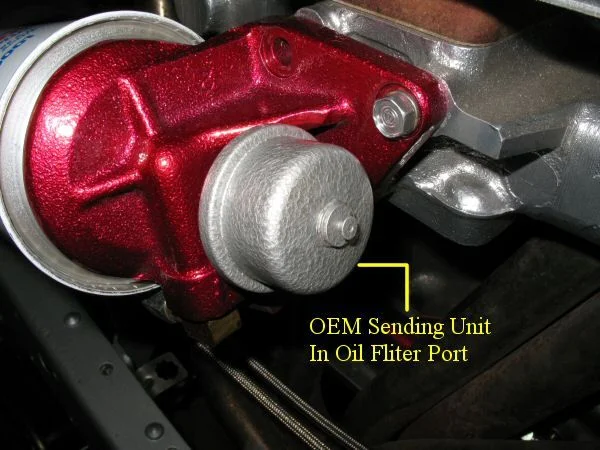

I put the electric sending unit in the block where the OEM sensor goes. I put the OEM sending unit into the oil filter port just to plug the hole until I can get some plugs.

I just did the same thing, my drill worked great, and my Snap-On tool work great to.
pics:
