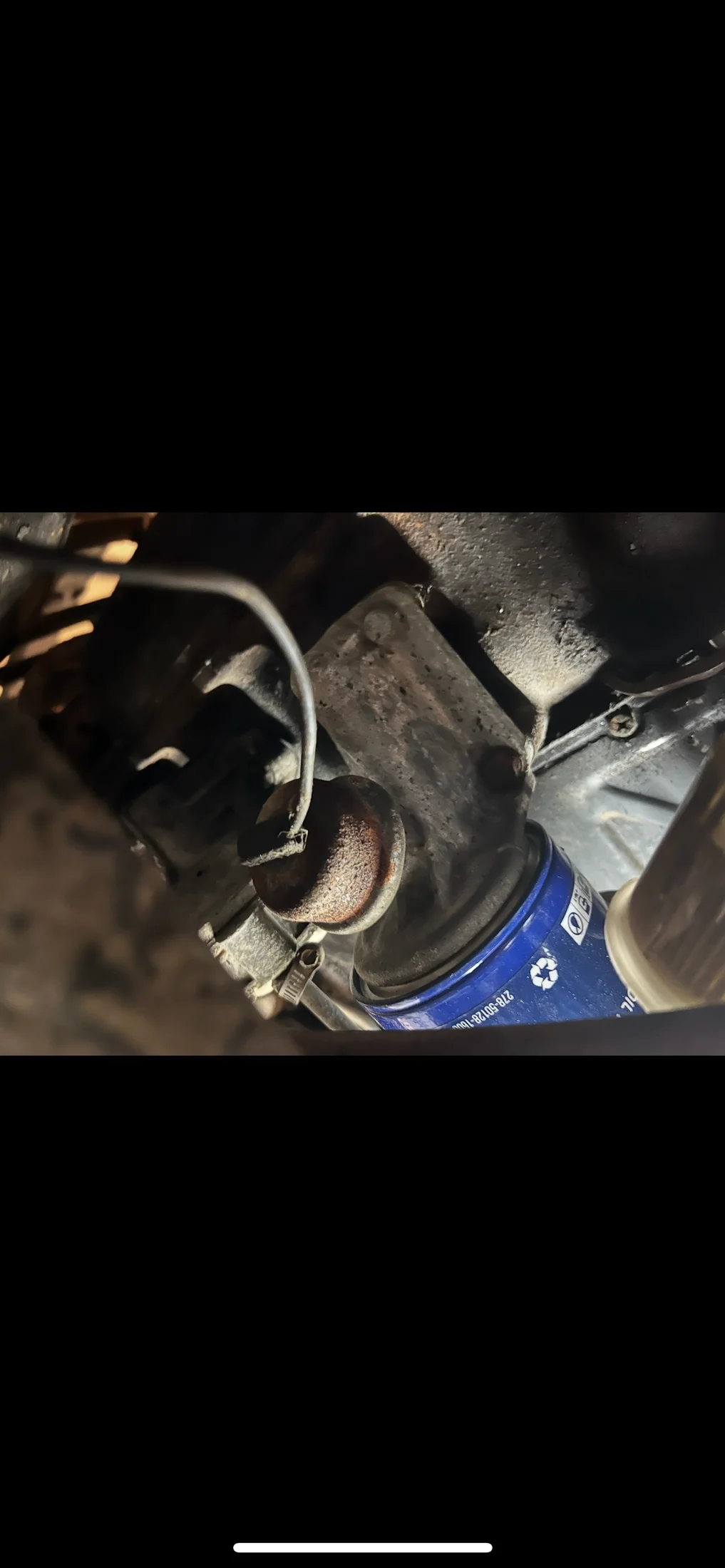

Installed a new oil pressure sensor about a year ago.
Car sat for a few months.. just started driving it again.
Would a bad filter give a high or low reading? Curious if I should replace the filter to troubleshoot this.
Possible but pretty unlikely. There is a spring loaded bypass in the oil filter housing (or whatever you call it) that should open if the restriction is too high in the filter.
if it were a bad filter (and a stuck bypass) it would read high pressure at the sender. Again, I think it’s unlikely that it’s the filter, but have been wrong before:)
You could also pull the valve cover off and run the engine and make sure the top end is being oiled.

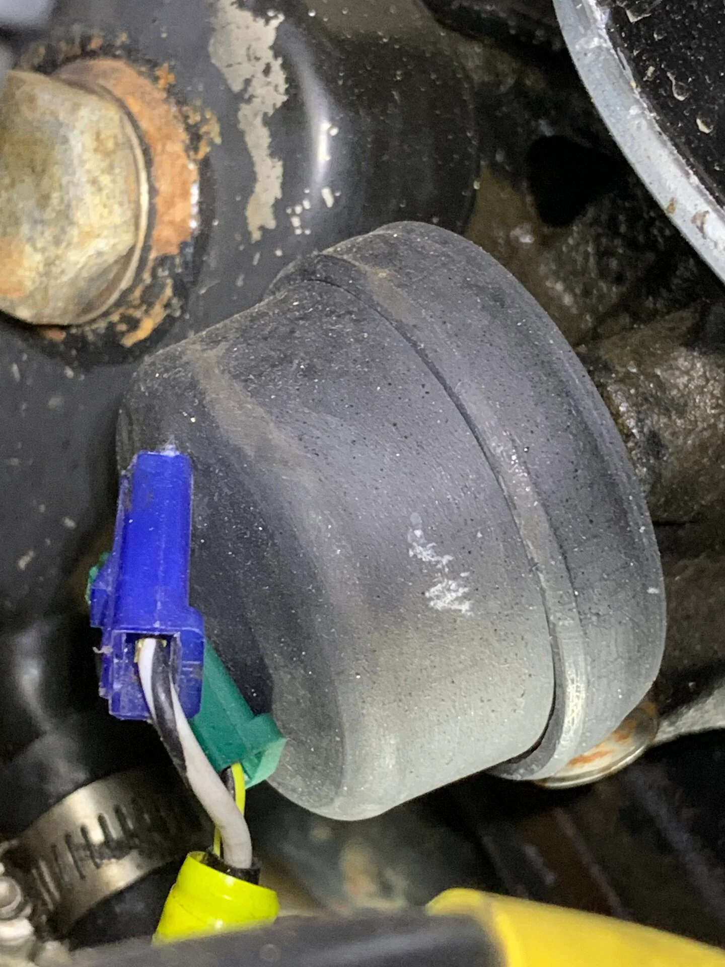

If I recall correctly a bad ground usually pegs the meter.

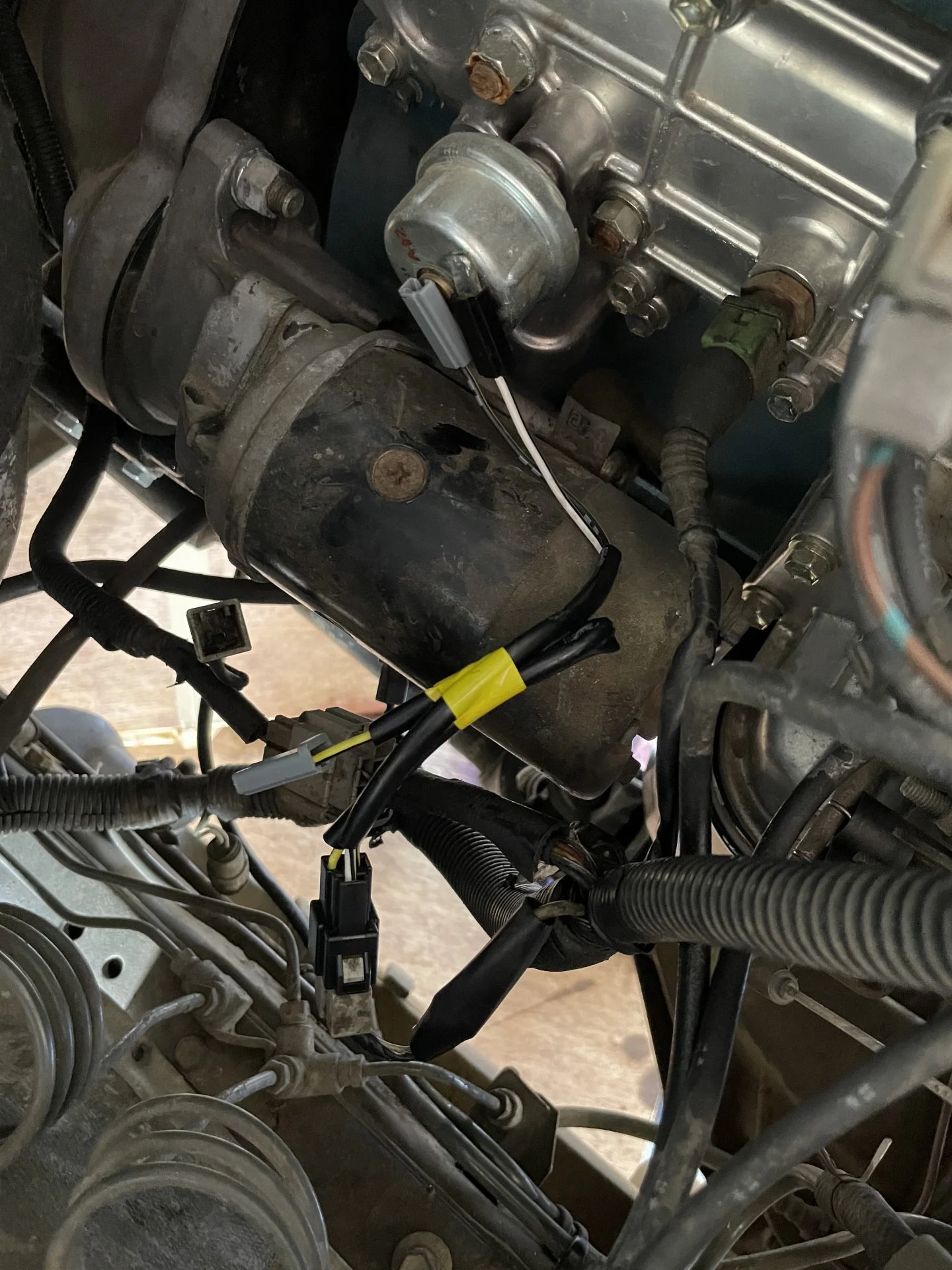

If I was to add that wire I would run from the sender to the instrument panel. However I run a thick cable from battery -neg terminal to a starter mounting bolt, also a woven strap cable to the engine and like #10 to the alternator.

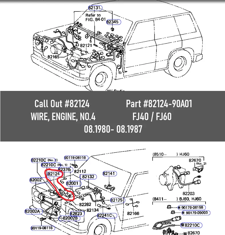

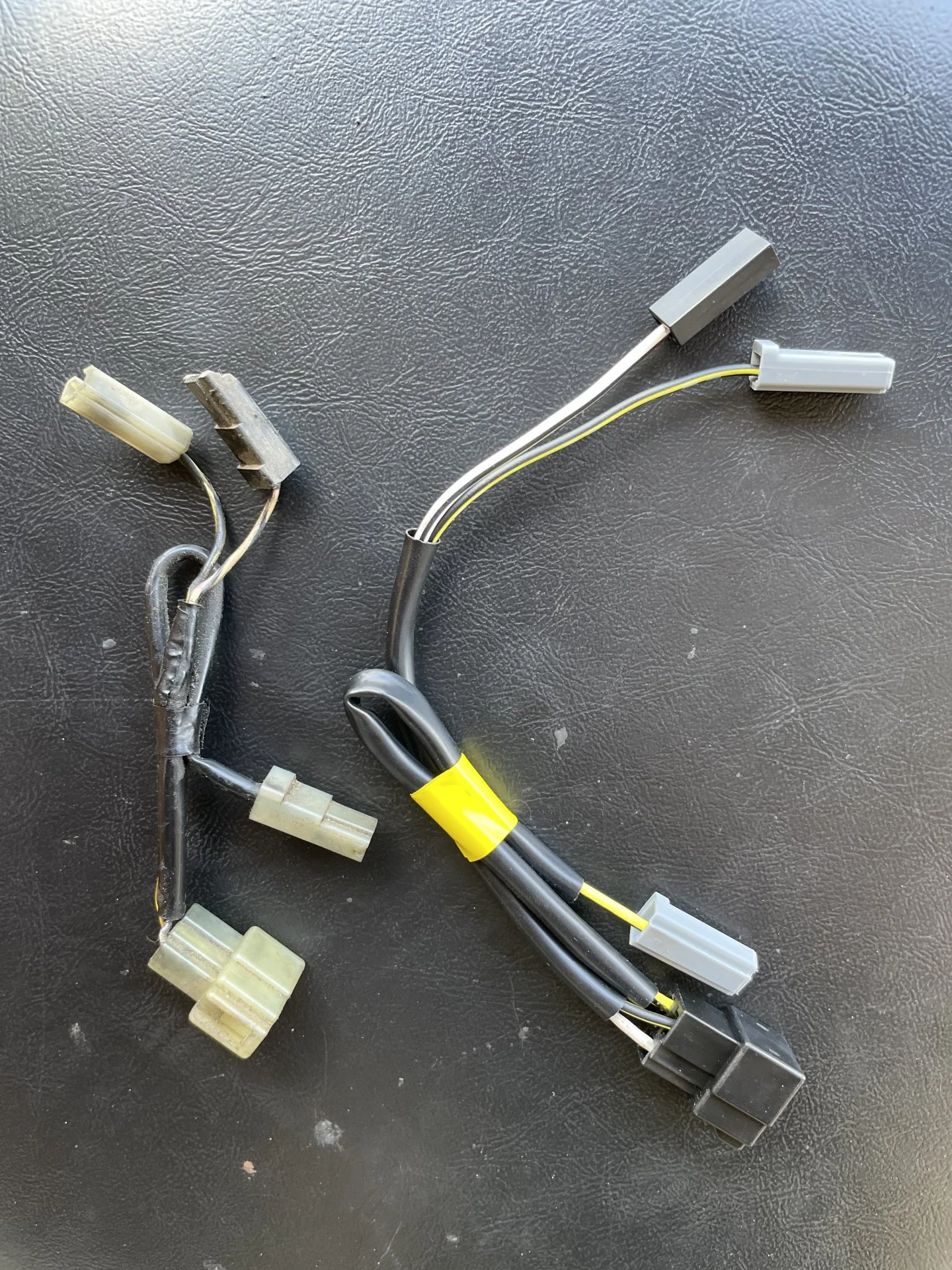

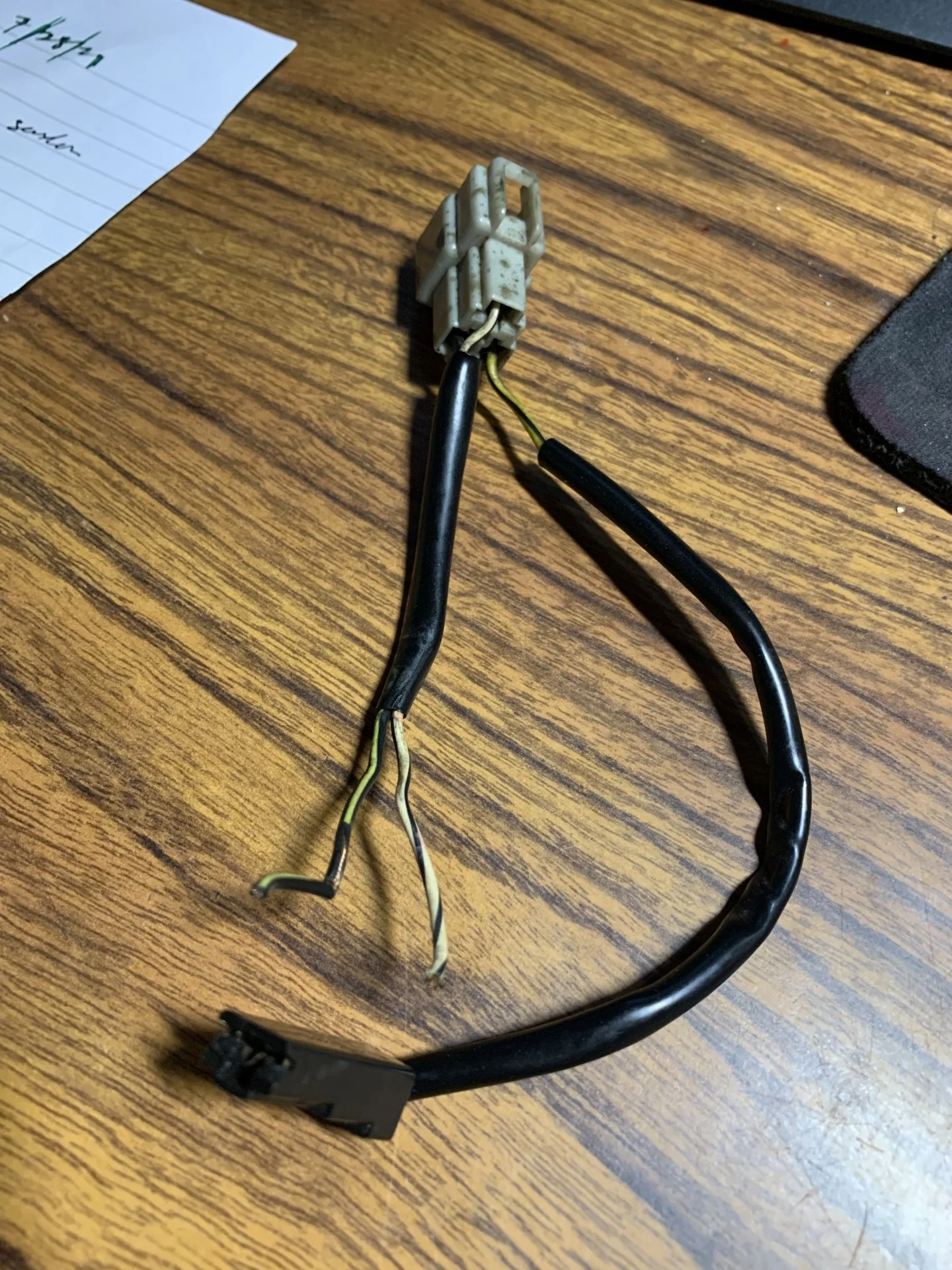

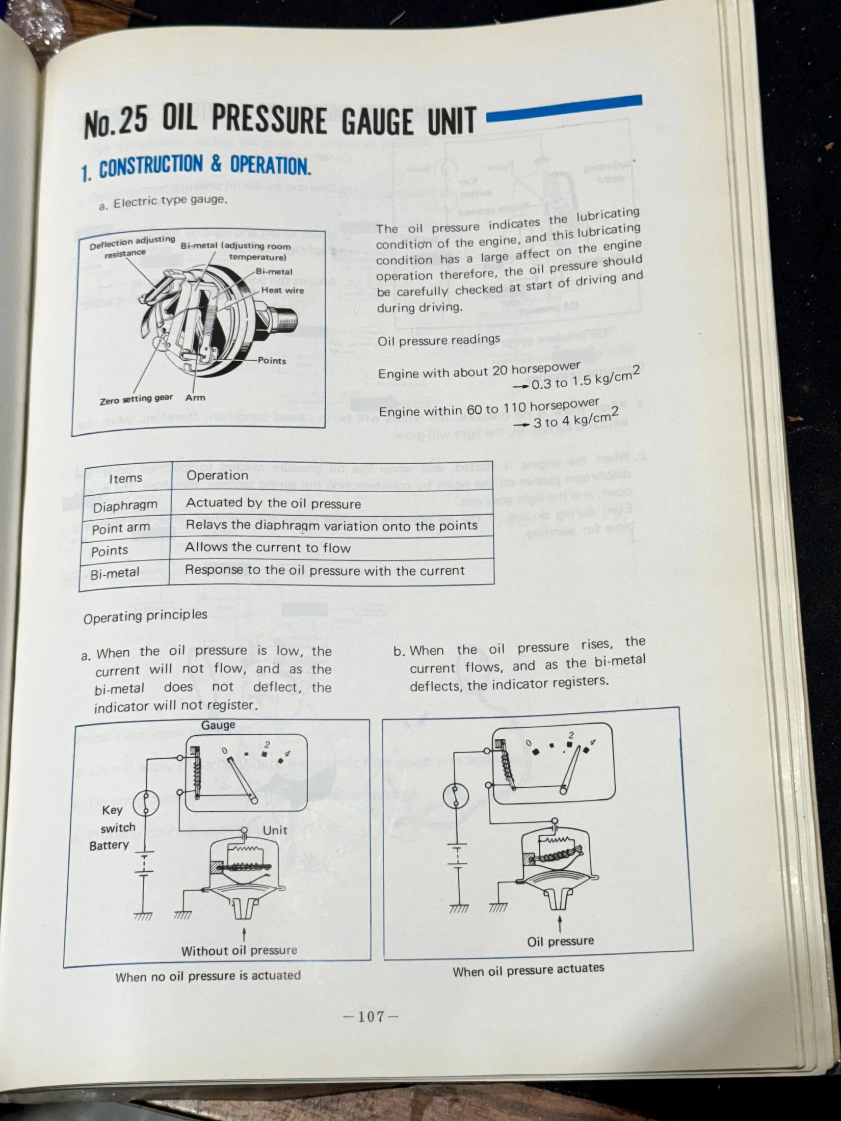

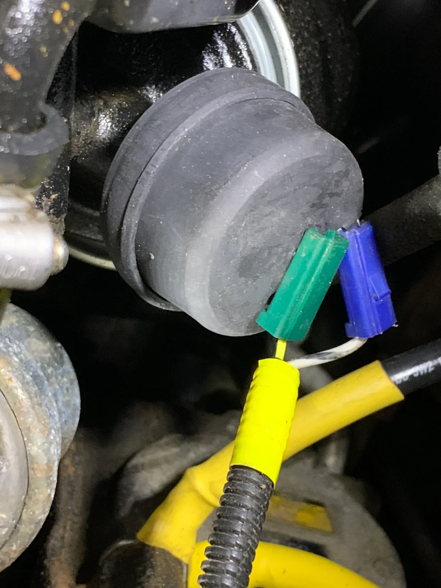

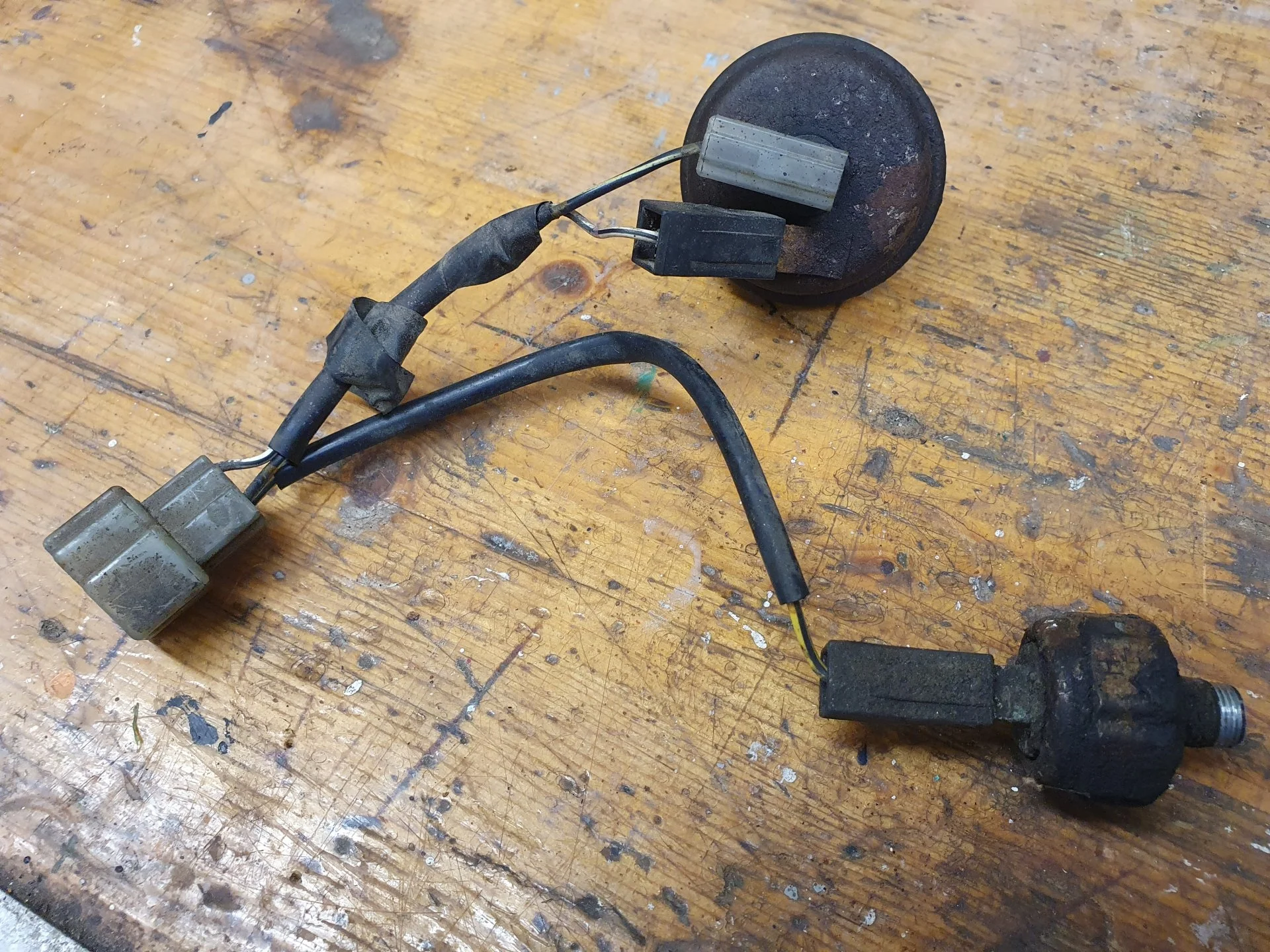

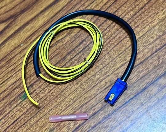

your yellow wire w/ black tracer stripe found a ground path , hence full fielding the cluster Gauge element into certain charred doom
- i have both the single wire and double ire versions , i hand assemble each one using all OEM Japan Spec parts ....
- 16 gauge wire , and a nice tidy gloss loom at the end , i also include a 3M Crimp heat shrink butt adhesive lined to tie it all together for a life time of service :

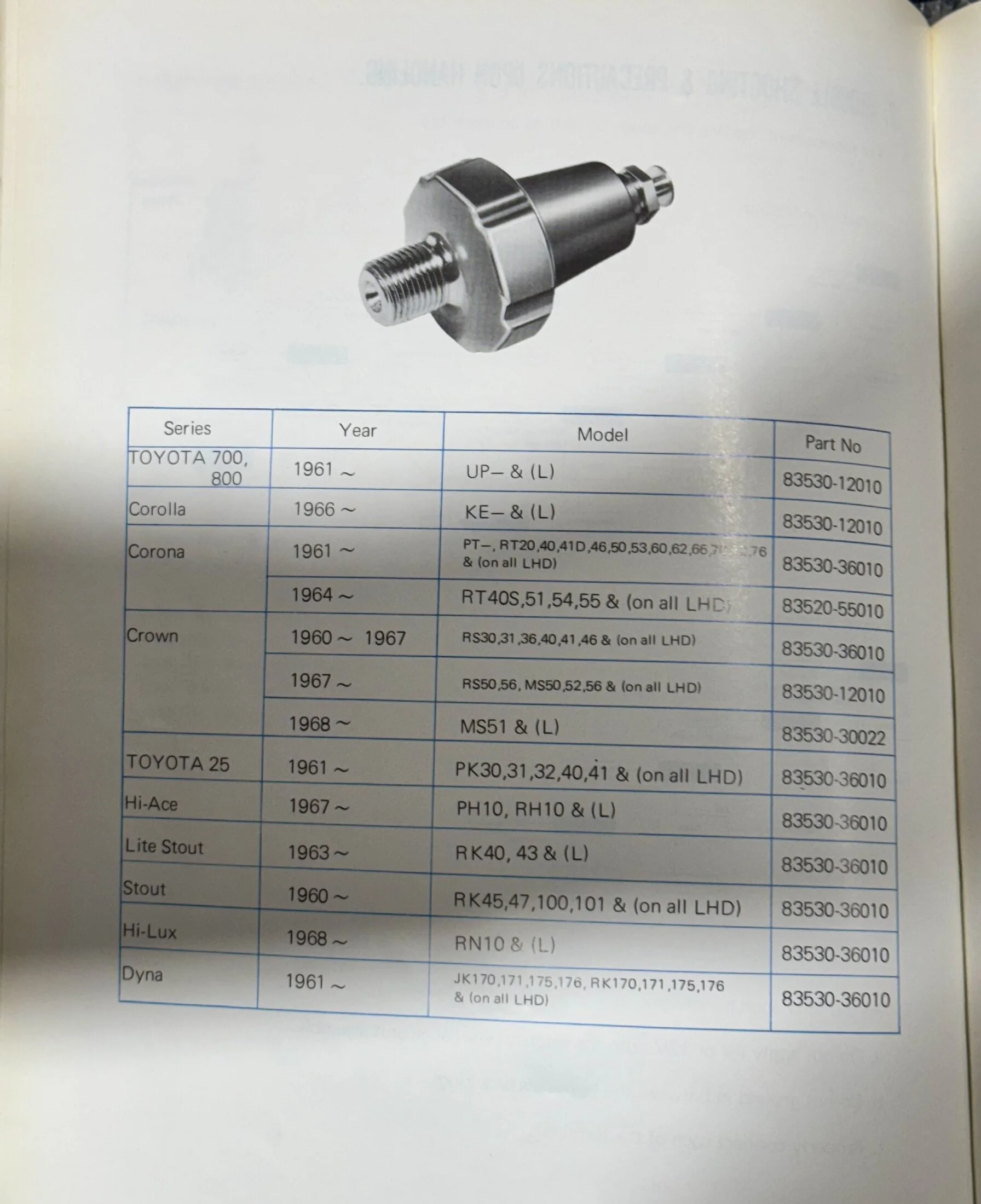

i have also reproduced the 8/80/1990 rubber sender insulator and vibration and temperature stabilizer cover EPDM chemical resistant
Engine Wire No 4 kit us Tite and Right for all years 1961-1990
