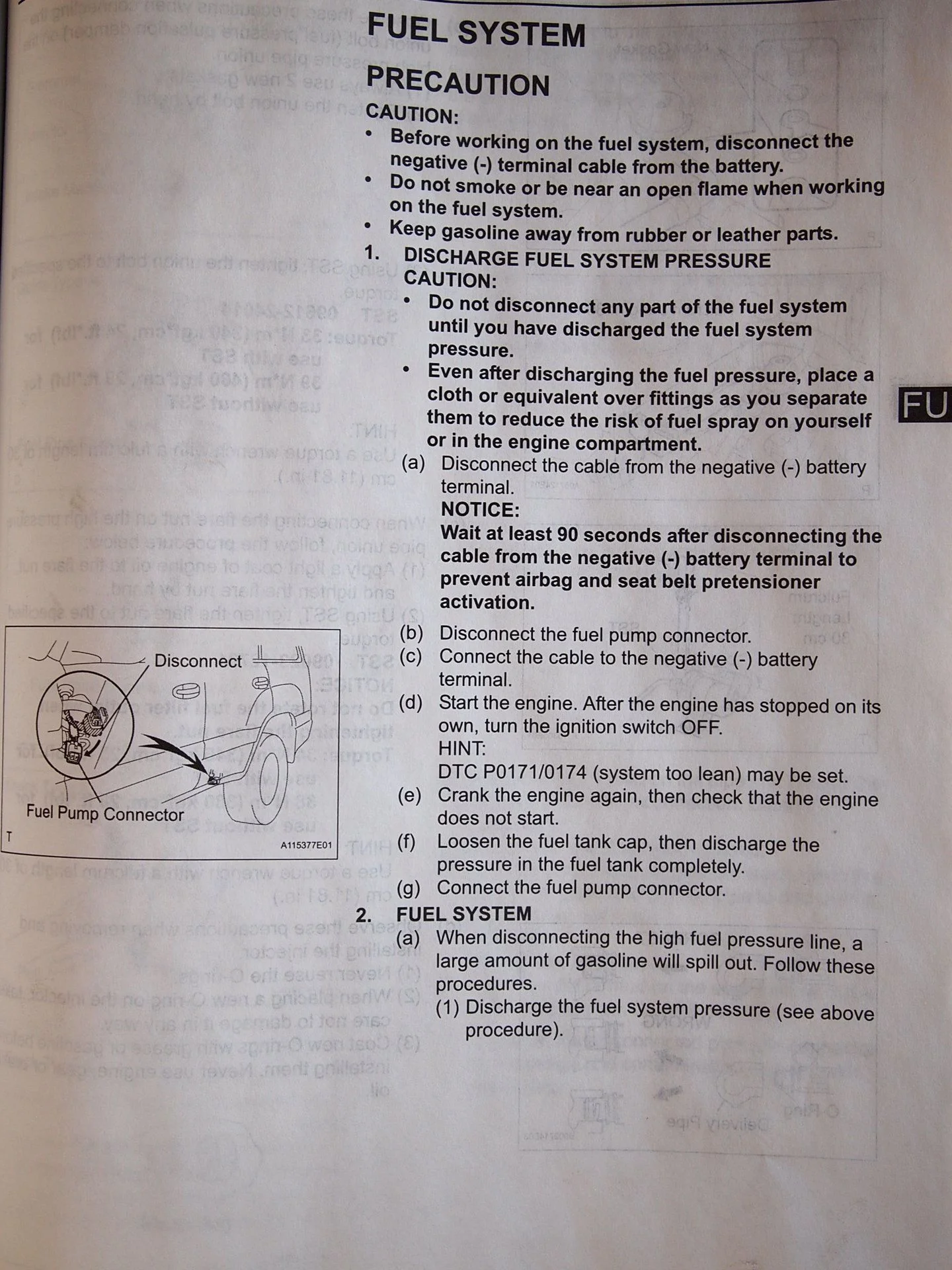

FSM states we should not run fuel pump more than 10 seconds. I did disconnect fuel line quick connect at filter (fuel rail side). Then let auto crank function of starter determine time pump would run. But quickly realized this could damage starter, as it would need ~100 long auto cranks to get just ~10 gallons.

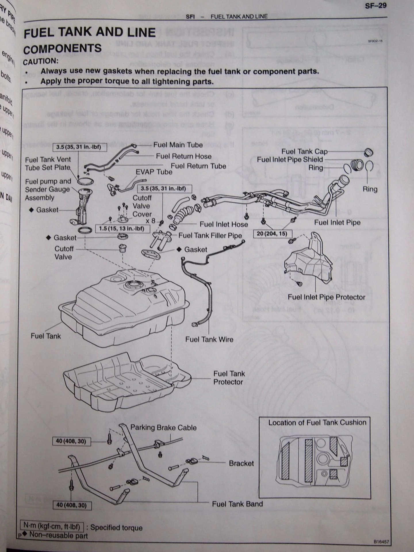

07 FSM

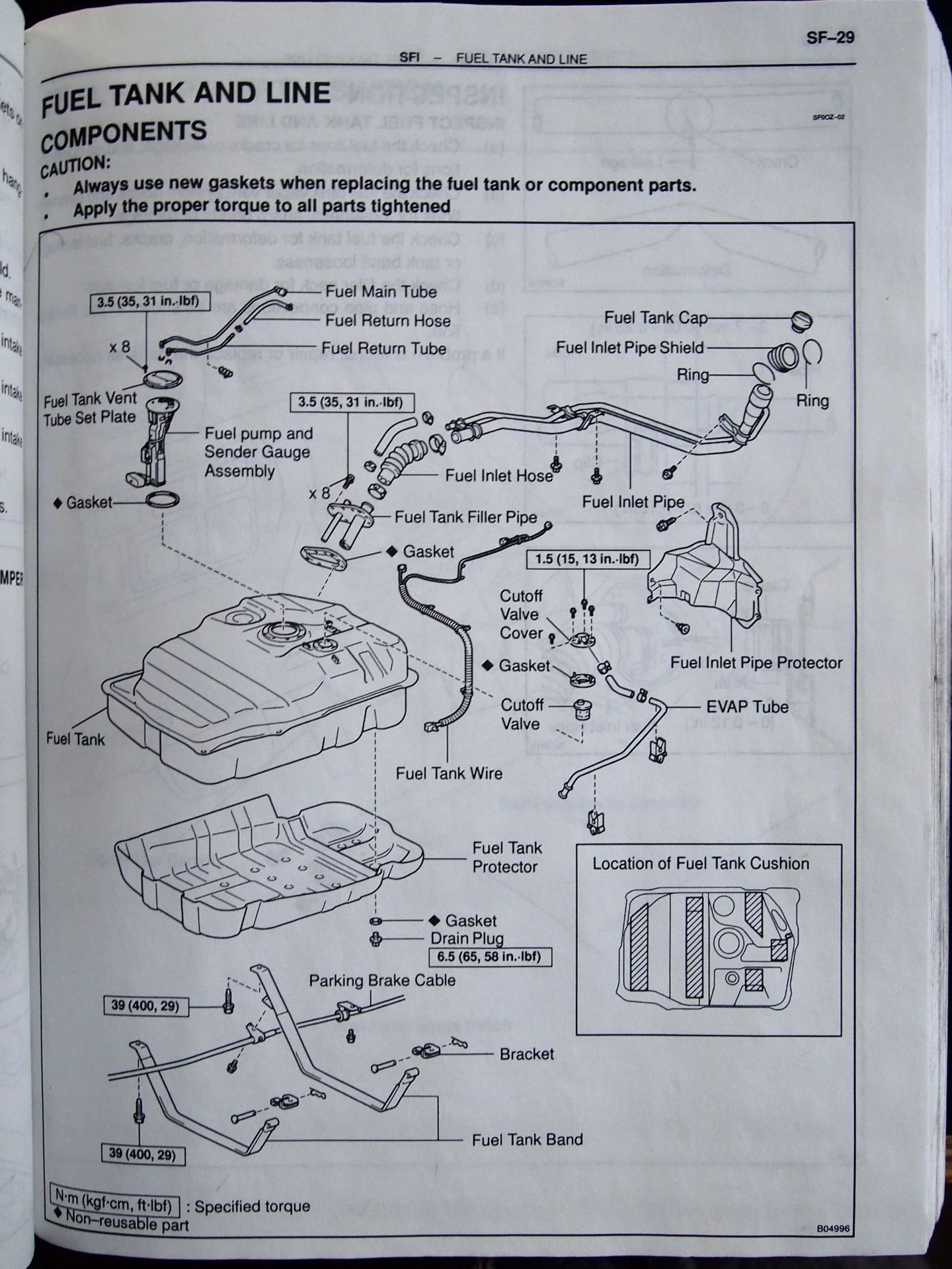

00 FSM does not show a relay under the hood.
The 05 & 07 LC FSM does not show a drain plug.
The 00 LX & 01 LC FSM shows a fuel tank drain plug.

Interesting too, is my parts guys said no Toyota had a fuel drain plug. But yet the FSM from 98-02 show it.
I'm curious why the fsm says not to run for longer than 10 seconds?
Doesn't the fuel pump energize with the key on, not in the starting position? I'd also imagine a jumper somewhere easy to turn the pump on without starter engagement.
FSM states to keep from burning out coil. I was going to jump pump, until I read this.

I did, but with fuel tank cover on. In the older FSM above it looks as if drain can be accessed through or with cover on. As I look at the 07 cover, it has an opening at same point, but no drain plug that I could see on tank. I also called my Toyota parts guy for the drain plug washer/gasket. Which he informed me there is not a one (no drain).

Until this week I thought pump ran once key ON, I now know differently. I also thought pump ran constant during operation. But based on "10 second" statement in FSM, wondering about this now. I suppose FSM concern (burning coil) could have to do with jumping directly at pump. Could it be powering during normal operation through/with the resister connected, protect this so called "coil"?

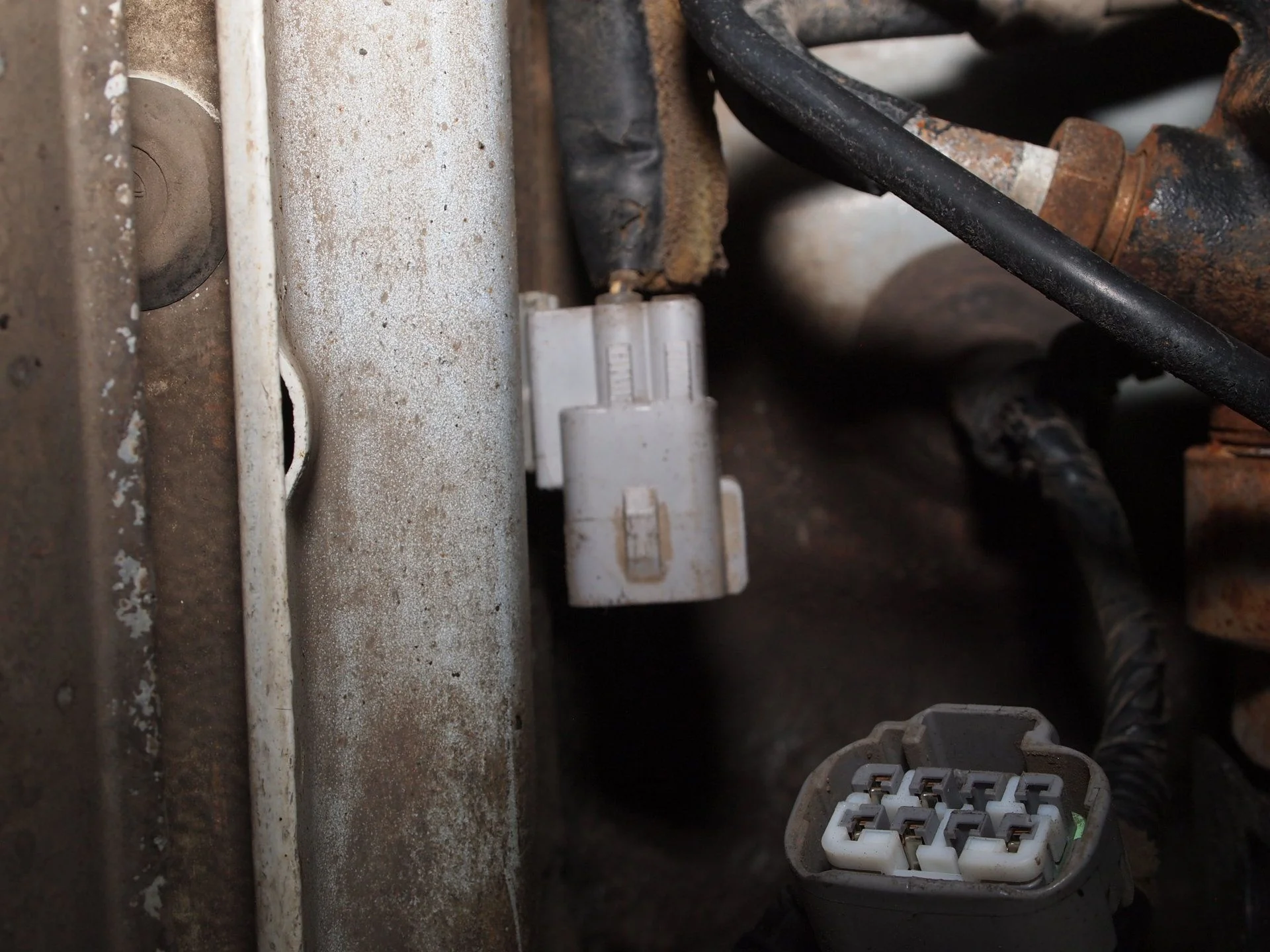

I was thinking I'd jump at disconnect under DS rear door, but not sure which leads here to jumping.
Picture of The Rebaron's fuel disconnect:
Can we jump at fuse box, if so which leads?

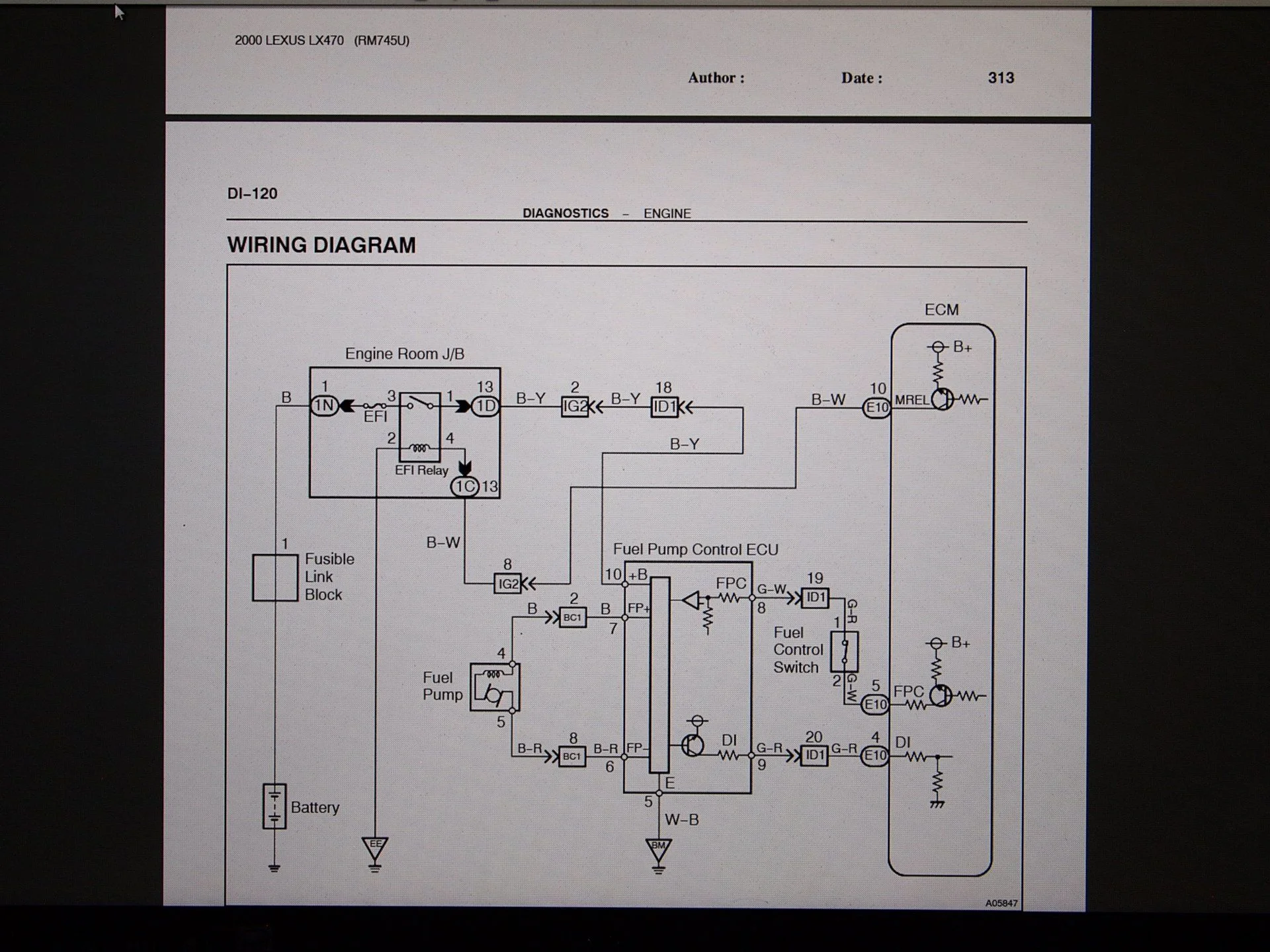

There is a relay saying F pump, you just bypass this. The relay is just a switch, you just link the switch side and not the coil side. So pull the relay and add a fly(link) lead. You might need to put the ignition on, the wiring diagram will show you what to link out or where if prefered to add a feed.

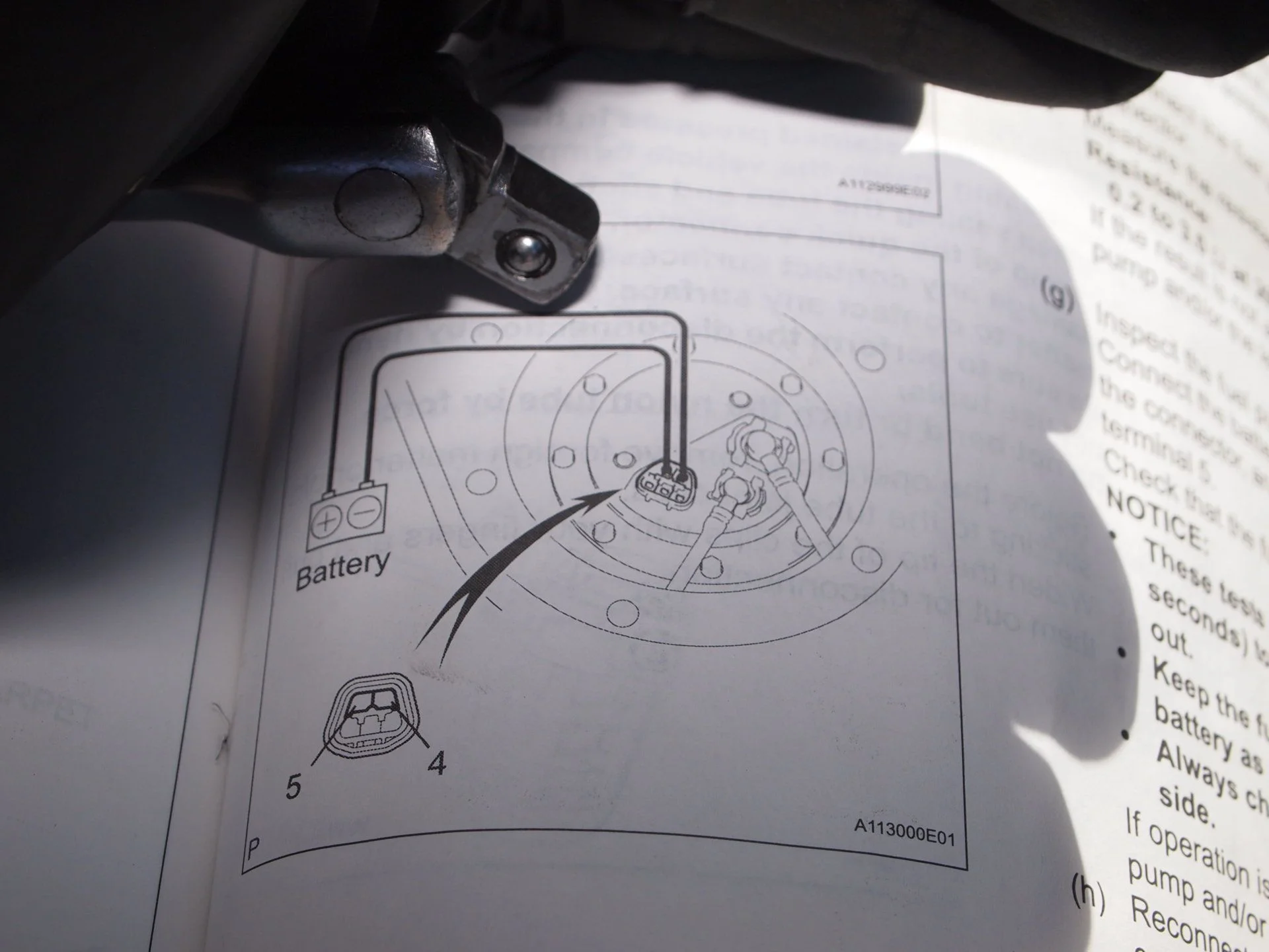

I think that 10 second run time is for pump out of the tank. When in the tank the fuel running through it cools it. The page before the one shown with the test, may show removing it.
Thanks, make sense "cooling".
Although the test is for sure ON-VEHICEL INSPECTION with pump still in tank, where they give warning about coil. It does not say anything about fuel level in tank. Nor have I found any procedure for removing fuel. You'd think they make some statement, at least in fuel tank removal procedure.
But regardless, if we assume cooling/heat is the issue. Then running for under 10 seconds should be safe as @Julian Stead suggested.

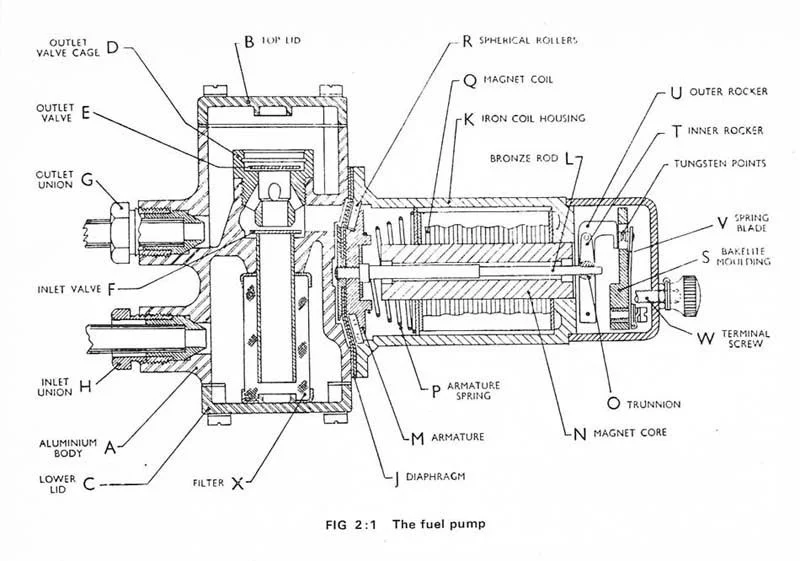

I really was not sure what they meant by "coil" they refer to. I assume it"s the magnet coil like shown in this generic fuel pump.
Wiring diagram shows to link pins 3 and 5.
Check how many pins are on the relay, the test procedure shows a 4 pin, but the wiring diagram shows a 5 pin.

If I can jump at fuel "Disconnect" (under DS rear door) I'd have less risk. As I'd be ~8 feet away from engine bay
I found this picture from Snowy that shows the disconnect wire housing block has 8 slots, but only 5 leads.
It's only a guess, but I'd say the top two are my +-. With outside left being +. You see anything in wiring diagram to indicate whats correct?
Edited: 11/29/17 My guess was wrong!
