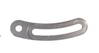

My entire passenger door limiter was missing when I bought my 76 FJ40. I used a small alternator tension bracket like this one as a "temporary" fix. Looks close to OEM an is still working great decades later, no plans to fix it correctly! 😁
Yes, 3_puppies, mine is the rig from Costa Rica with the the tub, doors, and windshield from prior years. I did find the right kit on SOR.com and it IS the rounded bar from the earlier years that's required. I have the bolt that is on the door side, but I'm missing everything else, the round bar and all the pieces that are behind the slot in the pilllar (rubber cushion assembly). I just hate to pay over $200 to get the proper replacement. If it was a period perfect restoration, I would only opt for the OEM components. Since it's a restomod instead, some would consider its value already diminished with such a potpourri of components from years other than '75, I resigned myself to the notion that, in this case, an alternative solution is practical and acceptable. Having said that, if I could find the correct parts at a more reasonable price, I might still fork out money for the correct one. Sometimes being anal about such things can be costly, and I have a tendency to be that way. We actually restored two FJ40s in Costa Rica, one restomod and one OEM (as much as possible) and had them both shipped to the States. I probably should have taken the non-restomod unit for myself! This '75 is growing on me though. At first, I was chagrined to learn when it arrived it was absent door panels and dash vinyl, and contained components from prior years. However, now, I'm thinking of repainting the metal access panels on the doors gray to provide some contrast. This is starting to sound much more palatable. Lot's of these older units seemed to have used that scheme of a different color on the acess panels.
Cruiserkev, that was a pretty cleaver and, evidenlty, long-lasting solution you devised.
